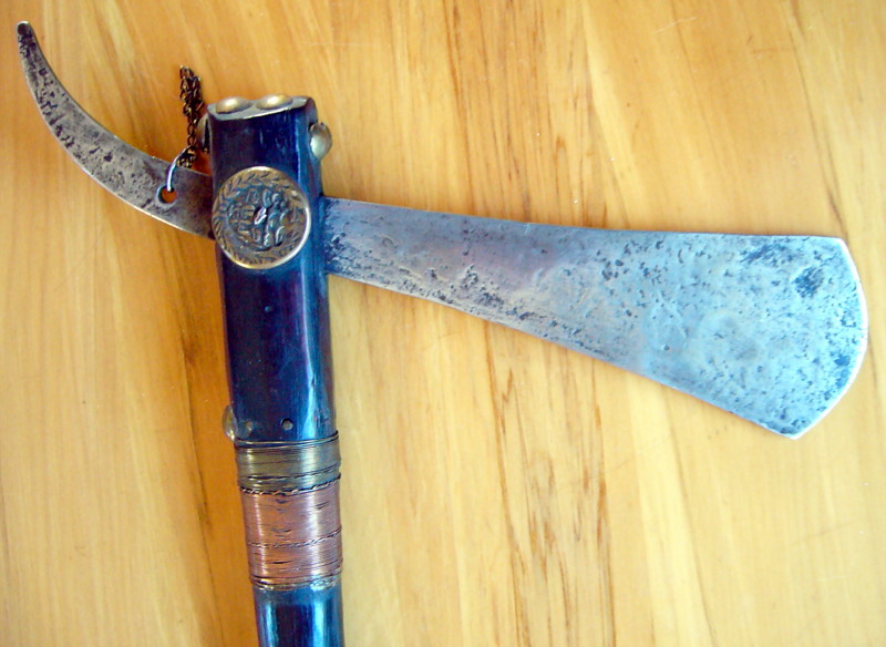

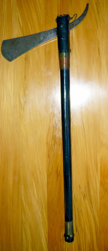

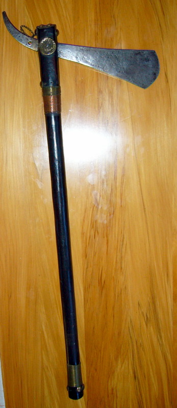

Another interesting axe for comment and identification. After the unreached conclusion of the two axes recently posted by Atlantia, I am interested to see what the Members think about this one.
Some dimensions : Haft length 21 3/4" (555mm)
Blade width at cutting edge 2 1/8" (55mm)
Blade front to back 9 1/8" (232mm)

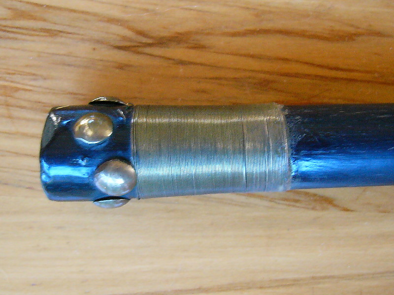

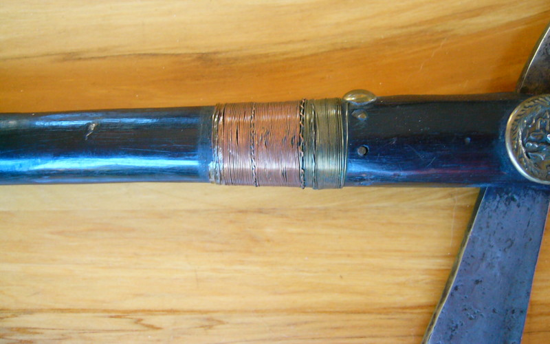

The haft appears to be a hardwood wrapped with brass and copper wire which is very neatly done. Additional decoration of brass domed nails. There is a brass chain attached between the blade and the haft.

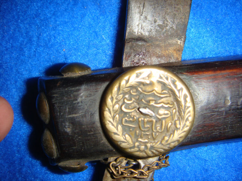

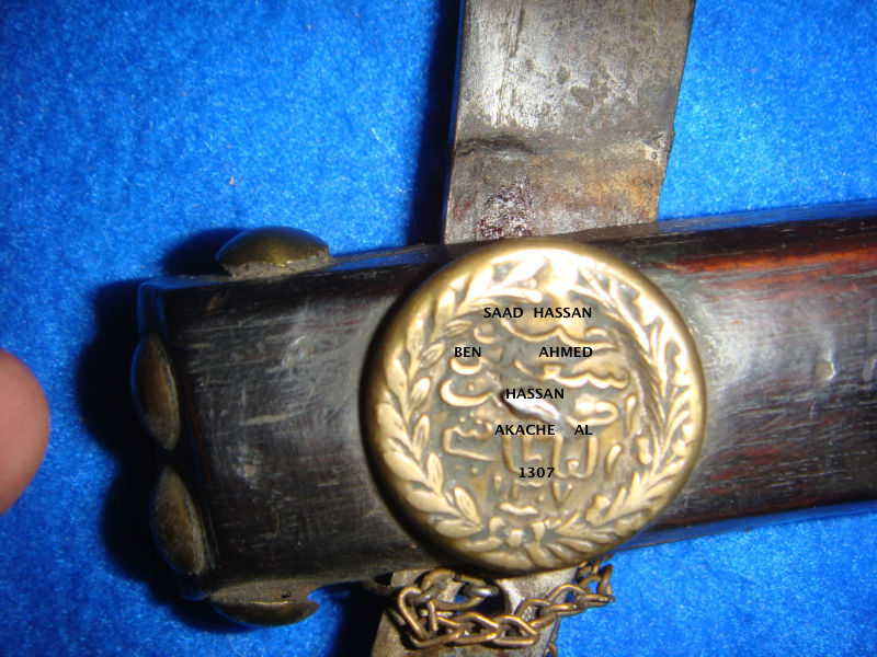

The Cartouche in Arabic, which I have had translated reads:
HASSAN SAAD
BEN AHMED HASSAN
AKACHE AL
1307 (1889AD)
The Cartouche IS NOT a coin. The one sided bevel edge is not knurled, and the reverse is completely plain.
Could the wording AKACHE AL be AKACHE AL(geria)? There is a town/city in Algeria named Douar Akache.
What do you think?

Not much I can add but this look very similar to one on Gav's website. I find the form very interesting and reminescent of the Omani axe.

While African axes are not something I am overly familiar with, I am inclined to agree this is likely something Omani, and distinctly linked to the kinds of axes used by Bantu slavers mid 19th century both utilitarian and as weapons.
The wood seems similar to the axe which appears on Gavs site as noted, in which case the poll of the head extends through the haft.
The appears an embellished example, and the chain attached to the haft and linked to the aperture in the poll recall the chainguards on many Hadhramauti sa'ifs which would have been well known to Omani merchants in traffic to Zanzibar. The connections between the Bantu and Omani merchants in the slaving commerce is of course well established in these times.
This is plausibly the axe of a merchant of either Zanzibar or East Africa and likely an individual of status and clearly Muslim. The accoutrements of the Omani merchants were it would seem often well decorated and fashionable and this would have been a most attractively worn item.

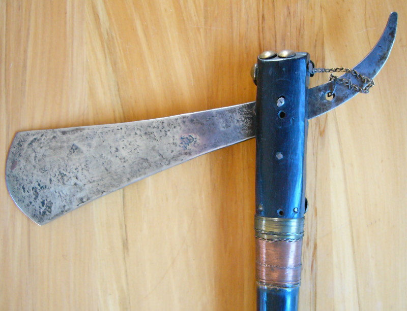

It is good to note that the wire wrap around the haft is a well known affectation seen on of course Persian and Arab sword hilts, as well as, again, the decorative chain . The copper wire is described in Elgood {"Arms and Armour of Arabia") as indicative of wealth. The use of brass studs or rivets is also noted, and seen on a number or weapon hilts.

Originally Posted by kahnjar1
Thank you Gentlemen for your comments and information so far.
I would now like to make some assumptions and would like some feedback on what you think.
1.We now seem to agree that this axe is from what is now modern day Tanzania, which of course was the name given to the combined countries of Tanganyika and Zanzibar.
2. It is assumed that the language spoken in Tanganyika was some sort of african dialect.
3. Zanzibar was under the control of the Sultanate of Oman from 1698 until 1890 when the British interfered.
4. It is assumed that the language spoken in Zanzibar at that time would largely have been Arabic.
5.This axe has a cartouche in Arabic, so we assume that it "lived" in Zanzibar.
6. Assuming that the date 1307 (1889ad) on the cartouche is accurate, then this axe existed in Zanzibar under Omani rule, as the British did not take power until 1890.
If the above IS correct then this axe, although of african origin in design, is actually of Arabian (Omani) heritage.
no objection at my point of view,
this demonstration makes sense
à +
Dom
Old 16th June 2011, 06:22 PM   #23
Posts: 10,838
Excellent synopsis of the established facts and presumptions collectively.
Perhaps this might serve well in reflecting on the note made concerning Arab outposts in East Africa.
1.Zanzibar became a part of the Sultanate of Oman, though as a trade center, it began as an Omani trade station, or outpost.
2. Zanzibar is located in East Africa
Therefore there were Arab outposts in East Africa as well as across the continent. This was one of the key factors in the diffusion of Islam both religiously and culturally. Eventually many of these outposts which were strategically along established trade routes developed into towns and eventually cities.
In considering the possible provenance of this axe, which it seems generally agreed to carry distinctly Islamic affectation, with a number of the features characteristically Arab, and even more defined as Omani. The typology of the axe itself seems however to correspond to forms well known throughout Central African tribal groups, with certain provenanced examples known to belong to Bantu slavers.
As we know that Bantu slavers were in league with the Omani slave trade operating out of Zanzibar as well as probably others, and we know that the routes frequented by these caravans headed for Zanzibar headed into what is now Tanzania enroute to Zanzibar. It stands to reason that axes of this type, known to be used by Bantu in Central African regions, probably diffused with trade and various interaction to contiguous regions and tribes through time.
The fact that this carries Islamic decoration and features does not distinguish it at Zanzibari, we can only assume that it is plausible it may have ended up there with an individual connected to the commerce situated there.
We cannot therefore call it an 'Omani' axe, as it is of a well established African tribal form geographically well dispersed, and known to be used by various tribes. The decoration, which resembles well known 'Arab' elements, may be from Omani sources, or Hadhramati, but the presumption to Oman is due to the connection to the known slave trade in Zanzibar.Also considered are the examples of these type axes attributed to Bantu slavers and examples from Tanzania (part of Zanzibar). Since Slaving was one of the key elements of commerce present in this sector of East Africa and Zanzibar the connections seem compelling.
It should be pointed out that Zanzibar itself was a trade metropolis by the middle of the 19th century with profound international and cultural diversity.
There are a number of weapons presumed to be from Zanzibar, however this does not seem to be their true origin. The Omani kattara for example was in the time of Richard Burton ("Book of the Sword" 1884) often considered a Zanzibar sword because of its prevalence there with Omani merchants. The curious dirk type weapon termed by Burton 'Zanzibar sword' was presumed so, again because of its prevalence there. These 'I' hilt weapons (similar to the European baselard) were improperly identified first by Demmin (1877), and later discovered to actually be a form of the s'boula from Morocco (confirmed by Buttin in 1933, discussed in my research 2003). Also typically classified as from Zanzibar (Buttin 1933) are the sa'if (known as nim'cha) with the hilt similar to the Moroccan form, but with a perpendicular ring on the crossguard. These, though typically found in Yemen, are said to have been produced by armourers in Zanzibar using trade blades.
The key importance to this example referring to the Zanzibar sword is that the geographically wide separation and appearance of these weapons illustrates tne vast distances and dynamics of the trade networks, and an interesting connection that reflects this is the presence of these same type weapons in Ethiopia.
It should be noted that while Ethiopia (then Abyssinia) was primarily Christian, Harar and its regions were nominally Muslim, as was Somalia, other points of trade where Arab outposts were quite present.
In conclusion I would restate that this axe could be from one of many East African locations where Arab influence prevailed , and probably in association with Omani slave trade merchants. It seems to be decorated in accord with the merchants desire to reflect status, power and wealth much in the same manner as used by businessmen, leaders etc. through history and what seems a well known practice with the merchants of Oman.
Incidentally, John Hanning Speke was with Sir Richard Francis Burton in Somaliland in 1854, and they were also in Zanzibar.They discovered Lake Tanganyika in 1858 in thier quest for the Nile source.
Old 16th June 2011, 06:59 PM   #24
kahnjar1
kahnjar1's Avatar
Posts: 2,828
Default Some Clarification
It was never my intention to say that this axe ORIGINATED in Zanzibar but that at some stage it "lived" there. As we are well aware from other threads, the existance of BORDERS as we know them, meant nothing to the tribes who inhabited the land, and it was not until the colonial powers started taking their "empires", that actual borders came into existance as we know them today. For the sake of agreement can we say that the axe comes from East Africa, and at some stage in its life has had some definate contact with the Arab world?
Old 16th June 2011, 07:14 PM   #25
Posts: 5,979
From " Manfred A. Zirngibl & Alexander, Panga na visu" very nice book. I think Ujiji was the furthest west Arab trading market.
Old 16th June 2011, 07:19 PM   #26
kahnjar1
kahnjar1's Avatar
Posts: 2,828
Thanks Tim, I think this confirms Tanzania (Tanganyika).
Stu
Old 16th June 2011, 08:51 PM   #27
Posts: 10,838
Good discourse, and clarification.....well placed examples from Zirngibl/Alexander.
For those reading, it should be noted that Ujiji would have been a trade outpost in western Tanzania, and located near Lake Tanganyika. It was indeed near a slave trade route.
I think we agree that the axe is likely East African, and as noted has been embellished with Arab decoration, with the possibility that this derives from slave related commerce that corresponds to routes coming out of Zanzibar, part of the Sultanate of Oman, known for that particular activity.
Old 17th June 2011, 05:50 PM   #28
colin henshaw
Join Date: Jan 2008
Posts: 1,429
Hi
An interesting African axe and good discussions on its potential origins etc. I would just like to add a few further points for conjecture :-
The axe is a recognised type from Tanzania and down into Mozambique, made by Africans. They were often "badges of office" used by headmen or important personages and carried on the shoulder. The trade brass and copper wire, and brass upholstery nails, were common African adornment used on weapons.
As noted, this area of Eastern Africa was extensively penetrated in the 19th century by Arabs of Omani origin (also Swahili and Baluchi) slavers and ivory traders. They established an extensive network of transportation, settlements etc. Also alliances with African tribal leaders. The brass medallion with the Arabic inscriptions could well have been given to an African ally in their slaving/ivory trade, either as a gift for adornment or a "membership card" in their joint enterprise. Probably the trader kept a stock of these medallions for distribution as felt appropriate. I think it unlikely the axe was the property of an Arab in Zanzibar.
A couple of useful references on this topic are :-
"Armies of the Nineteenth Century : East Africa" by Chris Peers 2003
"African Axes" by Carl Gosta Widstrand
Old 17th June 2011, 06:29 PM   #29
Atlantia
Atlantia's Avatar
Join Date: Jun 2008
Location: The Sharp end
Posts: 2,928
Hi
Hi Colin,
Could you recommend any other good in-print resources for axes/spears
please?
Thanks
Gene
Old 17th June 2011, 06:56 PM   #30
Dom
Dom's Avatar
Join Date: Oct 2005
Posts: 1,142
to the "Gang"
I am surprised that nobody mentions that for a long Zanzibar attracted the greed of merchants Persian, Arabic, Portuguese and British, for its spices;
- clove (whose smuggle collection was convict by death penalty)
- nutmeg
- cinnamon
- ginger
- cardamom
be side to the slaves trade, the Omanis were great traders of spices, and the production of Zanzibar was in addition and in complement of their supplies coming from India
in 18th 19th century, spices was having value as well as it was ... gold,
that explained the Omanis's interest for the 25–50 kilometres (16–31 mi) off the coast of the mainland, and consists of numerous small islands and two large ones: Unguja (the main island, informally referred to as Zanzibar), and Pemba
few references to dates
Zanzibar became a part of the Sultanate of Oman, though as a trade center, it began as an Omani trade station, or outpost, controlled by Omanis in the 18th and 19th centuries.
Britain established a protectorate (1890)
à +
Dom
