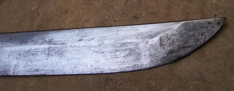

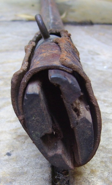

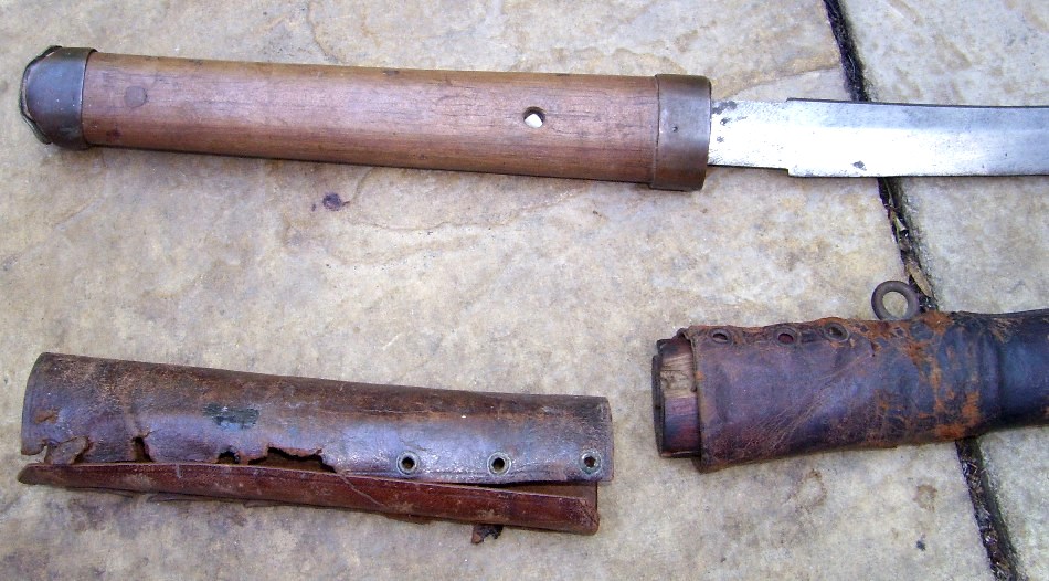

Hi,

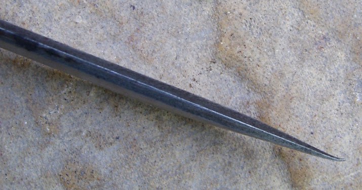

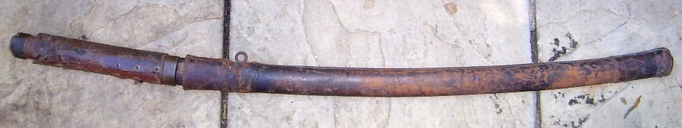

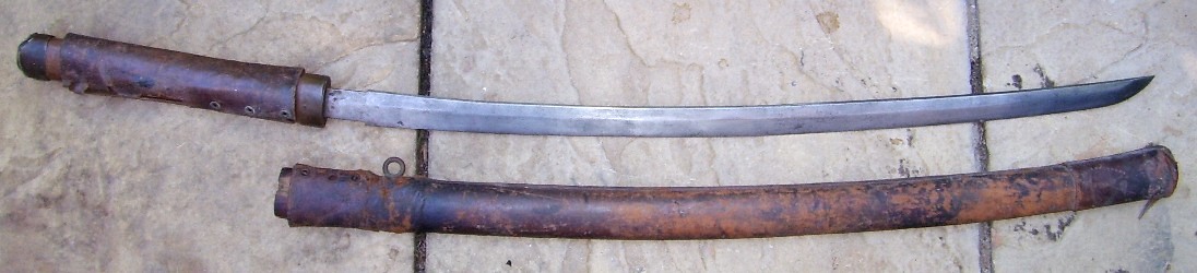

can anyone please help with a new aquisition, what I believe to be a genuine Gunto. Saya is wooden with leather cover (type 98 ?) single suspension ring. The blade seems better than average quality and has obviously been re-fitted with this latest handle.
No tsuba, seppa or habaki
Kissaki looks reasonable, there seems to be some evidence of forging....in places looks almost straight grained (Masame ?) No obvious harmon not even an oil quenched one, but the blade has many scratches and is out of polish. The blade spine (mune ?) appears to be Ihori ie inverted 'V' profile.
The tang I believe is Futsu and the tang-tip Kurijiri.
Blade tip to 'step' (just before the tang) 65cm OAL 85cms Widest point 30mm approx. 3.5 mm thick.
Plenty of pictures,....can any one confirm this is Gunto, could the blade be older ? all comments gratefully received, thank you
PS I've just noticed on the picture of the tang there could be (very faint) a signature ??

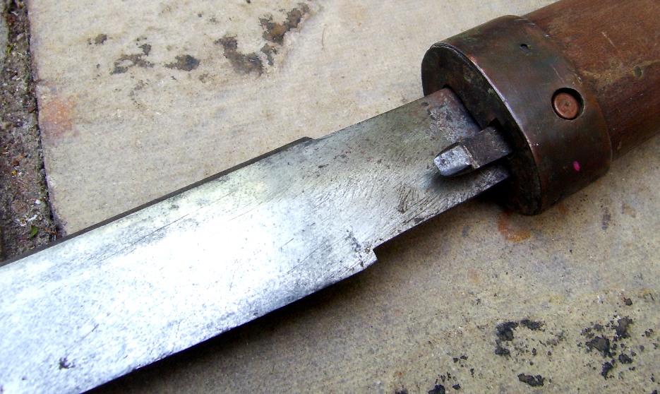

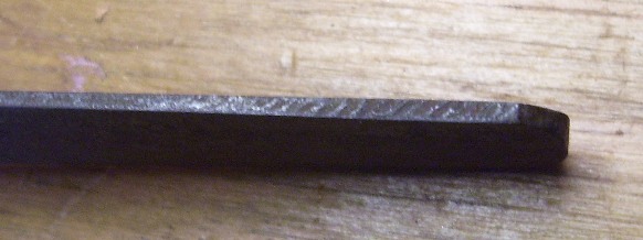

Cleaned an area on the blade with very fine wet and dry paper using a very fine 1020 grade then (even finer) 2040 grade, lubricated with some olive oil.
First thing that was noticeable is there is a Hamon and its not a Chinese acid etched one !!! Its not regular but is a fine colour change in the steel I also think there is 'activity' in the blade....impossible to photograph....but when reflecting direct sunlight the cleaned area glistens and sparkles...hard to explain but the blade seems to come to life as you gentle 'angle' it in the sunlight.... like it is covered in very fine glitter ...but when you look at the blade 'staight on' the 'metallic' sheen is gone ....not explaining this very well but hoping someone might understand the 'rambles' of this madman
There is a small, but noticeable, forging flaw which could explain why, if the blade is of some quality, it was not signed ??
Not certain what to do now...should I etch the newly cleaned area ????

I totally agree that the scabbard and fitting are low quality and typical of those late in WW2.
However, the blade is much better quality and seems a total mismatch...whether it is due to necessity during the war or later ...
The very tip of the kissaki is slightly bent (the picture makes it look larger) but is still extremely sharp and well defined..... and do not want to try to straighten it as I am certain it would snap. The tip is also very thin where it mets the spine due to the contination of the Ihori (inverted v profiled spine)The edge section you mentioned is also quite small. I am not saying this blade is Nihonto but does seem better than some other gunto I have seen.
The late war blades were often made from sub-standard steel and produced rapidly, so manufacturing standards dropped...it was a time of desperation, so do not believe that this blade is one of those.
I have only seen a few gunto but do not recall any of them having the Ihori type spine....just a standard flat one.

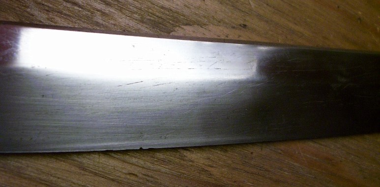

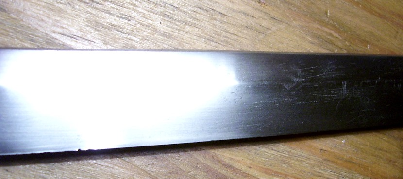

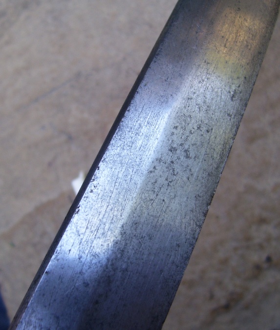

thank you for your input . I have tried to 'capture' the hada but it seems almost impossible ....it is very subtle. I have posted my poor efforts below. I am amazed as to the relative rigidity of the blade , there is flex ..but I would normally expect much more flexibility from a sword blade just over 3mm thick.
It seems that many of the scratches were caused by sharpening (crudely) ...I believe (by patina) that this sharpening may have occured 'in the field'. The shinogi, is very regular so must be the photos. The forging marks are scratches (the ji and the shinogi-ji ) they look worse than they actually are (magnified picture)
Kind Regards David

Thanks for posting these additional photos...
The scratches on the surface look much more superficial in these photos than in the earlier pictures. The shinogi, while it does appear regular, still seems to lack a certain "crispness" I am accustomed to seeing in shinogi-zukuri nihonto. Again, this observation comes with the caveat that my exposure is rather limited. I also recognize this may be simply a result of the photographs. I took a couple photos of the shinogi of one of my own earlier today. Tomorrow I will download them and see if they appear different through a lens then they do to the naked eye.

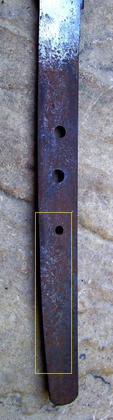

Below are some pics of the nakago ....there does seem to be file marks ...also on the rear edge (top and bottom) some diagonal marks. I have tried again to capture the apparent 'activity' in the blade...but not very successfully. I have briefly 'cleaned' the kissaki with 1200 grit paper (not very well) but it seems to show some 'crispness' to its definition. The shinogi on mine is not as crisp as yours....very slightly rounded, but I think this may be due to poor polishing. There is a small section of the shinogi which is not perfectly in line ......at this same section on the blade there were 'ghost' marks, very unclear, but seem to have been Japanese characters which may have been polished out ....and in doing so affected the line of the shinogi at this point. I have carefully checked for any fatal flaws ....and so far found none ....but then again a proper polish may show these more clearly ??
I , so far, have not contacted Rich yet ....I don't want to waste his time if this blade is not kosher or at least a high probabillity that it is genuine.

Thank you for posting the pics of the nakago. I am at a loss...
The patina looks legitimate and old, and as been mentioned, along with the three mekugi ana, seems to speak to age. Thus, as the opinion should fit the data, maybe the aforementioned attributes that raise concern can be explained by a bad polish as you suggest, or a tired sword?
If the sword has been polished through the skin steel, leaving in its wake the softer core steel, I would think this might account for the appearance of the shinogi, the bent ha and kissaki, and the 3mm kasane? We are so far past my confidence level I can only surmise without certitude, and follow up such possible explanations with the obligatory shrug:
I can state with certainty however, that so long as this sword is in your possession, carbinated beverages should remain afraid... very afraid.
