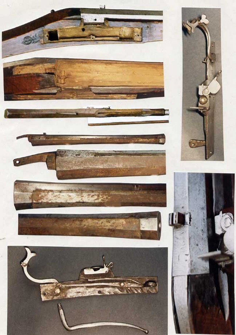

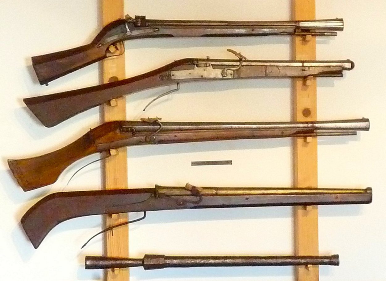

I would never have generally ruled out the early existence of iron ramrods for heavier pieces, and I am glad to be able and prove your discovered contemporary artwork by two really existing wrought iron crudely sighted haquebut barrels, both possibly Nuremberg made, about 1500-10, ans struck with a maker's mark, a shield with some pellets, the swiveling touch hole cover of one missing, the latter barrel heavily damaged and broken in two in the middle, and both retaining their iron ramrods characteristically bent outside the muzzles in order to prevent them from going in too far - just the way Alexander found them illustrated!
Both are preserved in the Museum of a small Northern Bavaria country town named Wunsiedel, where I took photos of them amost 30 years ago!
As 'Nando pointed out, I would however like to reemphasize the fact that iron ramrods were the exemption to the rule until the early 18th century. The Landeszeughaus Graz preserved hundreds of separate thick wooden ramrods mounted with iron finials threaded for screwing in cleaining tools for their mid 16th c. wall guns (Doppenhaken), and the huge 35 kilograms of weight Nuremberg bronze Doppelhaken of ca. 1520 in my collection (posted here earlier) also retains its original fir wood ramrod (repaired in places), its iron finial retaining its original cleaning tool.
Michael

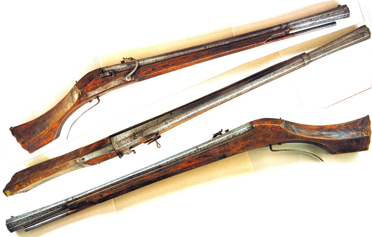

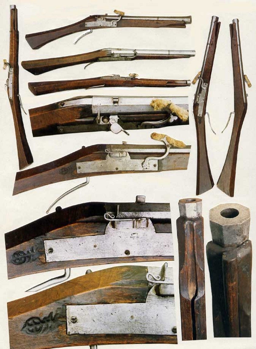

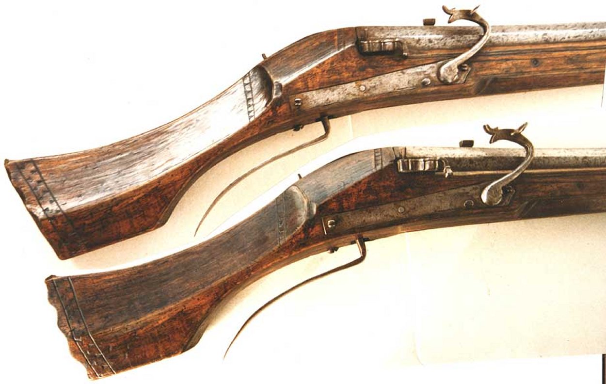

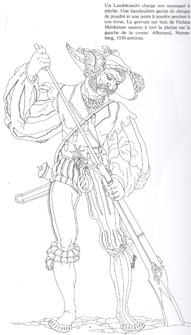

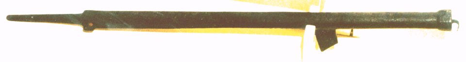

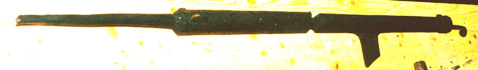

Here is a full view and a close-up of the South Tyrolian fresco Alexander posted above.
It is, as I wrote in an earlier thread, preserved on the wall of a 15th c. guardroom of the fortress Schloss Issogne, Aosta Valley, and can be dated closely to ca. 1495.
Please note the hooked iron ramrod seen in front of the ramrod channel of the lower Landsknecht arquebus, which I had hitherto overlooked - my old eyes begin to lose their light ...
However, also note the cylindrical tubular iron finial (Setzerkopf) of the - most certainly - wooden ramrod shoved into the stock of the uppper arquebus - obviously the more modern loading tool! We can but speculate why the wooden ramrod prevailed with both 'military' and sporting guns until the first half of the eighteenth century ...
Michael

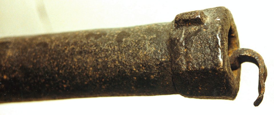

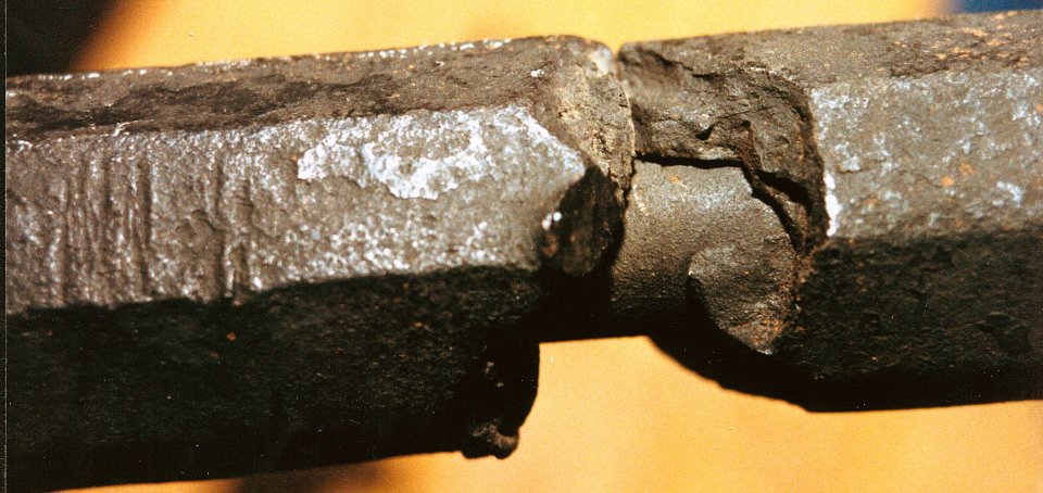

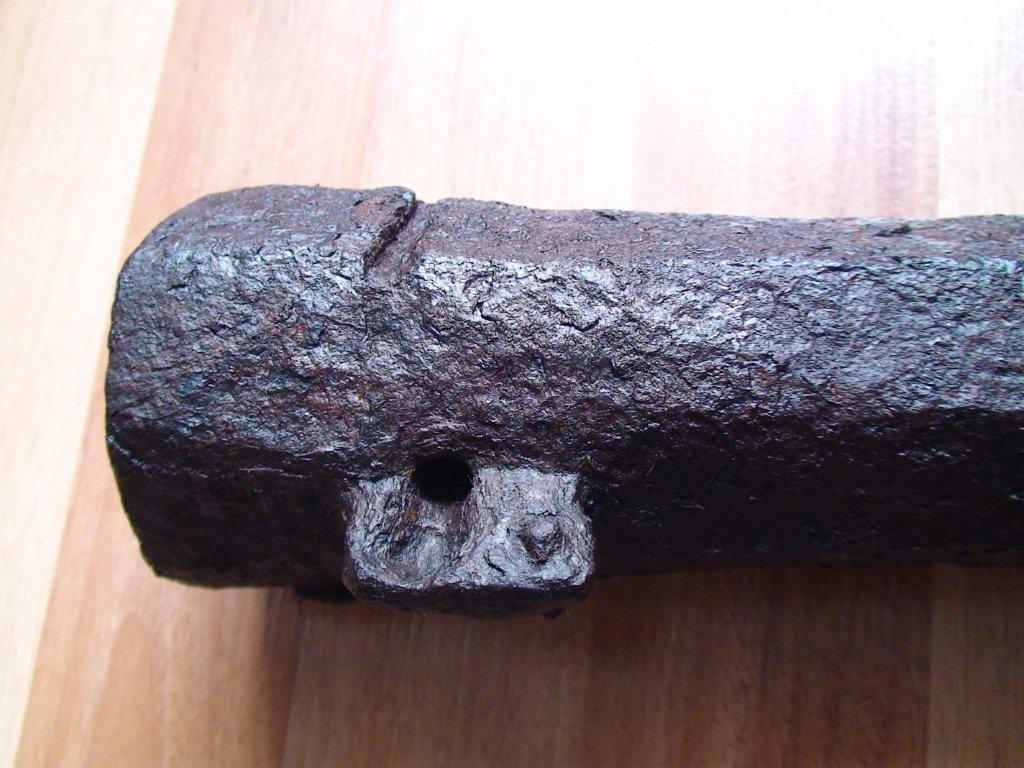

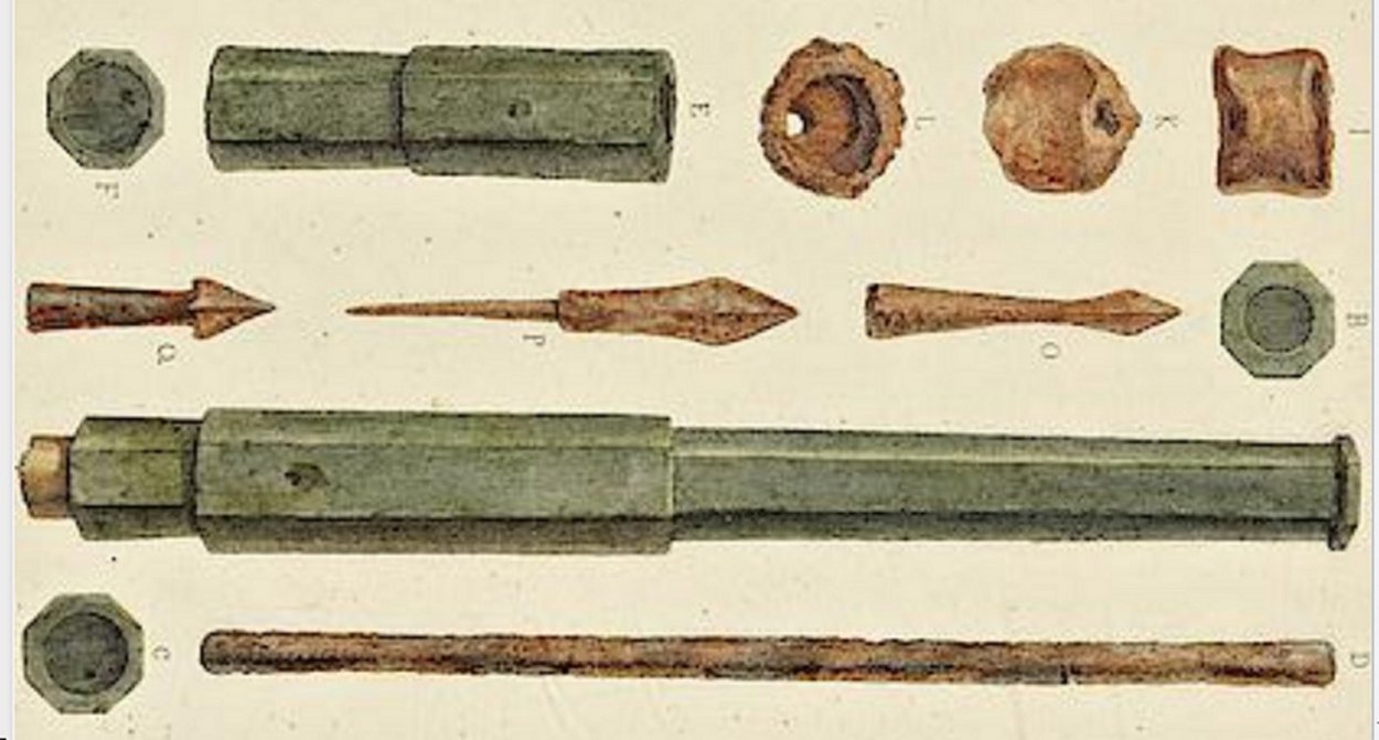

In August 1848 not only the well known Tannenberg handgonnes were exavated from a water cisterne at Tanneberg Castle (Hesse, Germany) but also an iron ramrod lying near the handgonnes. The find can be securely dated to 1399 when Tannenberg Caste was sieged and destroyed by the City of Frankfurt. The find is publised in J. von Hefner, J. W. Wolf: Die Burg Trannenberg und ihre Ausgrabungen. Schwerberg, Frankfurt 1850 Online. On table VII the ramrod is marked with a "D" and here you can see its dimentsions compared to the handgonne. Till yet I don't know where the ramrod is kept or if it is still survived after the excavations some 160 year ago. The handgonne is kept at Germanisches Nationalmuseum in Nuremberg and I hope so the ramrod too.

Splendid, Andi,
Great job - thanks a lot!
When your are in Bavaria you should come and see me and my collection. Now how does that sound? Inciting, doesn't it?!
Michael

According to Joachim von Wlassatys article Nachlass der Raubritter - 600 Jahre Tannenbergbüchse in Deutsches Waffen Journal 6/1999 the ramrod was separated (and the loading of the gonne and the rest of the survived tiller were removed from Tannenbergbüchse ) before the Tannenbergbüchse was transferred to Germanisches Nationalmuseum in Nuremberg. As far as I interpret the article the ramrod (along with other finds) was probably lost during bombardements of Hessisches Landesmuseum Darmstadt in 1944
Andi is offline   Reply With Quote

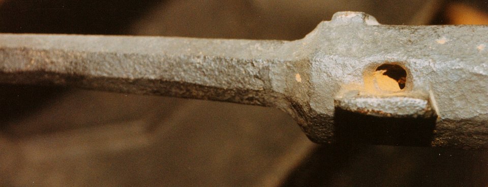

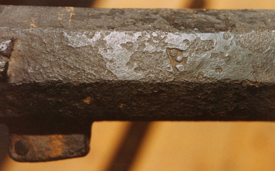

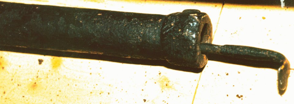

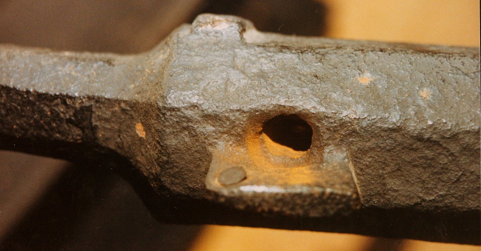

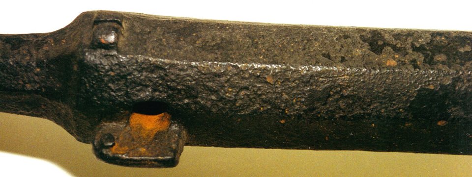

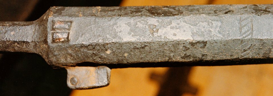

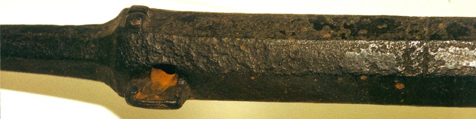

Close-up details of the Tannenberg brass/bronze barrels plus the iron ramrod - enjoy!
m

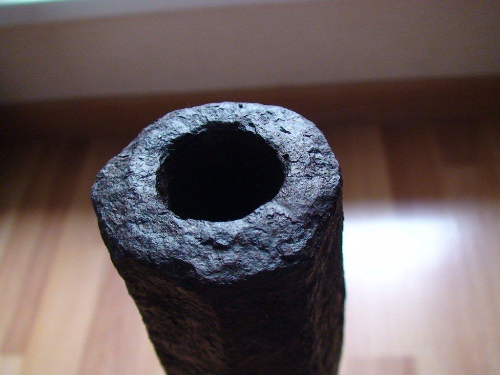

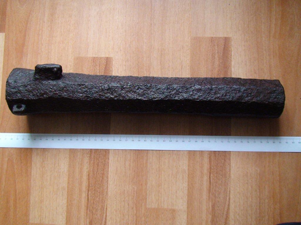

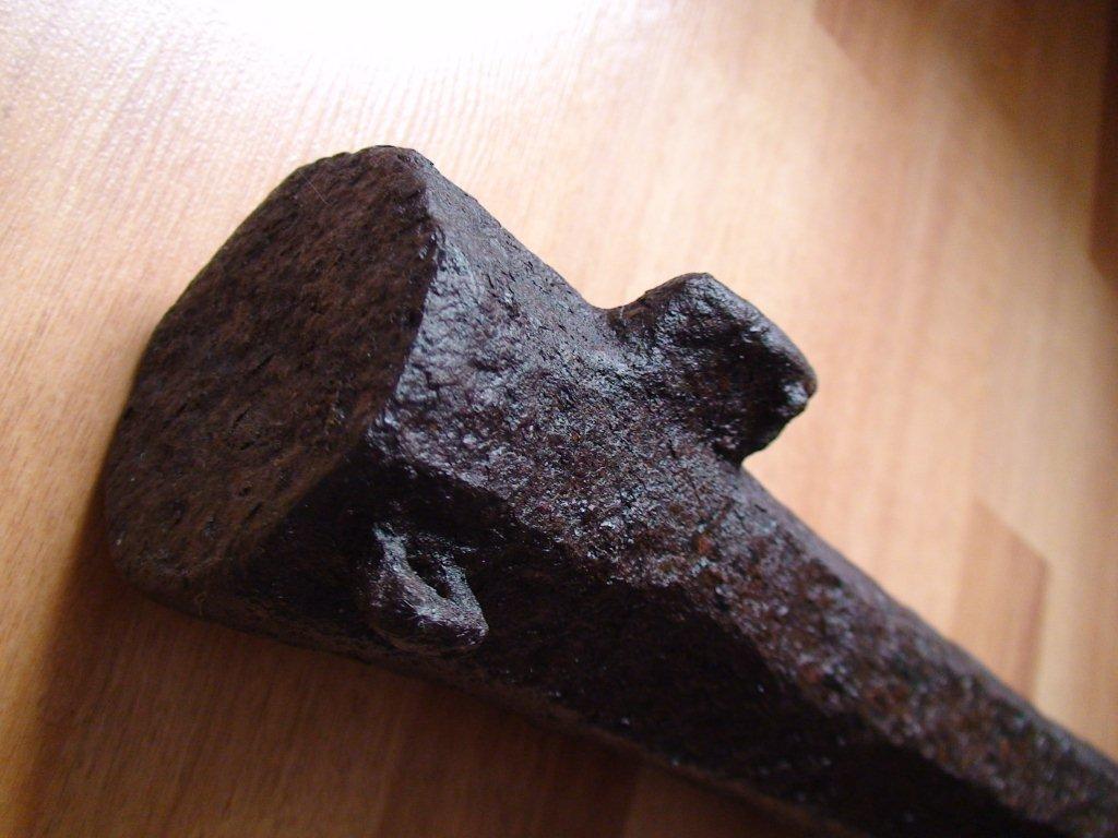

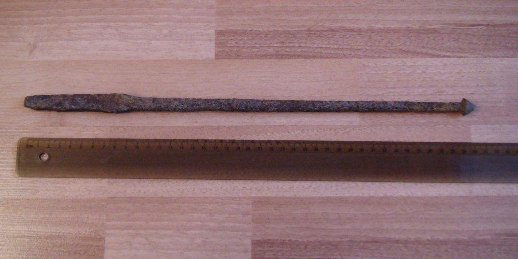

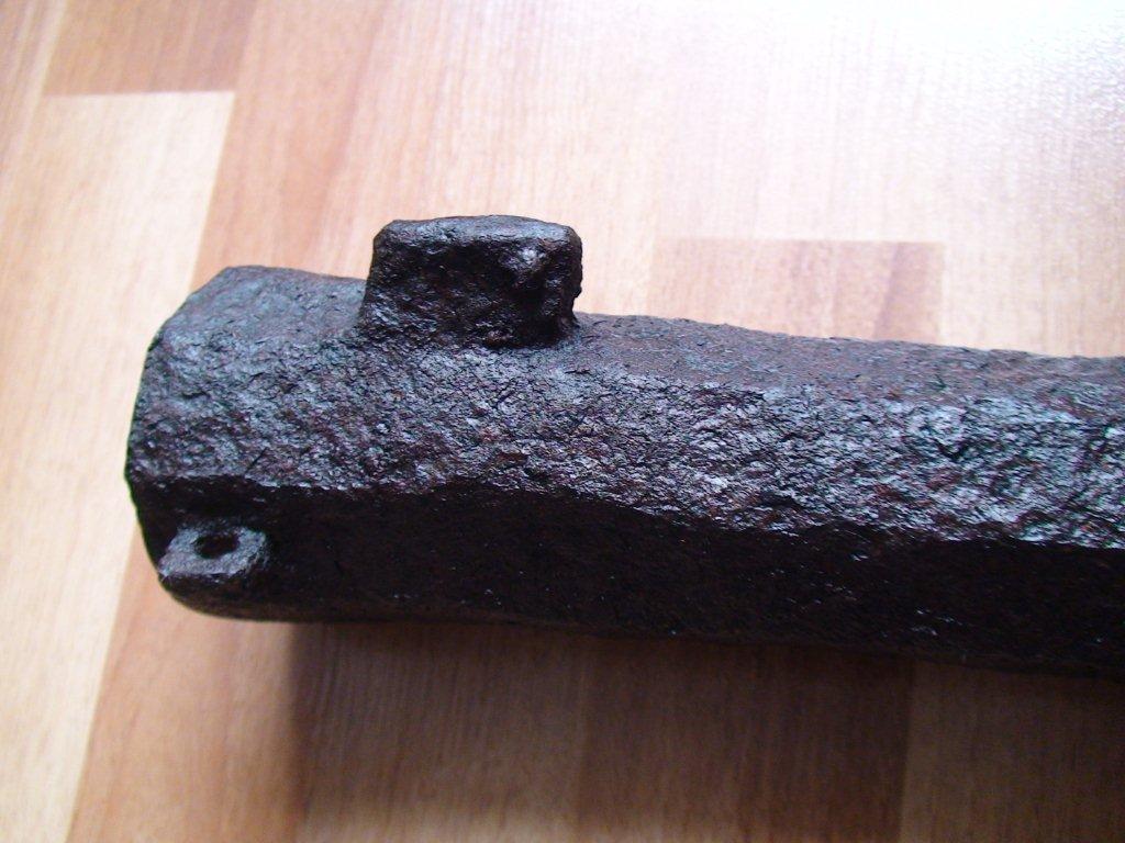

gents,
could it be some kind of ramrod ?
Evgeny_K is offline   Reply With Quote
Old 20th December 2013, 11:58 AM   #23
Evgeny_K
Evgeny_K's Avatar
Join Date: Mar 2011
Posts: 217

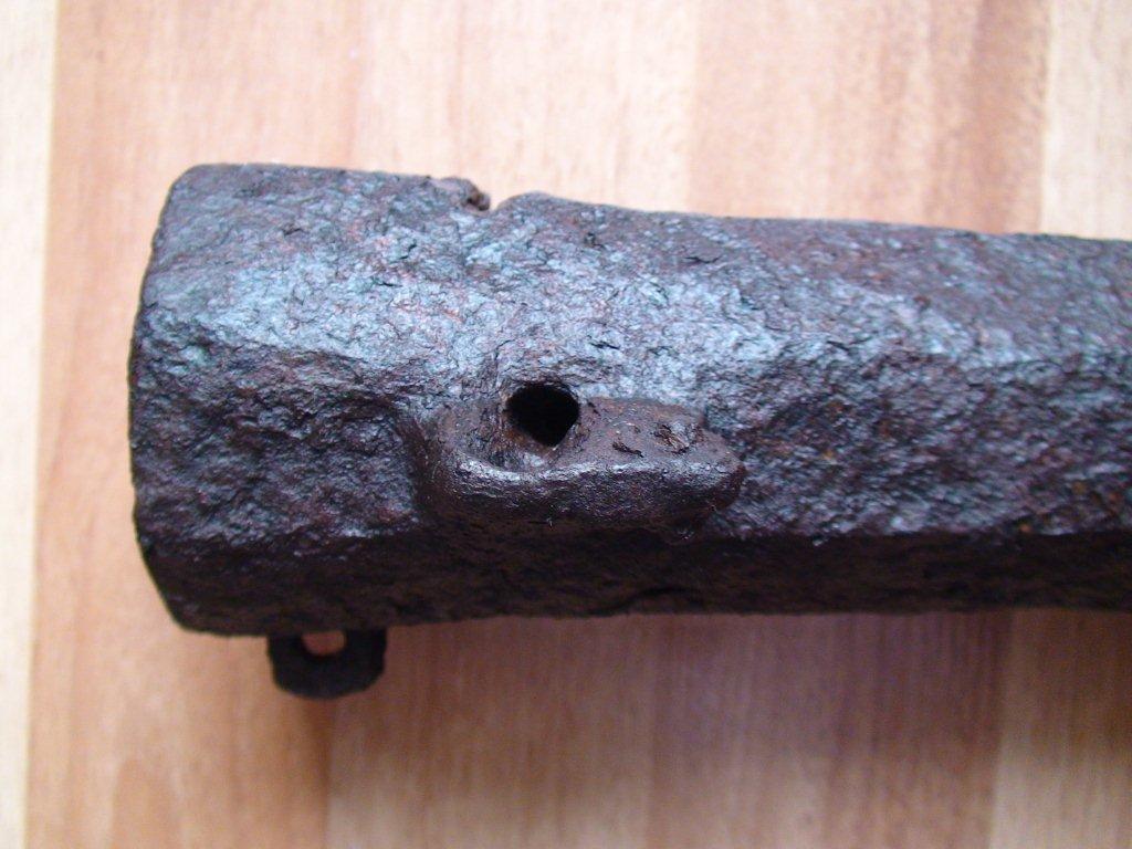

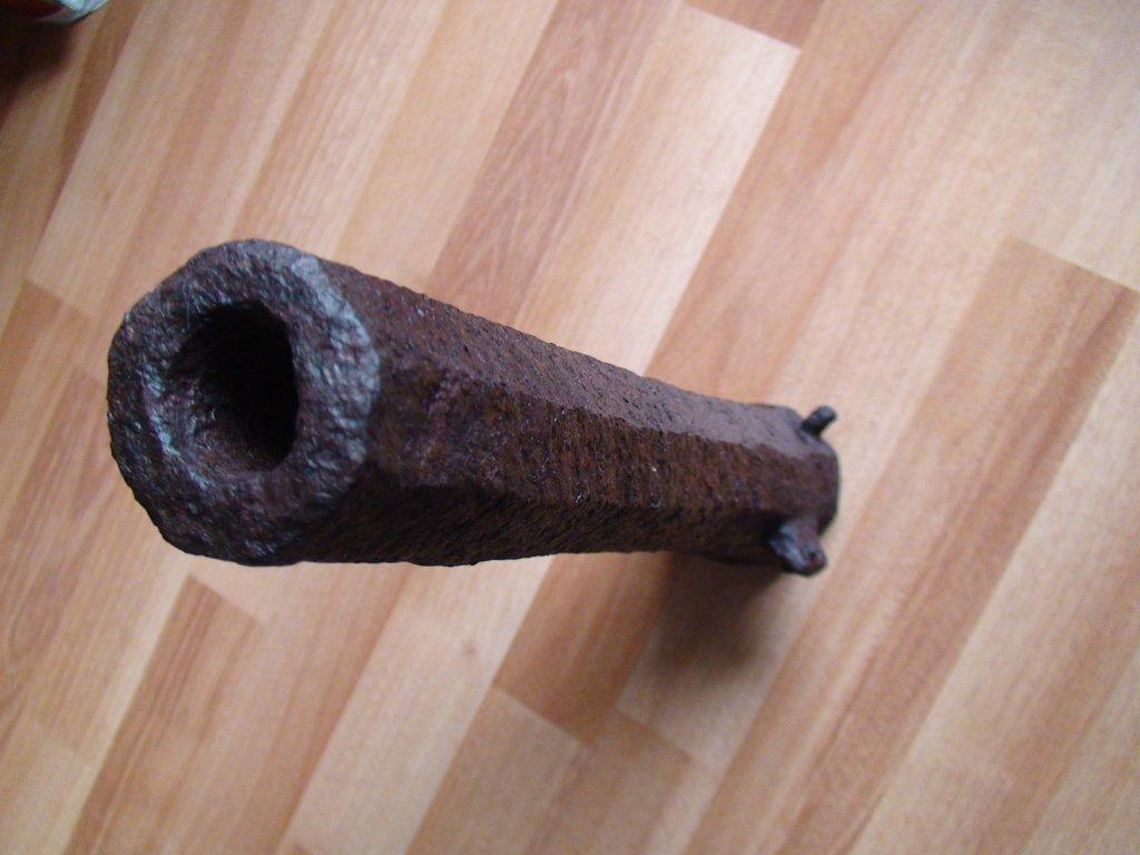

it was found near this handgun in Russia

Hi Evgeny,
Do you have more images of that barrel:
- the backsight
- the rear of the breech
- the form of the pan trough and touchhole
How long is that barrel now and what is its bore/caliber?
I could then tell with adequate authority about how old it really is, which could lead us to a better based identification of what I choose to just call a 'rod' for the time being.
Michael

Hi Michael,
This barrel is not in my posession , so I have not much information.
There are some additional pics.
barrel length 400 mm,
diameter 55 to 70 mm at rear,
caliber ~30 mm,
weight ~ 6.9 kg.
Evgeny

Thanks, Evgeny,
I can see most of what I was hoping I would be able to see.
This is (the possibly shortened rear part of) a wrought-iron arquebus barrel of ca. 1520-40.
The small blade backsight is missing from the breech, and so is the pivoted swiveling pan cover of the ignition pan, as well as the forward section of the barrel with the second loop for a transversal stock pin; the rear loop on the underside of the barrel is still present. We may safely assume that the stock was originally fitted with a snap-tinderlock mechanism.
Attached please find links to my threads on three similar but perfectly preserved arquebuses of ca. 1525, 1540 and dated 1539, all in my collection:
http://www.vikingsword.com/vb/showth...lock+harquebus
Whether that iron 'rod' had any connection with that barrel I doubt very much; both rod ends do not make any sense at all for a loading process. It does not show any similarity to any actual ramrod I have ever seen.
Michael

You are welcome, Evgeny!
I just wanted to add that the mushroom-shaped finial to one end of the iron rod seems to indicate that the piece is more or less contemporary with the barrel.
Sometimes you find that characteristic shape on finials of the grips of Gothic maces.
Michael
