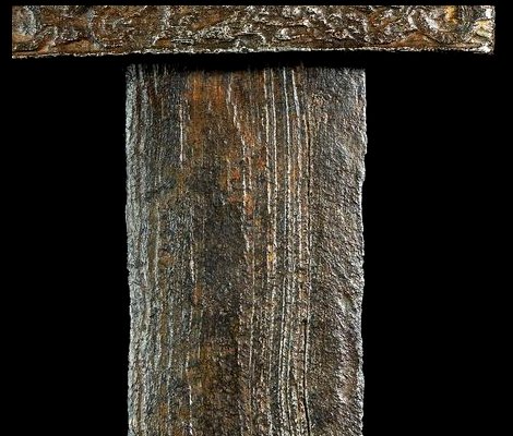

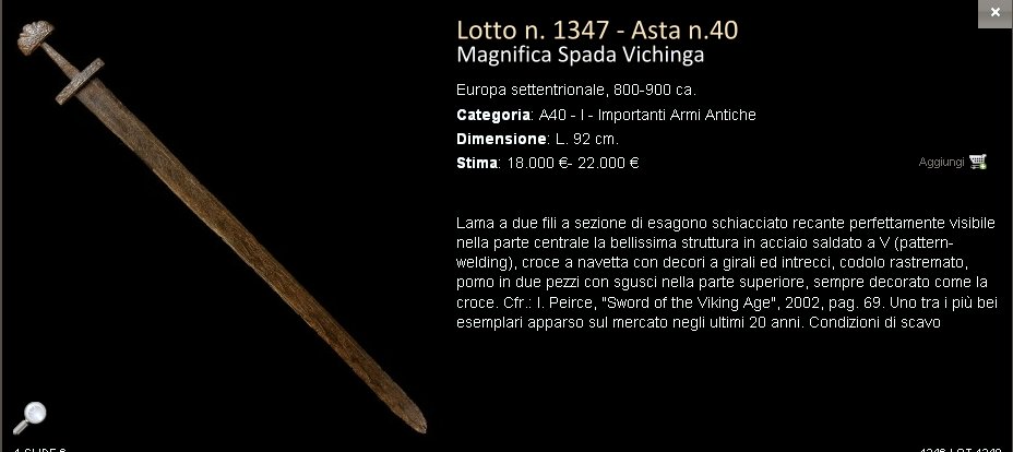

Default A Beautiful Vikingsword, 9th Century!

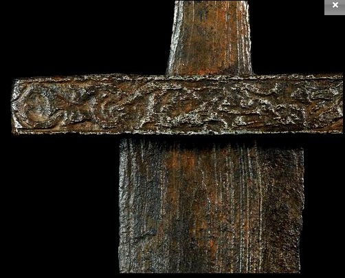

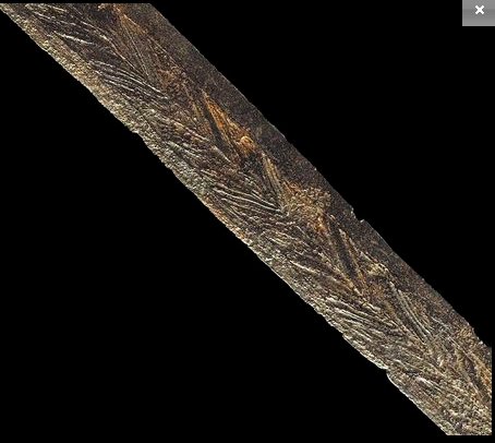

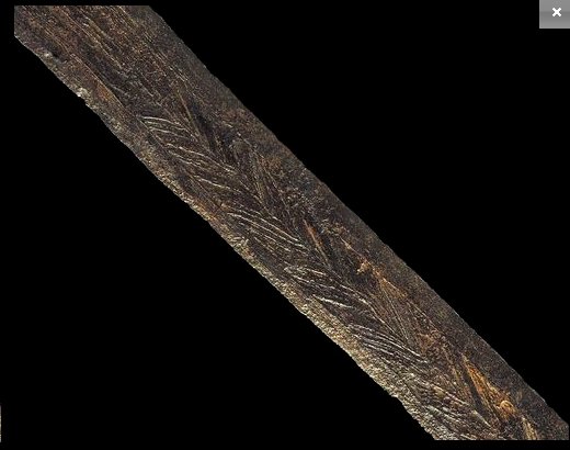

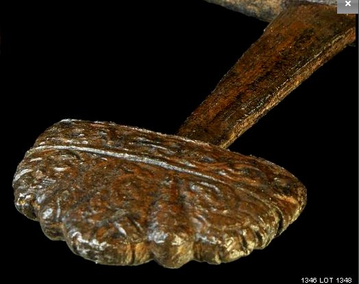

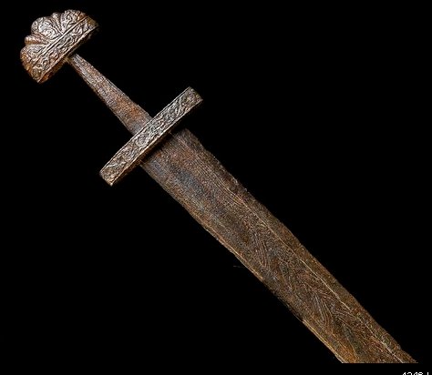

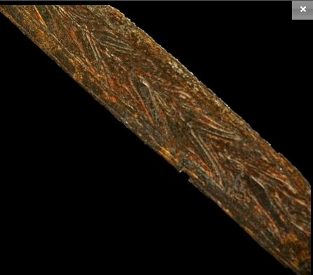

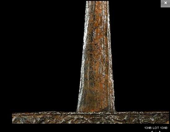

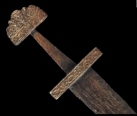

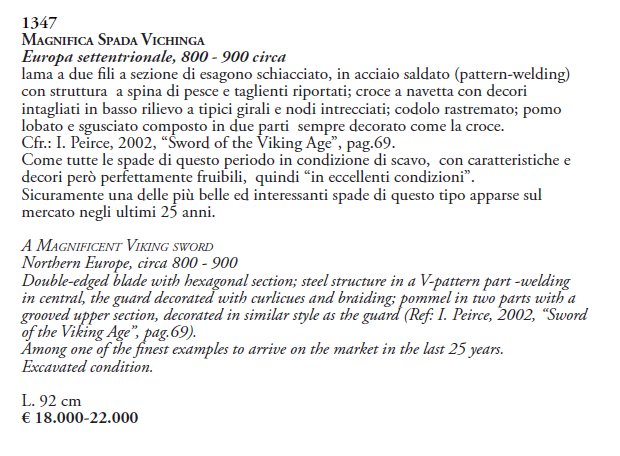

This was estimated 18,000 - 22,000 euro but failed to sell at auction with von Morenberg, Trento/Italy, 20 June 2010.
Overall length 92 cm.

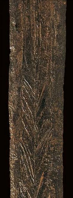

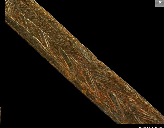

Please note the fine fishbone decoration on the upper section of the blade!

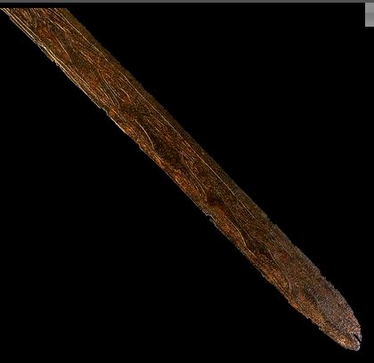

Old 27th January 2011, 05:21 PM   #2
Matchlock
Matchlock's Avatar
Join Date: Sep 2008
Posts: 4,310

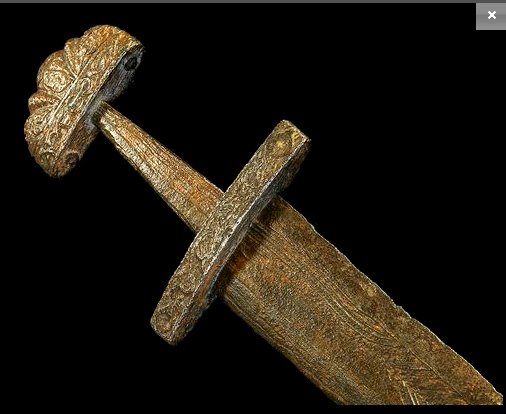

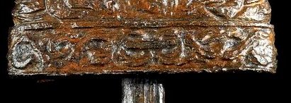

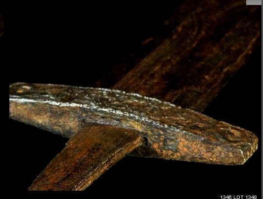

The rest of the details.

I think this sword did not sell for a good reason, and that it would not make an ideal logo because it is not a Viking sword. The patterns on the blade are all wrong, and the decoration of the pommel is suspect at best - a very nice fake, though.

similar pommel/cross patterns are published by Glosek, and this blade pattern I saw last year or 2009 on a viking blade at a London auction house.
No I don't think this is a fake.

Jeff is not alone. The medieval sword fakes that are coming out now are so proficiently made that I believe the entire market has been poisoned by suspicions. I have seen examples for which I am not personally confident of authenticity in the very best sales venues including major London sales within the last decade. (I am otherwise unaware of the 2009 sale mentioned by cornelistromp and I am not commenting on that sale or sword). Would be buyers are advised to always attend the preview for close-up examination personally or by qualified proxy...

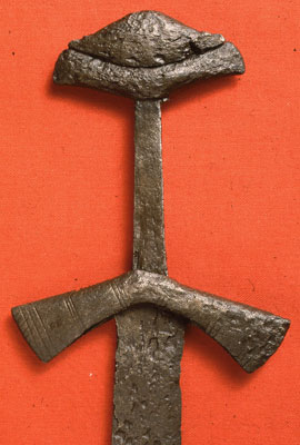

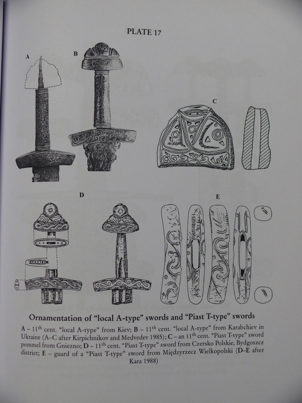

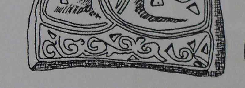

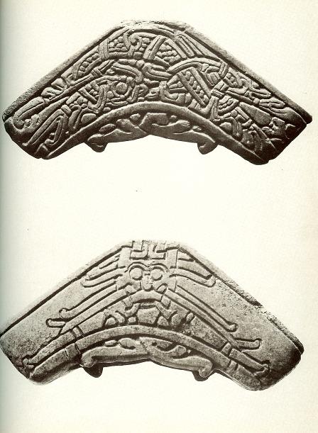

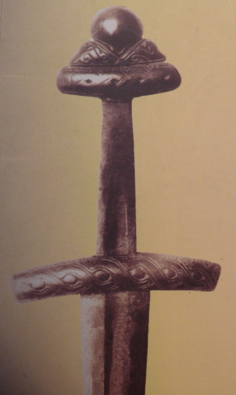

pommel:I found the same decoration/pattern published by Lech marek.
an 11thc piast T-type sword pommel. see picture

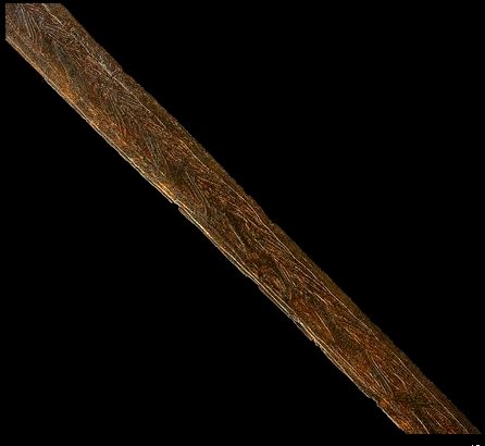

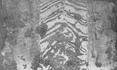

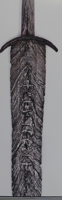

Blade:the blade pattern i thought i saw before was on a sword auctioned by Bonhams 29 april 2010 however it is a kind of... different.see picture

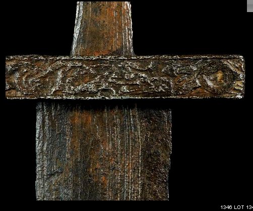

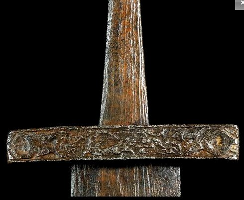

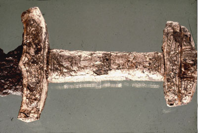

cross:the decoration/pattern on the guard must be something like the sword hilt from Busdorf Germany. see pic.

Yes, the Viking age artisans did decorate their equipment with tendrils and beasts, however on iron hilts (I think we can conclude the hilt is iron from the photo) decoration of this style was done via inlay, not carving. So we don’t even have to get into how the carving might be off, it shouldn’t be there to begin with, I can’t recall a single example from the era.
Unfortunately, referencing another unprovenanced auction sword does not bolster the authenticity of the one in question, though these two are similar enough to make each other look bad. It does not look like the usual chevron pattern created in the Viking period, and it looks a lot like modern attempts to replicate the technique, with what appears to be the chevrons pointing in opposite directions on either side of the blade (indicating much more simple construction than most old blades) …and I’ve never seen an authentic blade with the chevron angle so stretched out. Attached is a photo of a more ‘normal’ chevron angle.
The Bonham sword is even more nonsensical; for fundamental, functional reasons swords were made with the coarse, patterned material in the middle & had edges of very clean metal, going all the way back to Celtic times. And Leutlrit did not make his swords from pattern-welded material, so tis odd that they would reference his swords in the lot description.
Hi Jeff,
that you have never seen it means nothing, Unless you have seen them all! (famous Oakeshott quote)
(it does not mean in any case that it has never existed on Viking swordblades.)

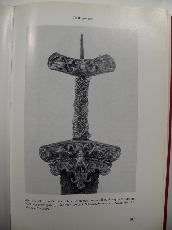

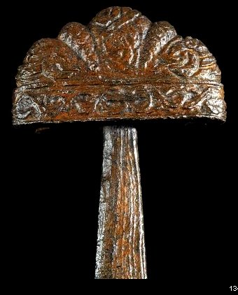

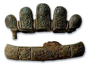

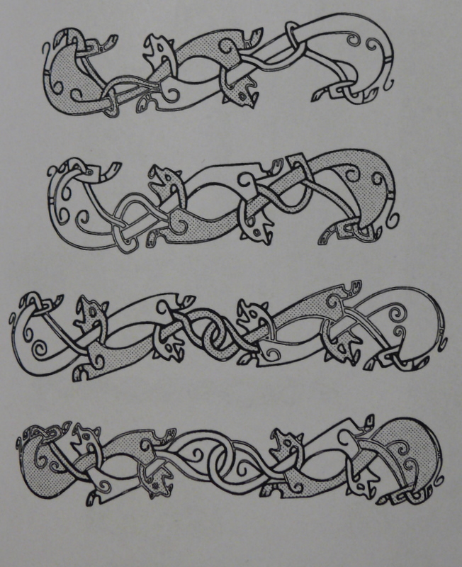

attached some carved viking hilt parts;
This elaborate Viking sword hilt was found on the Isle of Man by two gentlemen with a metal detector. Here's how 24-Hour Museum describes the pommel (top part):
Rather like a set of knuckles, the pommel (the top part of the sword) design is divided into 5 parts, or lobes, each with intricately carved designs. In between the lobes are sets of finely twisted silver wires – a technique seen a few times on artefacts from the Isle.

My own experience in examining a number of Viking Age swords is very much in concordance with Jeff's observations.
That 'stretched chevron' pattern is, indeed, unexpected in Viking Age material; I have had this nagging déjà vu that I had seen somewhat similar patterns somewhere in pre-Viking material and at last I have placed this memory with the Danish/N. German Roman Iron Age bog finds and confirmed it by reviewing the marvelous recently published (2006) catalog of the Illerup Ådal finds.

Are the upper and lower guards you show made of Iron?
From all appearances, they seem to be non-ferrous metal, as they show little sign of corrosion.
Jeff was speaking of iron hilts being decorated with inlay/overlay, and was not speaking of non-ferrous hilts as it is well known that such hilts often have designs cut/cast into them.
Some iron hilts Do show Light engraving, where they had originally a non-ferrous overlay, (Silver or whatever) then a design cut Through the overlay, into the iron beneath, to show contrast.
Such engraving appears lightly done, compared to the heavy designs on the non-ferrous hilts.

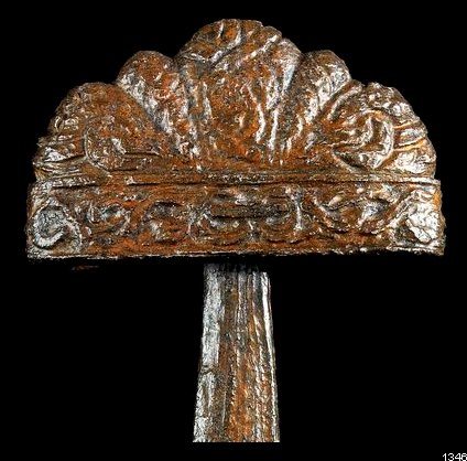

re:carving in iron in high relief.
In the national museum in Helsinki are (plenty) viking Hilt examples of iron carving in high relief.
what we know and have seen in viking swords is only "the top of the iceberg" there must have been 100's of thousands of swords.
Unfortunately there are only a few % remaining for study, which are obviously far from representative of what was common in forging /patterns and of what was common in the use of certain type of decorations.

It is true we have only a tiny percentage of the era’s product to admire! The artisans of the Viking age were subject to the same limitations of technology, whims of fashion and economic restrictions as the rest of us, so you can make some pretty concrete predictions about the 99% of swords we have NOT seen from the time. Just as you will not find a Viking sword with an aluminum hilt (technology not available), you can be pretty sure an iron one with relief interlace carving is not going to show up – although technologically feasible, it was not the fashion of the time or what the economics of the situation would favor, inferring from the ones that have survived.
A few Finnish examples of Viking age swords can be found here:
http://www.helsinki.fi/arkeologia/ra...t_viikinki.htm
Though the photos are woefully small, you can see they were using the same techniques as the folks further South to render designs in a slightly different style.

you are indeed right iron ones in high relief are very difficult to find, I have seen them so please give me some time to find them
the pattern of the blade I did find, it it closer then expected ,it was in Peirce p25. see pics, also a picture of the Scandinavian hilts I mentioned before.
