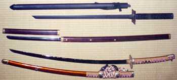

Hi All,
Found another weird sword, and I'm wondering how real it is.
The sword I'm posting below is claimed to be a special "ninja" weapon invented by the Saito family in Medieval Japan, and possibly of supernatural origin (see link to picture and story).
I'm talking about the middle sword in the picture. It's a "backwards" katana: 2/3 handle, 1/3 blade, and the blade is double-edged. It is used differently than a katana (search for "tengu sword" on Youtube). The one shown is obviously is a modern model.
A school teaching the use of this weapon exists, but some martial artists believe that the system is modern, and that the "tengu sword" is based on the knives used to harvest cane and pineapple in Hawaii--cane knives and machetes, in other words.
My question to the board is: has anyone ever seen a genuine, historical Japanese (or other) sword that looks like this? If you think it's modern like the "ninjato" above it, what do you think it was based on? It doesn't look like a cane knife or machete to me.

I can't speak to the tengu sword (Looks like a bad, bent naganata), but the "ninja" sword is a modern fiction. There is no credible historical evidence of such swords in Japan. They are basically a modern Hollywood invention - pure fiction. I suspect the same for the tengu sword.

Hi Rich,
That much I know, and I'm not arguing that the ninja-to is a genuine historical design, used by real ninja.
As for the tengu sword, it's weird enough that I figured I would ask. It's certainly an original design, and it hasn't been commercialized the way the ninja-to has.
Assuming it's modern leads to a fun question: why create an anachronistic weapon that's only used in a few martial arts schools in Hawaii, California, and Arizona? In California, at least, carrying that sword would be a felony.
The other thing is that Japan does have an extensive history of weird weapons, and people do collect them. If the tengu sword has any historical precedents (perhaps a military kama?), I figured someone on the list might know.

The only reverse edged Japanese weapon/tool that I'm aware of is the KUBIKIRI or BOKUWARI. These were basically bonsai or gardening tools (although lots of fancy tales about them). I've only personally seen them in tanto size although I did see a pic of one on a sales site years ago in wakizashi length.
Might want to look at my page on unusual tanto for a kubikiri pic.

One question: do you know of any two-edged, curved tantos? That's what this tengu sword has: it has a two-edged blade, but the tip is (roughly) chisel-tipped like a conventional Japanese blade, except that it's rounded for slashing. I'm not an expert on Japanese blades, and I don't know of any Japanese blades with this shape.

Yes, I've seen double edged curved tanto (don't recall the name of the style off hand). But I've not seen any swords with a rounded kissaki (point) like that in the picture.

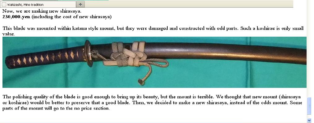

An old thread I know, and possibly superseded, but I came across this item on Usagiya and thought hmmm!
Old 19th December 2012, 04:00 PM   #16
fearn
Posts: 1,247
Could be. Is it terrible in the sense of ugly, or terrible in the sense of unusable? If it's ugly but quite functional, that's possibly an indicator.
Thanks for pointing this out.
F
Old 19th December 2012, 04:57 PM   #17
David R
David R's Avatar
Join Date: Jan 2011
Posts: 1,148
What I think is intriguing is that the blade fits the saya.....I have two wakizashi in original saya and 3 spare saya and none of them are interchangeable.
I can think of other reasons for this set up, poverty, aspiration or simply making an item more saleable, but it is interesting all the same in the light of the above.
