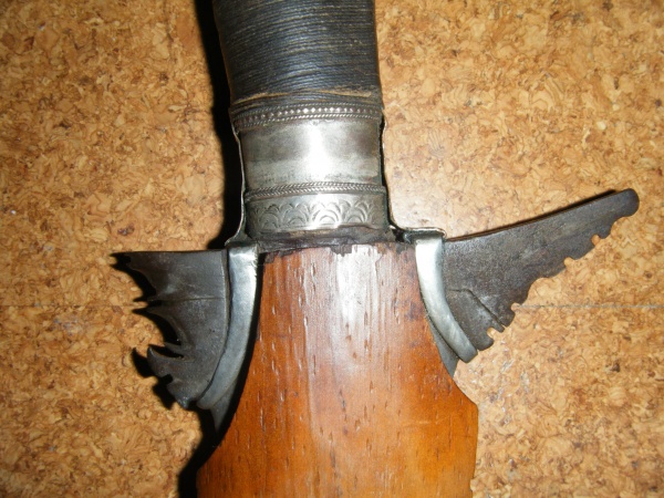

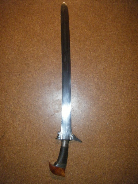

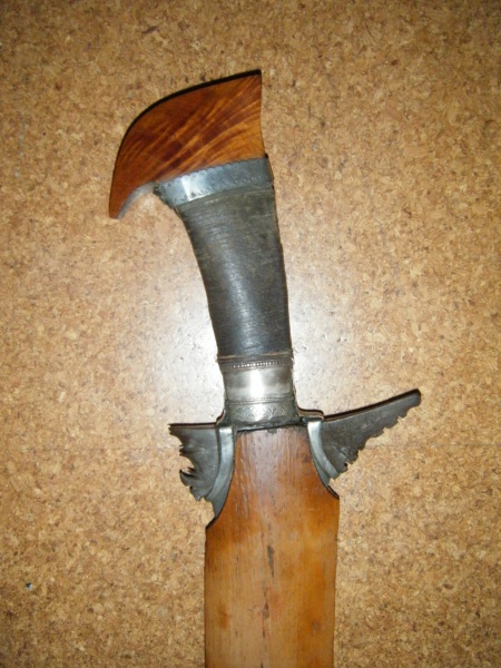

Yesterday I received the kris and I was enjoyable surprised. The handle fittings seem to be from silver plated brass and the asang-asang from silver (not tested until now). The sheath is from very soft wood but is in good condition. I have cleaned all, the blade I start to polish to be able to etch it the next days.
Here some fast taken pictures by lamplight so please excuse the quality.

Posts: 7,403
Congratulations! Silver plate was common among the Maguindanao and Maranao.
Cleaned up nicely. Can't wait to see the laminations in the blade.

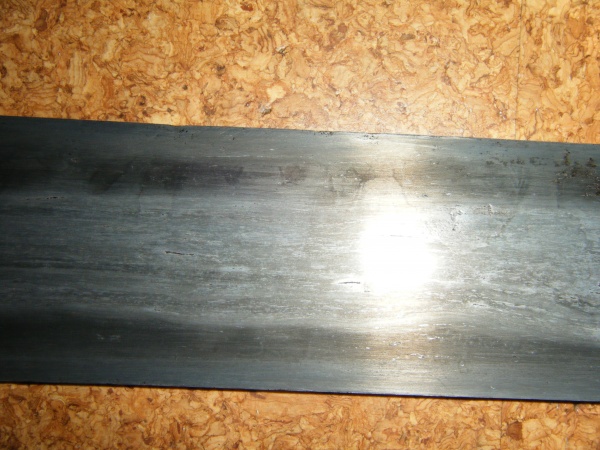

Old 19th November 2010, 12:57 AM   #12
Hello Kai,
thank you for your usual informed comment. The length is 57 cm (22.4 inch). I am not sure that the crest got broken off formerly, I think I have seen this form before but I may be wrong.

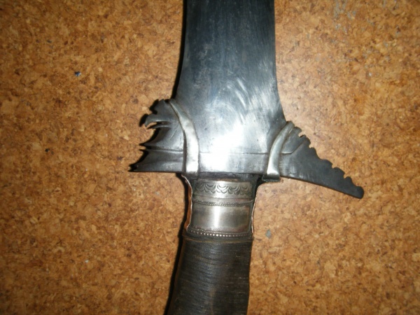

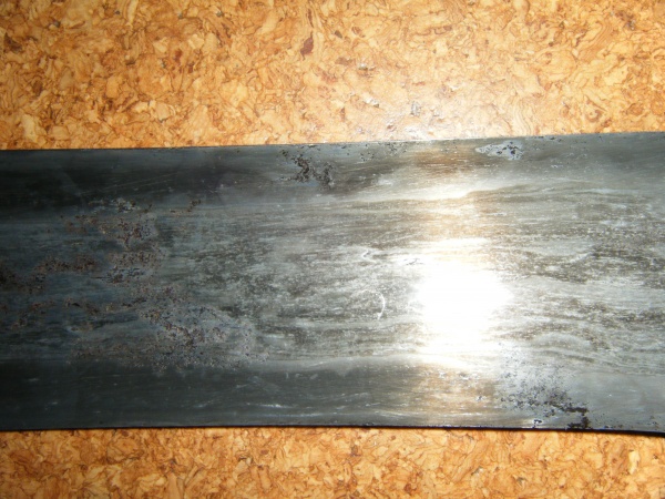

The blade wasn't clean down from the hilt at the gangya area but it was done this evening and I have etched the blade. The reaction was very fast and you can see the result by the attached images.
In the moment I am afraid to open the hilt because I am not used with this technic, maybe later when I am trained by this.
Please let all know me what you think about the result, was the etch to strong?
Old 19th November 2010, 03:11 AM   #13
Posts: 7,403
Interesting and subtle laminations...........
I am very surprised by the very fast reaction and strong contrast since I have had by my other kris blades no reaction or a very low contrast.

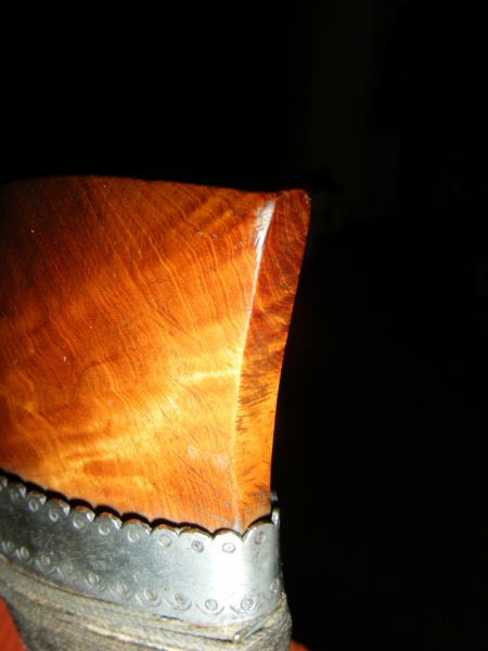

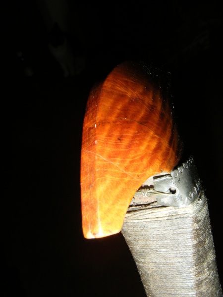

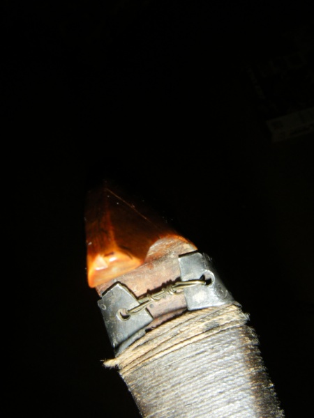

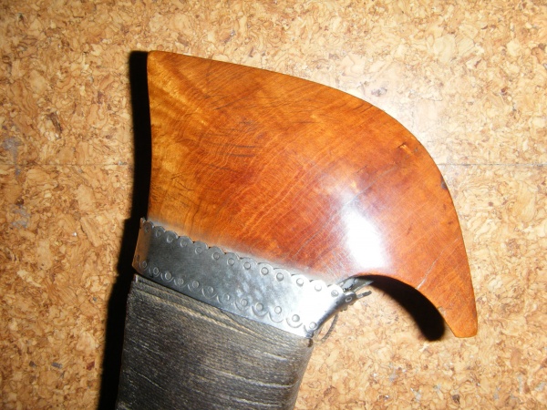

Here some close-up's to get a imagination of the pommel's shape. Hope it helps.
Old 19th November 2010, 08:48 PM   #17
Posts: 7,297
It looks to me that it might have been recarved after a breakage. I know the type of kakatua you are referring to that has a similar profile that seem to have popped up in early 20th pieces, but i don't think this is one of them.

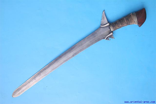

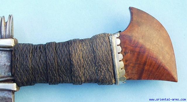

Yes David, I think we have the same type of kakatua in mind. Here is a example I found by Oriental-Arms.

Old 19th November 2010, 09:16 PM   #19
Posts: 7,403
Hard to tell, but I think this could be original. I have had ones similar to this. (Thus I would leave the pommel alone)

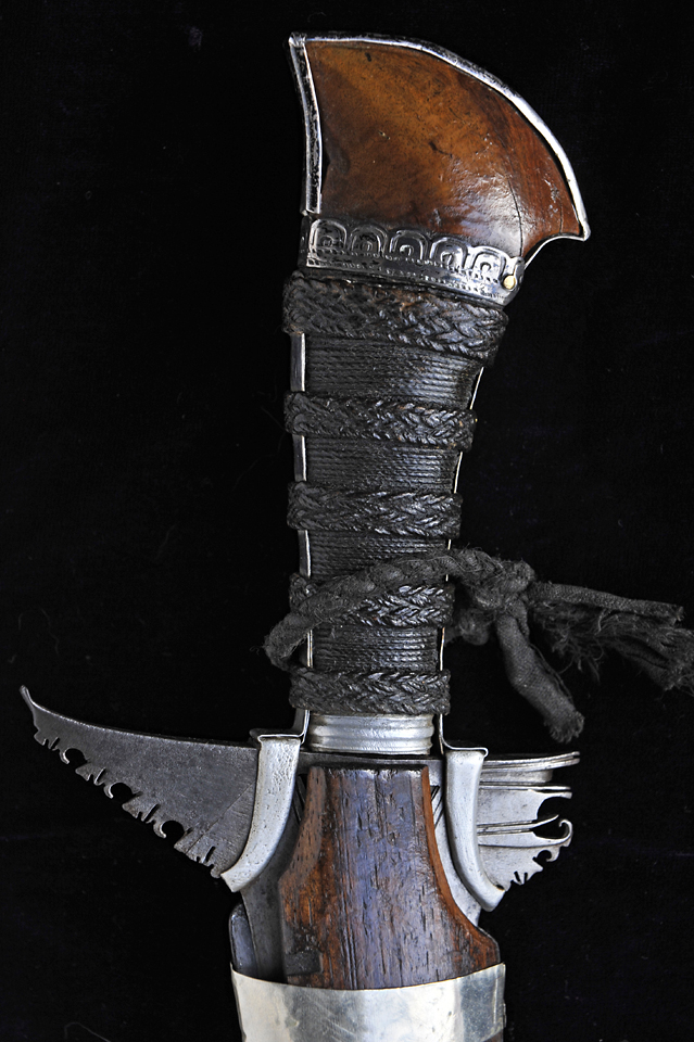

Below is one Maguindanao one that I had and restored (only picture of it is on Federico's site) with silver around the top:

HEY! That kris is in MY collection these days!!!

The last light of the afternoon was just fading, but i had enough time to get this quick shot if it helps.

Yep that's the one! Glad you have it - it was one of my early pieces and after restoration I sold it.
Notice the pommel - same profile.
Again congratulations David - I kind of miss that one (even used it in an escrima demonstration once! ).

Here a second example of the same pommel style from Oriental-Arms.
Old 20th November 2010, 03:30 PM   #28
Posts: 7,403
Yes that is why I with Rick say to leave the pommel alone - it appears to be a Maguindanao style.

Examples of this pommel style which were obviously original never show a distinct beak (i. e. both, beak and crest, heavily stylized). Since Detlef's examples has a distinct beak and also the flow of lines where the crest could have been seems to be unusual, I'd guess that the original pommel got recarved a long time ago.

Well that's my thought as well Kai. To me Sajen's pommel looks unbalanced while these other examples do not. So i vote that it broke some time ago and was recarved. Still i would also agree with the others to leave the pommel as is. Recarved or not it is what it is and i wouldn't attempt to change anything.
