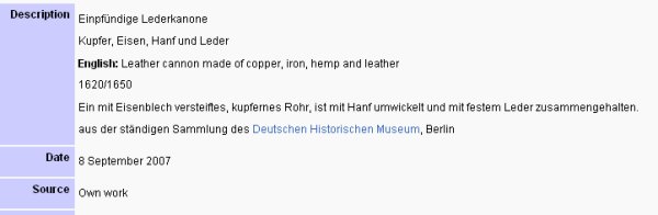

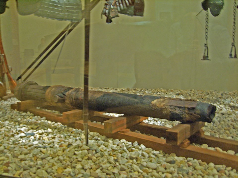

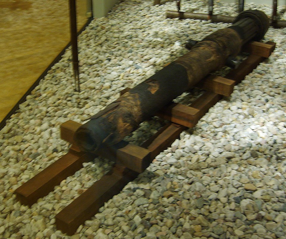

Attached please find pics and description of a so called 'leather' cannon, ca. 1620's, preserved in the Historisches Museum Berlin.
As David pointed out the barrel actually is of copper reinforced by iron, covered with strong (elk?) leather and bound with hemp, so it's not just all leather ...
I learned they have two pieces, their lengths being ca. 2 m and the caliber a one pounder and the other a one-and-a-half pounder.

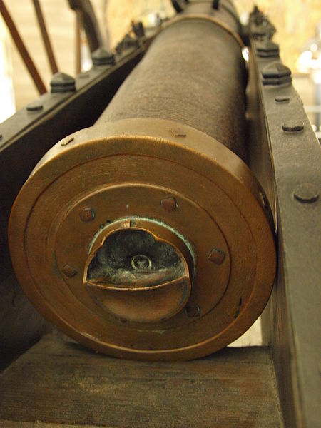

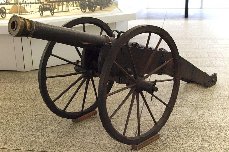

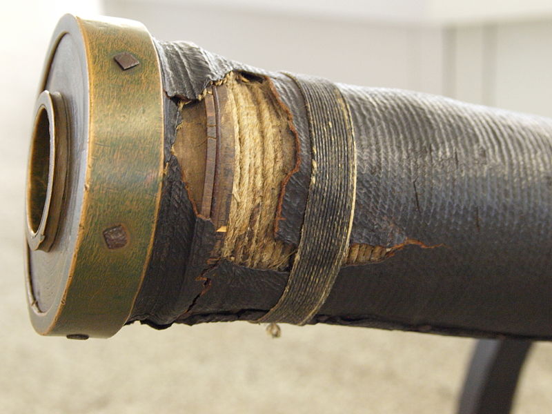

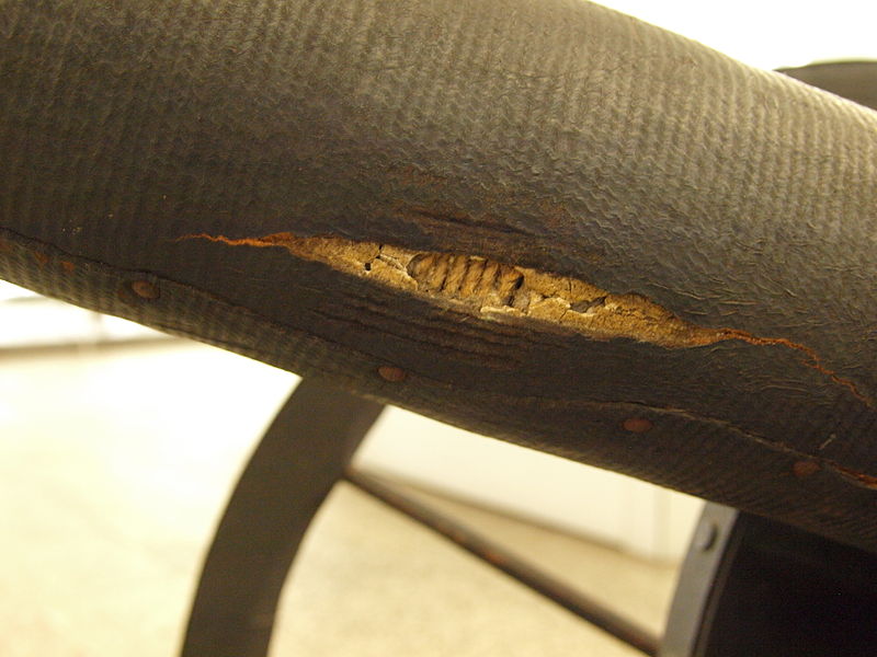

Here are some photos of a called leather cannon which I took during my last visit to Germanisches Nationalmuseum Nuremberg, Germany.
Leather Canon calibre 37 mm on a lafette bearing the coat of arms of Paris of Lodron, 1619-1653 archbishop of Salzburg. Germanisches Nationalmuseum Nürnberg Inventory Number W 614. Barrel made of a thin copper tube, reinforced with hemp ropes, wood, leather and iron. Carriage made of wood and iron.
You will find the full resolution images on Wikipedia-Commons
https://commons.wikimedia.org/wiki/F...mberg_W614.jpg
