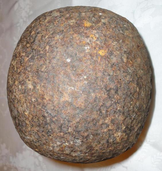

Default Ever heard of a cannononball .. ovoid?
This item lacks the basic condition for a ball, as it is not round ... but ovoid.
However the (non professional) seller guaranteed this is surely a cannonball, kept by the family for a long time and having been found in a place where actually plenty war confrontations took place, both internal and Napoleonic.
The weight and average diameter coincide with an 18 pounder.
Byt i don't think this thing could be fired as it is; neither its deformation could be achieved by rolling on the ground after being shot ... it wouldn't become so perfectly ovoid.

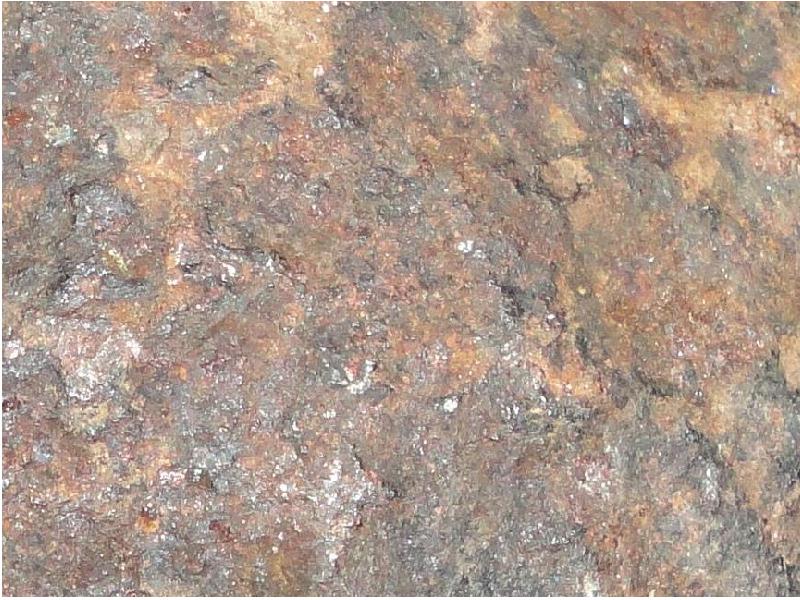

On the other hand, its texture looks exactky like that of a 18th or 19th century cannonball.
What do you gentlemen think of this?
Ever seen one like that?

I am afraid I've never seen or come across a cannonball of such unique shape - ovoidal!
What practical sense could it possibly have made?
Fitting and rotating in a cannon barrel? No way, I would say.
The only use I can think of would be throwing it from a catapult but then we would have to seek its "date of birth" in the 14th and 15th centuries.
Highly interesting piece anyway and one of the unsolved riddles in historic weaponry ...
Thank you for sharing this, and I do hope for some brainstorming from our members!

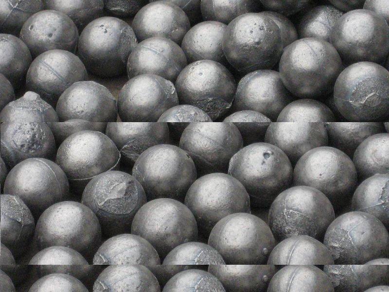

my first impression of the faceted surface was it was a worn ball mill ball....

I had already been in that link website during my browsing, Wayne.
It appears to me that this is not likely to be a mill ball.
Those spheres are usuallly hardened steel, whereas my example is iron.
I have phoned a cement maker technician; the wearing of mill balls has a smooth texture.
Also i think that a mill ball, worn by continuous random tumbling, would get a alietory shape due to its variable movimentation and not such a regular one, which looks to have been submited to a specific rotation, orientated in a linear direction.
I know nothing about metalurgy either, but probably a steel mill ball woud not degradate through time in the same manner, with such corrugated and scaled look.

The shape of this ball could also be a result of poor casting.

In support of the above comment, I have a cannonball recovered off private land at the site of the Battle of San Pasqual, and it too is deformed.
It is not nearly as big as the one above, at a little under 3 inches... possibly used by the Sutter Gun, a provincial small 4-pounder. Shot produced in frontier California tended to be of a lessor quality than what the Dragoons likely would have brought as part of their ordinance.
Anyway, as shown from two perspectives orthogonal to one another - you can see it is still (more or less) "in the round" when viewed from the top-down, but when viewed from the side, well, it's kind of ovoid...

Darn, Kronck beat me to the point about the shot tower. I'd also point out that a heated cannon ball, if it was hot enough to deform that much, also wouldn't have an elongated oval shape. It would get flattened by the power of the explosion behind it. More to the point, if it was soft enough to deform that much, it would probably weld itself to the inside of the gun and cause the gun to explode when fired.
I keep looking at the dented surface of the thing. I suppose that could be corrosion that was cleaned off, but I keep thinking that some poor blacksmith got the job of trying to hammer a sub-par cannonball (or a too-big cannonball) into a diameter narrow enough for them to use it with the gun they had. It could also have been a really ugly cannonball that was discarded as too crappy/dangerous to fire.
After all, we've been assuming that it was fired, and I don't see that anyone has presented evidence to support this idea.

How would i guess that the posting of my atypical ball would result in such a treatise on cannonballs.
Hot shot and shot towers would certainly never dream of making part of my vocabulary!
I finally located some data on the use of hot shot in old Portuguese (and Brazilian) coast forts. It was a question of having not browsed with the right term; here they call it bala ardente (burning bullet).
Considering Fearn's reasonable suggestion that this ball was not even fired, having been discarded due to its faulty construction, one question arises: why then wasn't it discarded right after casting inspection, instead of going to take a risky chance to be used in campaign?

I was thinking of a field modification: what do you do when the cannonball is too big for your cannon, and you really need to fire that projectile? "You men, take these hammers and chisels....followed hours later by colorful invectives and a "that didn't work!" Then you leave your failure on the battlefield, to mess with the minds of those who come after you.
Anyway, I was reading a little about hot shot, and the one thing I'm pretty sure about is that they weren't heating the balls enough to deform them. It's hard to do that without a formed air draft and a much hotter fire than they describe.

You will forgive me Fearn but, resizing cannonballs on the battlefield, sounds pretty fictional to me, even assuming the artillery officer had flour in his head, instead of brains.
Even if the issue were to adjust only one ball, which seems rather insolit, it would have to be a sculptor's work, to reshape the thing with the necessary profile ... not a task for rank and file .
More plausibly i would accept this is not an actual cannonball.
