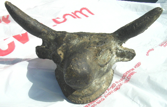

Posts: 273
Thanks for all the information. Here is a photo of the little fellow I am talking about. He came from Yemen and has been handled a lot for the last 35 years so some of the patina has worn off, especially on the nose were bits of the copper alloy are showing through.
