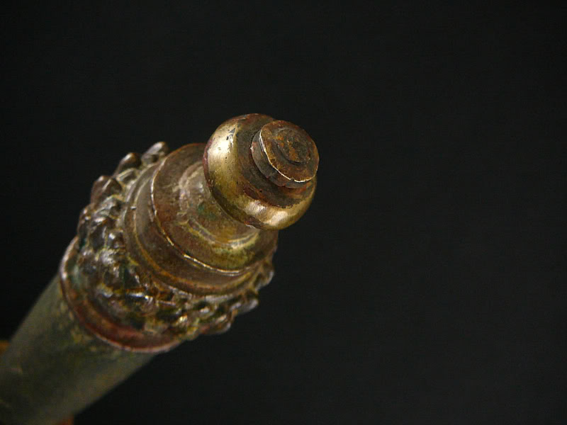

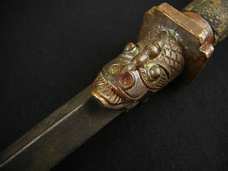

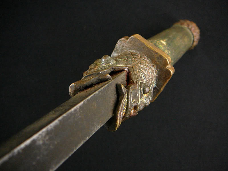

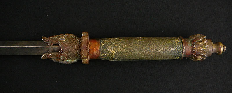

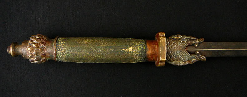

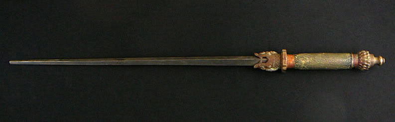

I just acquired this on eBay, and it looks genuine. I have never seen one so nice.
Josh

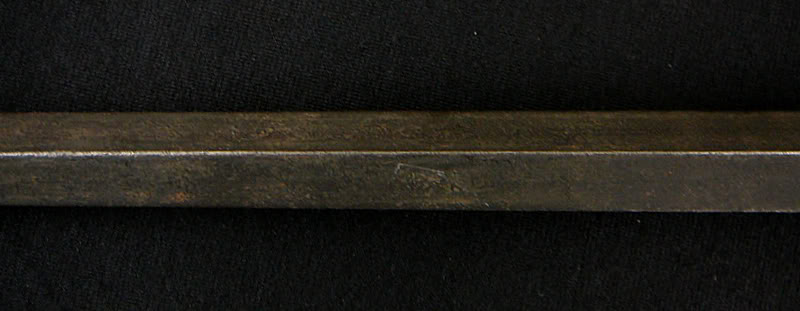

I'd be very curious to see, more clearly, what look like inscriptions on the blade. I get a Thai vibe from it, but I've got a friend who's deeply into collecting Thai weapons, so I might just be hallucinating.

I use the term “sword breaker” as a term for its function. Technically this is a jian, with a different inflection than “jian” the two edged sword. Jian have a square cross section. Other terms are “bian” or an “iron whip”, which seems to refer to round cross sectioned sword breakers, and “taiji” or iron ruler for rectangular ruler like weapons, often with Chinese inch marks.
I am worried because my Chinese friends say it is a fake. I am hoping they are wrong, but usually they are correct.
A South East Asian origin is an interesting hypothesis. I don’t see anything that is clearly not Chinese, but then again Chinese sword breakers are almost never that ornate. It may be why my friends are doubtful. Often Chinese influenced things from the SEA region will be more ornate than originals. I will see if there is any way to tell when I get it. I don’t think there are any inscriptions.
There was a time when the Chinese liked fake antiques to look as new as possible. Then there was a time when they were ham handed with fake patinas that you could spot from a mile away. Now they seem to have learned the art of carful distressing and aging of materials in a way that is making it tough to evaluate authenticity. The trickiest examples are often then sold through some of the less careful Western dealers.
Josh

Hi Josh,
I like it, but saying that I wouldn't have bought it based on a few aspects.
I like the taper to the shaft and the way the dragon mouth opens around it, I even like some of the patina seen in the mouth.

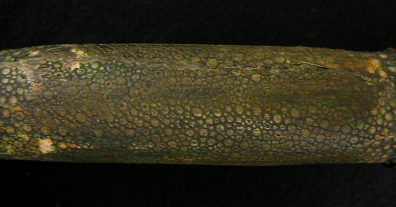

My personal views, I don't like to differing patina or the colour of the patina to the fittings, this appears both incorrect and artifically aged to me. I have troubles with the colour and poor 'rolled' application of the grip covering and I personally would have expected it to have binding to the hilt, sure it could have been lost but there is no evidence of it ever being and the condition also says that it should still be there.
Over all it is an attractive piece and I look forward to hearing from those more knowledgable.

It is a certainly a fake. I just saw a set of two that are the same construction.

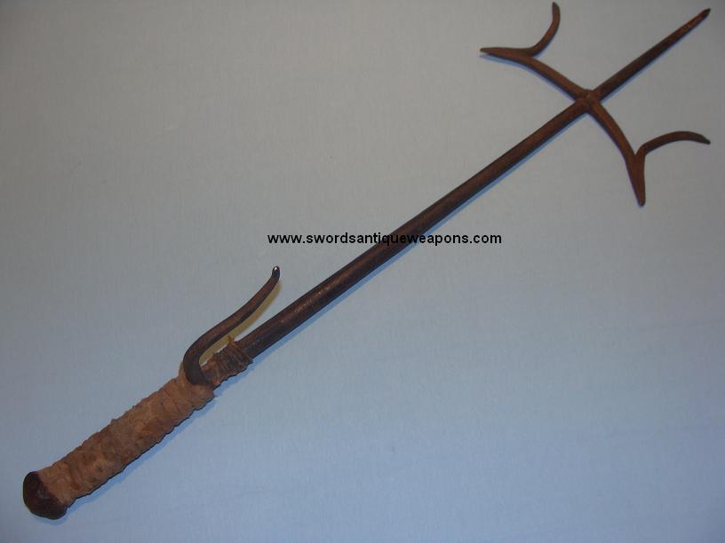

....but I also have reservations about the functionallity of this type of sword breaker. My main concern is the lack of a guard ......a blade could easily slide down the 'spike' striking the hand of the wielder (the dragon's mouth/ small square guard provides very little protection from this).
I understand that Sai , with their 'upturned' guard could also 'capture' the blade. Why, would a sword breaker not have this simple addition which would make it much more effective and 'safer' for the user.

Default a little something like this?
Originally Posted by katana
Sorry too, that this is a fake .....it seems that the Chinese are making 'patina' an art form.
Regards David
David,
Perhaps a little something like this piece?
Gav

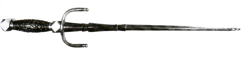

Old 18th July 2010, 02:07 PM   #14
Hi David
You mean something like this?
A sword breaker, also called left hand dagger used in Junks.
This is a Far East specimen, denoting some Portuguese influence.
Dated XVIII/XIX century (Collection Rainer Daehnhardt).
Fernando

Well done Fernando, I got in by a nose. Nice image you present. My personal opinion is that your example presented it more likely 1850-60, just a hunch

I was thinking of the less sophisticated version posted by Fernando. Gav the example you posted suggests that some sword breakers were a 'dedicated' weapon. I had assumed that the Sai 'type' were used like a 'main gauche' with a sword (or similar) held by the other hand. I know in Martial art 'forms' ....the Sai is used on its own or in pairs......but I cannot imagine an individual, on a battlefield using two, as his main weapon of choice.

David, they certainly were a 'dedicated' weapon of old and could disable with or without killing. This example probably had the same origins as the 'Sai' that were a farming impliment originally.
The Sai, I could see them used in rural setting or as a secondry defense in pairs by perhaps an enforcment official or similar but I think in the battle field the sword and shield or long pole weapons where the first choice.
I like the one Fernando presented, the centre shaft could create more damage to a swords edge, something sword owners hate

Surprisingly, the jian was quite well made and looked almost as good in person as it did in the pictures. The fake patina was well done, though it had a glazed look that was odd. Inside the mouth was redder as apposed to the black I would expect, but looked good. The one telltale was a distinct smell off acid when I put my nose to the dragon's mouth.
Interestingly it was well balanced and felt quite lively. It was longer and lighter than originals while maintaining enough heft to feel effective. It's too bad the originals don't look this nice
Most Chinese sword breakers are quite simple with a multifaceted "nut" forming the guard and the pommel. The guard would only have given minimal protection.
Chinese sai are a very different weapon.
I have two "Chinese sai" (sometimes called "gen") of differing construction. One has a narrower guard about the size and shape of my thumb and forefinger forming the letter C. It is nicely finished with brass fittings making me think it is a more sophisticated form than the village pieces. The other is a village piece with a guard like a shallow omega. The guard is almost twice as large, and made of steel forged around the central rod. It is much heavier than the one with brass fittings. Clearly it was well designed for trapping and breaking.
Both the jian sword breakers and the gen can occasionally be found in sets of two, but singles are more common. They were stand-alone weapons, easy to conceal and carry regularly. I think the breaking function worked best when blocking an edged weapon. I doubt many swords snapped as such but the edge damage would be tremendous. Some of my breakers show nicks where they were hit by an edge. I imagine the apposing blade was not in good shape afterward.
