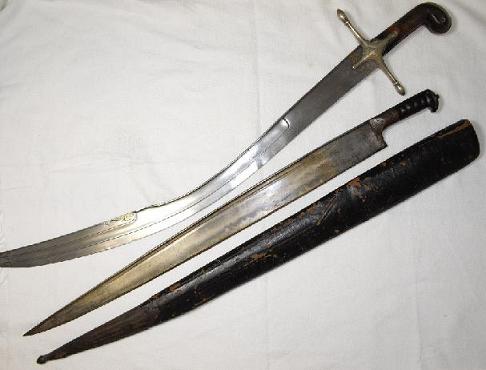

Here we have kinjals from Caucasus, some of them can be really HUGE, still they're counted as "daggers" not as "swords"
If not mistaken, it seems that many of these large 'kindjhal' type weapons are termed 'qama', as cited in both western references as well as the catalog from an Arabian exhibition in Riyadh I have noted (1991). While the term qama is used with daggers, it seems that the term applies equally to the larger sword size (Ive seen them up to over 30" blades) as well as the daggers.
It seems also that a single edged curved bladed example is termed 'bebut'.
