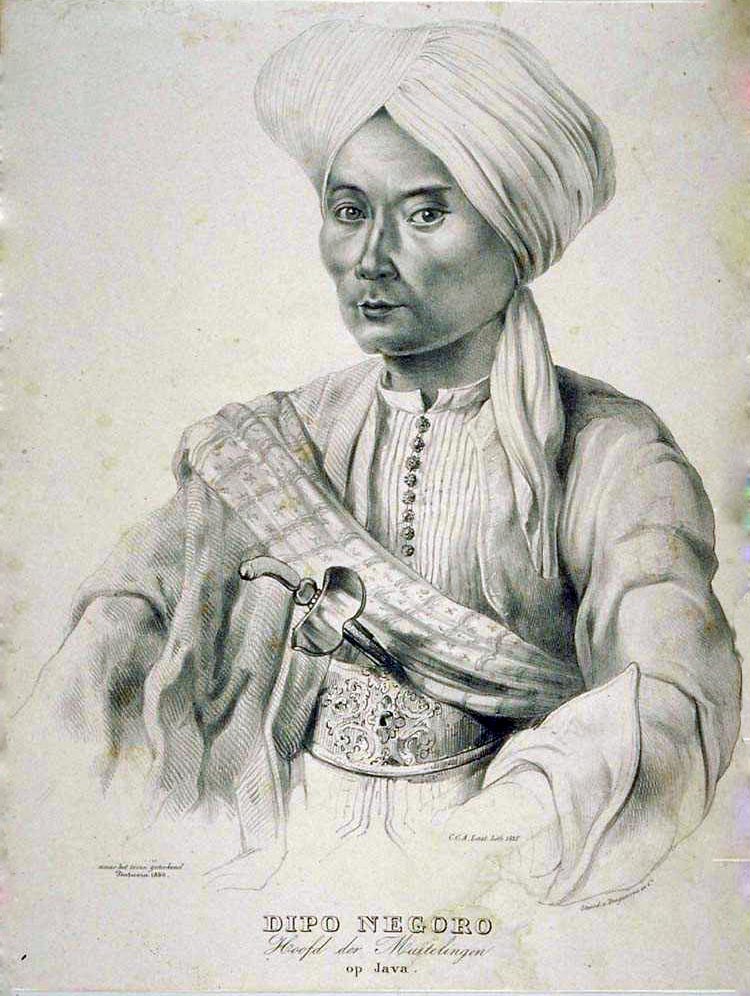

Well, this isn't exactly what you want, but perhaps it will still add to the discussion.
Old 30th December 2011, 05:38 AM   #8
PenangsangII
PenangsangII's Avatar
Join Date: Jun 2007
Posts: 401
Thanks David. This portrait might be an artist impression of what Pangeran Diponegoro looked like, or dressed like.

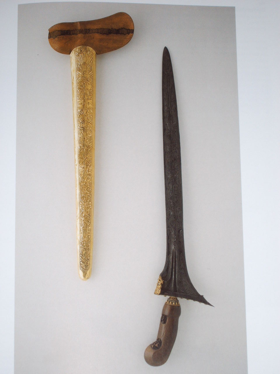

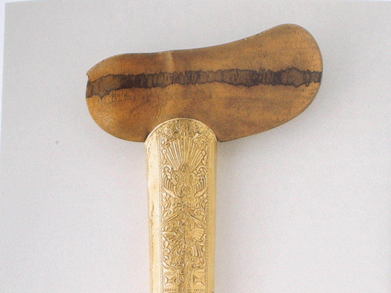

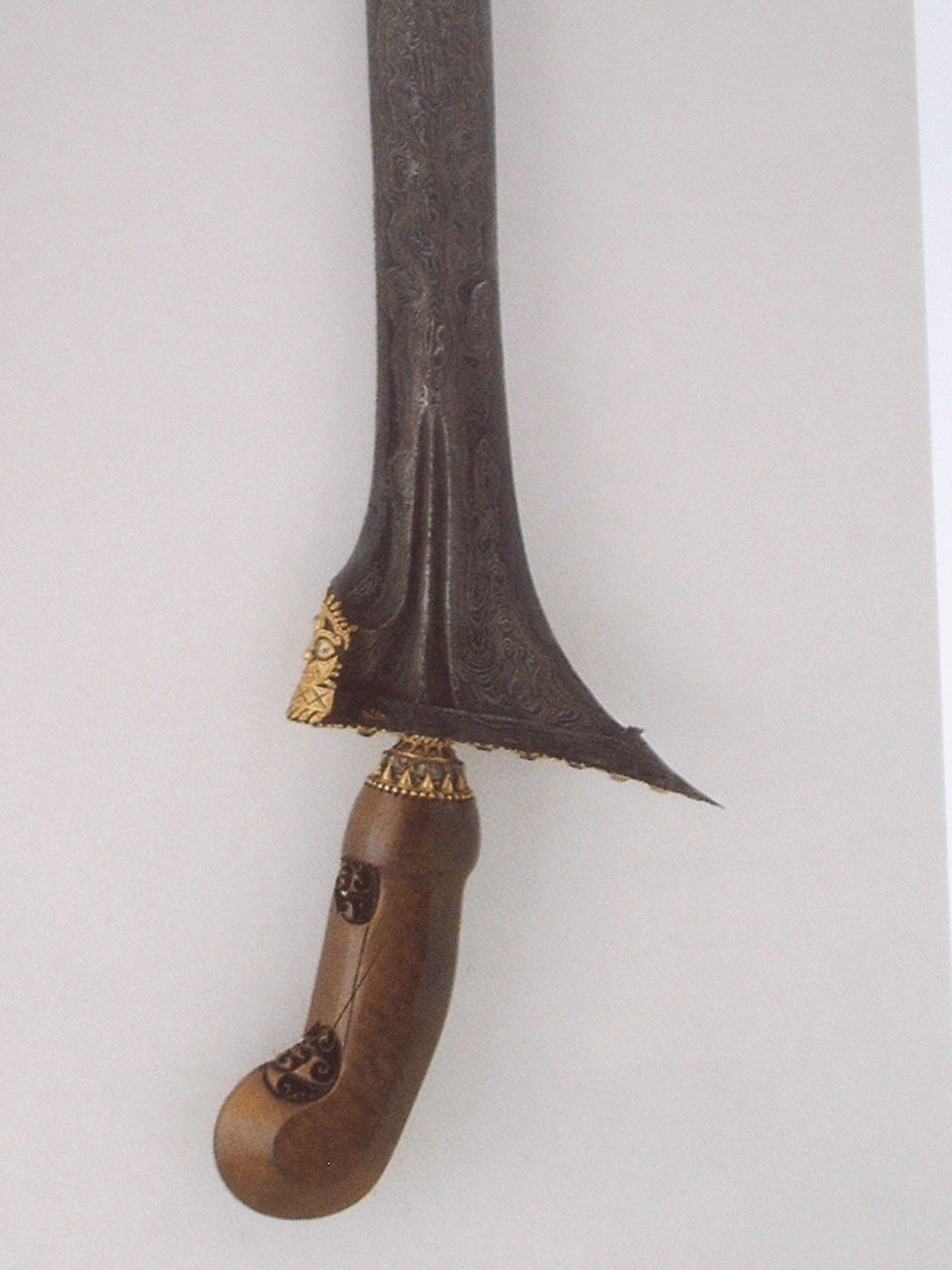

Dear All,
here are the pictures of Keris, which belonged to Diponegoro, according to notices of George Lodewijk Weijnschenk. He acquired this Keris in Yogyakarta, 1886 he's collection came to MVK Wien.
Total length 48,7 cm, blade length 40,5, which is very big for a Yogya kris. Also atasan is very substantial.
