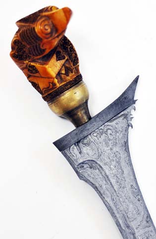

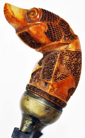

I have a problem with this Palembang keris and hilt. All I want to do is to clean the black-rusty blade with "kelapa" (coconut) husk. But unfortunately, the hilt is fixed firmly to the pesi. Too firm, and not possible for you to open or even to turn the hilt with your bare hand...
What would you suggest me to do: (1) Must I open the hilt first (2) but how to open such firm fixation? Or (3) just submerge all -- blade and hilt -- to the "blandongan" full with coconut husk? (4) Or clean the blade, without unfix the hilt? How?

Beautiful hilt - very expressive fangs! Sure looks ivory.
The hilt could be still fixed with resin - heat will easily do to remove the blade.
The pesi could also be heavily corroded and rust holding the hilt in place. Although there is a chance of damage, it would IMHO still be better to remove it, especially before soaking it since water and rust won't do any good and there's a chance that the hilt may get cracked from accumulating rust eventually.
Are there any cracks visible close the hilt's base? If not, it should be pretty safe to apply gentle heat to the sorsoran area (holding the hilt/selut with a heat-resistant glove helps to avoid heating the hilt). When hot, gently try to twist the hilt. If it doesn't move, let it cool completely and reheat/cool several times. I'm sure you've utilized this procedure quite a few times already...

IMHO, it is not ivory but "duyung" or dugong hilt.
Forgot to comment earlier: Ivory is a general term and includes other tooth from animals like dugong, walrus, hippotamus, etc.
P.S.: It would be great if you could invite more Indonesian keris collectors to our little warung kopi! We all realize that the language barrier can be a challenge. Every contribution would be valuable and appreciated though!

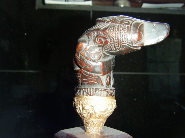

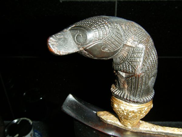

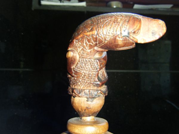

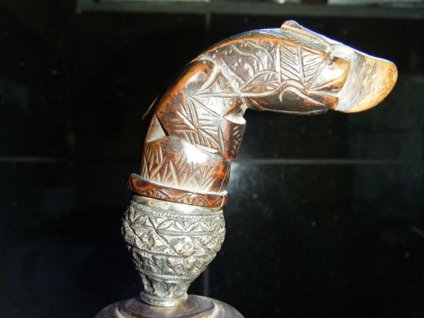

Here examples from my collection. The pictures are taken fast so I apologize for the quality.
Old 23rd May 2010, 02:15 PM   #28
And there is a hilt type with similar features but also with style elements from Cirebon. So I am never sure from where this hilt coming.

I received the hilt together with the keris and I I ever have thought that it is a Palembang keris.
Here the requested pictures. The keris was shown in this thread before:
