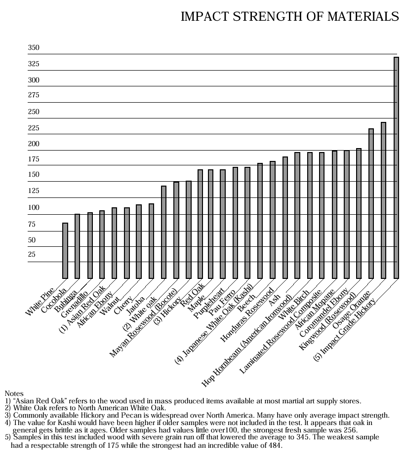

Interesting article on woods

This may help?
Old 7th May 2010, 11:42 PM   #10
t_c
Join Date: Jun 2006
Location: ca, usa
Posts: 92
This may help?
That's great actually!
Thanks Lew - going to file this one away in library!

As for Vandoo's graph, you can download it from the link I posted above.
Same link as before
F

It is interesting to note after I posed the question over a laminate, I see #6 on the wood impact strength graph is a laminated rosewood composite.
