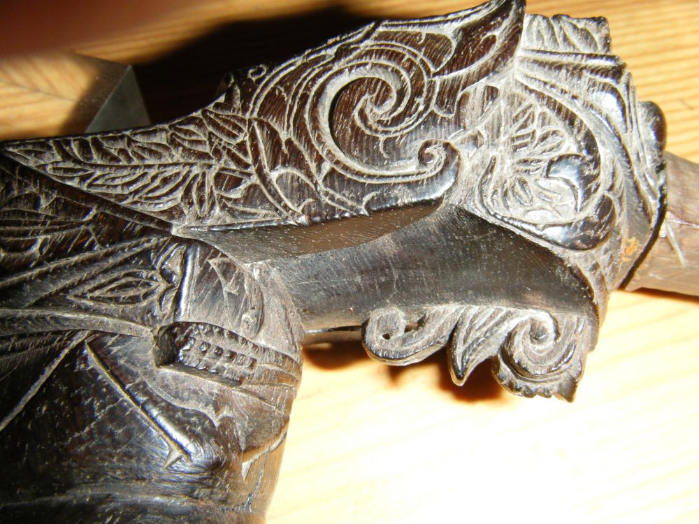

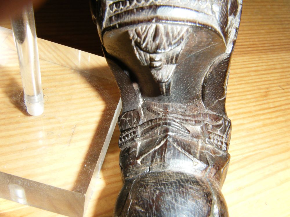

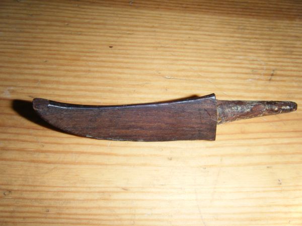

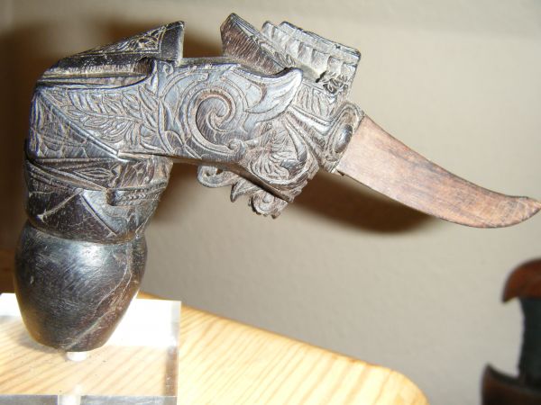

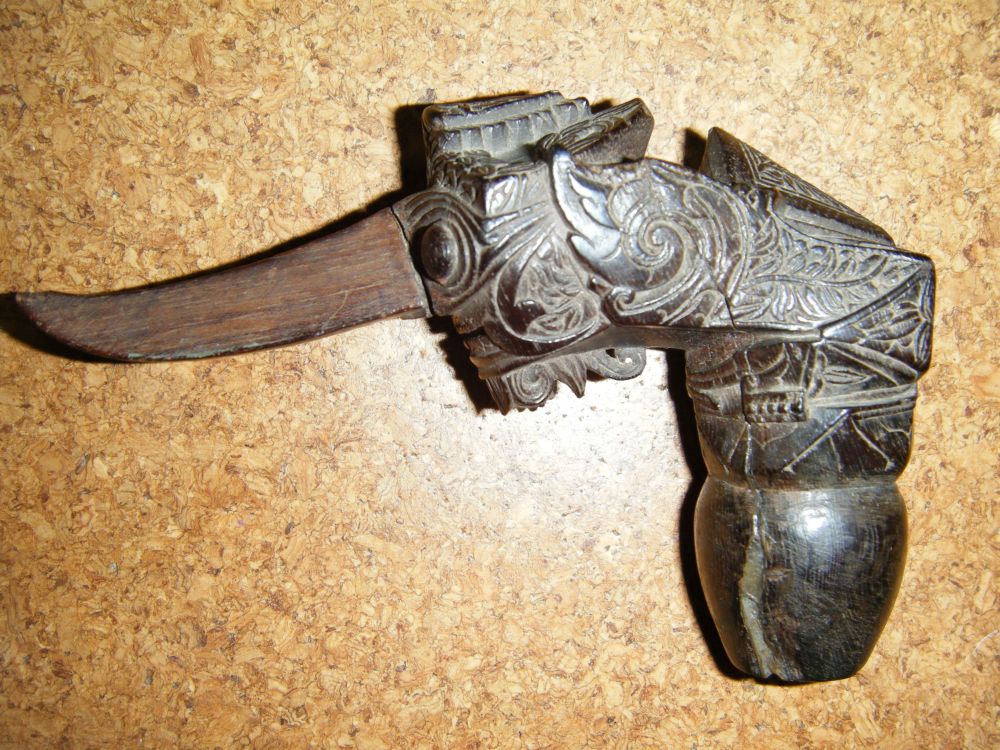

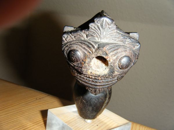

The sheat I will clean careful with steelwool and it will get a new cover with shellac to give it back a primal glory. The blade I try to clean careful from corrosion. The hilt I clean already careful and I was able to open the nose without break and I think that I can reglue it better. Is this an "original" repair from the nose (see the pictures)?

Yes, this is a traditional way to repair missing noses in tajong hilts. Looks like this was done professionally a while back.

The hilt looks 'thirsty'. I think it would do well with some wood oil.
It's a good hilt. Some of my tajong hilts have deep cracks through the hilt, one even has a partially repaired buah pinang (60% of the original gone). So it is quite common to see old tajong hilts with some form of damage. |

first of all thank you very much for all your knowledge help. So this repair is an old one. I will look that the reglue will be done more unvisible. The hilt look "thirsty" because I just cleaned it before I take the picture. It will be oiled after I have reglued the nose. Do you able to estimate the age of the hilt? I have had a look to "Spirit of Wood" and think that the hilt is from the middle of the 19th c. ![]() ![]() Regards, Detlef Last edited by Sajen; 2nd May 2010 at 07:44 PM. |

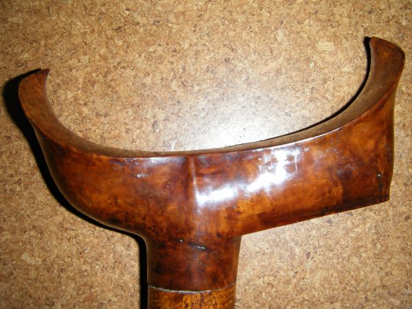

One of the tricks of the trade in the furniture restoration business is to moisten a small pad of cloth with gum turpentine and using car polish you polish off the filth on old french polished, shellaced or varnished surfaces.
You can get a quicker result if you use 0000 steel wool , and also if you use a clean and polish paste rather than just a polish paste, but you then run the risk of going through the finish. Its best to stay with a cloth rubber unless you are sure that you have a thick layer of old shellac or varnish. The interior timber fittings in many of the historic homes in Australia have been brought back to an acceptable condition by the use of this technique. |

I have followed your advice and the result is a great one. Tomorrow I will post some pictures from the sheat; it look beautiful now. Regards, Detlef |

Here the pictures from the cleaned sheat.

NICE work

I agree very nice work on the sheath - looks completely different!

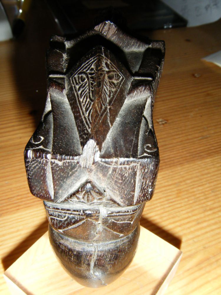

Thank you Dave (I hope it's ok that I address you like this) for your comment. I think that I am hooked on them already and my believe is that I never will get one again auspicious like this one. I am encouraged by your dating of the hilt. The wood is nearly black and very heavy. My guess is that the body of the hilt break when the wire was attached to the pesi and the hilt was forcibly pressed on since the glue look recent. Maybe it happened by the prvious owner. Would be nice to read what Nik Dee think about the used wood. Regards, Detlef |

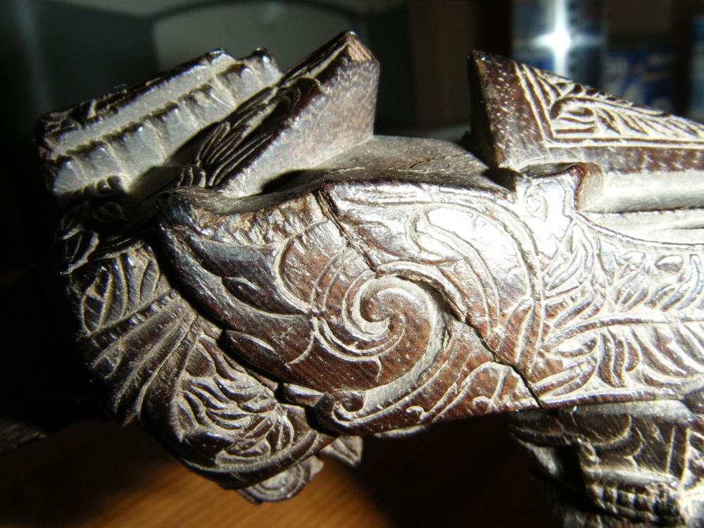

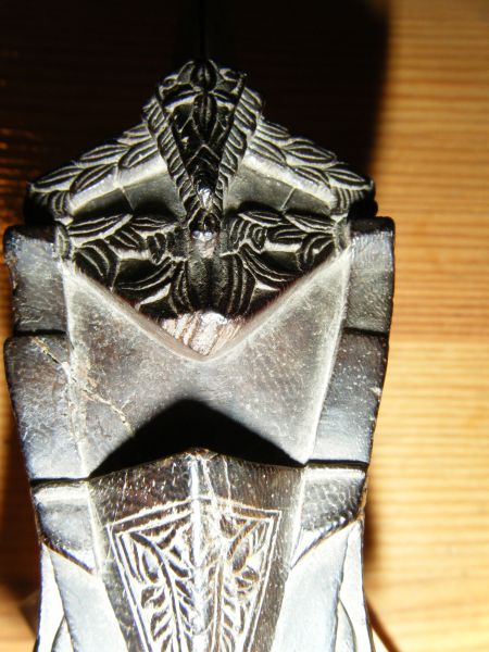

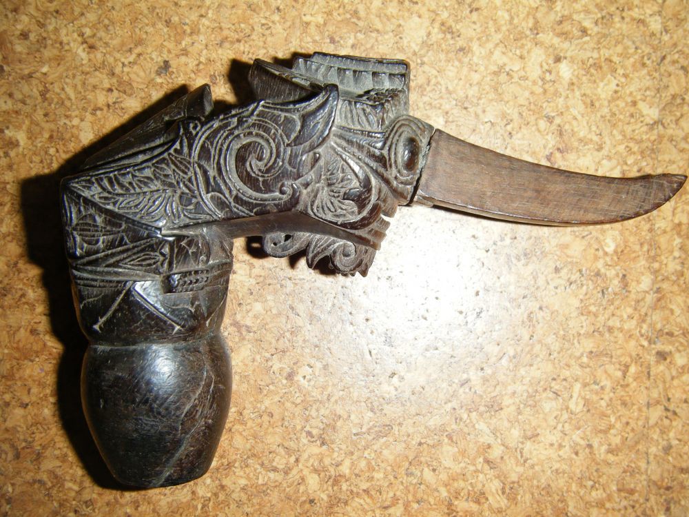

The nose of the hilt is reglued and the big crack at the left side is filled with wood putty and at last the hilt is oiled with wood oil. The wood putty is on the pictures grey from the flash but in nature it is black and have nearly the same colour as the wood.
