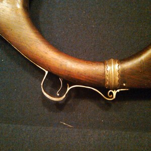

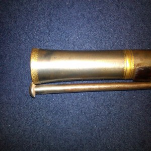

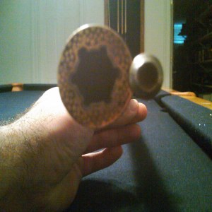

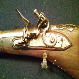

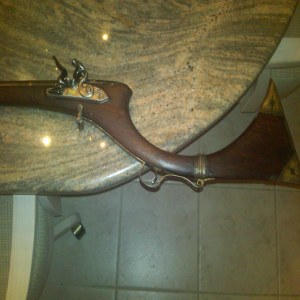

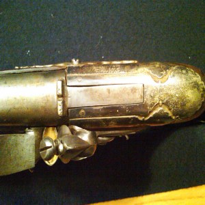

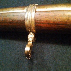

I recently acquired this Jezail from a relative who passed on. It is a very important piece to me because it was inherited. I am trying to identify where this piece is from and any information I can find on it will be greatly appreciated. Attached are the photos I have taken some are better than others your help and expertise in this matter is greatly appreciated!

That piece is from Sind and is the best one of these I have ever seen. Most of these pieces of this form are very plain. This looks like a presentation piece I suspect that it has a very nice damascus barrel, but would need to see better closups.

Hi Patsy57
very nice Afghan Jezail flintlock, very clean
made in the Sind area around Pakistan and Afghanistan - Late 18th century -
may be the flintlock system could be imported (English ?)

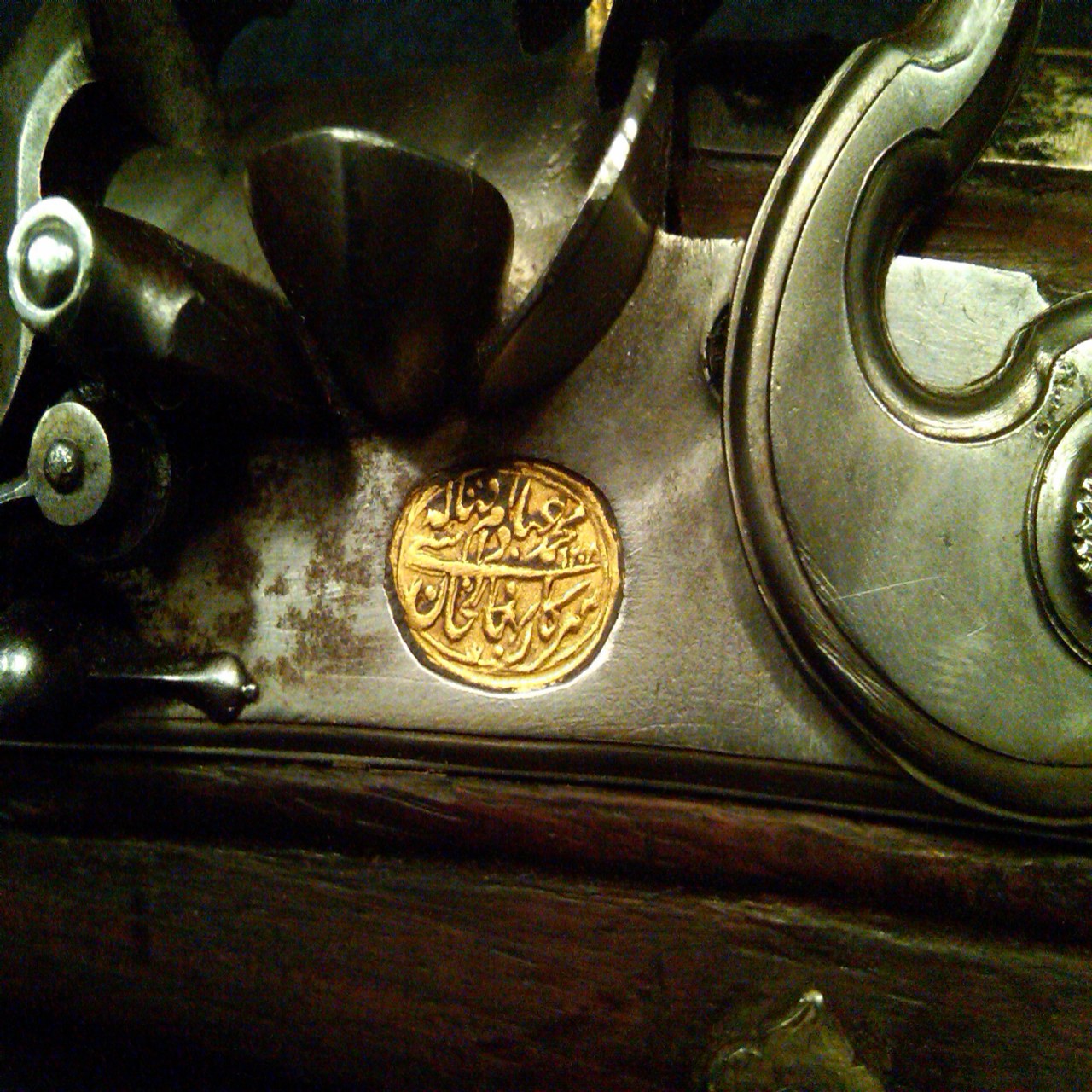

a focus image of the coin embedded, could might be give a chance for a translation

OK now my interest is really peaked. What other pics would you guys like to see? Is there anyway to really bring out the Damascus barrel without hurting the firearm?

Plus, either I'm missing something (I'm totally out of my area, here), the pics are inverted, or the gun is made for a left-handed shooter...

The Jezail is a left hand version.

Here is a larger picture of the medallion.

Any ideas on the seal? What it says? I am continuing to look and try to have translated.

Going from left to right and top to bottom I can decipher "Hamid Abud" but that is only part of the top line and I cannot seem to get the rest. Any help once again is greatly appreciated.

I think I'm seeing a date: 1204 (the 4 is a bit indistinct... might be a 6)
I believe that would equate to: 1790 Gregorian.
Which would fit perfectly with Doms estimation of age for the piece.

I didn't get the translation completly, because it's "farsi" language
Arabic alphabet, but not Arabic language
it's little bite like a rebus ... words are in all directions
up the lign
- 1207 either 1792 Gregorian
- MOHAMED
- ABAD could be a name
- the left part it's illegible
down the lign
- CIRKAR (I thought in farsi) "country"
- KHALKHAN either KhalKhan - Badakhshan Afghanistan
Badakhshan (Persian: بدخشان - Badakhshān) is one of the 34 provinces of Afghanistan
all what is in above must be corrected and approved by a Persian or Patchou reader

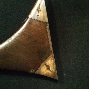

That`s fantastic! Well Its a great start guys I really appreciate the help! Here are some pics of the entire firearm. Any other help is greatly appreciated!
