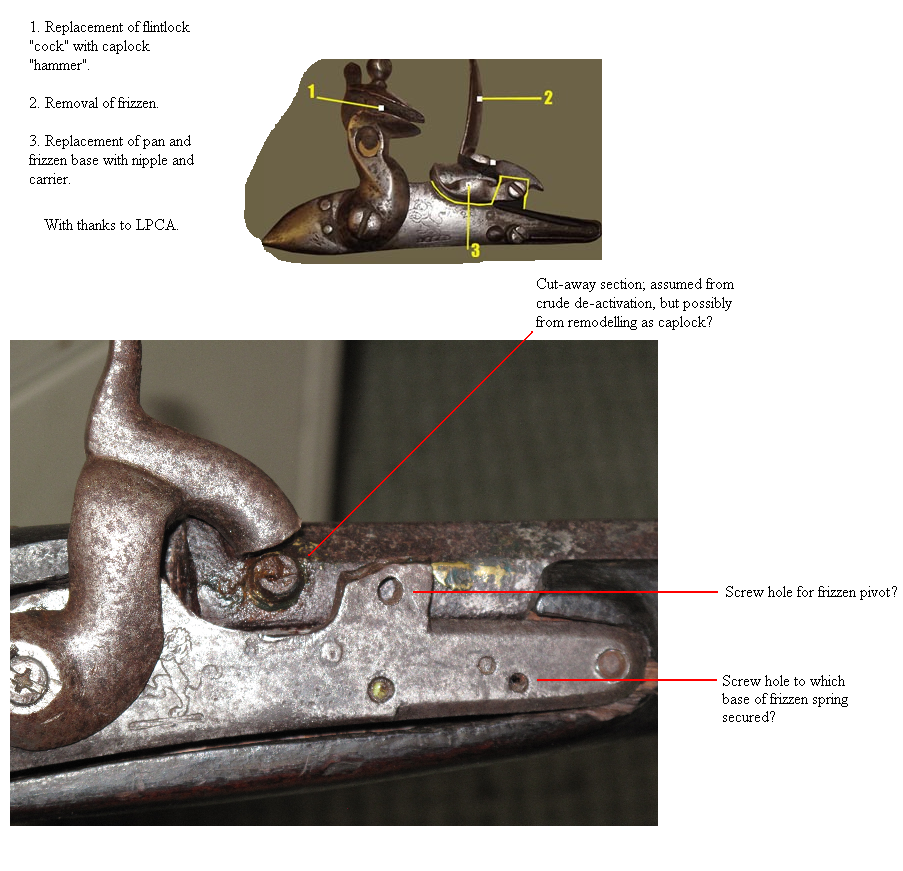

To respond, I had my misgivings about what is left of the lock from the outset. The sans-serif numerals certainly didn't seem right; no specimen of British lock I've ever seen (in my, I should add, very limited experience) from that period had sans-serif numbers or letters, and this page here gave my suspicions a boost. Likewise, the lack of a border around the lockplate (which as I understand it was pretty much de rigeur on British locks) and absence of any visible proof markings seem indicative of a fake. I've very gently removed some of the lockplate rust with a soft cloth and WD40, and apart from another "8", stamped just below the former location of the nipple, can see nothing more than what I've described above. On better examination, the lion seems what I can only call ragged; it doesn't quite match up to illustrations and photographs I have seen of the EIC lion, and seems more crudely inscribed.

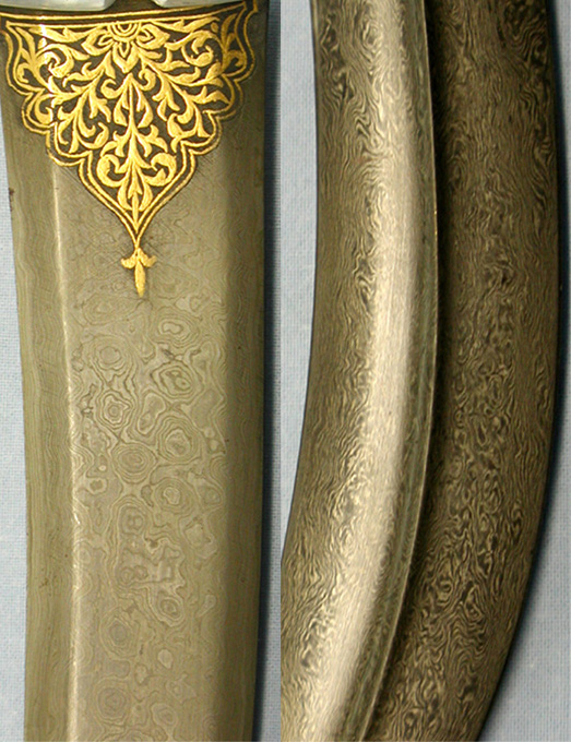

Watered means that the piece is damascus steel. Meaning it is a mixture of steel and iron and will show a pattern. As heavy as that barrel is I think it is possible. The contrast of the pattern is brought out by acid being used on the piece. People mainly use ferricc chloride now but just about everything under the sun has been used including urine.

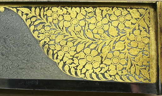

Watering or wootz you can see on the blade at the right side of the picture, the blade to the left is mechanical damask, but very skilfully done, it can be seen much cruder.
A steel blade keeps the edge very well, but it can be brittle and break, an iron blade is soft, bends easily but seldom breaks, and to this comes that it does not keep an edge very well – so to get a mixture of these two metals was important.
The last picture is from a Khyber knife, here the wootz is clear and you can even see how the koftgari was made.

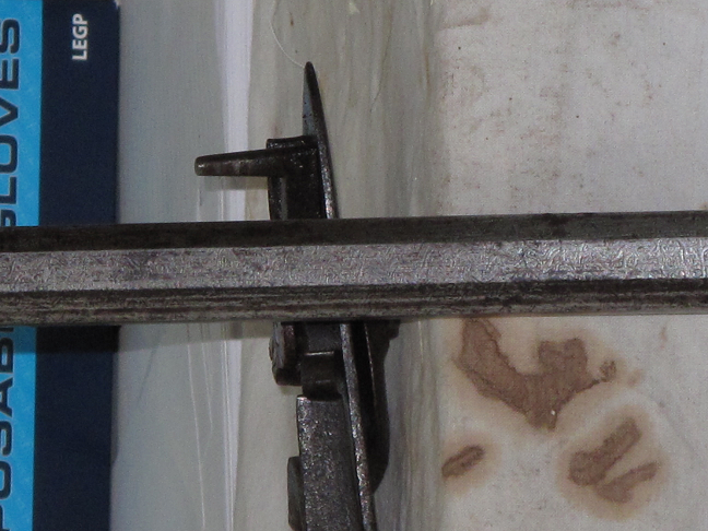

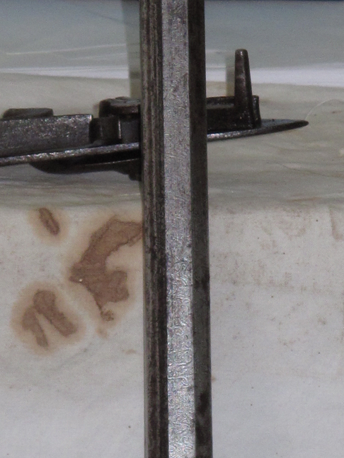

Well, I finally did it; I've dismantled the gun. No real surprises, I should imagine; the "ramrod" turns out to be a piece of painted dowel, inserted to keep the fore stock together, and the lock came away easily enough and seems, happily, to be in working order; at least, it certainly does a damned good impression of it! Having determined it was at the half-cock, I decided to cock it fully and fire, thereby releasing the tension on the mainspring. With the aid of a little WD40, it worked like a charm. My compliments to the maker!
The biggest surprise, however, is that the barrel steel does show a pattern! It might be damascus, I suppose, but then again it could just as well be faked damascus patterning. I'm trying to get a good photograph but this damned camera is still defeating my efforts; however, some select pictures can be seen below.
Barrel:
http://img85.imageshack.us/img85/8917/img0323tx.jpg
http://img704.imageshack.us/img704/5083/img0317yt.jpg
http://img181.imageshack.us/img181/8163/img0325.jpg
http://img691.imageshack.us/img691/6926/img0324ky.jpg
http://img89.imageshack.us/img89/4329/img0323l.jpg
http://img180.imageshack.us/img180/8257/img0326i.jpg

ok I see pattern. A quick and dirty way to see if it might come out take the strongest vinegar you have put in microwave and apply to the underside of the barrel. when you are finished use hot water or baking soda solution. It will not do anything bad to the outside appearence as long as you are reasonable carefull. If you see the watering that I expect I can talk you thru a better watering technique

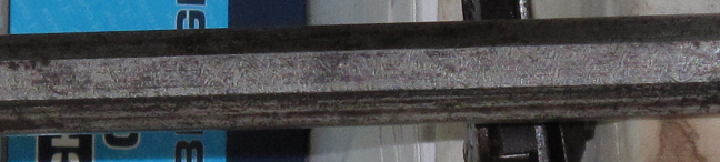

Right, I've done the vinegar-and-water acid etch trick. I can certainly see a difference; the pattern is very distinct, with many swirls and whorls, and even appears to have a tiny bit of a texture to it - though I can't feel anything through latex gloves. I've taken five pics and I hope they've come out all right, but if not, I'll work on getting some more done.
Incidentally, any tips and tricks on rust removal? I've not yet really embarked on de-rusting the barrel, since it seemed pointless when I was about to apply acid and water to it anyway, but hopefully I can now move onto that stage. So far I've tried a small area, using some reasonably fine glass paper, which seemed to produce results. With the lock, I've restricted myself to 3-in-1 oil and a soft cloth, removing as much excess oil as possible and leaving only a small amount as a film to inhibit further corrosion.
http://img13.imageshack.us/img13/3706/img0331qe.jpg
http://img693.imageshack.us/img693/7321/img0330og.jpg
http://img408.imageshack.us/img408/8053/img0329g.jpg
http://img215.imageshack.us/img215/2114/img0328v.jpg
http://img547.imageshack.us/img547/6654/img0327.jpg

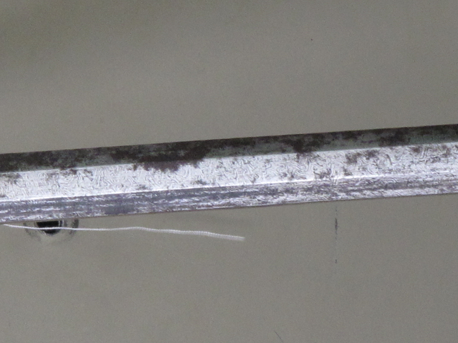

And a belated reply, with a minor update: browsing around the forum for further information on these creatures (I'm now thinking of buying one myself - it's everyone here's fault, I tell you!) I came across http://blade.japet.com/B-afghan1.htm - which got me thinking about this lock. I had attributed the cut-away section of the lock to a crude attempt at de-activation; is it instead possible that this was a native-made flintlock, modified to become a caplock? I present my hypothesis - with thanks to LPCA - in the form of this magnificent illustration.
I also attach a couple of better pictures, which might show the watering more clearly than did my previous efforts.
