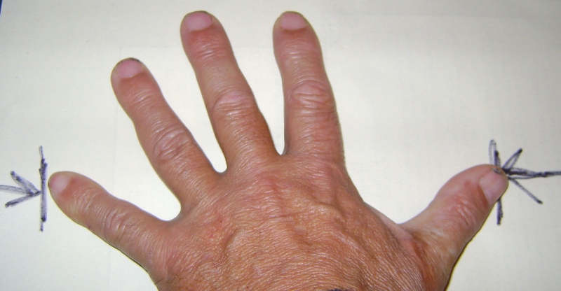

Across the hand, fully stretched, from thumb tip to small finger tip. If you have a 'standard' hand, measure it this way and you will have an approximate result.
I used to play buttons when i was a kid, and we still used Palms. You toss your button against the wall and if it falls within a palm from your foe's button, you score. I was not such a winner, as i had a small hand .
Fernando
Old 7th December 2009, 12:04 AM   #5
Like so

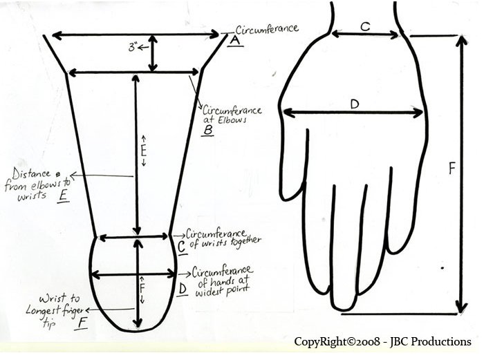

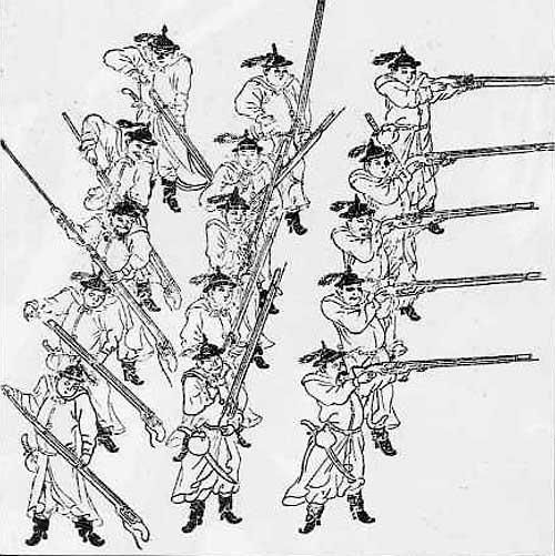

I found these line drawings on entering palm measure at google.
It his, as has been suggested, most probably a length measure taken from a part of the human body. My palm, e.g., measures 9 cm in width.
As Willocks' The Religion is settled in 1565, the mentioning of seven-palm and nine-palm muskets should, in my opinion, refer to the overall length of the guns. Let me just point out as an aside that, as I have mentioned previously, the term musket seems to have arisen in mid-16th century. Most of the guns of that period which we have come to call (h)arquebuses nowadays had an average overall length of ca. 70-90 cm. A significant terminological difference between the shorter and the longer guns did not exist yet.
So, as a conclusion, the idea is quite convincing to me that seven to nine palm guns - no matter whether they were called arquebuses or muskets - would have been about 80 cm long.

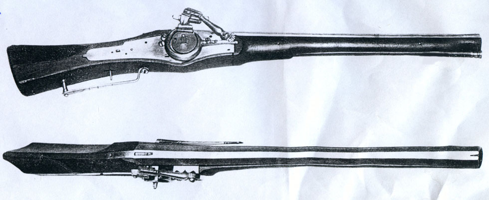

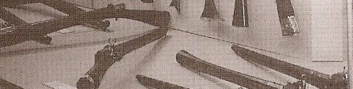

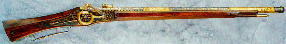

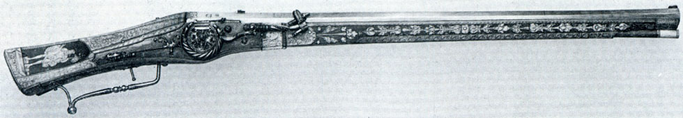

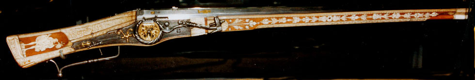

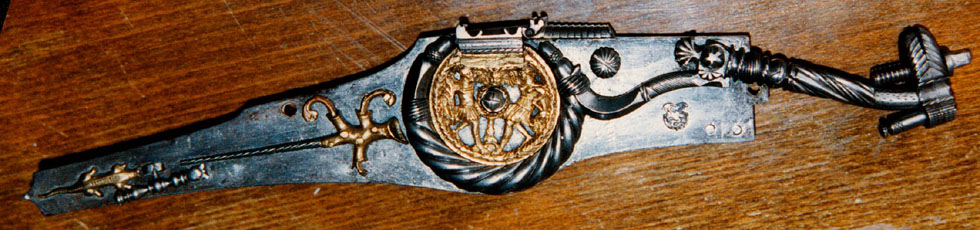

I fully agree as your definitions nos. 1 and 3 would lead to a measure between ca. 7.5 and 10 cm which is exactly within the span I pleaded for because when multiplied by factors 7 or 9 respectively, it corresponds very closely to the average overall length of a mid 16th century wheel lock gun, may it be called either an arquebus, pistol, carbine or a long gun.
For an impression of proportions, attached please find scans of three mid 16th century wheel lock arquebuses, from top:
- dated 1541, overall length 90 cm, cal. 11 mm (Capodimonte Naples, inv.no. 3193)
- dated 1548, oa. length 95 cm, cal. 14 mm (Tojhusmuseet Copenhagen, inv.no. B 35)
- ca. 1550, oa. length 100 cm, ca. 11.5 mm (Mníchovo Hradiste, Czechia)
Michael

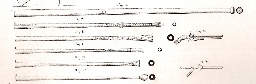

Illustrations from 1680s-1705, From Marsigli's 1735 State of the Ottoman Empire ....includes a picture of Janissary muskets (Istanbul Military Museum)
Notice the length of one of the barrels in the illustration.

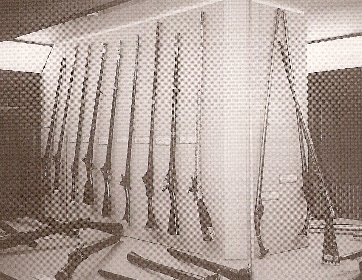

Still facts (defined as both actually surviving dated guns or closely datable sources of illustration) are all that matters to me. So I attach some scenes from a series of Brussels tapestries which I posted here earlier. They were made after watercolors painted 'live' during the Tunis campaign of the Emperor Charles V in 1535, and clearly depict snap tinder lock and matchlock arquebuses used by arquebusiers of both Charles V's forces and their North African colleagues.
While the 'modern' European guns are noticeably shorter and stouter (ca. 90 - 100 cm) those of the Turks still reflect a somewhat mor archaic German style. I do admit that the Turkish guns are a bit more delicate and also somewhat longer (ca. 120 cm overall I should say). The reason for this is doubtlessly that they were still copied after the German obsolete style of the 1520's.
Michael
Michael you say that 'surviving dated guns' are all that matter to you.....so why do you choose to ignore this possibility stated in my previous post
Robert Elgood states in "Firearms of the Islamic world in the Tareq Rajab Museum, Kuwait" that......
"....There is a fine 16th Century Turkish matchlock barrel (with a rear peepsight and a grooved foresight, round at the breech with a tulip-shaped muzzle) in the Victoria and Albert Museum, London, which has been mounted by a French gunsmith on a wheellock arquebus from the Royal Cabinet of Arms of Louis XIII (Inventory number 3) The length of the barrel is 58 inches and may be compared with that of No. 3 in the Tareq Rajab Museum
The art work is great.....but it would be difficult to use as factual evidence. 'Artistic licence' springs to mind. However, lets assume that the picture is accurate in all detail (dimensions etc) .....what does it prove.....it shows Turks using similarly sized arquebus, but this fact is already known ....the bulk of the Ottoman army were issued with these imported European guns
The battle scene depicts both factions very close to each other, the shorter barrelled arquebus would be better suited to this situation....long range accuracy is unnecessary and reloading in a crowded position would be severely hampered with a long barrel and the long ramrod ....the shorter version would be much easier.
It is strange that a horseman (in one of the illustrations) would ride into a close proximity battle with a loaded arquebus, once (possibly inaccurately ?)fired he would have little chance of re-loading ....unable to draw his sword (unless he discarded the gun) he would presumably have to use it as a club. I can only assume that the artist was 'lucky' enough to see such a foolhardy action and painted it ..... or it is evidence of 'artistic licence' ( Also, if everything is true to scale, the horseman's sword is quite .....small ...and quite uncharacteristic ...the Ottomans used the Kilic a curved sabre (especially from horseback) the infantry used the Yataghan (yatağan) from the second half of the 16th century onwards.)
Interesting that you assume such accuracy from the tapestry regarding the firearms .....when the swords, it seems are portrayed inaccurately.
I mentioned before the arquebusier Balbi whom describes the Turkish muskets as “nine palms long”. Why give such a name to an arquebus that is slightly longer, why catergorise an item unless it is significantly different ???
Francisco Balbi di Correggio (1505 - 1589) born in Correggio in the province of Province of Reggio Emilia, Italy was an arquebusier who served with the Spanish contingent during the Siege of Malta. Little is known about him other than that he maintained a journal throughout the siege, which he afterwards published.
Balbi's is the best-known eyewitness account of the siege (there is at least one other, in the form of a long poem by the knight Hipolito Sans), and all subsequent histories rely heavily upon it, including that of Giacomo Bosio, the official historian of the Knights of St. John, whose massive account first appeared in 1588.
http://en.wikipedia.org/wiki/Francis...i_di_Correggio
I believe that the 9 palm musket would have been a specialist weapon, mainly used at the start of a battle because of its long range and accuracy, to hit strategic targets (officers, cannon crews etc) The Musket’s barrel length gives it better penetration, accuracy, and less recoil (which also affects accuracy). However, it’s weight and length would make it difficult to aim at quickly moving targets.
"....By the early 16th century, the Janissaries were equipped with and were skilled with muskets.Nicolle, p.36. In particular, they used a massive 'trench gun', firing an ball, which was "feared by their enemies".
Below is an illustration reportedly from a 14th C work written by Jiao Yu,14th century Ming Military leader.
Notice the length of the muskets.....as long as each man is tall ( 5 foot +) or perhaps the muskets are around 130 cms and the men illustrated are pygmies..............or perhaps it's a case of 'artistic licence'.
Michael, if you can provide factual references that prove that the Ottomans did not have such a large musket in their arsenal. Please post it. If you are saying that Elgood is mistaken regarding the Turkish barrel in the Victorian and Albert museum, please explain why?
