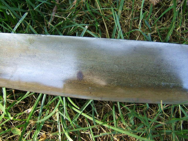

Hi Guys

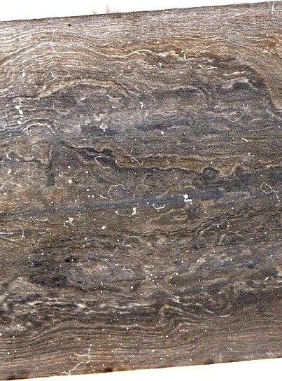

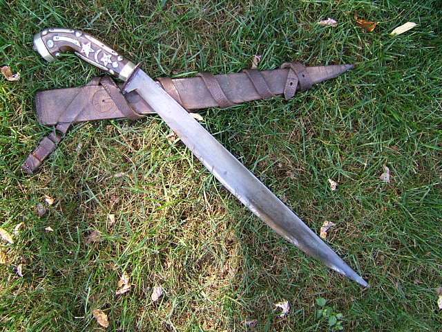

Ibeam was over at my house today to have me etch some of his swords. He pulled out an old Luzon bolo which he thought he saw a wootz pattern in the blade. So I did a light etch and to my amazement it was wootz. I figured the bolo must have been reworked from an older sword I don't think the Christian smiths made wootz in the late 1800s.

Thumbs up Great find Ibeam!
Any chance to get better close-ups?
(I know, wootz is a pain to photograph! )

I agree with Kai. I must admit i don't really see Wootz in this photograph.

I don't have the sword anymore Ibeam will have to post better pics but it is most definately wootz I did a side by side comparison with some of my wootz pieces and his sword showed a nice pattern. It was real hard to photograph the wootz pattern. I tried sharpening the current close up but the file gets too large for the website to take. Nechesh I can email you a sharper pic if you would like. OK here is a link to view a better picture of the wootz pattern.
http://img.photobucket.com/albums/v1...tphotos012.jpg

I can sort of see a pattern of something, but the pics are less than convincing. Even so, assuming this is wootz, it is a very unusual finding on a distinctly Filipino sword from Luzon -- I've not seen another example. The sword blade is definitely a Filipino pattern ("matulis"). The hilt and scabbard suggest c. 1900 or a little later, perhaps a Katipunan piece from the symbols on the hilt.
Possibly the most likely source for a wootz ingot might have been via the Muslims in the south of teh Philippines, and their contacts with other Muslims in Malaysia, India and Arabia. Perhaps something brought back from the Haj that found its way into the hands of a Christian Filipino.
Intriguing piece if it does turn out to be wootz.

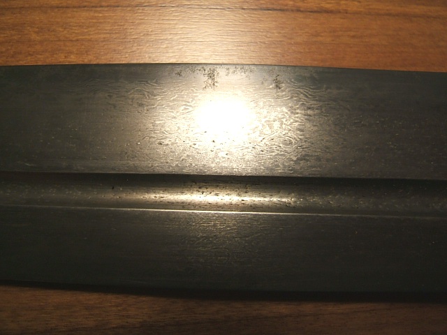

Thank you All,
I tried to take a close up of the blade and here it is. The clean smooth steel in the bottom of the picture is the blade edge. Most of the patterning happens just above this hardened edge.
Thanks Lew for posting the sword.

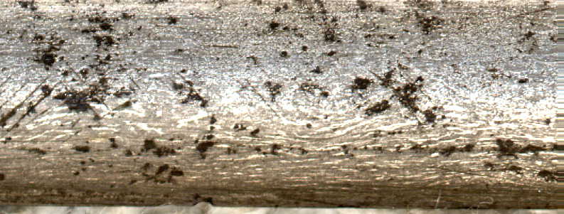

I fiddled with your pic in Photoshop to try to show the pattern better. Don't know if it's better or worse.
Lovely Bolo though!

Thanks for the pic, Ibeam! Ok, I see the pattern which you are referring to as wootz. However, could you please try to get an even clearer pic? Waiting for a completely overcast day does help... Since this may be such an unique piece, I'd love to get the documentation as good as possible!
That's like fire-hardening a bronze sword's edge...
Actually, this lack of pattern may be a more compelling evidence that this really is wootz: Seems like the bladesmith was unaware of the requirements for forging wootz and thus destroyed the hard wootz edge during a futile conventional "hardening" step!
Maybe this blade was made from an imported wootz blank/blade? Is it possible to deduce from the pattern wether it was just filed into shape or is there any forging noticeable?
Sorry for being a pain!

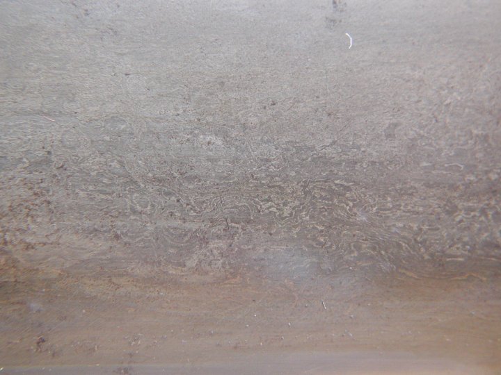

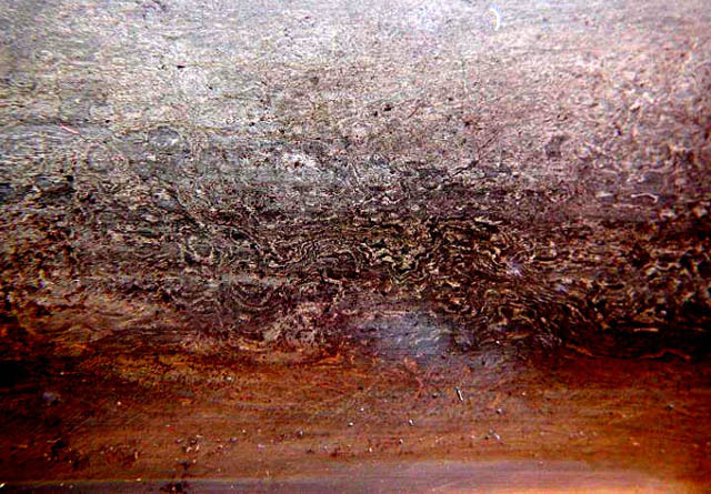

Hi again folks. First off, here are pics of my gunong and a very detailed closeup of the blade lamination. I must admit, although it resembles wootz, it is not crystaline like wootz. Many Indian blades are not wootz. but I love the close blade lamination of this puppy and this is one of the many reasons that I keep it.

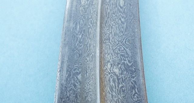

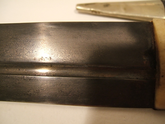

Here is a Kurdish jambiya I have for comparison. Notice the difference in structure (though close to the gunong). This is a wootz blade.
Old 25th August 2005, 06:22 AM   #27
Posts: 7,417

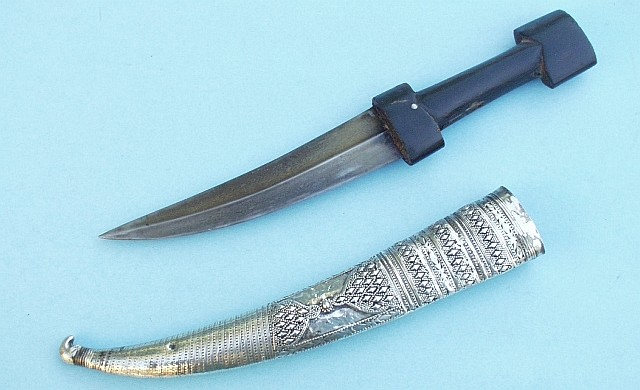

Finally here is an Ottoman jambiya with wootz closeup. I must admit at first I had trouble telling the wootz from really good lamination, but now I look at how the patterns fall back on themselves or how the crystalization is. Although you can see some swirling in this closeup, you can see the crystalization easily.

Can you provide us with a closeup that covers a wider area of the gunong need to see more of the pattern.

i know we're talking about the blade, but does anybody notice the deco on the handle? besides the stars, there's also the crescent moon (ibeam brought this up), most likely denoting Islam. i realize it's a luzon bolo (or is it? hmmm), but the original owner prolly has some roots in mindanao. this could be a clue...
