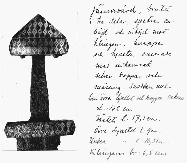

The handwritten notes for the grave describe two swords and one spear etc. .

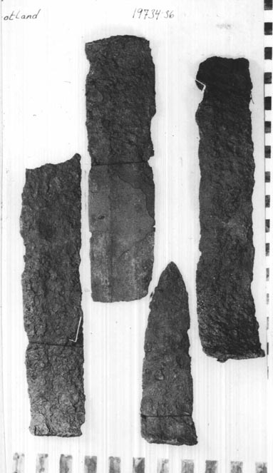

This is presumably the first sword, described as broken in three parts (“tre delar” in the notes next to the photo).
(photo 1)
L- 102cm
Hilt? L - 17.1cm
Over ? L- 9cm
Under? L- 10.5cm
Blade width – 6.5cm

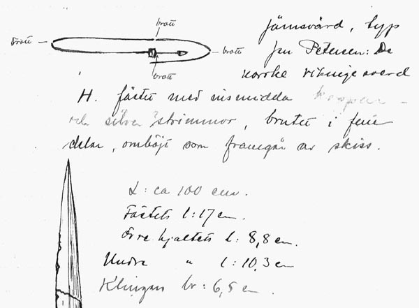

The other sword is described as having a type H hilt and the drawing shows more breaks (photo 2)

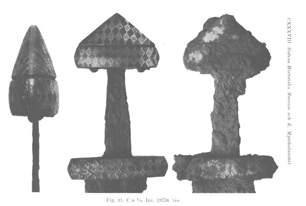

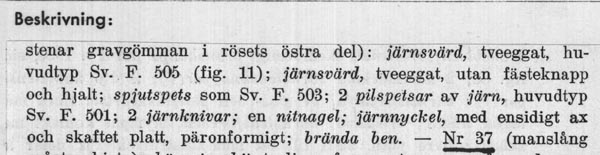

Moving to the Museum’s Iron Age catalog, the grave goods are described differently, the second sword has lost its hilt (photo 3)
This blade has the right inventory #, and is in more pieces so must be the second sword’s blade (photo 4)
The ‘Fig. 11’ mentioned in the museum notes is also in the Järnålderskatalog, and shows a side view of the pommel. (photo 5)

Blade
Blade is preserved fragmentary, see pic. 1. There are no traces of pattern welding on the blade. But the condition of the blade is however quite poor and it is difficult to determine any original structure.
Pic. 1 – fragments of sword
