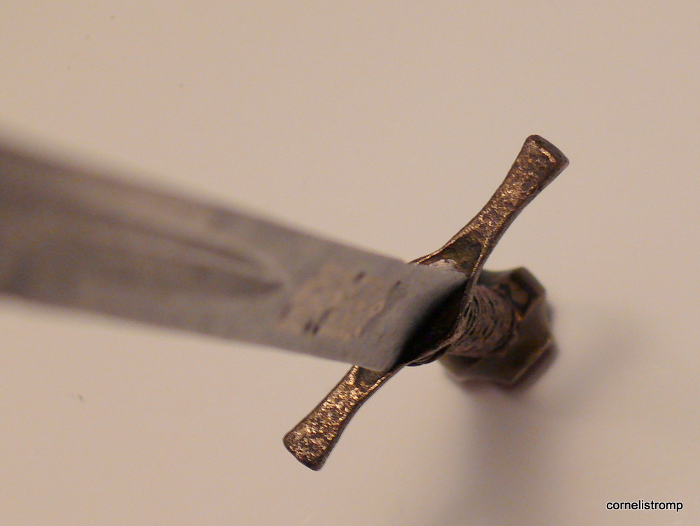

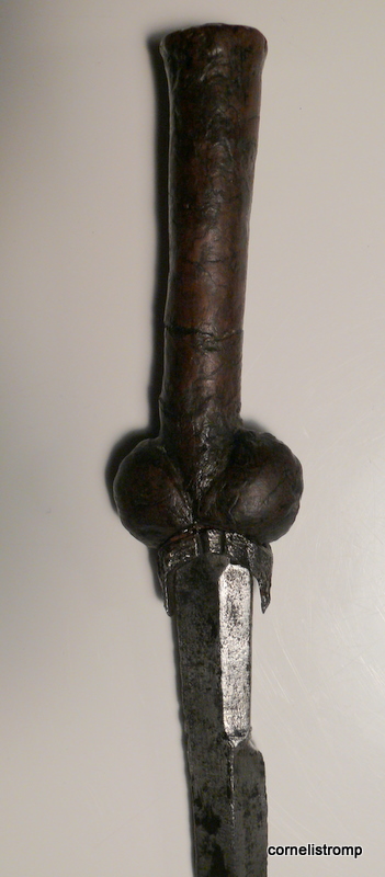

Default two Dutch medieval daggers

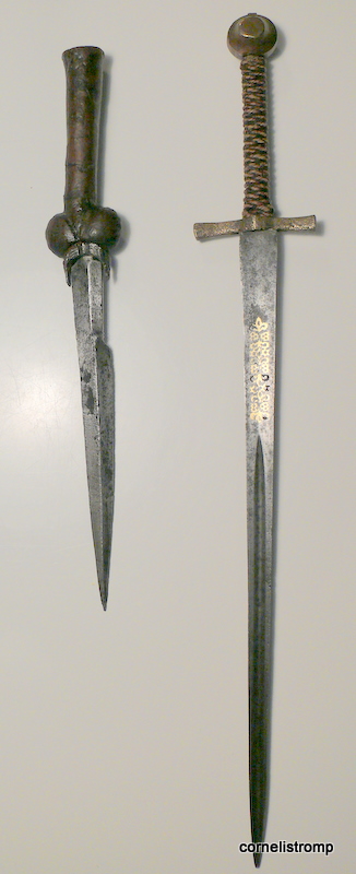

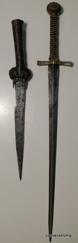

Both daggers have been found in Amsterdam in the 70ths.
enjoy
best regards

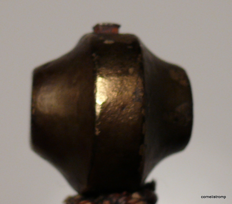

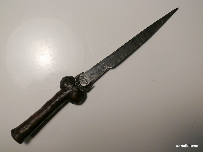

Nice daggers!
Does the bollock-style handle serve any special purpose?
It's blade is also very interesting since it is asymmetrical.
Old 11th November 2009, 09:15 PM   #5
cornelistromp
cornelistromp's Avatar
Join Date: Mar 2009
Posts: 1,071
Originally Posted by KuKulzA28
Nice daggers!
HI,
the nuts of the Ballock handle (it is the original wooden handle on this dagger)
stop the hand from slanting off similar as a pair of guillons.

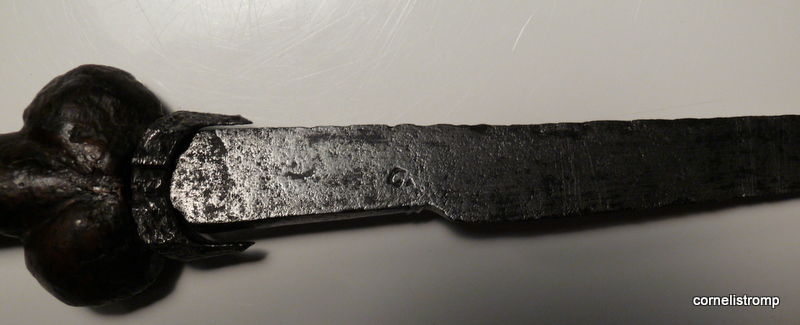

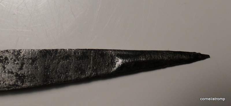

the blade is an Armour piercing blade with a reinforced diamant shaped point.
the blade is asymmetrical so it makes it possible to use 2 hands for the killing stab.
best regards

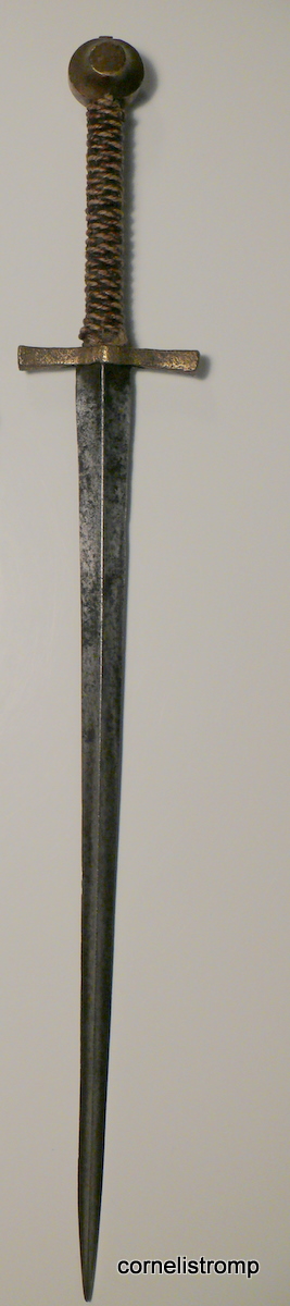

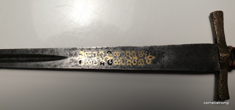

The ballock dagger looks fantastic, indeed. The blade is peculiar but not unheard of in this type of weapons.
Now the other dagger... well, it's just my opinion, but it suspiciously looks like a put-together with what could be a genuine medieval pommel, a crossguard about which I couldn't pass a reliable judgement without examining it more closely, and a blade that looks like a cut-down blade from a 18th c. smallsword, down to the style of inlaid decoration... maybe it's just me...
Now the other dagger... well, it's just my opinion, but it suspiciously looks like a put-together with what could be a genuine medieval pommel, a cross-guard about which I couldn't pass a reliable judgement without examining it more closely, and a blade that looks like a cut-down blade from a 18th c. smallsword, down to the style of inlaid decoration... maybe it's just me...
Hi Marc,
thank you for the compliment for the ballock.

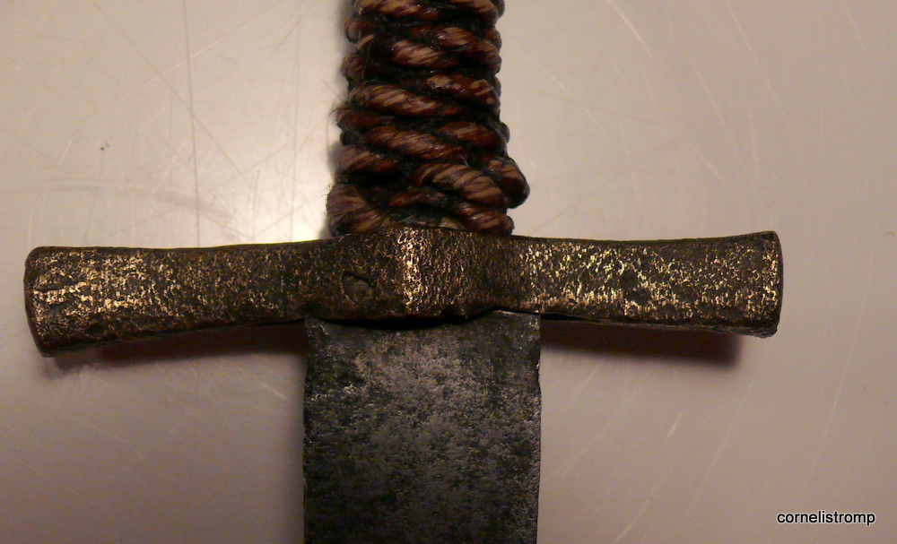

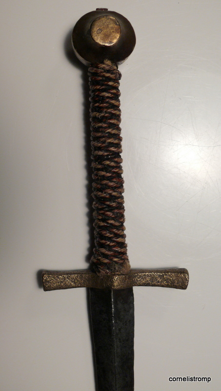

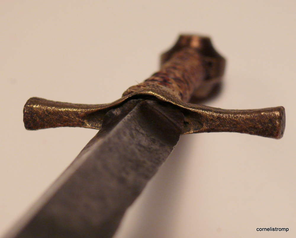

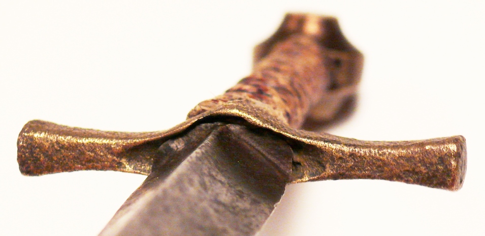

RE: the quillon dagger I think it is just you

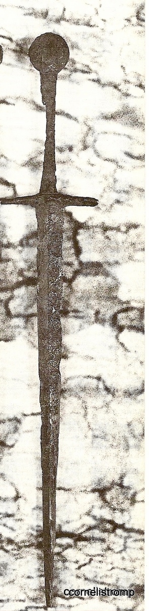

Don't let the condition fool you, it is also 100% genuine. the authenticity has been confirmed by the curator of the Dutch army museum.

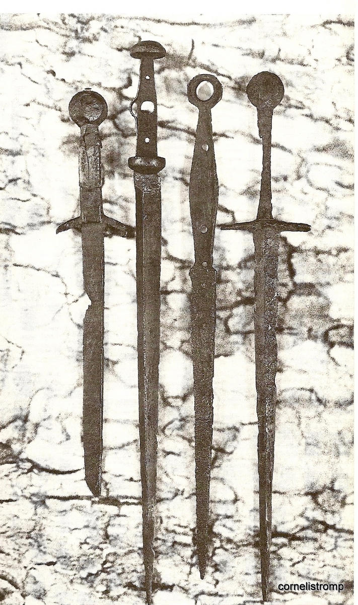

This is how it is found in the the river Rijn. (only the robe grip is added)

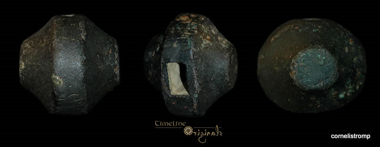

it is not a genuine pommel but a medieval dagger wheel-pommel 3cmx2,5cm
I also found the same type of small dagger wheel-pommel offered at an arms dealer and more convincing a similar dagger is published in Francis laking part 3.
This type of blade of hollow triangular section can be found on the majority of the same period rondel daggers.(around 1400)
I will post some pictures in order to explain.

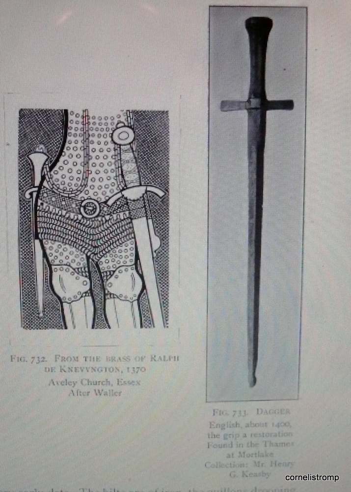

see picture Francis Laking part 3 page 3 guillon dagger fig 728 , this dagger from the guildhall museum has the same pommel and same guillons however a longer grip and a diamond shaped blade.
The construction of the guillon; the way the blade fits into the guillon is a feature of medieval swords. On later 15thC examples the shoulder of the blade rests on the guillons.
Best regards

Outstanding pieces Cornelis!
On the quillon dagger I think I would have joined with Marc in his very reasonable observation based on the photos alone, and without the data posted afterwards. The material you provided after his observation is most impressive in illustrating the information on the actual disposition of the weapon. The detail on the provenance and authentication from the Dutch Museum are also impressive additions. A remarkable dagger.
The 'ballock' dagger is also most impressive, as these are I believe reasonably rare even without this unusual blade form. I had not heard of a dagger used with two hands in stabbing aming these types. What I do recall of these 'ballock' daggers is that they were once known as 'dudgeon' daggers for the type of boxwood typically used for thier hilts, if I remember correctly.
Also, the collectors of the mid 19th century with prudish correctness (the Victorian version of political correctness) saw fit to avoid the suggestive 'ballock' term by using the less colorful anatomic term, 'kidney' daggers

Well, after all this time I should have learnt to keep my mouth shut. But I still believe, fool of me, that submitting a piece to such an open scrutiny implies a desire by the poster to gather opinions about them.
And an opinion is what I have. It’s a pity it doesn’t coincide with yours or the curator of the Dutch Army Museum’s, but I still stand by it.
There’s indeed a typology of medieval (14th-15th c.) dagger blade of triangular (or peaked diamond) section with a strong mid-rib. It’s there in swords, also. What I’m saying is that the blade of this particular piece is not one of them. It’s from a cut-down small-sword, probably an early one, given the inlaid decoration, maybe late 17th or early 18th.
I wouldn’t dare to pass a definitive judgement by pictures alone, of course. And, for sure, my reasoning never took into account the actual condition of the piece, nor I think I said so. I know very well how dependent to particular conditions corrosion is, not to mention the wonders of restoration.
I, of course, agree with Oakeshott, who wouldn’t. After all, what he says is the very basics of Antiques evaluation. It’s from there up that one builds a criterion for appraisal.
Also (and here we disagree again, I’m afraid ), although I too believe that judging by pictures is far from ideal, after all I wouldn’t stamp my signature in a report that would be used to certificate anything basing my evaluation in pictures alone, of course, I think that pictures, in this particular environment of ours, are good enough to pass by a first impression. We don’t have anything better, after all.
Well, in any event, let me repeat, it’s just my opinion. Probably it’s indeed only me
P.S. The ballock dagger is still, again in my opinion , nothing short of terrific.
P.P.S. The pictures are here only to illustrate my point about the typology.

Hi
like Marc, I have reservations regarding the same dagger. I too freely admit I am no expert on medieval daggers....but several features do seem 'alien' to the daggers of the period.
The blade sits 'uneasily' within the cross guard and is not central. Rust and decay in that area could account for this, but with the good 'preservation' suggested, seems unlikely. The forte/tang area ( shoulder) would be shaped to fit the crossguard slot/hole to prevent movement, the handle and pommel once fitted 'locking' the components together.
The relatively deep fuller extends to the point, again AFAIK suggesting the blade has been shortened. Why design a blade that has a weakened point.....especially when it could strike/pierce armour and snap ?
The crossguard recess is almost 'diamond' shaped ....better designed to accommodate a blade that's cross section is square/diamond not a triangular section. This also suggests the crossguard and blade did not 'start life' together.
Also the fort of the blade where it meets the guard is flared .... I have not seen this on a cross guarded dagger of any period (but then this does not mean this is a fact) However, this 'flare' is seen where the blades butt up against a bowl or similar shaped guard.....like the short sword. See photos below.
If you look the size and shaping of these flares seem almost identical.
If this is not a medieval dagger, it is possible that this is a Victorian 'era' 'put together' ....common to the time due to the interest of Romanism and the fascination of the medieval period.
All these observations are from the pictures, which does not necessarily convey the 'whole story'. This is not an attack on the museum curator either, but people make mistakes, so his assessment should only be taken as a guide. After all doctors often seek a 'second opinion' ....even if they are certain their diagnosis is correct.
The flare you mention are the result of hollow grinding. While the technique tends to be associated with three sided, triangular small sword blades it can be found on medieval swords as well. In hallow grinding the grinding wheel is used to create rather than a flat face one that is slightly concave imparting stiffness to the blade. Dr. Jones has a nice 15th century fishtail pommel sword, of the type with a blade that tappers rapidly from forte to point that I had the pleasure of handeling that is hollow ground.
A Senefelder is offline   Reply With Quote
Hi A Senefelder,
thank you for the explaination. Surely though, the 'flares' would be removed....unless it resulted in an added benefit. I think this 'flare' would provide a larger 'surface area' butted up against a bowl/cupped guard....making it more secure....much like a 'washer' fitted under a nut. These 'flares' do not seem to serve any purpose in the recessed cross guard of the dagger shown.
The 15th C fishtailed sword sounds interesting......could you post some pictures ? All the best

I am not aware of the flares being removed, it simply forms the little bit of forte ( very little in fact ) that exists at least on most of the later smallsword examples i've seen. I cannot find pics of Lee's sword, just one of the two swords of Lee's it was sitting next to. I think this one might be in "Records of the Medieval Sword ", I know a few of Lee's are.
