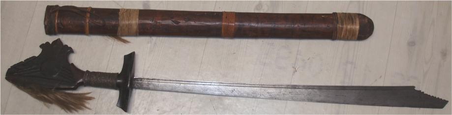

Hi wizards and experts,
-New to the forum I'd like to share some images on a sword that I've been told is a Kampilan but that has a handle I haven't seen in any of your forum images
Been in the family since 1930 and it was said to have been old already then when my Grandmother's brother picked it up in the Philipines
I would be interested in details on its origin and what you think about the handle...(why it is different from any other handles I've seen for Kampilans on the forum)
The blade is 70cm (27.5")
Thanks
Per

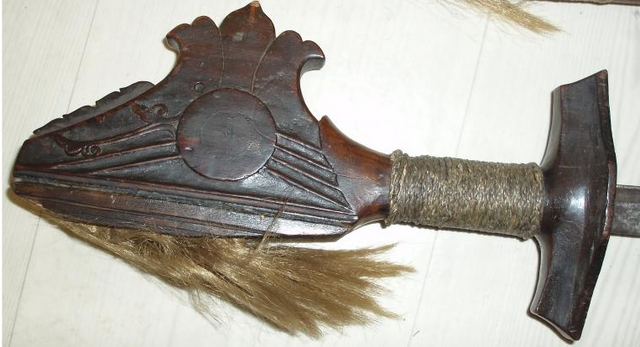

The handle style reminds me of Spunjer's avatar .
The blade ?
Very oddball for a Kampilan .

If you have a look in Leiden's picture database you will find resembling ones with hilts like yours collected on Timor (at www.rmv.nl)
This doesn't necessarily mean that yours has to be from Timor but that it probably is an older variation, that somehow survived longer
among the ex-pat Llanuns who were culturally isolated on Timor.

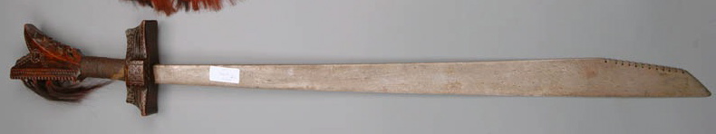

On the blade-tip it resembles a bit one of my older ones (enclosed), even if it goes the other way.
I suspect yours maybe has been reshaped based on what resembled traces after holes from brass-studs and a reshaped tip (maybe broken?)?
Congratulations to a very interesting and rare variation!

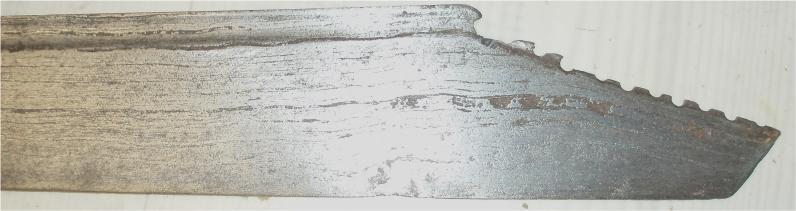

I thought the presence of a fuller somewhat unusual .

Copied your picture in case the photobucket link disappears in future. Nice handle !
Thanks Willem, i was just about to do that. Here's the other 2 images.

Beautiful kamp! And also an unusual sheat.

I wonder where the blade was forged; it is very different from the norm .
Everything about this sword is different from the norm.
The fiber on the hilt & sheath appears to be abaca, which is indigenous to the Philippines. A quick search shows the Dutch introduced it to Sumatra & the British introduced it to Borneo for rope making. I didn't see anything about Timor.
While I agree Timor is most likely the source, it seems odd the originator didn't use a local product.

I'm betting the blade was not forged in the Philippines .
This forging style reminds me of a Sasak-or-Sumatran klewang .
Can someone out there please show me another example of a fullered Kampilan blade with exposed pamor-like grain like this one has ?
Per
Perhaps this sword should be referred to as a Klewang from Timor. (Zonneveld's Traditional Weapons of Indonesian Archipelago, fig 272, pg. 71)
If this sword made it's way up to the Philippines, it may explain the abaca on hilt & sheath. Trade between the islands is endless & if it passed through the hands of one of the lumad tribes it seems plausible to use abaca rather then the traditional use of hair, the Moro's would use.
Bill is offline
Hello ??
Anyone ??
We'll just ignore the strangeness of the blade then .
The structure of the blade ( so not the shape) looks like the Celebes and Bugi swords.... but thats just a guess.....

All we can do is guess; but I do not believe that blade originated in the Philippines .
