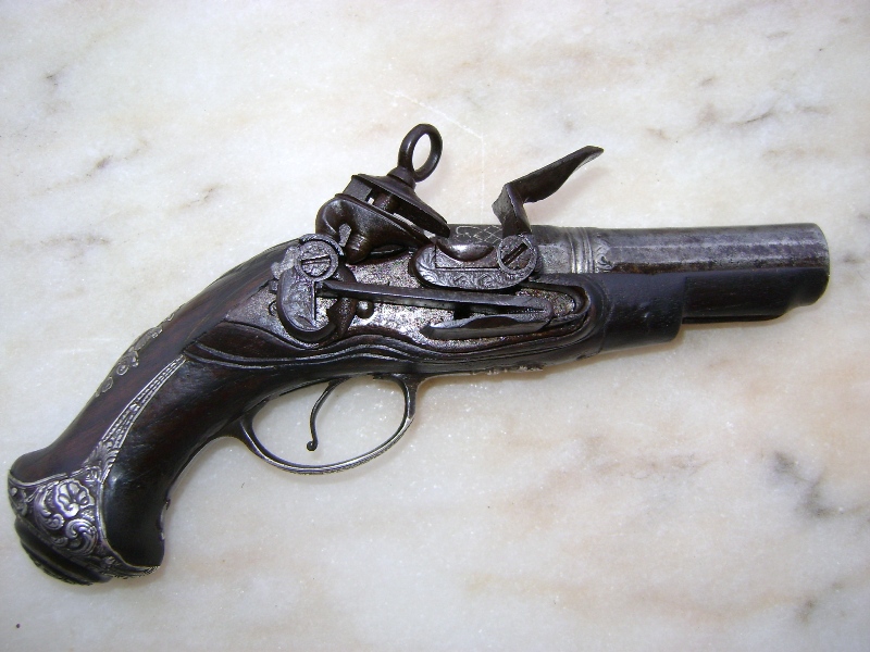

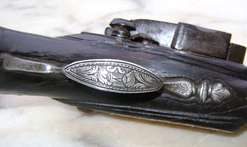

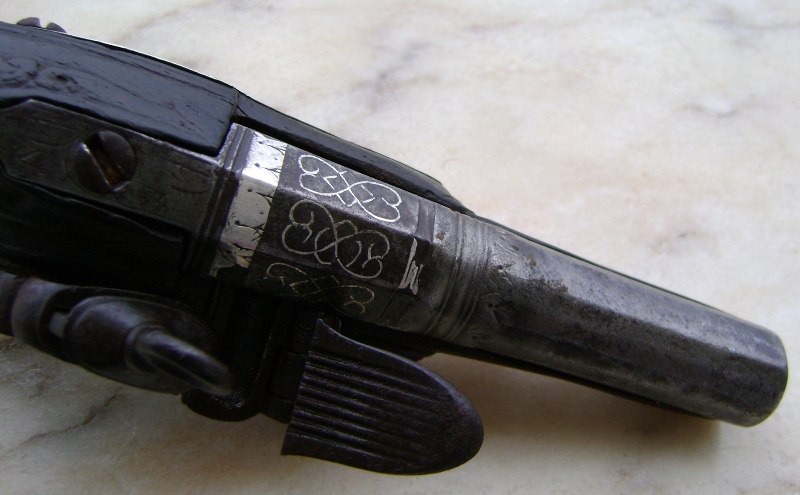

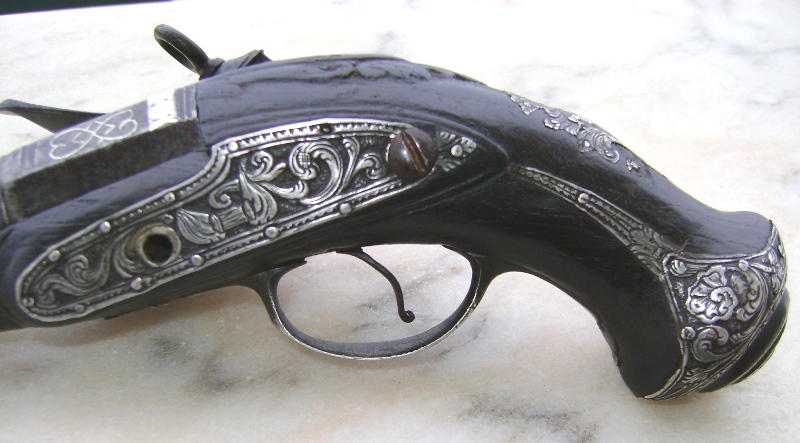

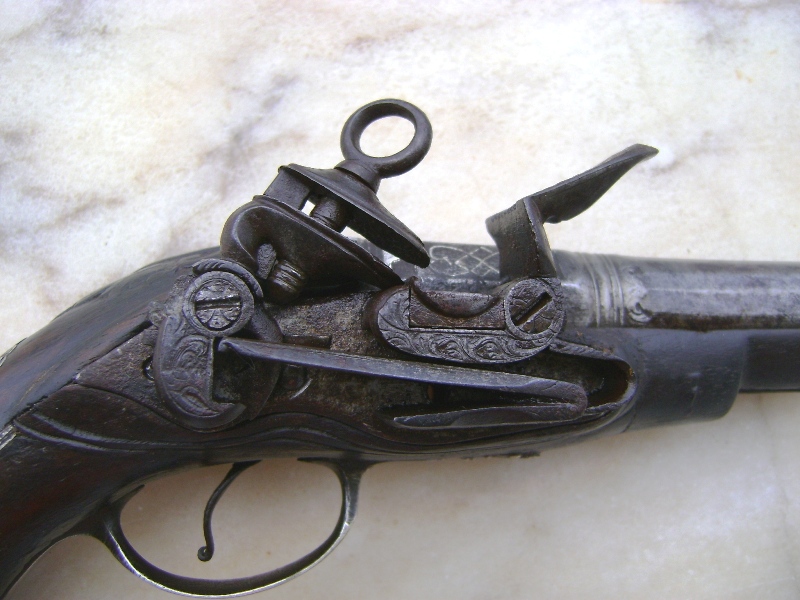

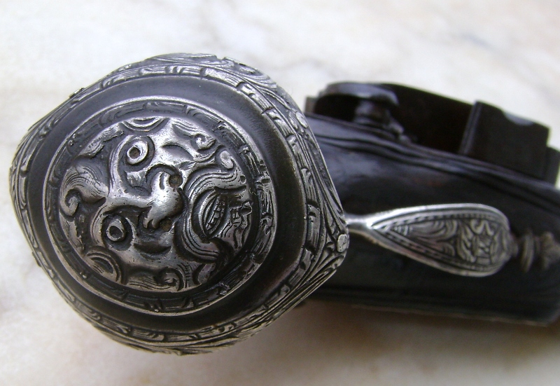

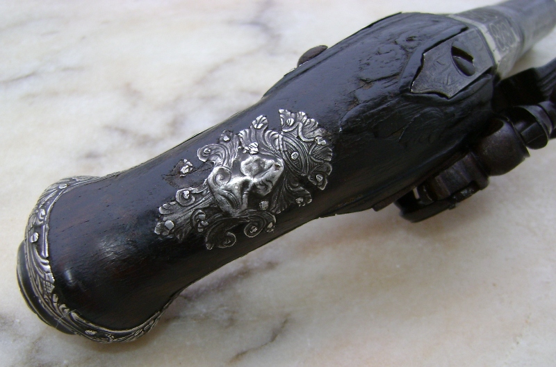

A little (pocket?) pistol with 19 cms (7 1/2") total length.
Patilha (Miquelete) lock.
Barrel, part three upper faces and part 16 faces.
Breech florals, side plate, trigger guard, estucheon, buttcap and grotesque face mask all in decorated silver.
Caliber 15 mm.
Ramrod missing.
Questions:
Age ... 18th century?
Origin ... Portuguese, Spanish or French with a Spanish lock?
Anyone care to comment?
Fernando

Though this is not as old as most pieces that am headed for I like your little pistol, especially the nicely constrasting blackened stock and the embossed silver inlays. Most of all, however, I admire the perfectly homgeneous surface patina.
I tend to assigning it to either Spain or Portugal, ca. 1730-50 but will look up what little I can find in my humble library (not a joke because I am not really overfed with books on Italian, Spanish and Portuguese arms). Also: I should not totally rule out Southern Italy as a possible provenance.

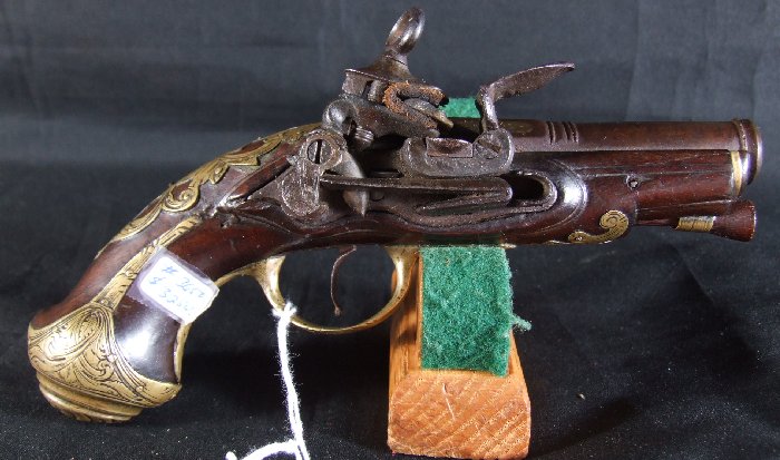

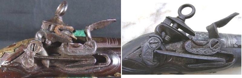

Beautiful piece. Caliber?
I hace seen identical verticsl stripes on the striking face of the frizzen in Spanish Migueletes.
Any punzon/poincon armourer's marks?

Very well observed, Manuel,
But South Italian, Sardinian and Turkish miquelets too have vertically ribbed frizzens in order to produce a bigger shower of sparks.
Fernando, there seems to be indeed a certain French influence in both the decoration of the barrel and the embossed silver on the stock. As there is no doubt that the lock originally belongs because the figured stock closely follows its characteristical contours, especially at the bottom line, the thesis of a French export model in the Portuguese or Spanish taste is worth considering in my opinion.

" Na minha opinião trata-se de uma pistola de pederneira, com fecho espanhol , com muita influência francesa.
A fecharia é nitidamente espanhola, muito usada nas peças de exportação. Aliás de espanhol só tem a fecharia. Se tivesse uma fecharia à francesa a arma era francesa. Não é de excluir ter sido feita em França para o mercado espanhol ... "
The caliber, as said, is around 15 mm.
There are no marks or punctions.
BTW, let me tell you that, to my ignorant eyes, there is a great resemblance between the lock of the pistol you posted above and my example.
Is that pistol yours? Can you post pictures of the side plate? I heard that if the plate is fixed with several little nails, it could be a Rippol weapon.
Can you establish its origin ... Spanish? Ripoll? this is very important ... please tell.
I have also detected a pistol attributed to Ripoll production, with the barrel in a fashion similar to mine: first section with an upper 3/8 faces and the rest with 16 faces all round:
http://www.armasantiguas.com/avancarca/htm/1086bls.htm
I wonder if this barrel profile is a Spanish (or even Ripoll) exclusive fashion; that might also be a way to confirm the origin of my piece.

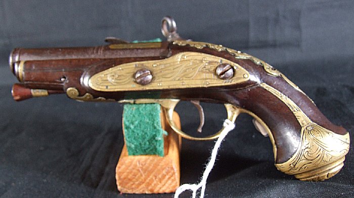

Zorry! The pistol's images I provided belong to a Spanish pistol found at an online auction service. Sadly, mine was not the winning bid, but I did keep the pictures for future reference.
Now, this one is mine (click on the thumbs) :

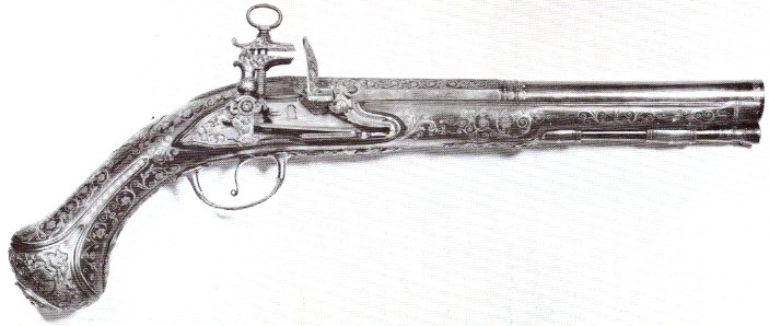

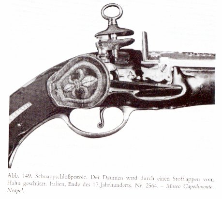

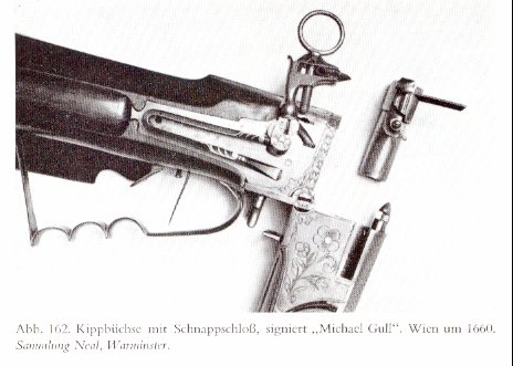

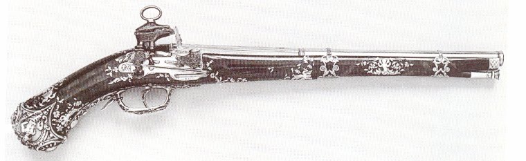

I attach scans of Italian miquelets, and even one from Vienna, Austria proving that these locks 'alla catalana', and of mediterranean origin, as Arne Hoff put it (Feuerwaffen I, 1969, p. 233) were widely copied while the rest of those guns mostly kept their national characteristics.
Finally I found two Spanish pistols very close to Nando's in the firearms catalog of the Museo Arqueologico Nacional, so please enjoy.

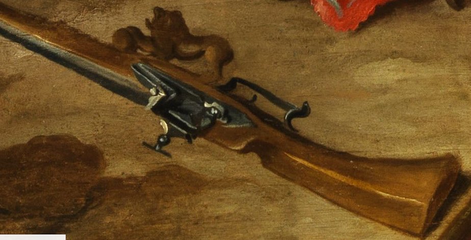

Default A Miquelet Musket on a Painting by Jan Brueghel The Younger, ca. 1660
The Painting is called The Allegory of War and was sold in a German auction house in September.
Note the Spanish military musket stock and the blued iron parts of the gun.
Michael

Yes, pistola #49 has a cock foot similar to mine, which is not the (more)usual straight profile. Same goes for the frizzen spring.

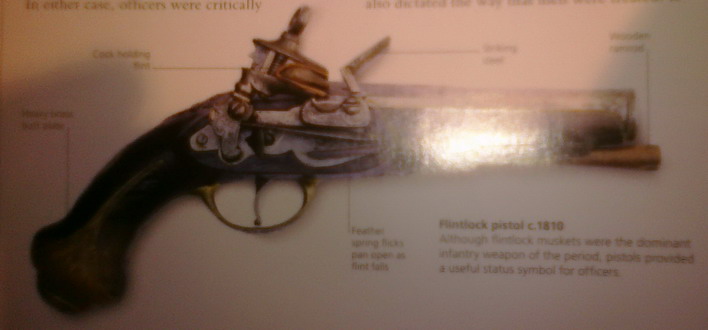

From a Borders bookstore book. It's dated to 1810...
M
