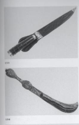

A new book arrived today with two knives pictured in it. I am curious as to the attribution of origin. This is not a test and the fist picture is from an area I do not have interest in but I still want to question them. Unfortunately the picture is a bit small and the blade is not shown. It is meant to be from an early collestion, 18th cent, the scabbard and handle do seem familiar? I will post the other picture latter.

Hi Tim,
The hilt is reminiscent of 18th C hunting swords and the scabbard suggests the type of knife known as the 'English Bowie'.

Let tackle this another way. Does this knife look like it could be 1700s Ottoman?

ingelred
Location: Moenchengladbach, Germany
Posts: 62
I would vote for central Europe.
To me it looks like a German or Austrian hunting knife, a so called Nicker.
No, not at all.

Location: Australia
Posts: 51
I'd tend to agree with Norman on this, it looks similar to the Naval dirks of 18th century Europe, and the sheath/ scabbard is reminiscent of the English sidearm/ knives of that period. This one is on the Michael D Long militaria site.

Posts: 2,928
What worries me about this knife is the sheath having the big leather belt attachment with belt slits. Like on the FS commando knife.
I'm only aware of that being used on later 19thC knives.
Might be wrong of course.
I'd have expected a 'button' like on the one Bryan posted

Thanks for all the replies, they have been really helpful.
I too was curious about the scabbard belt slits. I would very like to add to this thread but I have a BT moden problem which will hopefully be sorted by the 19th of Oct. I can say that this knife and the other example I intend to post are from a famous? German university collection. As soon as I can I will continue. Thanks so far.

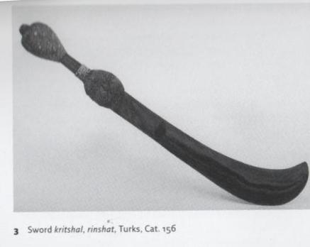

These pictures in question are from a new book of a university collection in Germany. The Asch Collection Gottingen- Siberia and Russian America, Culture and Art from the 1700s,-Prestel. I do not want write an essay as an invitation to discuss so here are just a few bits to start.
The Siberia and Russian America collection in the book is bulked out with some other stuff from China, Tibet, Europe and the middle east that does not interest me. It is not a book about weapons except for the two example shown. There are two pictures of the curved blade one a little bigger but still not good, can I see a snake on the blade? Africa? I have included the relevant text.

The remaining two, do not look Turkish to me as well.
Museum descriptions and attributions may be tricky, to put it mildly :-)
