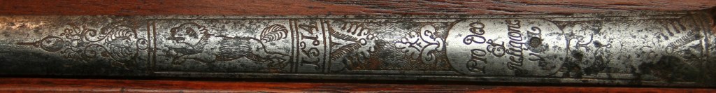

Interesting subject as always, Jim. Here's a sample to get you started; not one of your dates or necessarily a running Passau Wolf but numbers, a Latin inscription and a critter nonetheless. This is a rapier (or perhaps an espada ropera blade), 30 7/8" in length. (78.4 cm)
Looking decidedly un-wolflike and given the stocky build, brindle and pronounced blunt proboscis, I'm leaning towards an Alano Espaņol for the critter. I have seen it engraved on both a miquelet lock and a powder horn, although it was depicted wearing a collar in both those instances. The inscription translates to: "For God and Religion" but there are some letters following that I cannot make out. As far as I can determine, nothing of world shaking import occurred in the European sphere in 1514.
(Caveat: European arms are not my bailiwick so I could be wrong about any or all of the above ;-)

Doesn't look like the Running Wolf of Toledo, perhaps one of the many subsequent german variations..?
The style of engraving doesn't seem to correlate to 1514, nor the relatively thin blade.
The latin motto might be "Pro Deo et Religio Vera": For God and (the) true religion.
The pro deo inscription seems to be common in Poland and surrounding areas...
In Sept 8th of 1514, a coalition of Poles an Lithuanians defeated the Russians.
Best
M

Excellent example Ray!!! and thank you for these observations. You seem to have a pretty impressive understanding of things European despite the modest note The running wolf was a profoundly stylized, almost temporal, image which was used and copied widely in almost countless variations. It seems to have almost always been chiselled or placed with chopped, sticklike lines, and these more artlike figures seem more associated with mid 17th into 18th century European blade motif, quite contrary to the 'Passau' wolf.
As Manuel has well noted, the inscription resembles Polish and Hungarian examples of these periods, but this blade, which seems likely a smallsword or court sword type, may well be from a number of European locations. Most interesting is of course the numeric '1514', again seemingly recalling a date year, and in similar number groupings as others discussed.
Thank you Ray and Manuel for coming in on this, and Ray, for sharing this example which is a perfect example of these variations.
