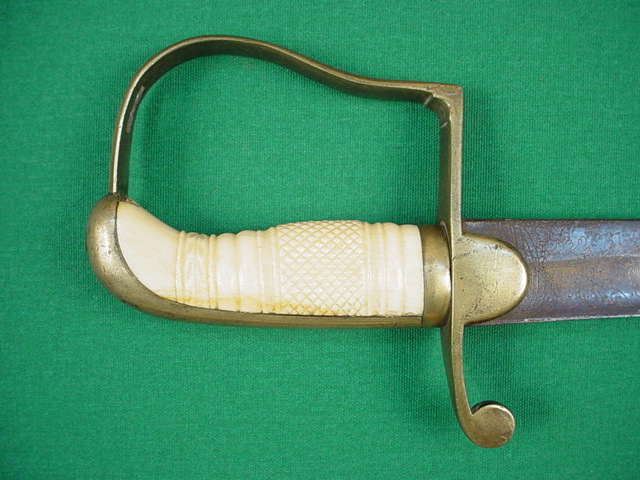

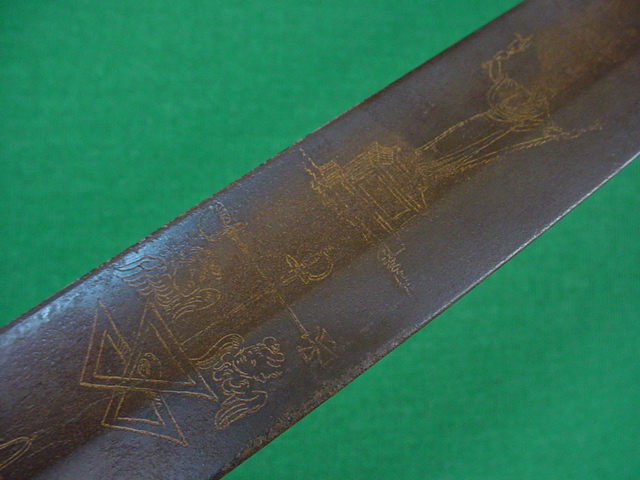

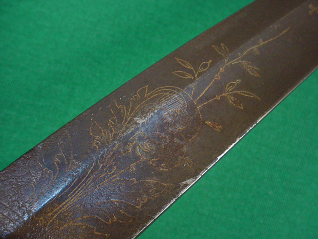

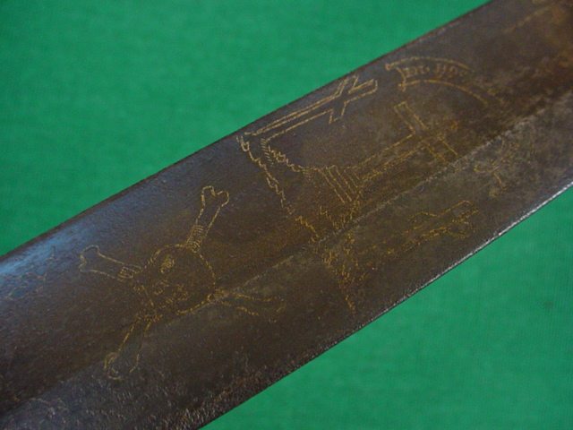

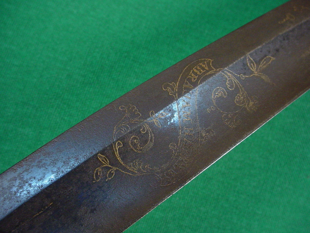

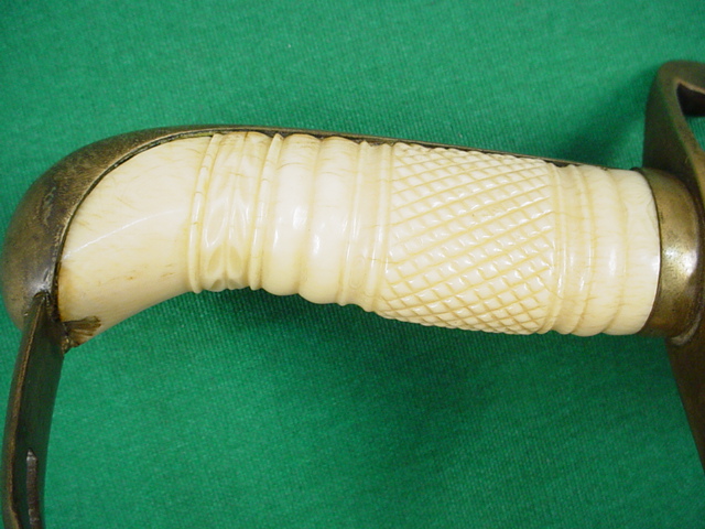

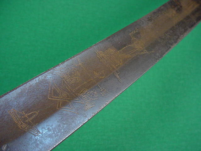

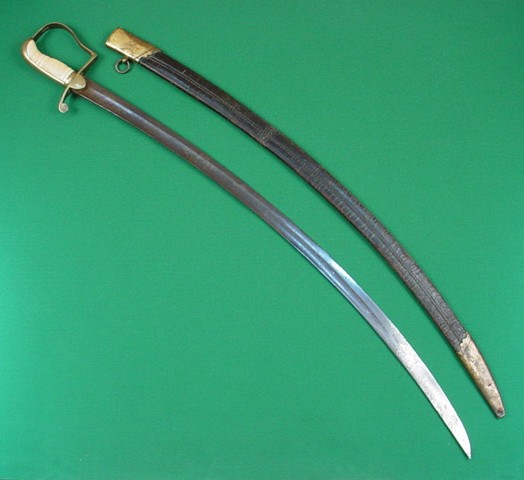

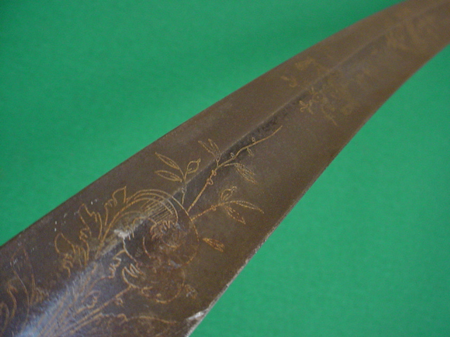

Attached are images of a cavalry sword that (to me) describe York Rite affiliations. I have not been able to determine whether the sword was carried in America or in Scotland but the familiy name leads a fairly meryy chase.
The Phoenix Masonry museum page has at least one standard military sabre that may or may not have simply been a lodge sword. Collectors Firearms of Texas has an interesting 1796 cavalry sword that was donated to a lodge. Another name (Knowles iirc) to research and perhaps appreciate. The skull and bones hilt sword is/was listed there as well. I don't find that I ever downloaded those to my drive for research but they come to mind.
The sabre attached here was sold by and I assume was photographed by Stephan Juan of Antiquefirearms dot com. While on my lists to buy, it sold before I got there and it was as much the engravings and named aspect that was of primary interest but it's a great looking sword even without that addition.
Cheers
Hotspur; I could be imagining it all as well but there is symbology enough there to draw some conclusions

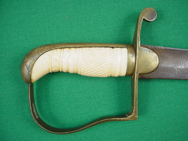

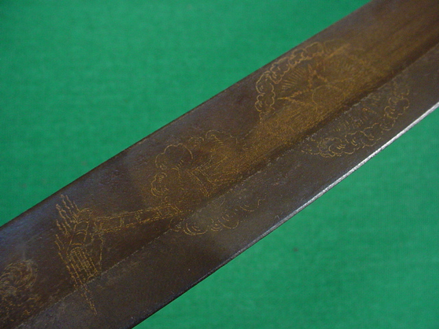

one more

Hi Glen,
Great example, of no doubt masonic symbols on a late 18th century saber. But, I am not sure it answers my question of; were officers allowed to put obvious Masonic symbols on their regulation field or dress weapons? Clearly symbols appear on Masonic ceremonial pieces, the Ames catalogues show obvious symbols on military presentation pieces, and Hamilton cites examples of symbols added to retired military pieces, but I can't think of a mixing of clearly masonic symbols and the usually military motifs. Was it against regulations? What I am getting at is; A large number of officers in the late 18th century, early 19th century were masons, who clearly found some importance in symbols, it would stand to reason that if they were not allowed to openly display there signs, they would go to more covert methods.
I really don't know, but, still think it is possible that the original bead hilts do have some masonic significance. However it is very far from being proved. I also believe that the significance was lost as the original hilts became the style which further muddys the water.
All the Best
Jeff

Hi Jeff,
Yes and no in my reckoning. No, on a good number of regulation swords but I would think unavoidable as add ons in period military use. The sabre I attached (again in my reckoning) the is either a British or Scottish yeoman cavalry officer's everday (as it were) sword. Strict regulation even there does not apply in that instance. As possibly American (where did I put those name notes) a militia officer would still be able to order what he pleased. That sword in hand might make me a happy camper in further research of it.
The American militia acts and regulations only require a sword. American military regulation regarding officers swords was widely disregarded, as they were also private purchase. That went on through to the second half of the 19th century. Right off the bat, the castings for the pre ACW American militia swords share the cross on the guard.

Hi Jeff and Glen,
It seems to me the blued and gilt blades I have seen are typically end of the 18th century, and well through the 19th. The cabalistic and talismanic images on blades I am referring to are typically on Solingen blades and various European blades, the concept of which seems to have originated on hunting swords (Blackmore). These symbols became well known on trade blades often found on colonial swords such as kaskara and many others.
The absolutely beautiful and mysteriously etched sabre Glen posts here is a British M1796 stirrup hilt sabre of the form for light cavalry officers, but this one is clearly a yeomanry version. I have seen many of these types for yeomanry, often ivory grips and gilt hilt, the blades typically with military motif and devices blued and gilt. It is well known that British officers of these times had considerable latitude in thier fashion, actually Beau Brummel himself was for a short time an officer (I believe possibly 10th Hussars as he was a friend of the Prince of Wales).
The etchings on this blade (the sword itself would date c. 1805-20 I would think) would seem to strengthen the profound presence of Masonic brotherhood in military officers. While swords certainly followed certain accepted hilt patterns, the blade, and its markings would not be open to any particular scrutiny. I suppose much in the way a tattoo covered by a uniform still holds personal meaning to an individual, but remains unseen by others.
In "The American Fraternal Sword" (p.12) it is noted that in the 18th century military hangers and gentlemans smallswords were used by Masonic sentinels and in ritual degree work. As sword patterns were superceded, often the older swords found use as Tilers swords in lodges, and were held in high esteem as implements of war, and well placed in thier function in guarding the lodge and its proceedings.
It would not seem surprising that an officer such as in yeomanry, heavily engaged in social function and particularly lodge affairs, would have its blade etched accordingly. If called to duty, the fervently marked blade would certainly strengthen his valor temporally. This is of course the concept that has imbued sword blades with such markings and inscriptions from the earliest times.
It would be extremely important to discover if the origins of the multiple beads had other than British origin, and in what period the motif began. I have of course seen the single longish bead or device typically seen in the center of the knucklebow, and it does seem these occasionally have what does seem artistic embellishment. As far as I can recall, I have not seen accompanying features en suite on the crossguard and the device seems singular without specific purpose other than adding symmetry to the guard.
But then...who knows ?
All best regards,
