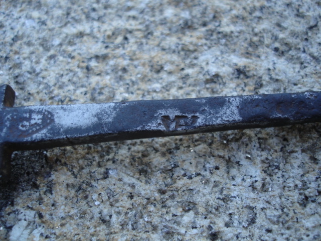

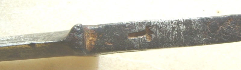

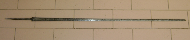

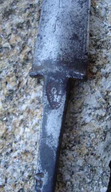

An old blade, possibly rom a rapier, and possibly from the XVII or XVIII century.
I first thought it would be Portuguese or Spanish, but someone sugested Solingen.
May any member discern where and whose these marks are from?
Thanks in advance.
Fernando
The pictures have distinct backgrounds because i had to choose them from various atempts to get reasonable takes ... allways difficult to picture tiny marks.

your blade is definitely a Dutch 18thC small sword blade.
(not a rapier blade; a rapier is at least 110cm long and on each rapier the fore-finger touches the blade when holding the rapier, therefore the ricasso is not sharp)

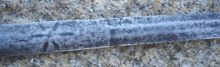

more of importance this star shaped figure has only been found on Dutch small-swords. (cf J.P Puype.... blanke wapens)

the blade type flat oval to hexagonal was very common for Dutch small swords from the first half of the 18thC. also the star disappeared after approx 1750.
the 18thC Dutch sword makers usually signed there blades not with a stamped mark but with a script. name and address of the shop see picture (jean Hosse Mr swaartveger op de vijgendam tot Amsterdam).
your blade has a stamp GH.
there was a silversmith named Gerrit Hoying who made a lot of beautiful silver hilts for small swords. not the blades but just the hilts.
It can be that your blade has been delivered (by another fourbiseur) to the silversmith with the initials GH.

It is true that the star on the blade - a so called paternoster? - is often associated with Dutch blades. I am afraid that I haven't succeeded in identifying the mark on the tang..
Meanwhile i have being paging some Portuguese books and auction catalogues, and swords with this type of star mark make a regular appearance. Then again, the fact that they appear in Portugal doesn't impeach that they were imported. Eventually two of the samples i located are tagged as Portuguese, namely one with a typical hilt style ... the so called sail hilt.

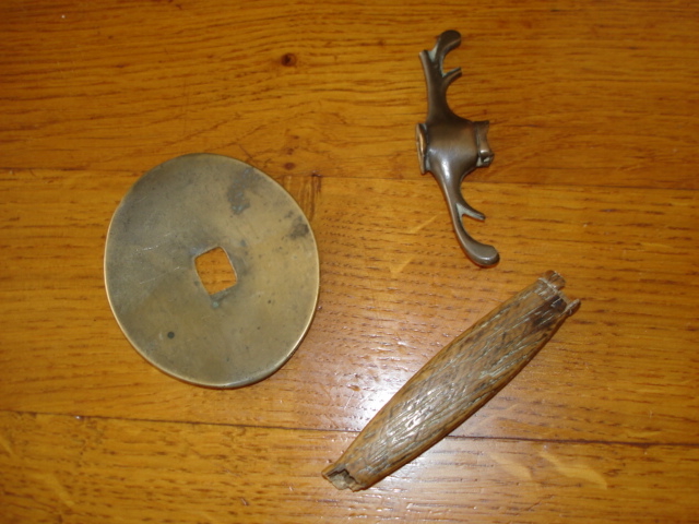

BTW, a few days after i bought the blade, the seller told me it had some ugly broken parts mounted in it and, as he 'knew' they had nothing to do with a real sword, he threw them into the trash depot. As i doubted his knowledge, i asked him to try and recuperate them, which he did, and then i found out the parts are the remnants of an actual small sword ... a humble version, but still real parts.

I gasped at the story on the sword parts tossed away! Nicely done in saving those components....I cannot believe such attitudes regarding preserving such history.
