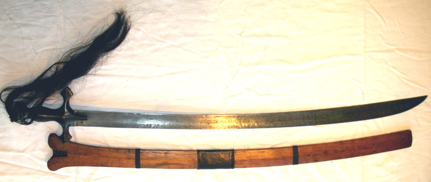

Here it is (Original Thread):
length: ~75 cm / 30"

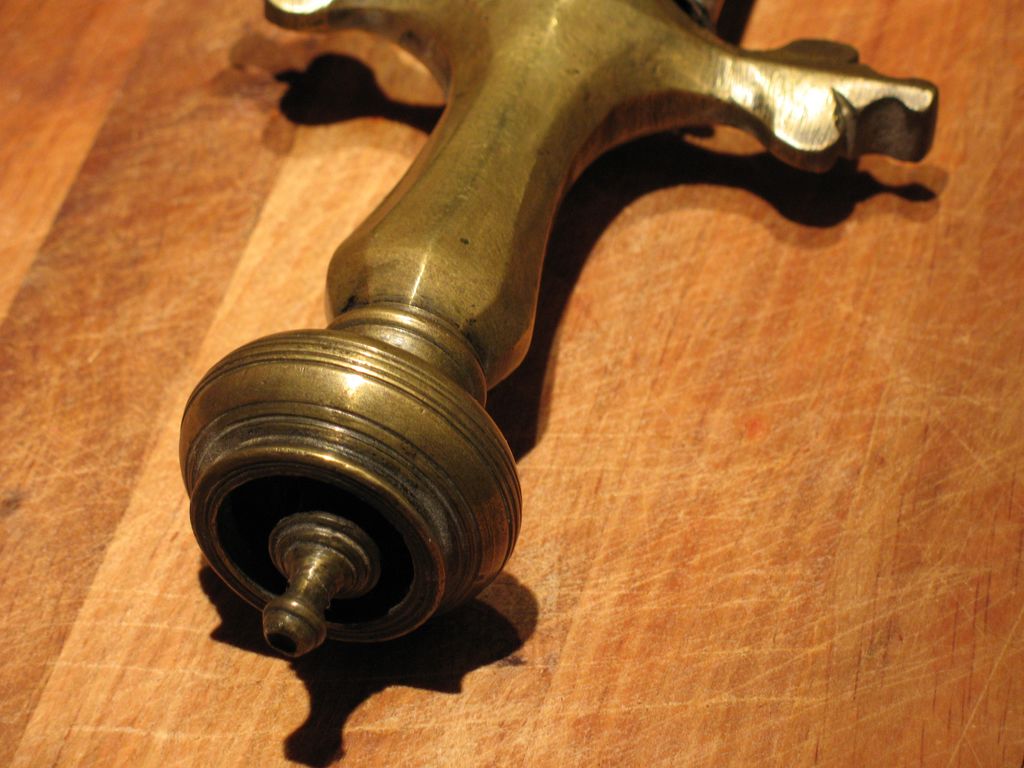

details of hilt:
hollow pommel:

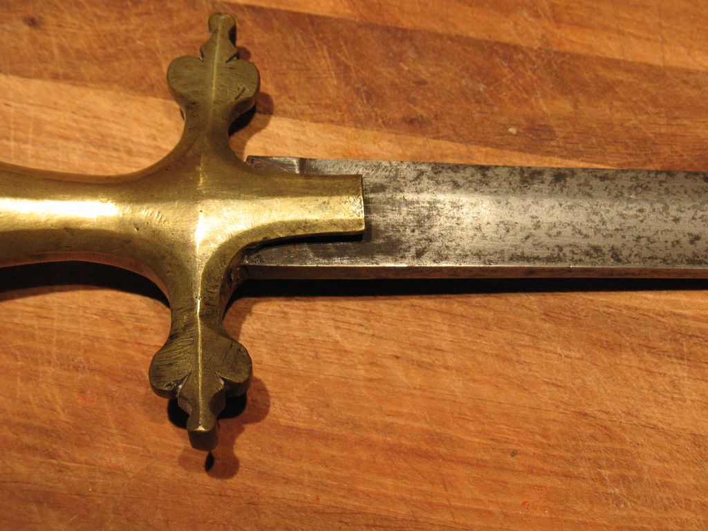

Posts: 29
details of blade:
smith signature ("RTD W D CAS TL" or so, and an arrow shape):
double line engraving, beginning...:
...and ending:
the ends of the double line engraving are marked by the Swiss pocket knifes:
back of blade (7mm / 0.28"):

Old 22nd May 2009, 10:36 PM   #3
Dinggat
Posts: 29
Details of scabbard:
Lower third is held together by rotan strings. I presume there once was a chape of the tin (?), but it went missing and some creative Iban fixed it with rotan.

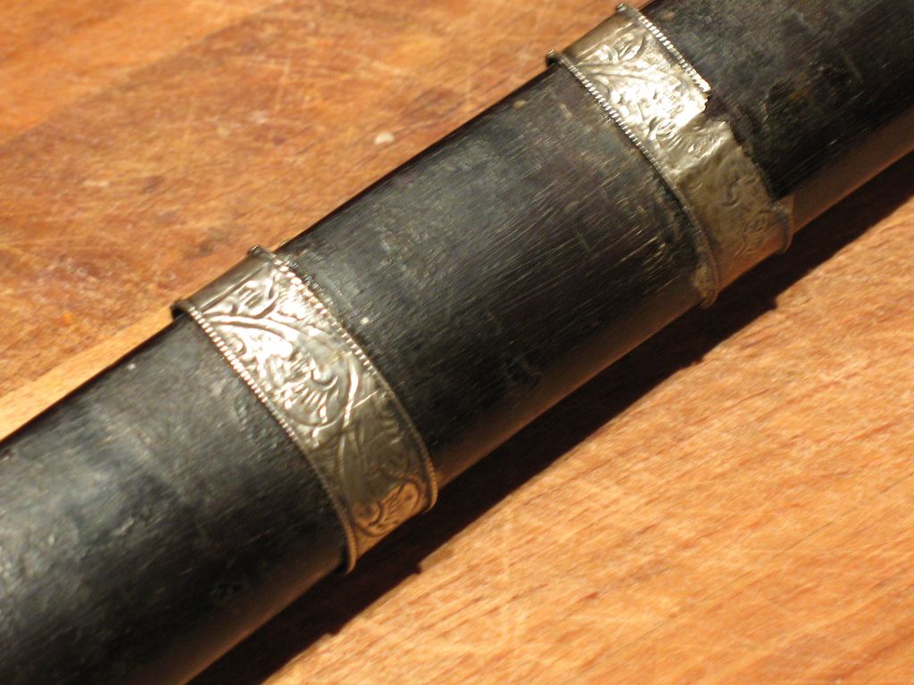

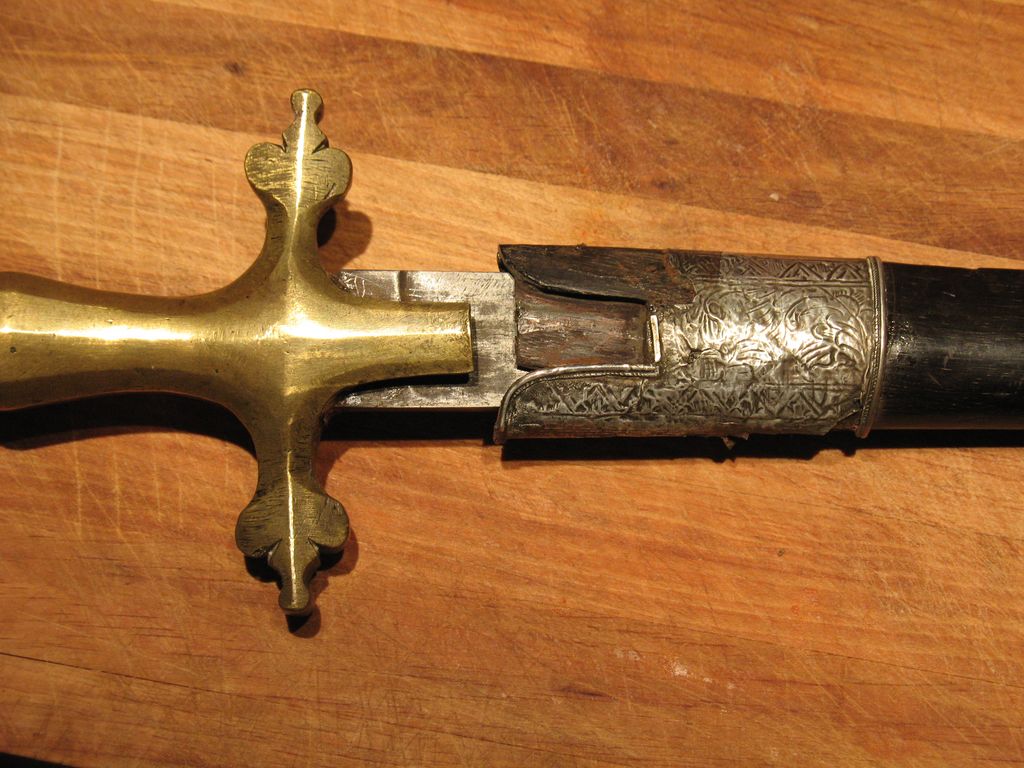

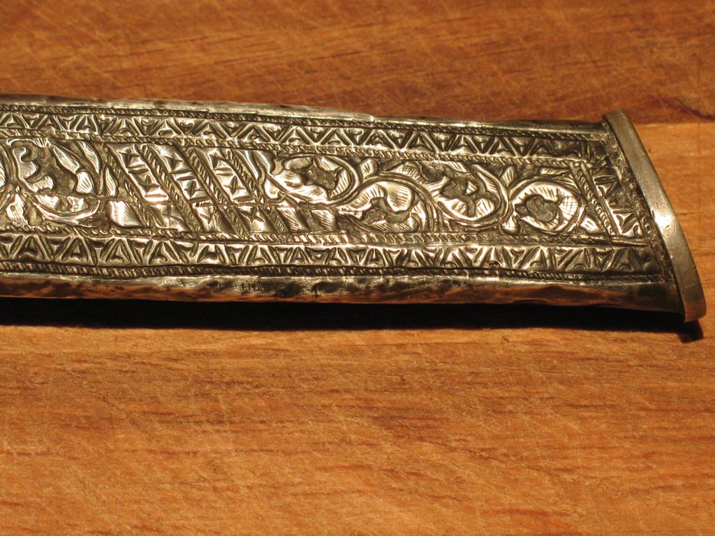

Old 22nd May 2009, 11:07 PM   #4
asomotif
asomotif's Avatar
Join Date: Nov 2006
Posts: 2,238
Nice one. The real thing !

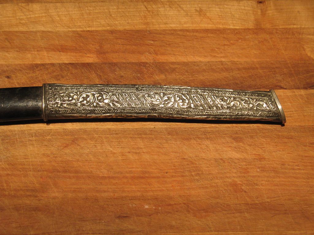

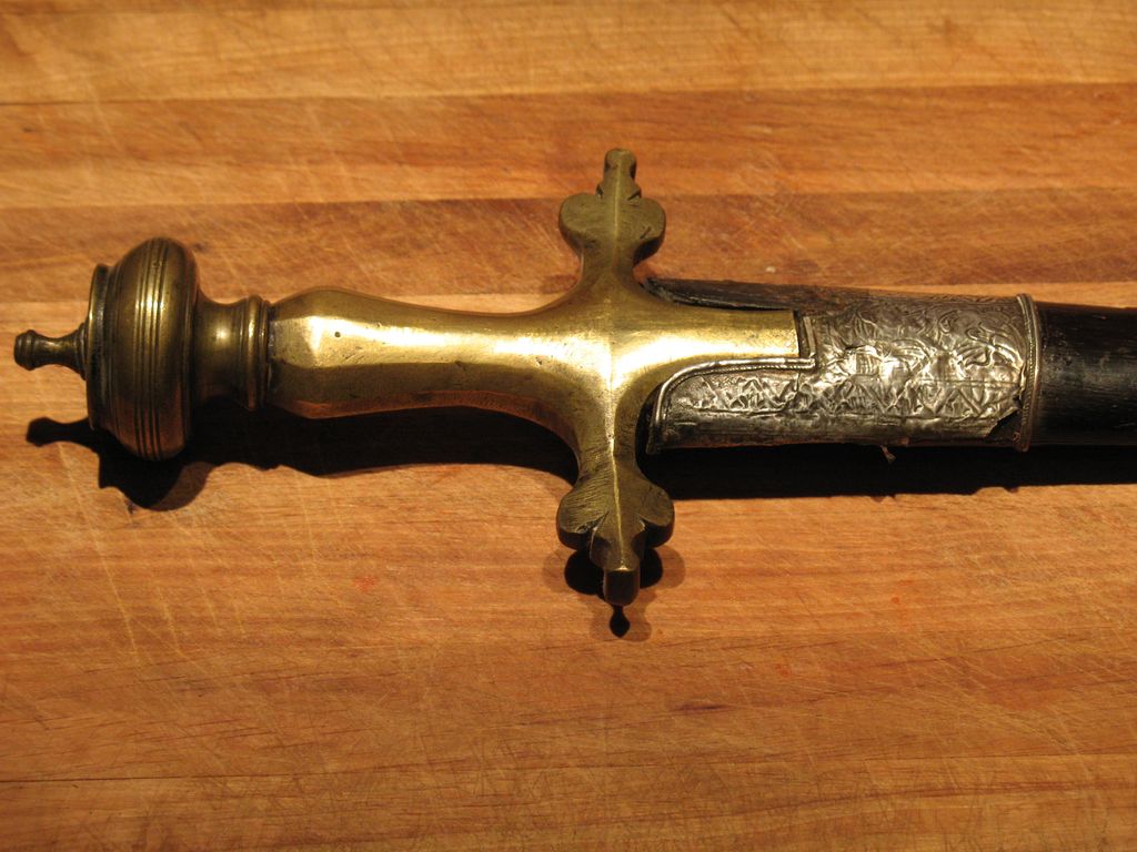

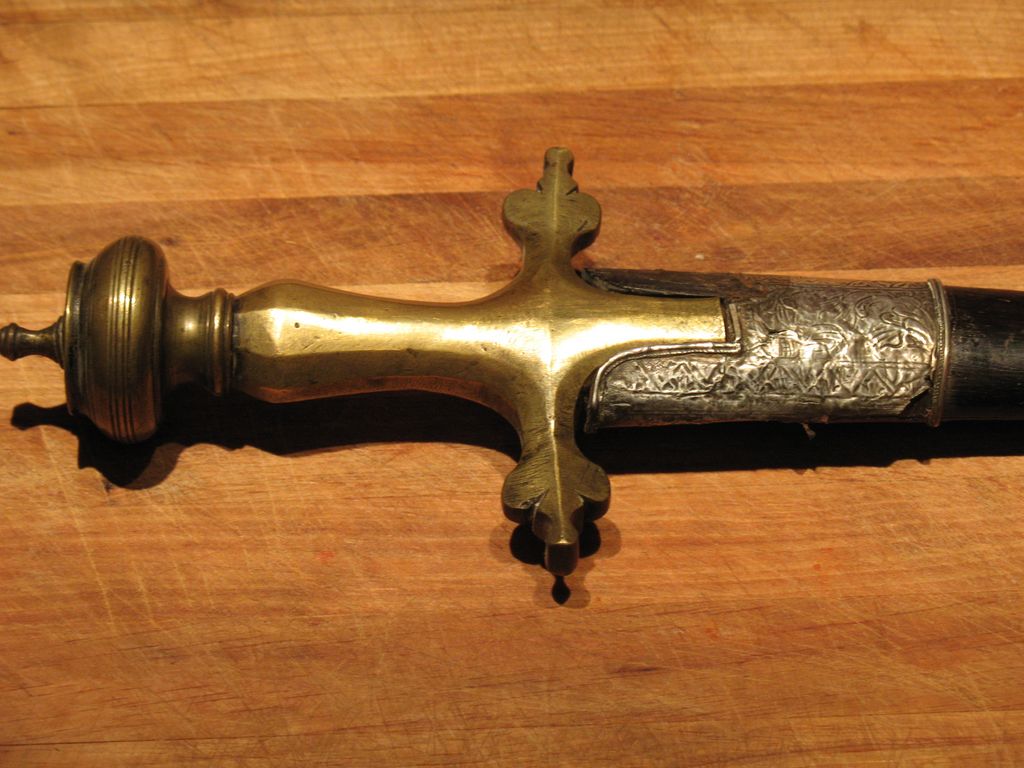

Here are some details of my example.
Old 23rd May 2009, 12:22 AM   #5
Posts: 6,436
A question; what makes this Iban ?
The scabbard decoration ?
Is this sword not transplanted Batak ??
Old 23rd May 2009, 03:41 AM   #6
Dinggat
Posts: 29
Hello Rick,
this weapon was not made by the Iban, but rather owned by the Iban. Maybe the title is a bit mistakable.

Old 24th May 2009, 07:58 AM   #7
Dinggat
Posts: 29
asomotif: Your one looks almost exactly like mine! :eek Is it also from Borneo?
Do you know how the blade is fixed in the hilt? The blade of mine is very loose, but I can't pull it out completely (I only tried with slight force, don't want to break anything). Would it be wise to try to remove all the rust on my blade? Or should I just keep on oiling it?

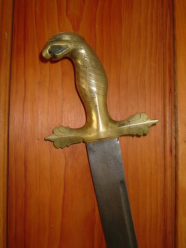

My example has an eagle head and no langets .
I wonder ..........
No scabbard but a nice non Euro blade identical to fig.433 pg. 110 in vZ's book .
I have only seen one other example of this hilt and it was broken and repaired .

Old 25th May 2009, 12:15 AM   #12
Posts: 6,436
here it is .

As this sword didn't originate among the Bataks, but in India, and as it is found independently, without any Batak connection, in Peninsular Malaysia as well as Brunei, Sarawak and Sabah I think it's incorrect to label it a Piso Podang (the Portugese influenced Batak term).
Michael,
I already hoped that you would step in. as you often have the more correct background info
Nice example Michael you have there.
Interesting is that the scabbard has no metal fittings.
Often to me that is one of the indicators for Borneo origins.
The problem nowadays however is that among the tourist shops in Kuching Sumatran keris and swords are imported and sold as souvenirs also in Sarawak.
Yes, this development is really killing for collectors and for correct details.
A lot of the vendors appear to be from chinese origin, selling "original borneo antiques".
I encountered the same on Zanzibar, some 10 years ago.
Indian salesmen would sell woodcarvings, masks an statues from literally all over Africa in their shop on Zanzibar and sell them as "Zanzibar" antiques.
While in fact original items from Zanzibar where hard to find.
Willem
