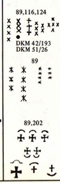

On some trade blades I have seen there appears an apparantly stamped grouping of three crosses of the 'maltese cross' shape. The most readliy recalled example I have seen occurred on the blade of one of 'Zanzibar' form of 'nimchas' (these with a crossguard ring can be seen in the 1933 publication of the Buttin collection). This example was from a grouping of these sa'if's that apparantly came from Zanzibar and were located in number in Yemen some time ago.
This representation of the triple crosses clearly suggests similar markings from European blades that of course carry the Christian religious symbolism of the Holy Trinity that often occurred in various application in makers marks and talismanic motif. However, as we have discussed, the numeric three has a very wide application in not only the symbolism in most other religions, but in esoteric and occult symbolism and allegory.
A number of years ago while visiting an alchemical museum at a castle in Heidelburg, Germany I noticed that among an apothecaries cabinet's drawers was one that supposedly had housed a chemical compound considered a poison. On the drawer were the same triple maltese crosses, that I was told symbolized death. I found that interesting and recalling the triple crosses seen on the Zanzibar blade, and have often wondered if that application might have had any connection with occult symbolism on blades.
We do know that alchemical allegory was employed in talismanic motif on European blades, and that such symbolism likely influenced blacksmiths and swordsmiths well aware of alchemical esoterica. The maltese cross occurs as a component of symbols of numerous elements and chemicals in alchemical charts.
Could there be a connection with the maltese cross symbol from alchemy, applied in three as on the apothecary poison warning, to markings used by makers on blades? Obviously the native copies found in Zanzibar were applied in imitation of European markings much as the dukari on takoubas without awareness of such meaning, or could the meaning have been known?
I'd like to hear what others think on this, and would like to know if anyone else has seen triple cross markings on blades whether European or native. Also, if anyone has the valuable Wallace collection book (a 2 volume set) which is profusely illustrated with European makers stamps and markings, perhaps any reference to same from that source.

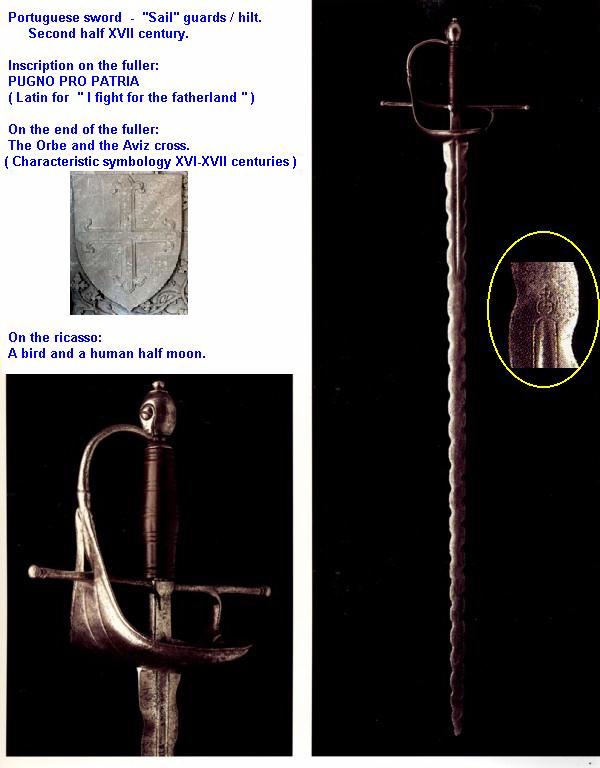

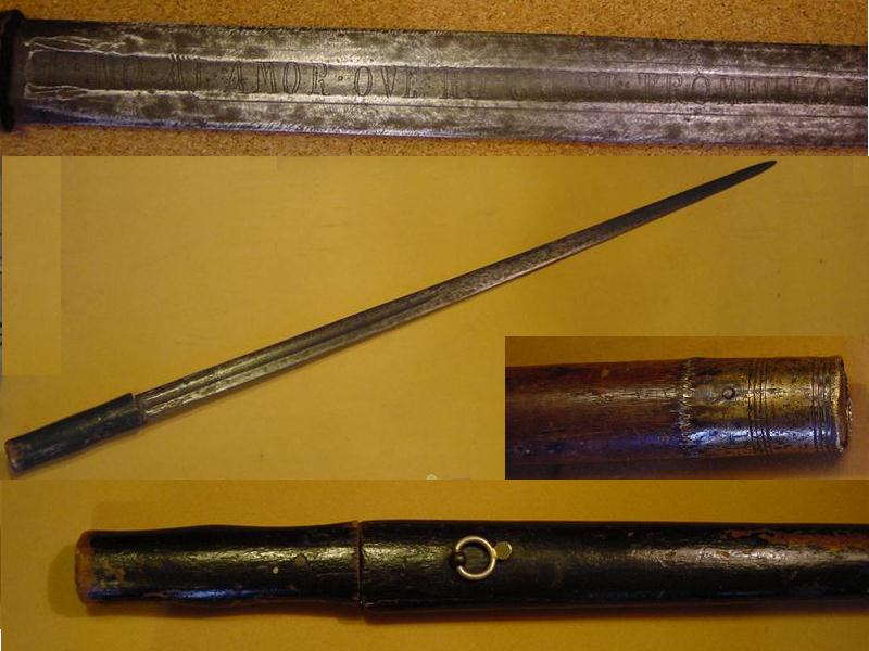

I first hesitated before posting this, as a trade mark.
It represents a version not yet included here as, being a motto, is a sentimental one, and not an honourable one, as already discussed in this thread.
But having seen this motto in two different specimens, in two distinct places, from rather diverse provenances, i presume this is after all a mark thas has been applied to swords from the trading circuits.
The motto is NO AL AMOR QUE NO CAVSE TROMENTO / SI NO ES FIRME CON ESTA ME LO PAGARAS = No to love that doesn�t bring torment / If it is not firm, you will pay me with this one.
I have it myself in a XVII-XVIII century rapier blade, mounted in a stick sword, possibly set up in the XIX century.
The other example is found in a beautyfull silver hilted cup guard sword, presently at the Oporto Military Museum, labeled mid XVIII century.
I ask you a thousand pardons if this situation doesn't fall within this thread theme.

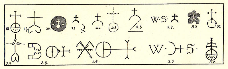

This is taken from Rudolf Cronau's Geschichte der Solinger Klingenindustrie 1885 ed. Pg 18
18-32 were located in the Dresden Museum. 32 was attributed to Johannes Wundes
Jeff

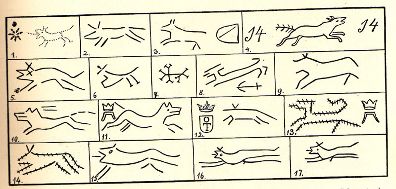

More Wolves from Cronau...
2. 14th century swords in the Berlin arsenal
3 . 14th century swords in the Zurich arsenel
4.and 5. are in the Coberg collection
6. on a sword in the Germanic museum c. 1490
7. A Dresden sword c. 1559
8.-15. more developed wolf figures
16. found on a sword with 'Jaspar Bongen me fecit'

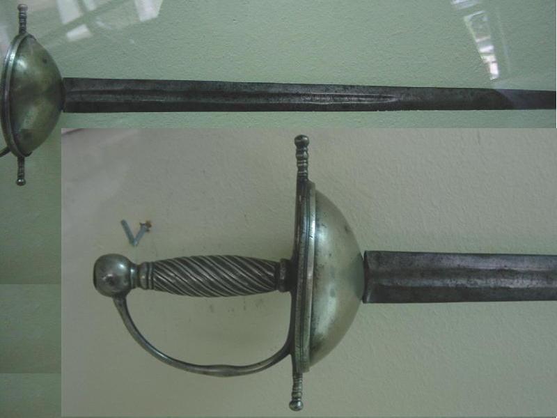

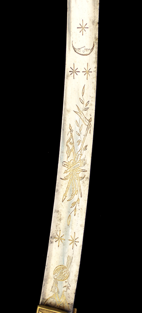

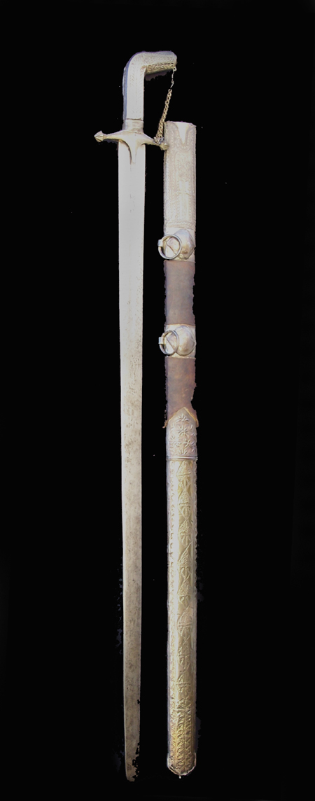

Greetings everyone, I found these swords that may fit into this forum nicely.
I can�t give you any intellectual insights on any of these swords, but what I can give is, some pictures worth a thousand words each. Hope these will help in a small way, in your endeavors to understand early makers marks.
The first sword may be a German export to Turkey; or not.
The second one is an Arab Shamshir with either a locally made blade, or an import, or a battlefield pickup. Don�t know for sure. I know you will probably like this one. It has your running wolf mark.
The last one is an English Mortuary sword with blade manufactured in Solingen. Lets run these babies up the flagpole and see if any body salutes.
Ya, I know, I can�t believe I said that�
Best regards everyone.
Don F

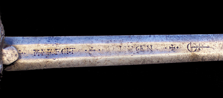

How about the more obvious 'ME FECIT'. This goes back to the 9-10th century and I think is still used today. We all know it means 'Made Me' . Did it have any other significance, such as superstitious/magical, quality or indicate maker master qualification?
What language is it? A lower German dialect? I don't think it is Latin.
Jeff

Hi Jeff, may i come in ?
Jeff (Quote).
Latin, no doubt!
I guess it has no other conotation than that of its direct meaning. It appears in other than swords, even churches. Altough its correct use would be "somebody made me", it apparently appears with the wrong sequence, like "me fecit Solingen", potentialy meaning "made in Solingen" ... or "Solingen made me"
Fernando

Originally Posted by fernando
^Hi Jeff, may i come in ?
Latin, no doubt!
Fernando (Quote)
Thanks Fernando, I guess 'sometimes a cigar is just a cigar'. I think I spent too much time in musty old books this week .
All the Best
Jeff

Hi Jeff and Fernando,
Jeff, good call on the ME FECIT SOLINGEN inscription, which typically was with a makers name, presumably at least. It seems that the catalogued items in the Wallace Collection carry a number of examples of this combination, the ones I found mostly 17th century rapiers. I think what is most interesting about these presumed Latin inscriptions is that the spellings, wording and syntax are typically somewhat inconsistant. Also the weapons carrying these blades in the period suggested are actually Italian, and while there are the discussed inscriptions such as one c.1650:
PAVLLV WILLEMS ME FECIT SOLINGEN

NO ME SAQUES SIN RAZON ; NO ME EMBAINES SIN HONOR
is not entirely Latin, nor Spanish linguistically ... Jim (Quote)
Unless a cigar is not just a cigar, i would say, in my empirical view, this phrase is well built and completely Spanish ... Castillian, to be precise.
But as you very well know, they used it all over, as also Portuguese sword makers; sometimes well spelt, sometimes not.
All the best
Fernando

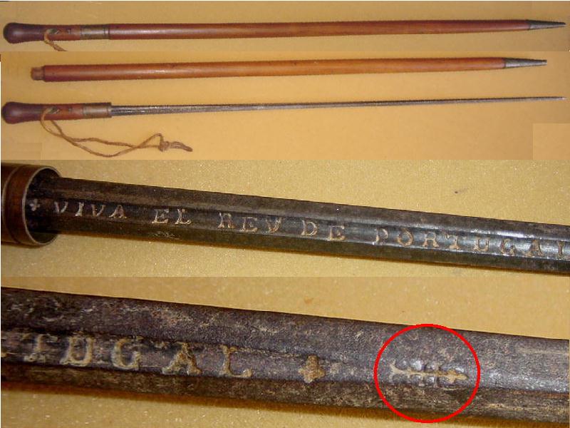

"Three in one"
Speaking of multi marks, and orbes+crosses mentioned by Jeff.
In this Portuguese specimen, we can find mottos, symbols and marks ... all for the price of one
These "Sail" guard swords come right after the cup hilt examples depicted in "Armas e os Bar�es", by Eduardo Nobre.
Maybe (some of) these are not trade marks, but maybe they still can fit in
Fernando

The Hounslow swords from England were indeed often marked with the ME FECIT SOLINGEN line typically along with the makers name, most notable Iohannes Hoppe. Some only carried the running wolf, and some of these instances carried into the later German enterprise at Shotley Bridge, but I dont think those used the ME FECIT. Eljay's knowledge on the 17th and 18th century European swords is outstanding to say the least!

Hi Jim,
In Danske Blankvaaben by Kay S. Nielsen, Forlaget Sixtus, 1978. Resume in German at the back of the book.
Around 1600. In the fuller inlaid with copper ME FECIT SOLINGEN
Around 1610. CLEMENS MEIGENN inlaid with copper.
Around 1680. In each of the four fullers IHESUS inlaid with copper.
Around 1700. Crescent and three stars on both sides.
Around 1700. On both sides sun, crescent, stars and an arm with a sword.
Around 1708. XX IN X MINI XX on both sides, in the fuller.
On many of them you can see the king�s monogram and a crown as well.

As you say, there are zillions of marks on the ilustrated examples. It would be nice if you volunteer to scan some of them, specially those that appear to be common to the sword theme ... you were the one that came up first with the idea
You have for instance a symbol that appears to be popular around, as it is shown in Italian and British examples: the anchor ... yes Jim, that's the name ( at least ) used by Evans.
This is to coincide with the mark applied to a piece i was about to post here, after checking its viability with Jim. This because the piece is a sword stick, not so much apreciated by some, but with an interesting blade, which i will first let Jim to make his expertized coments about. If some further detail needed, i will secondarize with the respective info ... if i can
This will confirm that the anchor symbol was assigned to several Masters as, besides Italian and British, it also appears in Portuguese blades ... or Spanish ... or both. Jim has comented that this symbol doesn't appear on the famous Tomas Ayala blades. In this case, the nice example i saw yesterday being discussed in a determined Forum ( i think i lost it ) was a fake ... which is quite frequent, although in this case the blade was very well forged, i would say worthy of a master.

Thank you for the note on the marking we were discussing Fernando.....the ANCHOR! That would make sense, and the flayed arms on the base does correspond to the shape of anchors in a sense. Since there is a relation to these and merchant marks used often used by traders, it adds to the plausibility of the term. I was incorrect in my comment on this not appearing on blades considered associated with Ayala, in retrospect it seems I do recall seeing something like that on the JESUS MARIA blade I mentioned. The blade had been recovered from a shipwreck in a large grouping of blades that were apparantly being sent to Spain's colonies, and was in pretty rough condition. In close up's I do recall seeing the mark though.
Thank you very much Fernando, for posting that great blade, which gives us a good view of these often exported rapier blades (Excellent close ups on these markings BTW ! It is important to note the serifs on the letters which emphasize the lettering style...and is that a cross near the ricasso?).It seems these were actually even exported after they had essentially become obsolete with the advent of the shorter, heavier smallsword blades in the 18th century. It is known of course, that Spain held strongly to thier sword traditions for much longer than many countries, as thier superb swordsmen maintained that tradition. It is puzzling though as it seems the cuphilt swords that were mounted in the colonies and Caribbean usually had the much heavier broadsword blades, rather than the rapier blades. Possibly the officers looked for replacement blades for thier swords ?
I hope we will see more examples of this 'anchor' marking that seem to occur usually near the fuller, particularly those with central fullers as broadswords and rapiers.
