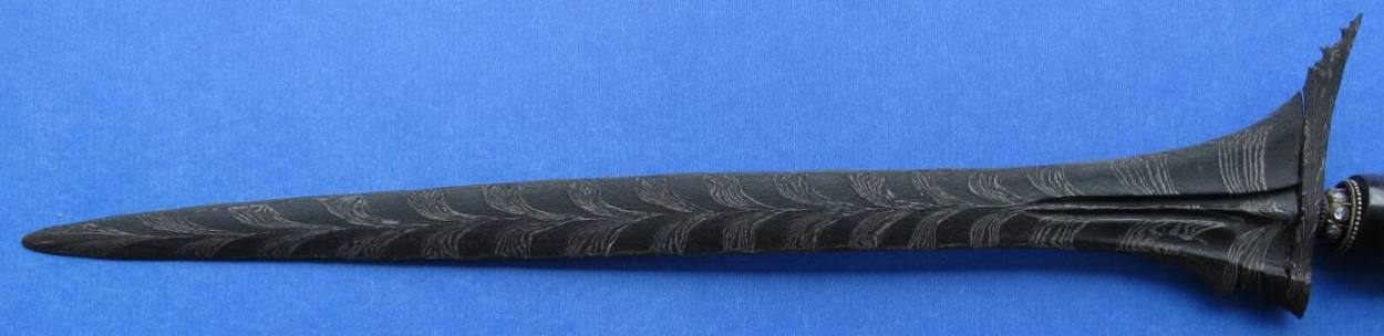

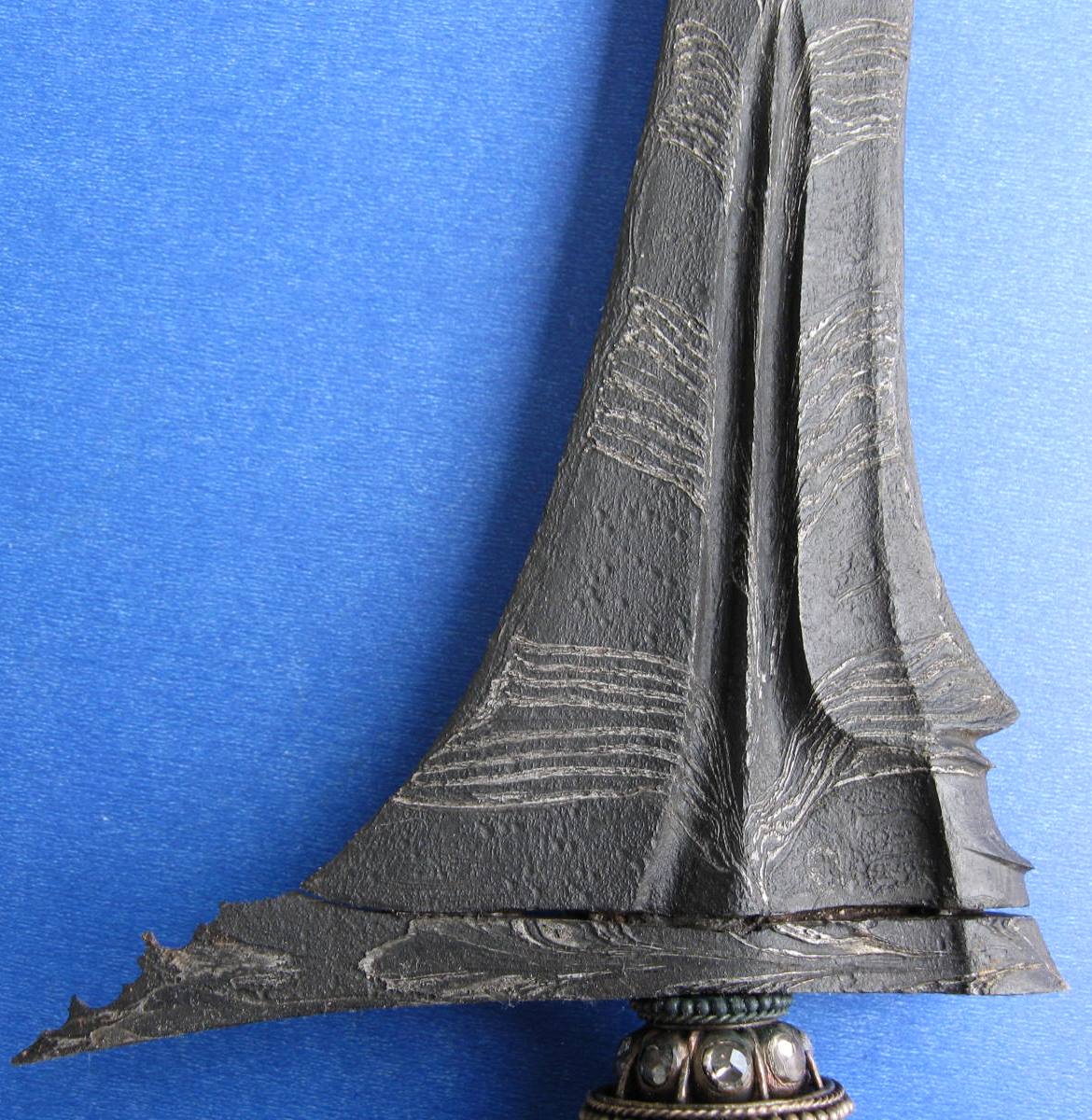

Default Ron Gendhuru
Unusual
Old 2nd May 2009, 02:38 PM   #2
Posts: 7,297
I don't know if it is unusual, but it is a beautiful example of modern keris art. Is the border actually a second pamor (wengkon) or is this part of the main pamor?

Old 2nd May 2009, 06:48 PM   #5
Posts: 6,436

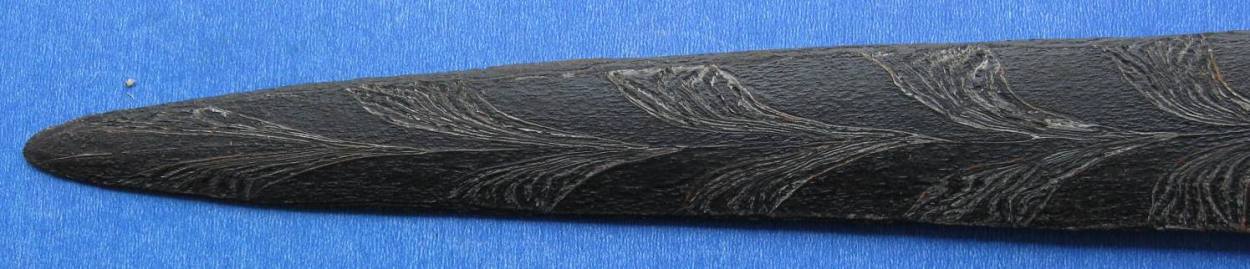

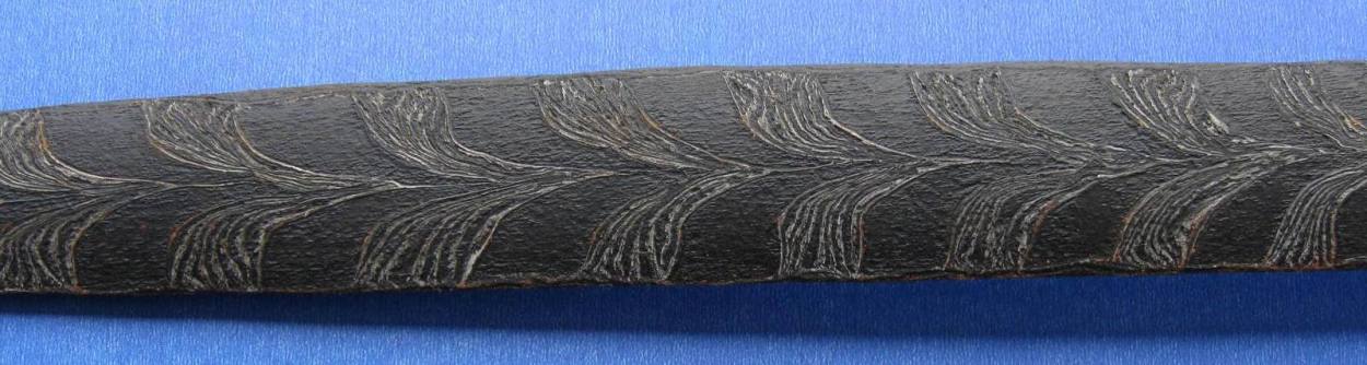

Nice example Marco.
In your close-up of the sorsoran the kembang kacang looks very elephant-like!
I think I even see an elephant's eye .

Old 2nd May 2009, 08:46 PM   #7
Posts: 7,229
Quite unusual methodolgy used to produce this pamor; not so unique in this day and age, but very certainly exceptional--- very exceptional--- for the PBX era and prior. Whoever made this was clearly an immensely talented pattern welder, and well before his time.
Yes David, it is a wengkon, created by a layer of contrasting mlumah material between the miring layer and the slorok.

Old 4th May 2009, 03:33 AM   #9
ferrylaki
Posts: 285
Originally Posted by Marcokeris
Unusual
the pamor work is outstanding. most ron genduru pamor will not appear this way. this pamor remainds me to 'kupu tarung' pamor.
I also love the wengkon.

Thanks all for appreciations.
Ferrylaki you are right. Pamor seems a little to Kupu Tarung . (About kupu tarung : in my experience is very difficult to find it....from some years i'm looking one opamor like this....but nothing good! ......i remember Ganjawulung has a very nice one )

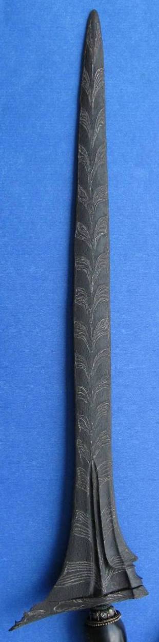

Hello Marco,
In my opinion, the pamor of this blade is not Kupu Tarung (see Pamoratlas for instance). I have my own idea (see pictures 11A and 16B in my book) but I leave to you guys to determine which pamor it is...
Cheers
Jean
I have found one: nothing extra...but a good feeling to my soul.
Hello Marco,
This is a keris with a similar pamor in my collection, I have classified it as Ganggeng Kanyut?
Best regards
Jean

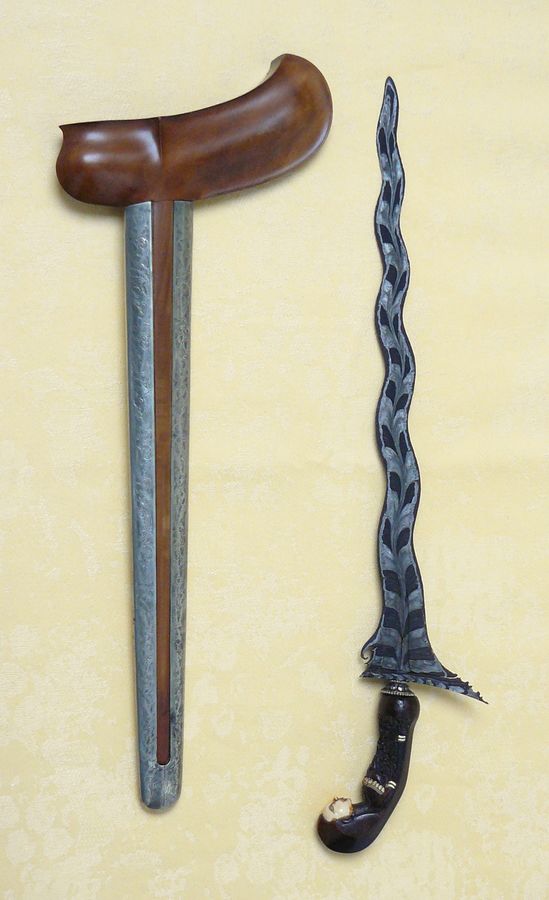

Dear estemed members,
The thread name on this is Ron Gendhuru, we have however not seen a Ron Genduru pamor in the thread.
In lieu of that I have attached some photos of one of my Solo pieces, reflecting what is normally understood to be the Ron Genduru pamor. This just so members that are not familiar with the pamor can see what it looks like.
Thank You,
Naga Sasra is offline   Reply With Quote

Thanks Erik for posting this.
Obviously the original blade has multiple pamor patterns. One seems to be wengkon. What pamor do you think the other one is that resembles Ron Gendhuru?

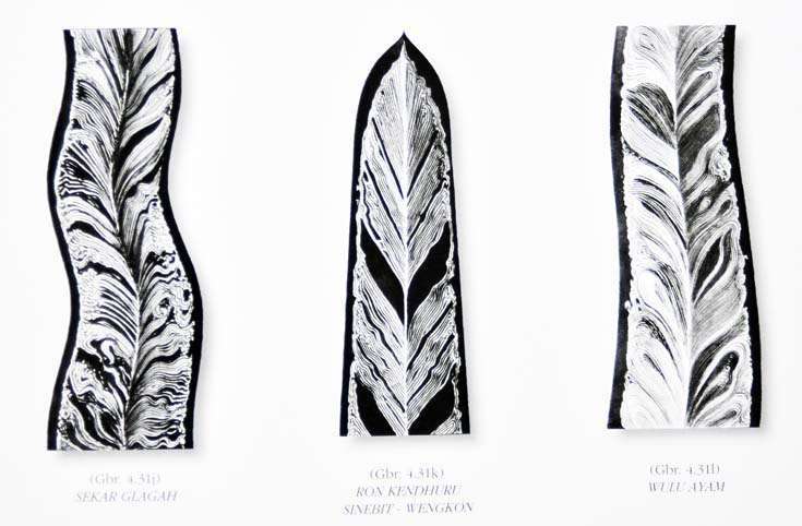

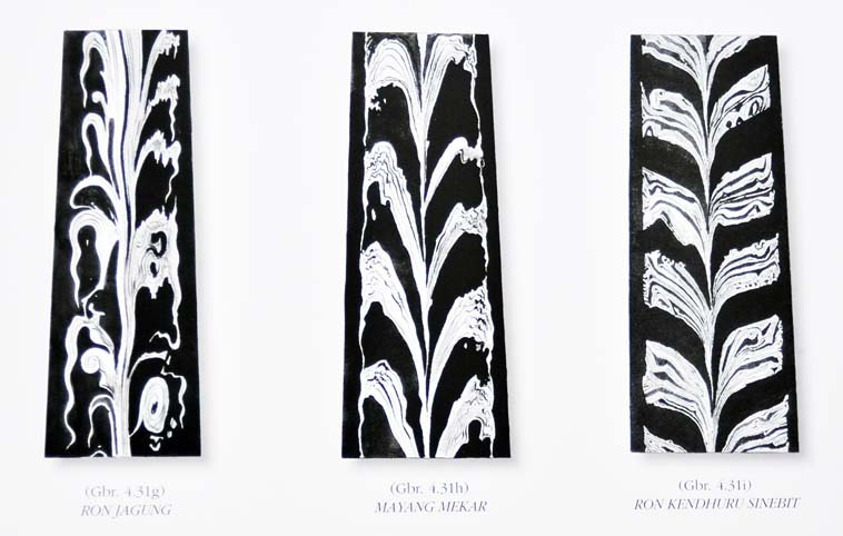

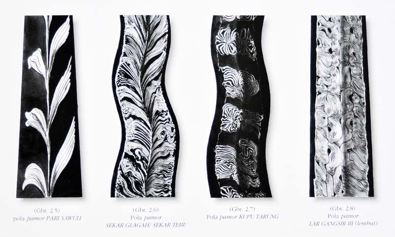

Default PAMOR COMPARISON
Just for complementary to Erik's post, here are illustration on some type of pamors for comparison. It is from Mr Haryono Guritno's book "Keris Jawa"...
(1) Ron Gendhuru -- or Ron Kendhuru, (2) Ron Jagung, Mayang Mekar, Ron Gendhuru Sinebit, (3) Sekar Glagah, Ron Gendhuru Sinebit, Bulu Ayam, (4) Pari Sawuli, Sekar Glagah, Kupu Tarung, Lar Gangsir...
GANJAWULUNG

Good question David,
At first glance and from a distance the blade look like a Ron Genduru, but the close ups show a lot of things going on inside the blade.
In my post I indicated my photos reflected what is normally thought of as the Ron Genduru pamor, which is supposed to be based on the Genduru leaves also called caryoto mitis and clumping fish tail palm.
The one that resembles Ron Genduru do not follow the lines of the leaf.
I see wengkon, and as ganjawulung noted lar gangsir, I also see a bit of Ron genduru and a bit of mayang mekar, with other words there are an awful lot going on in the blade, but frankly, I happens to like it.
I prefer not to elaborate any further on this, as when it come to attaching names to pamor and dapur as well, they can all be interpreted in many different ways and some empu had different ideas as to what a named pamor should look like, and the control of the pamor by the empu did certainly impact the finished product.
