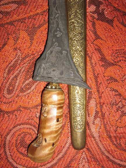

A.--- An old Madura blade, arsenic trioxide, stained about 1965.
B.--- An old Sumatra blade, stained in about 1960 with sulphur, salt, rice water.

nice work Alan,
Like A+B, love G, Kenanga? Would love to get my hands on some sekar blades to.. difficult to find good ones. Iff do.. way to expencive for my little wallet :S
Pic of some chunks waragnan, and trioxid pot.
here some more (clearer) pics of the blade recently done. Notice the square peksi, as writen of in other thread. For the ones remembering, that i did promise to post pics... after long search (at my moms house). found it but did not want to show without good clean and wash. Beter late than never.

.....here some more (clearer) pics of the blade recently done. Notice the square peksi, as writen of in other thread. For the ones remembering, that i did promise to post pics... after long search (at my moms house). found it but did not want to show without good clean and wash. Beter late than never.
Yes it's too dark!!. I 'ld try to wash it with a little lemon juice in the water... or a lot of cream soap over my fingers (...if the cream becames yellow...great day!! )
Opinion or fact? And can you underbuild you statment how it should look like... pics please.. from a equal blade with same pamor material! Not technique. Would like to see what you like/mean.

Yes, in the photos this blade looks too dark.
But it may not be.
We do not know what the true colour of the material is:- we can all only work within the limits of the material.
It is not possible to make a Tuban blade look like a Surakarta blade.
Maybe what we see here is the correct colour for this blade.
Look at the examples I have posted:- there is a lot of variation in colour, and this is only a small sample, in reality, blade colours can vary a lot more than this.
Because of the limits of the material we need to be able to classify a blade according to tangguh so that we can recognise when the blade colour is correct.
A. G. Maisey is online now   Reply With Quote
But it may not be.
Oke Alan, good comment.. cleary build..how can i be of asistence to give you more info to give you a clear impression of the blade (tanguh). Must i post dry pics?
addon,
this blade is when in oil (not like in pic) almost same colour.
