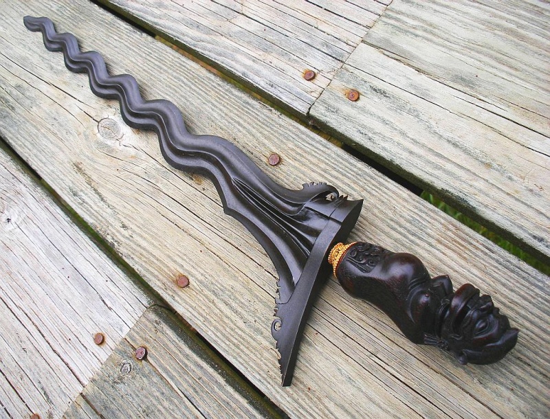

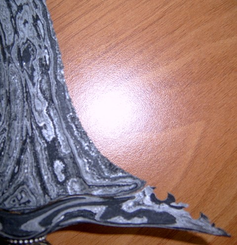

do you mean sparkling like this one in this sword? or a sparkling one like in this keris?

Hello Rick, thank you for the picture. Very beautiful keris; I like it a lot!
Hello Ferrilaki, the "sparkling" (somehow I feel that`s not the right word to describe it ...) in the sword comes quite close to the one in my keris. Pity I (still) cannot post pictures ... Thanks for yours!
Heinz

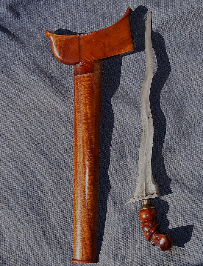

Such as this ?

I'm not going to comment specifically on the blades pictured, but if we look at the pale pamor material in the pedang we can see little white specks.
When we find a lot of these in ferric material it is very probably caused by forging at low temperatures. Prof Jerzy Piaskowski of Poland conducted a number of analyses of this type of material and this was the conclusion to which he came.
The effect can be quite impressive in a blade that has only plain steel and no contrasting pamor, it looks like little white clouds floating below the surface of the iron or steel, almost three dimensional.

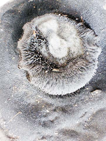

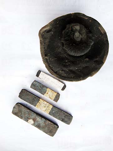

These pictures below are experiments of our German keris man Dietrich Drescher (hopefully Empu Kumis will respond this post). I took these photos at the besalen of Subandi Supaningrat -- one of Surakartan keris maker in the eastern part of Solo, Jawa Tengah (Central Java) medio last year.
As long as I know (I hope Empu Kumis will respond it too), he had made some experiments with Pak Subandi and Boedhi Adhitya (Yogyakartan keris connoisseur) to make blocks or "iron" of Cilacap sands. Cilacap located in the southern coast of Central Jawa. Why did he choose Cilacap? I think Dietrich has a certain reason on this. He selected the Cilacap "iron sand" material with magnetic piece of iron (see picture below) and then melt the iron sand, before being forged in block forms (please correct the right English term) as you see in the picture below ...
And I remember, Dietrich had shown me a newly made "wedung" with this kind of "iron sand" pamor couple of years ago, to prove his 'thesis' on "wesi malela".... I hope this info would help you

Hi all, this ironsand is called satetsu in Japan and is used to smelt tamahagane (jewel metal) which is used to make Japanese swords from, its a very good iron ore, with very little sulphur or phosphorus content so makes for a real good steel, with less carbon and added meteorite it would make most excellent keris pamor, "washed" high carbon tamahagane would be ideal for the core (very hard and tough steel) Costs about £60 a kilo in Japan though.
lemmythesmith is offline   Reply With Quote

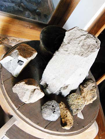

This is more picture of 'iron stones' that probably contained iron ore at Subandi's besalen in eastern Surakarta.
GANJAWULUNG (Guangzhou, June 16, 2009)

Many thanks for the picture, Ganjawulung! The stones look interesting.

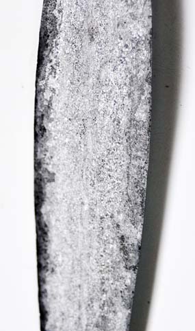

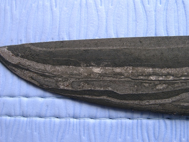

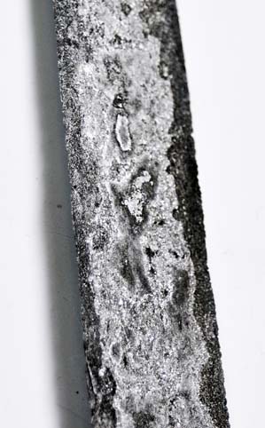

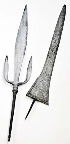

I tried quite a couple of times to portrait the "glittering" or "sparkling" effect of the blade that you probably meant to. But I don't think I can show you the good photo of it.
These two blades -- one (supposed to be) Pajajaran or Cirebon trisula, and one keris of dhapur "gumbeng" (quite similar to "kebo lajer" but not to thick) -- also supposed to be a Pajajaran gumbeng, with "sparkling" or "crystaline" grains in the blade...

Thank you very much for taking the time and making the effort to portray wesi malelo. It`s difficult to describe the "glittering/sparkling" effect by word and it`s not easy to illustrate this by photos as well. One must have seen it on the object in hand! But the pictures you posted are very informative to me, and they are much appreciated!
Wesi malelo is a fascinating but rather confusing matter, and much of the knowledge of it seems to be lost in the past ...
You show a Pajajaran or Cirebon trisula. That`s interesting as my keris in question is attributed to Cirebon. What`s the period of tangguh Cirebon (16th century?).
