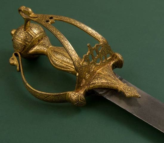

Hi
recently finished on eBay a seemingly very interesting and desirable Tulwar. Does anyone have any more details regarding the hilt.
http://cgi.ebay.co.uk/ws/eBayISAPI.d...MEWA:IT&ih=012

I saw this auction too. Here's a link to a similar one recently sold by Ashoka Arts:
http://www.ashokaarts.com/edgedweapons/ew-30.html

Stupid question probably; are these the same sword ?

Reminds me a bit of some old British baskethilts, for what that's worth. Mostly due to the pommel shape I think.
They're different. Look at the decoration of the blade, and the shape of the quillions, for example.

Spot on! as they say Kisak!!
Ashoka makes reference to a Victoria & Albert example in Rawson, and notes the NW India attribution about end of 18th early 19th century, to which I completely agree ("The Indian Sword" . P.Rawson, #46, citing number I.M.98-1955).
It would appear that there are at least three, certainly likely more, of this exact hilt, and the Arabesque koftgari of course seems of Mughal style. I think Jens far better at assessing that characteristic, so that is just my guess.
As for the sword overall, the ebay example seems to have a British M1788 light cavalry sabre blade, and I have seen other hybrid sabres of NW India with M1788 sabre blades in other cases. One was a shamshir style hilt, solid steel with Indian tulwar quillons and langets. The blade had koftgari at the forte in similar fashion.
In the British Raj, there was indeed a particular interest in Scottish basket hilts in many regions where some Scottish officers seem to have had these, though the only illustrations I have seen of native officers wearing them were later in the 19th c. In this case, if I recall, it was a Khyber Rifles unit.
I think the influence was far earlier, as suggested here, probably post-Seringapatam.
I think probably one of the most fascinating aspects of collecting the weapons of India are these hybrid forms, not simply tulwars with trade blades, but with regulation military blades that seem to fall outside that group. I have seen tulwars with blued and decorated officers blades and other marked military blades .
Beyond noting these instances of similar type characteristics, it would be hard to see who they were for, but clearly unique and seemingly quite rare.
All best regards,

The "onion" hilt to me says afgani pulwar, so I would say a mix of indian and afgani swords. That side guard is what got me puzzled... Very unusual piece indeed.
Rick - the one from Ashoka is not the same one.
Included is another example I found online with all its gold work intact.
Alex

Afghan would definatly be my vote. Interesting mix the onion bulb shows the early persian influence, with the guard showing a european influence and the decoration coming from india. That is what I love about afghan pieces the mix of different developments within the weapons scope mixed into their own culture

In Indian Art in Marlborough House, case A, Heldley shows one being no 1, and writes it is a present from H.H. the Nizam – so now we have moved to Hyderabad, and not the Hyderabad in Sind. It is not exactly like the first one shown, but very much alike.

I saw several such swords in the Wallace collection, all attributed to the Sindh, Punjab and Kashmir regions. I may have taken some pictures of the swords on the sly, ill try to dig them up and post them.
