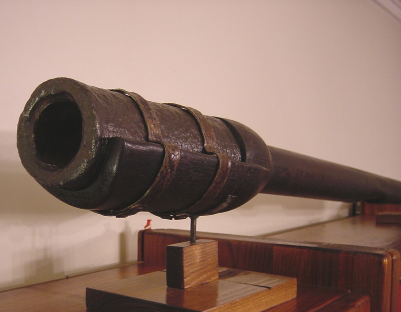

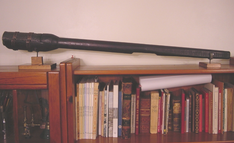

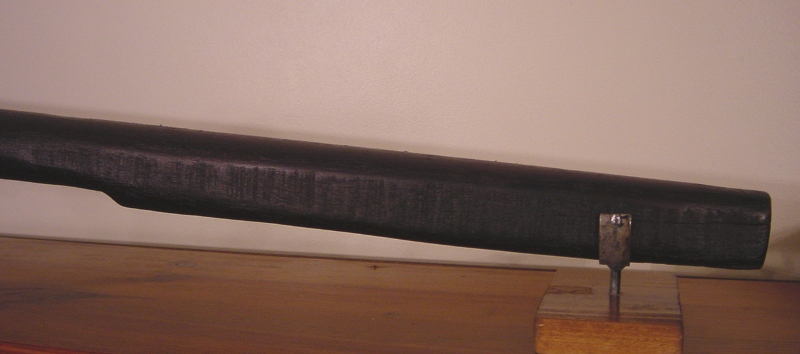

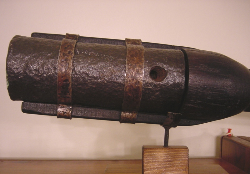

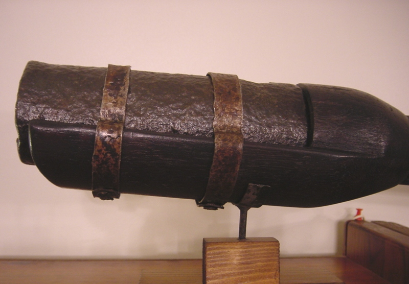

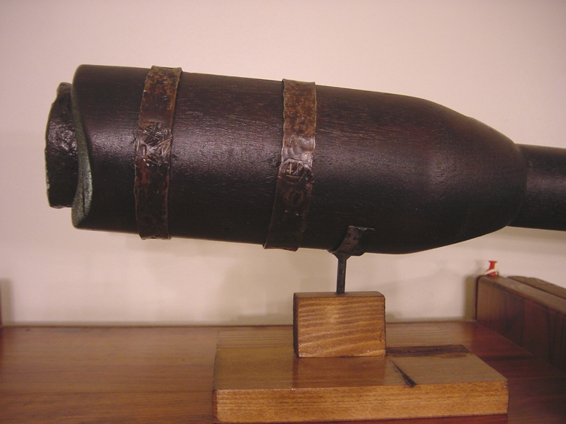

Is that so, Gene ?
Look what i managed

BRAVO FERNANDO
Regards David

WOW!
Fernando. That looks just fantastic!
You must be very pleased with it? How long did it take you?
It's prefect, just right!
Congratulations.
Gene

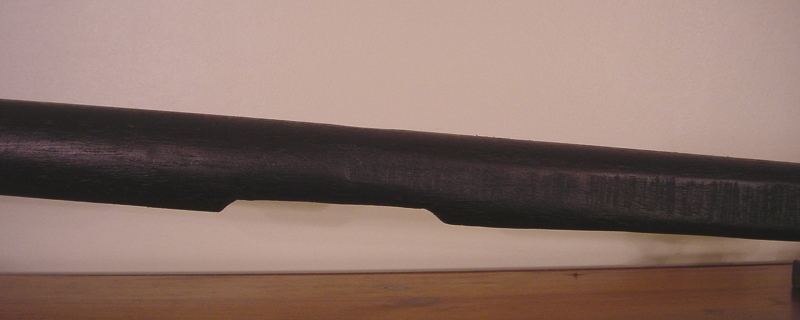

Thank you so much Gene, but i'm not that Gene-ious
A one handed guy with a couple undecent tools could never make such a decent job .
The carpenter, after i showed him a drawing and measures, must have taken less than two hours to turn the pole in mahogany, drill the ( barrel ) hole and cut it in half section.
Then i had to carve the half hole, here and there, to fit in the irregular barrel.
Back to the carpenter, to thin down the lower and side parts of the pole in its first half; it looked too bulky and perfect from the lathe, and this way it looks mor rustic. He used the vertical saw, to get an unfinished look.
Then three hours at the smith. I showed him a picture and had him to cut two strips of "black" iron, and beat them hard with a ball hammer, before bending them for the bands. The bands were fixed with screws, which had their heads cut off and criss crossed with a small grinder, to resemble rustic rivets. Then i told him to use a drop of sulphuric acid to darken the new heads.
Coming back home, i darkened the pole two hands of old fashioned vieux-chaine and covered it with liquid acid.
18 Euros for the carpenter, 30 Euros for the smith.
After all, the part that took longer was the carving of slight parts of the barrel bed, to fit it correctly, as i didn't have the correct means (and know how) to do it.
Now my whife is constraining for the adding of one more thing to the leaving/dinning room decoration; but she is brave ... she will stand it.
Fernando

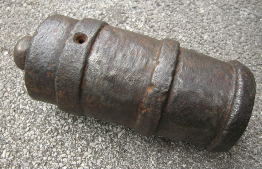

Speaking of cannons, I missed out on this one the other week. Check out eBay item #170241460432. Seller said 1900? I'd say earlier, perhaps early 19th? What say you folks? Is this a signal cannon, small mortar, hand cannon, coehorn or ?

Any takers? I did notice this was a "private auction" with hidden buyers. I don't know much about these types of auctions, but I'm told they can be a little shady. Too bad, seems like an interesting piece...

Such a pitty you didn't get it; very serious stuff ... so it looks.
Rather reinforced barrel, wide ( or worn) touch hole, large caliber ... meaning XIX century or even prior ? Not old enough to de considered a hand cannon, though ?
Also not a coehorn mortar ... It would need trunnions placed low, by the breech, for the rotation, right ?
It has a cascable, though ... was it moveable ?
I'm glad there are no experts around, to shut me up .
Fernando

no trunnions, so likely not an aimable mortar or cannon, may have been strapped to a carriage of some sort, too big & too recent for a hand cannon. too short for much. s缠mall cannon were used for line throwing but would have had trunnions . small rail mounted anti-personnel cannon would have had trunnions to mount it on a swivel. my guess is a signal cannon for a larger ship.
coehorn mortar, trunnions on base
small swivel gun, trunnions again
this small late 18c - early 19c howitzer is close, but has trunnions again.
lyle gun (line throwing)
trunnions again - this is a big lyle.
more traditional brass one in high polish
here's the whole gubbins with the coast guard crew to service it.
aha! a trunnion-less one mounted on a fixed base!
this is a signal gun used to start yacht races
note that 19-20c cannon of this type would have a lanyard operated percussion firing device threaded into it rather than a touch hole. removal would leave a larger hole than we'd expect for one fired by a slow match.
one for a lyle gun

Thanks for responding, guys. Fernando, you sound like you're closer to expert than you let on! Your comments are right on and that I didn't have the funds to get this cannon before the auction ended (got a nice boarding axe instead, though!)
Kronckew, thanks for posting all of these pics of some pretty cool cannons. That trunnion-less one in particular is interesting to see, as most either had them or were the older signal-types. I had never seen one without them until you posted this pic. I had thought deck gun, but of course they were all swivels, so your argument stands. Yes, in the early/mid-19th century, they started using a percussion firing system on deck cannons, ship signallers, and even on some swivel guns. I guess it was a lot easier than trying to use the old lit fuse.

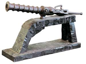

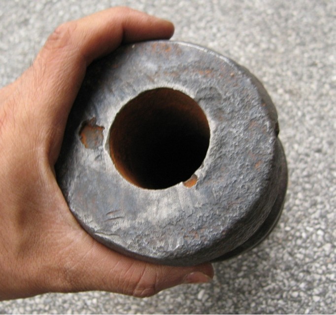

Hi,
I am beginning to think that the 'Austrian cannon' may have been cut down, below the trunnions. If you look at this picture there seems to be some machined surfaces, the deep pit looks like a 'casting flaw'. Perhaps the pitted face is evidence of an original fracture cause by stress....and then was cut at that point ???
The other picture is another cannon of unusual form
Regards David
Old 14th August 2008, 02:26 PM   #52
What a bombastic proposition, David ... and quite a plausible one . That would solve the riddle and make the piece look more rational .
Then who ever made the job, must have also grinded the muzzle rim into that slightly conical shape; the other remaining "rings" have a paralel section ... if i make myself understood ... and if i'm not talking nonsense .
Fernando
Old 14th August 2008, 02:31 PM   #53
Where's the KABOOM? there was supposed to be an earth shattering KABOOM!
(sorry, the devil made me do it!)
anyway, that looks very plausible, those marks look very much like it's been sawn & ground a bit - hadn't noticed them earlier. nasty inclusion woulda blown anyways at some point...
Beautyful "cradle". I saw a similar one with those staves, the other day, at the Lisbon Military Museum. Very old stuff ... XV-XVI century?
Fernando

Thanks, David. I think you've got a very good point there. I still always seem to forget about cutting down weapons, as so many have been over the centuries. So it seems the Austrian cannon might have started life as a real mortar-type and in its working life, been cut down to more of a signal type. Interesting, still would have looked good in my collection next to the Brazilian pirate cutlass

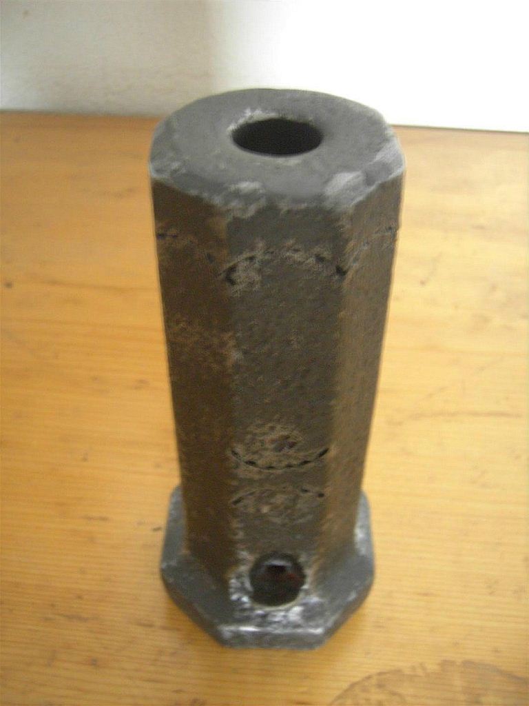

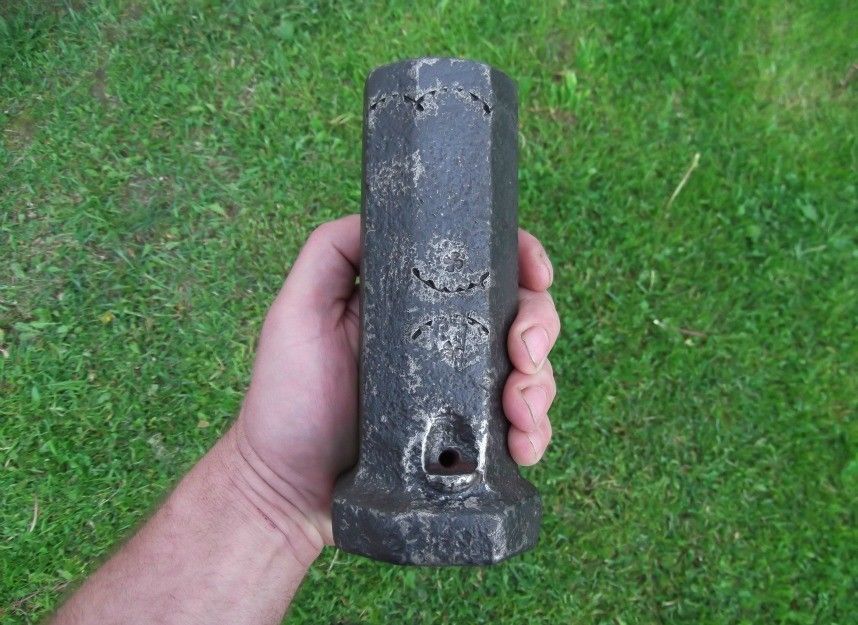

What do you think about this cannon ?
Evgeny_K is offline   Reply With Quote
Old 13th November 2013, 03:31 PM   #60
A very nice piece indeed. Surely a (signal) mortar and not a (hand) cannon , judging by its base and touchhole 'lip', both indicating this is a vertical firing device.
I wouldn't guess its age, due to my little knowledge but, it must be an ancient example, due to its overall look and specially the marks, which are often seen in old swords ... 16-17th century ?
