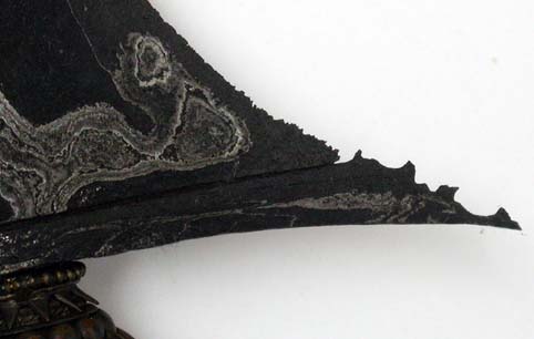

In light of these two factors, I believe that the assumption is reasonable that the greneng, along with some other ricikan of the modern Javanese keris, first appeared during the Majapahit era.
Apart from these two factors, there is the other evidence for a Majapahit origin that has been offered by Pak Boedhi
Now, what do we know of Javanese society and culture during this era?
OK, i'll start with the obvious. We know that for the most part, certainly on the keraton level where keris development would be taking place, we are talking about a Hindu culture. So if symbolism is involved then we are most likely dealing with Hindu symbolism.

Originally Posted by kronckew
the kudi/kujang also has decorative notches on the top of the blade, on my pre-islamic one, they are well forward, over the 3 holes.
european blades frequently have decorative filework notches cut into the blade spine, scots blades are also frequently notched
could it just be that they are decorative items that have evolved into fancy forms & have become 'traditional' in some areas, adding more esoteric interpretations in later ages.
as not all kris blades have them, and some non-kris blades have them, i'd think that if they had a definite non-decorative kris specific function then all kris would have them to some extent, however they are apparently optional.
occam's razor (razors generally come without greneng )?
Your kudi looks like a fairly modern piece to me, not pre-Islamic.
Greneng is certainly much more developed than the notches found on European blades and the form does look very much like the Dha letter it is reputed to represent. It seems to me that they are much more than just decoration.
Keris were/are made on many different levels for many different classes of people and for various purposes. I don't find it surprising therefore that some keris have greneng while others do not.

It is tempting to think of the very first, original expression of the greneng as a purely ornamental device, it is difficult to argue against this, as it is obvious that to say such a thing never happened, and never could have happened we would need knowledge of every keris ever produced, prior to the widespread use of the greneng as a feature in the keris.
However, once we reach the point where we can see a distinct form in the greneng, and we see this repeated in a number of blades, irrespective of the quality of the blade, I am very reluctant to accept mere ornamentation as an explanation.Most especially so when that form can be aligned with a form existing in Javanese script.
In fact, when we consider the 16th and 17th century examples in European collections, and compare these with examples in Jawa that are supposedly from this period, and earlier periods, it seems possible that in blades where complex ricikan were used , their addition to the blade was not the product of a gradual development process, but rather all the features were added at one time, or at least within a span of time that was relatively short.
To my mind, this indicates a planned process for an intended purpose.
Yes David, the Hindu faith was present in early Jawa, but it was not the Hindu faith as practiced in its homeland. It was Jawa-Hindu, which was a syncretic form of the faith incorporating indigenous Javanese elements and a parralelism with the practice of Buddhism. Not really a particularly easy subject to come to terms with, but an understanding of what was going on in the religious sphere at this time is essential before we can begin hypothesizing in respect the keris and its features.
Let us not forget that a culture and society consists of more than just its religious beliefs. We need also to try to gain an understanding of the other elements involved .
We must not think of early Javanese society as a Hindu culture. It was not. It was Javanese culture with overlays of foriegn belief systems that had been accepted, absorbed, and altered to fit the host society.

Kai, I'm sorry, I noted your remarks after I posted my most recent comments.
In respect of my comment that:-
"---In light of these two factors, I believe that the assumption is reasonable that the greneng, along with some other ricikan of the modern Javanese keris, first appeared during the Majapahit era.---"
Kai, here I am making an assumption, that is , it is something that I am asking to be accepted without proof.
This would be a non sequitur if I had presented it as a statement, or a conclusion, and had relied upon my previous remarks in an effort to validate that statement or conclusion, but with an assumption I am not required to validate or prove anything.Thus, we cannot say my assumption does not logically follow from the previous remarks:- it does not need to logically follow, as it is presented as an assumption, not a conclusion, which of course should be able to be supported.
If we were to take the line that my assumption is not a reasonable assumption, then we would need to mount an argument to demonstrate the reasons for it not being reasonable. We cannot dismiss it, as we can an illogical conclusion, by simply saying that something does not logically follow from something else.
However, setting this aside, you raise the question:- "---Why couldn't some kind of greneng have evolved earlier?---"
Yes, it could have, but taking into consideration the time span nominated for the appearance of the greneng, it seems exceptionally unlikely that it could have appeared earlier. The Majapahit era can be taken to stretch from around 1290 through to around 1525. These are extremes, and the core period was much shorter. If we look at the keris form that most probably existed prior to about 1300 we find that those forms have not yet commenced development into the form of the Modern Keris. It is only with the Modern Keris that we find multiple complex ricikan.
Yes, there are examples of the early Modern Keris that do not have greneng nor ron dha, and lack other ricikan. This inclusion of specific ricikan is part of the system of dhapur, so the inclusion or not of specific ricikan depends upon the dhapur that has been created.

Regarding the form of the greneng.(Dr. David)
Keris from different periods carry ron dha of differing shapes, those shapes supposedly can be aligned to the form of the letter "dha" at various periods.
Keris from some areas outside Jawa, and keris of village manufacture from within Jawa very often have very approximate renditions of both greneng and ron dha.
The greneng can take a number of forms, but in a Javanese keris the various forms will always contain at least one rondha.Early keris with greneng do have similar component features expressed within the greneng, but the composition can vary from one keris to another. To give a definitive answer to this, one would really need to examine all these old European-held blades at the same time. Photos, even the very best photos, are not really good enough, in my opinion. I think that very probably it would be able to be shown that early expressions of the greneng carry very much the same features as later expressions of the greneng, however, with later Surakarta keris I feel that we begin to see some artistic improvisation that was not present in earlier periods.

Very well David, its a flight of fancy.
Can you explain how the presence of the greneng on the keris assisted in assertion of authority over a portion of the a realm?
Especially when Sunda was virtually ignored in the Majapahit literature.
If we wish to make the greneng a geographical representation of something, we need to look at geography from the perspective of a lord of Old Jawa.
I don't think we can use this map theory. This is just not a reflection of Javanese thought of that period.

As for the greneng representing a map, well, old Jawa kings didn't seem to like or need maps much. They often did not have borders on the ground, and they considered owning people more important than territory.
One thing we must consider when thinking about how things became widely used, is the influence of charisma. If a God-King wants a greneng, all his subjects might want one too. When Panembahan Senapati died at his funeral cigarettes were served and from that day Jawa men smoked, court poets noted. So the use of greneng might be like that too, one day a King used it and the next day everyone wanted one. Why? Because of charisma.

Regarding the notch in a khukri blade.
What I might know about khuks could be written on the head of a pin, however, I do have a good friend who lives in Canada, and who, for the last 20 years or so, has been married to the daughter of a Nepalese Brahmin, who lives with them. Father in law was a professor of cultural studies at an Indian university, and my friend is a long-time student of the khukri, weapons culture in general, and Nepalese weaponry in particular. He is an intelligent man whose work involves logical investigation at a university level. He does not, to the best of my knowledge involve himself in internet forums and when I have raised this question with him he has indicated in a very forceful manner that he has no wish to use his time in this manner.
I asked him for his take on the notch in the blade of khuks. Here is his response:-
not one reason but a few.
the principle reason , which could be carved on stone,I was told by a nepalese of experience, not just a figured out theory, is to control blood flow, when chopping up people.
blood on the edge will flow along the edge to the notch then drips off the notch to the ground rather than running over the handle..
I tried it though with milk not blood and it works pretty well..
As well it forms a lock, when in scabbard bladedown and the notch helps lock it.,.
as well many people have told me it represents Mt kailas in tibet, where shiva is said to rest, so its religous symbol i.e. could be prayed to.

I still think that greneng is just an empu's signature and has nothing significant in its physical function aspect. However, I must say I agree with the notch in a khukuri theory - being blood flow stopper.
Another thing to note, though both types of weapons came from Hinduistic culture, empus were very revered that sometimes even the kings married off their daughters in rewarding their efforts. The same could not & cannot be said about the kami caste (khukuri makers) - They were considered untouchables
