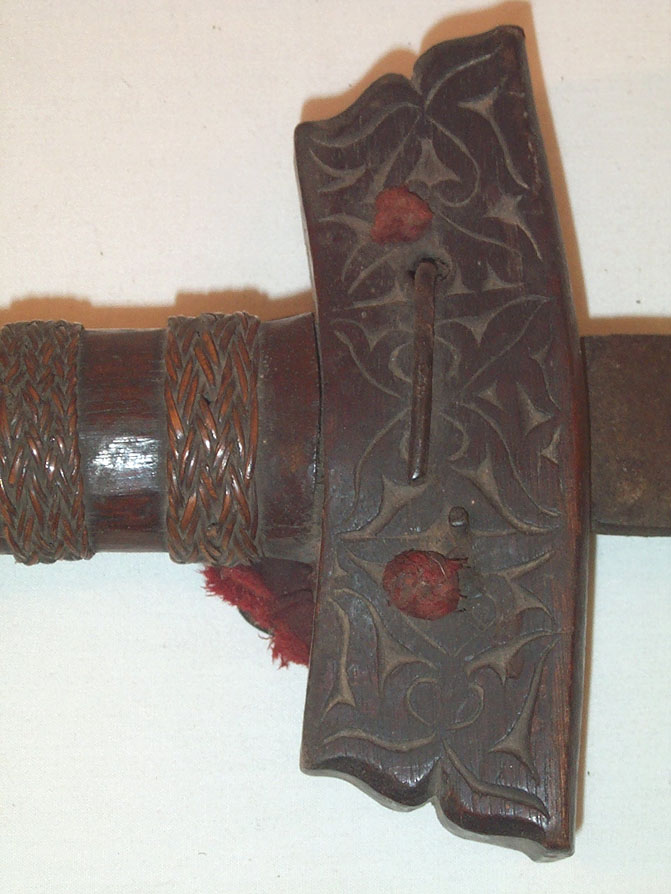

Unusual Hilt.
Opinions? |

Very nicely carved though. Michael |

I agree...it's a nice hilt, but it doesn't look all that unusal to me either.

I meant to say "unusual guard."
Well, maybe not THAT unusual! A little bit unusual?

Rare ? unusual ? less common? ......whatever the outcome....I really like the hilt..
...the zooamorphic 'pommel' is interesting...do you know what it represents. The 'square' jaw and large eyes puts me off the idea it is a Serpent's head.However, the (metal ?) wavy piece ( not very scientific ) on the guard certainly 'shouts' snake and I'm sure there is significance to the number of 'curves'.

As for the guard Bill, i would say perhaps "less common" is the term i would use. I have seen far too many kampilan on eBay with this style guard to consider it "unusual", though yours is i much nicer example than most of the ones i've seen.

Thanks, guys. I seem to have gotten into a description situation. I have been quoting a description of this kampilan from Cato's "Moro Swords." These are his words and I should be referencing him.
Please see pages 49 and 54 of "Moro Swords." "34. A curved kampilan guard with an unusual thalassic form." When I search for "thalassic" I see the "Free Onine Dictionary" saying: Adj. 1. thalassic - relating to the seas, especially smaller or inland seas;- Scientific American Thinking in this context, I assume the guard looks a bit like a boat. But it could have other meanings. I apologise for not quoting my sources and will be sure to quote them in the future. ---- Bill |

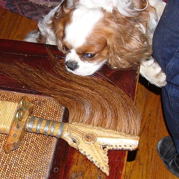

#15 |
Posts: 1,730
<<<==== is that unusual? |

looks radioactive to me....thats kinda unusual. |

Posts: 1,730
ahhh, that explains it. previous owner worked at Portsmouth Gaseous Diffusion Plant...

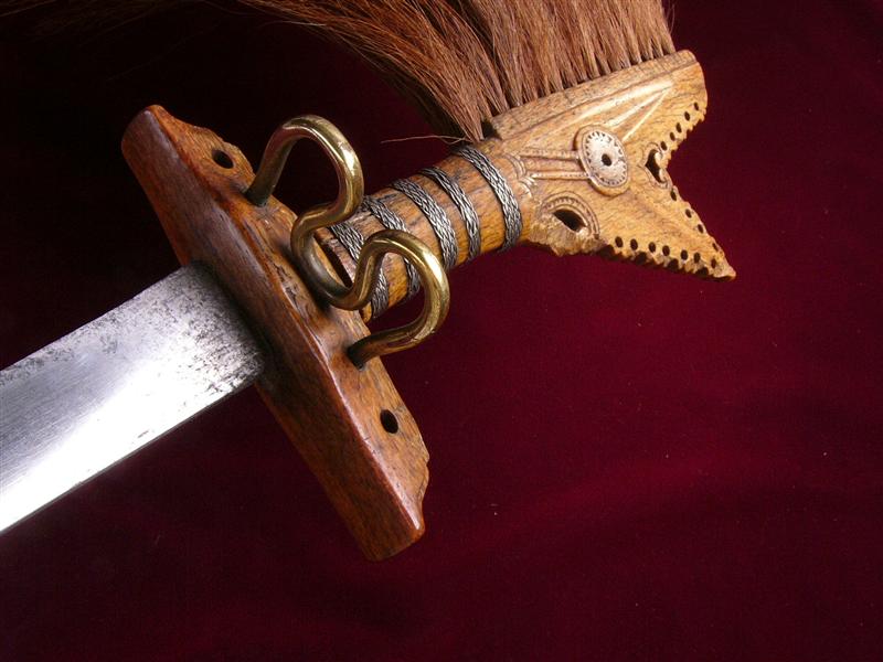

#18 |

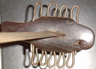

Posts: 6,387
Here's unusual; simple though .
Anyone seen brass guards before ? |
#19 |
Join Date: Mar 2005
Location: USA Georgia
Posts: 1,599
This one seems to be brass. Don't know how original it is to the handle. It was like it when I got it. From the additional holes, I would guess that some other guard was born with it.
My dog likes it. This kampilan has a very strange feeling about it. |

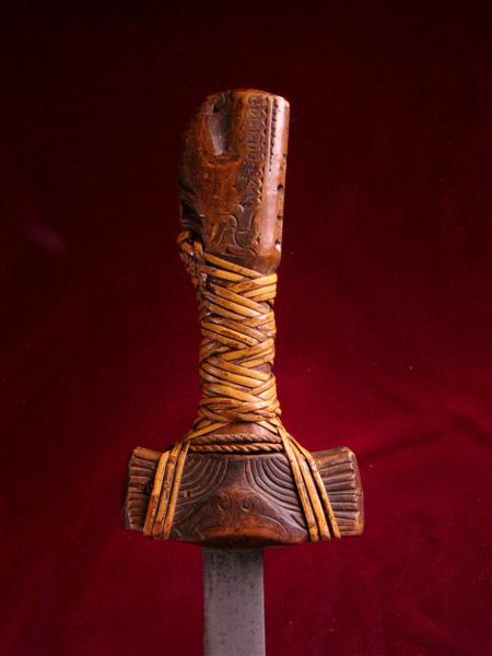

SPUNGER I HAVE BEEN WONDERING ABOUT THAT ONE PERHAPS YOU COULD DO A POST ON IT WITH GOOD PICTURES AND A DESCRIPTION OF MATERIALS USED AND YOUR GUESS AT AGE ECT. I HAVE NOT SEEN ONE LIKE IT AND HAVE JUST BEEN GUESSING THAT IT HAS A CARVED BONE OR IVORY HANDLE
I WOULD DEFINITELY LIKE TO GET A BETTER LOOK AS IT LOOKS LIKE A REALLY NEAT SWORD.RICK I HAVE ONLY SEEN THE ONE CAST BRONZE GAURD I THINK IT WAS YOURS ON A OLD POST. I HAVE ONE WITH A BRASS GAURD MADE FROM A PIECE OF THICK BAR STOCK WITH A SIMPLE DESIGN CUT INTO IT. MOST OF THE KAMPILIANS I HAVE SEEN OVER THE YEARS DID NOT HAVE A METAL GAURD AT ALL. SOME HAD HOLES WHERE ONE MIGHT HAVE BEEN OR THEY MIGHT HAVE HAD A CORD ATTACHED THERE AS IN THE EXAMPLE I POSTED ABOVE. MOST OF THE METAL GAURDS HAVE BEEN THE IRON ONES BENT INTO LOOPS BUT I HAVE SEEN A FEW WITH BRASS USED INSTEAD OF IRON. I TEND TO THINK THAT THE METAL GAURDS CAME INTO FASHION DURING A CERTIAN PERIOD AND MAY HAVE WENT OUT OF FASHION AGAIN IN LATER TIMES. IT WOULD BE INTERESTING TO BE ABLE TO FIGURE OUT THE HISTORY OF THE KAMPILIAN AS THERE HAVE SURELY BEEN QUITE A FEW CHANGES OVER TIME RIGHT UP UNTIL THE PRESENT. IN THE OLD CLASSIC POST ON THEM I HAD A PICTURE OF ONE WITH A SEA EAGLE POMMEL WHICH I WOULD GUESS TO BE WW2 OR LATER BUT A LATER EXAMPLE POSTED SOMEWHERE APPEARED TO BE A OLDER EXAMPLE. I ALSO HAD A VERY OLD ONE WITH A POMMEL SHAPED LIKE A HAND OR PALM LEAF OR SOMETHING, I SAW ONE OTHER EXAMPLE OF THAT STYLE BUT HAVE NOT SEEN ANY NEWER ONES USING THAT FORM. I ALSO WONDER IF WHALE BONE IS BEING CARVED TODAY FOR KAMPILIAN HANDLES AND FOR KERIS AS I HAVE SEEN QUITE A FEW VERY NICE HIGH END EXAMPLES IN RECENT YEARS BUT NOT BEING ABLE TO HANDLE ANY COULD NOT GUESS AGE. |
#21 |
Posts: 6,387
Bill, possibly yours had two guards and one has gone missing.
Barry, yes whalebone is still utilised; you see newer Bali wrankas carved from it. |

Posts: 4,650
Bill:
I think your guard and handle have been reworked/replaced. The ensemble looks rather pristine and the carving on the handle lacks a little of the refinement and patina of older examples. From the general pattern, I would guess second half of 20th C, Maranao work from the Lake Lanao region, where many of the more recent Kampilan hilts have originated. Ian. |

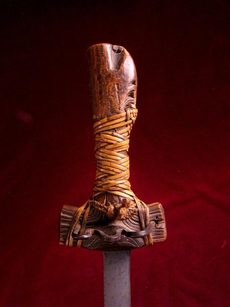

Location: Oahu, Hawaii
Posts: 166
All this time I thought it was a cockatoo, first time I'm hearing waves. Ian you were with me when I picked up this one and it's really similiar.

Posts: 4,650
Dan:
I was thinking of your example a few days ago in relation to this thread. The rounded "curly" forms of decoration are relatively uncommon on kampilan and your example is unique in my experience -- definitely old (at least early 20th C) and well executed hilt and guard. In some ways the rounded curls remind me as much of vines and leaves as waves. The guard on yours does look bird-like. Perhaps an eagle or cockatoo. ![]() Like many of Cato's descriptions, one wonders where the term came from. He does not document his sources, and without that documentation one is left wondering if much of his information could be confirmed. Frustrating. Ian. |

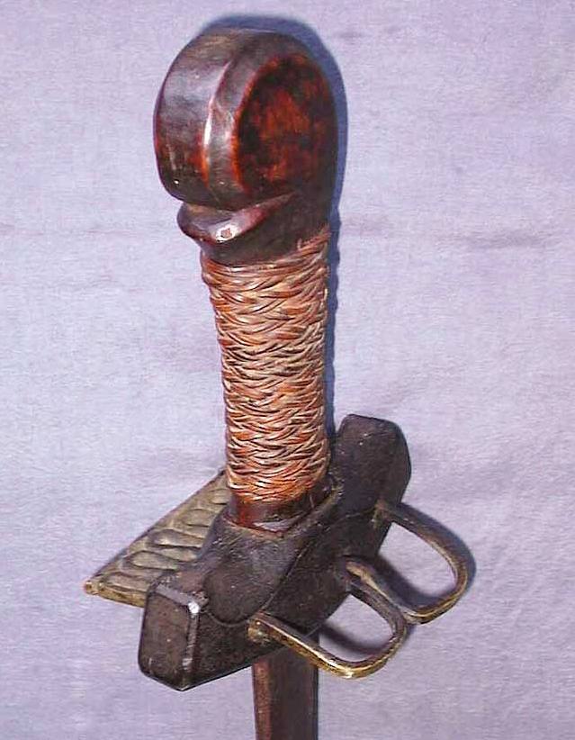

#30 |

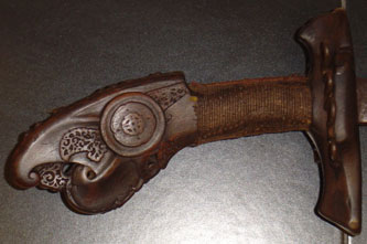

Join Date: Mar 2005
Posts: 1,599
Any ideas about this one? Has it been highly modified, or was it born this way?
Sometimes I wonder if pieces were worked on to sell to tourists or were they battle pieces that the owner just thought, "Hey, fix this grip so I can get a good hold on it and let me get back to fighting!" I got a kris around here somewhere..... |
