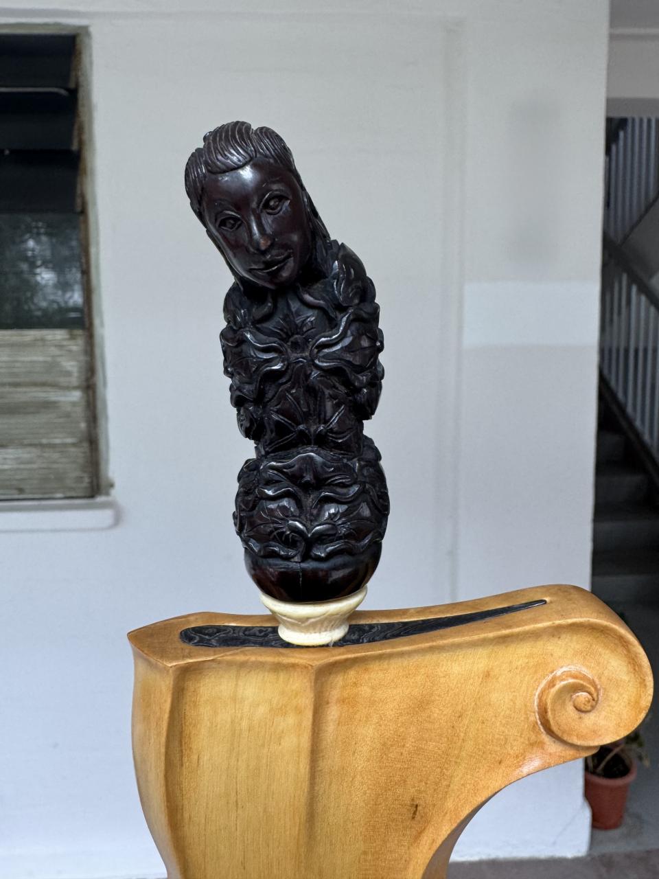

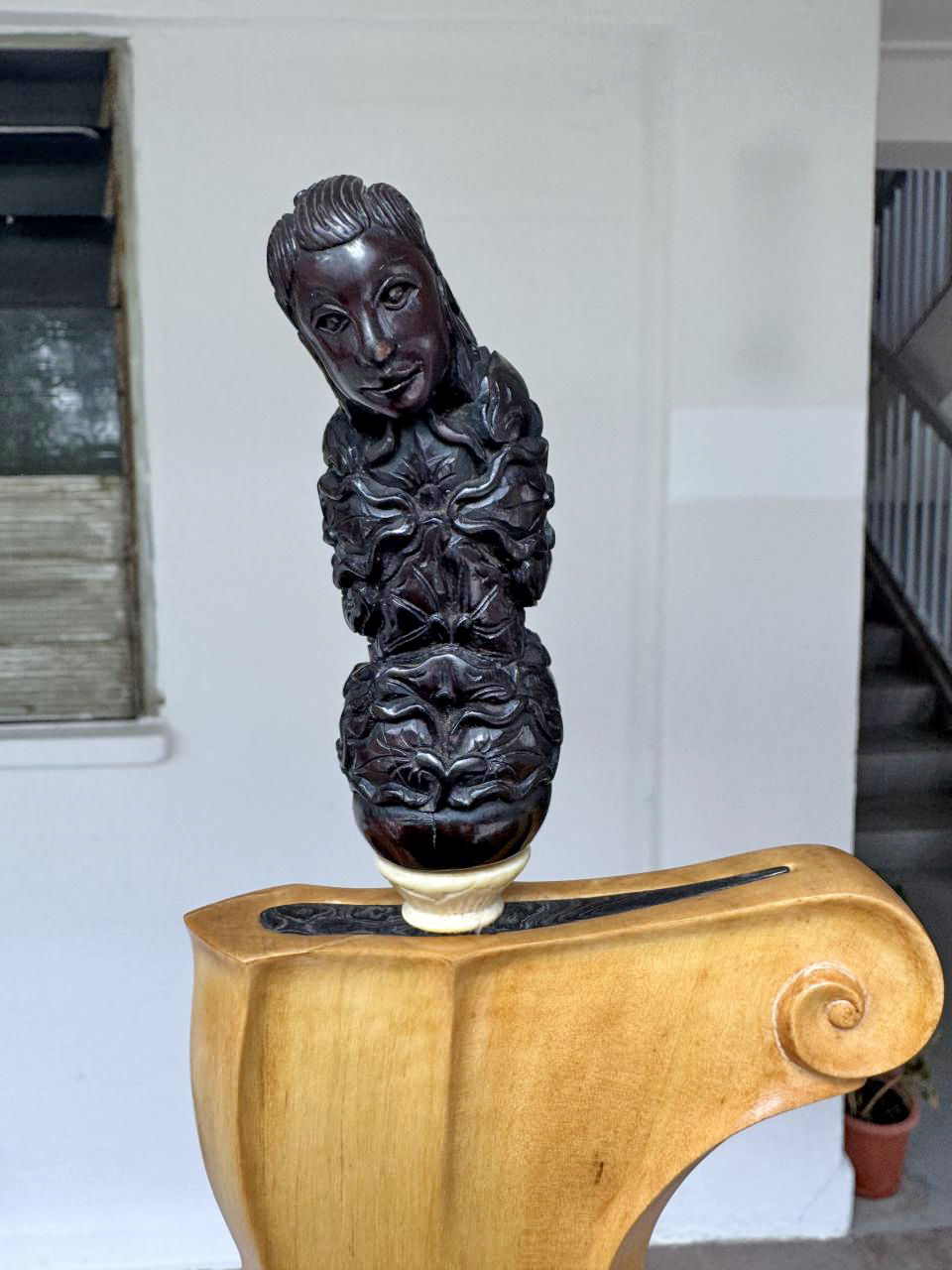

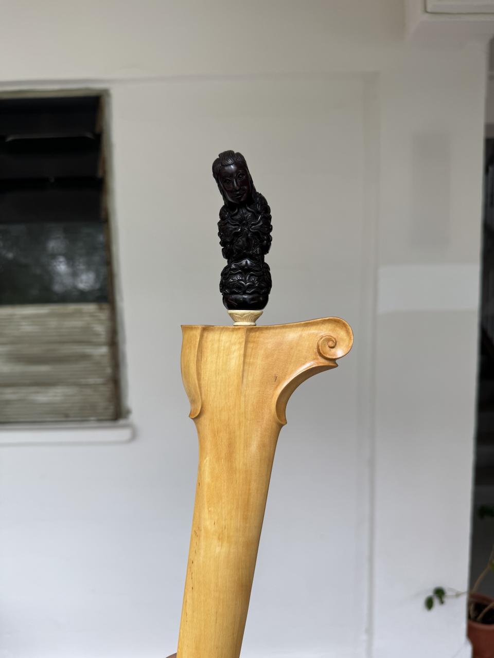

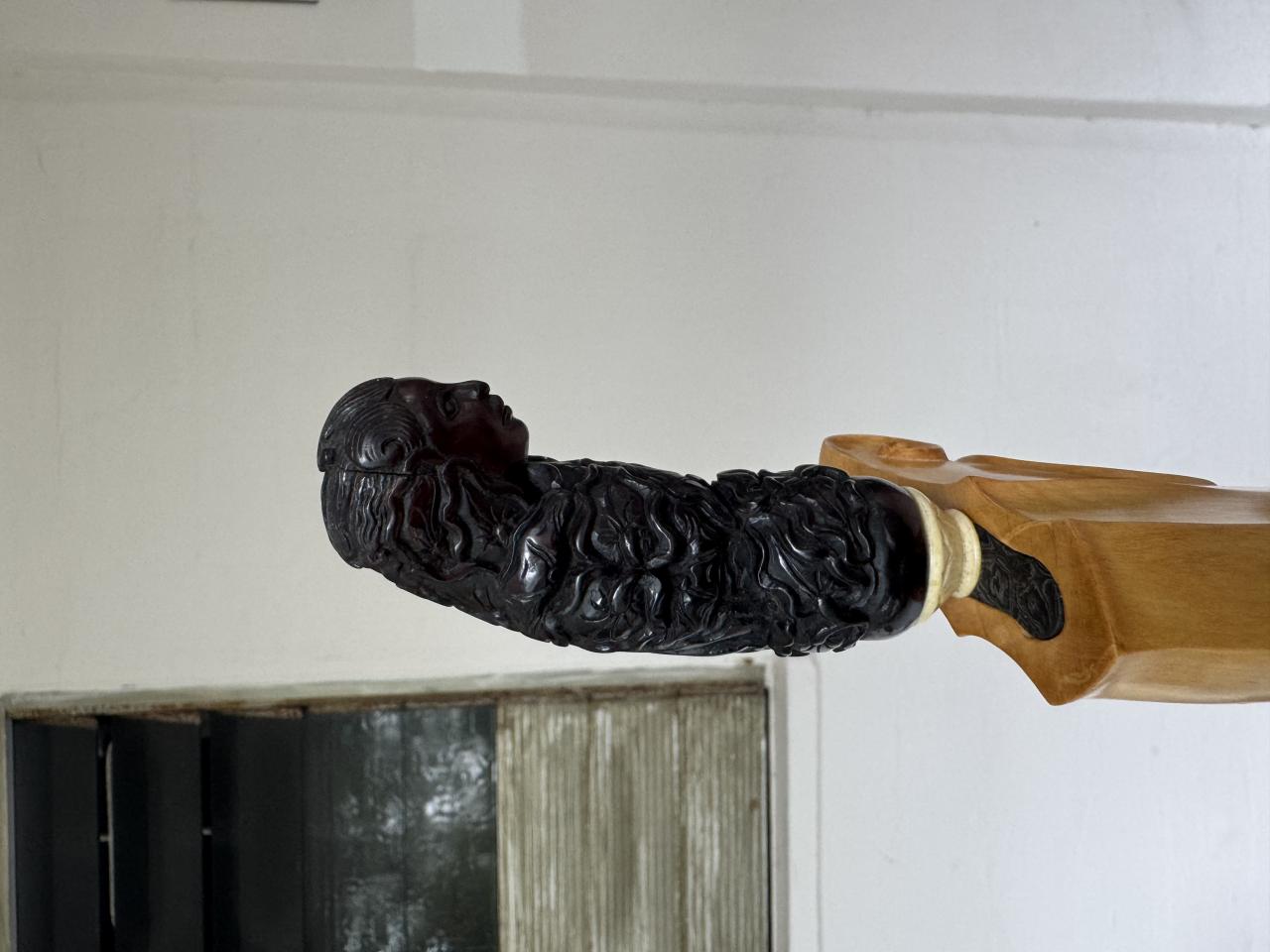

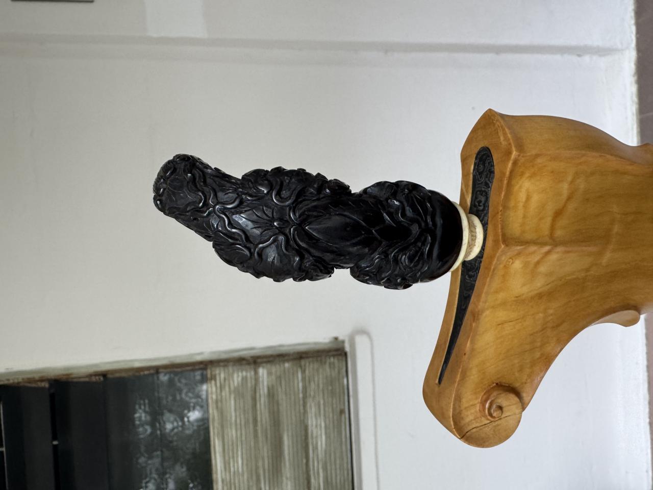

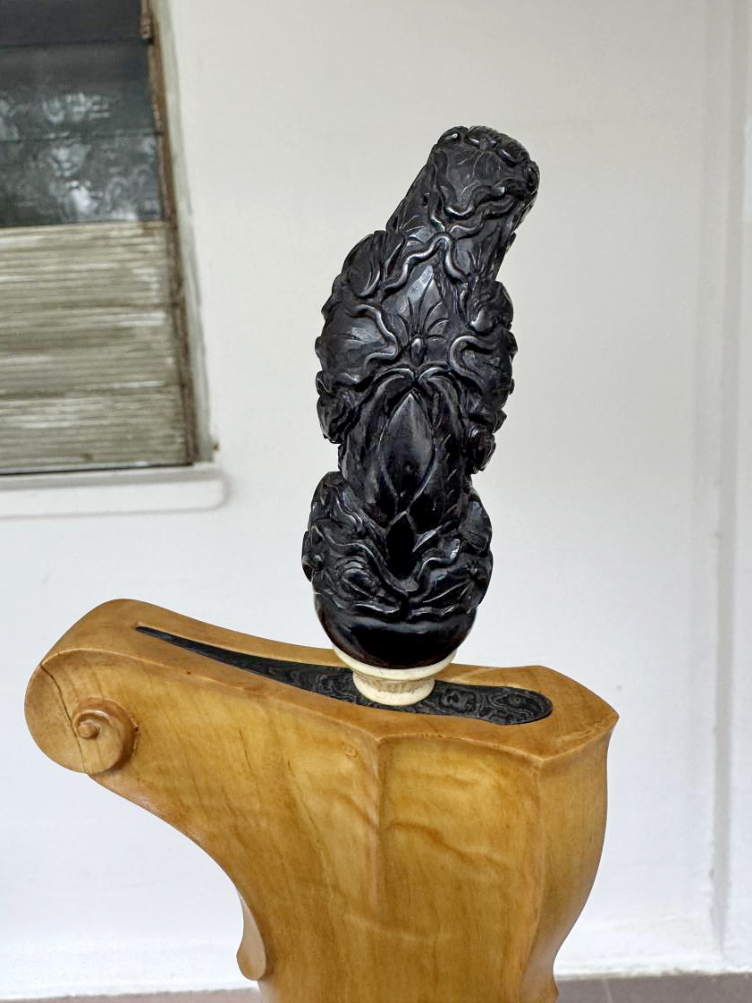

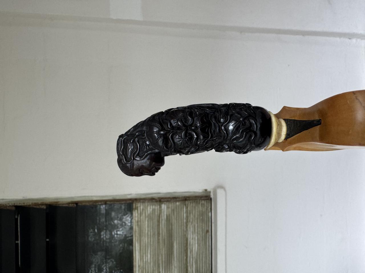

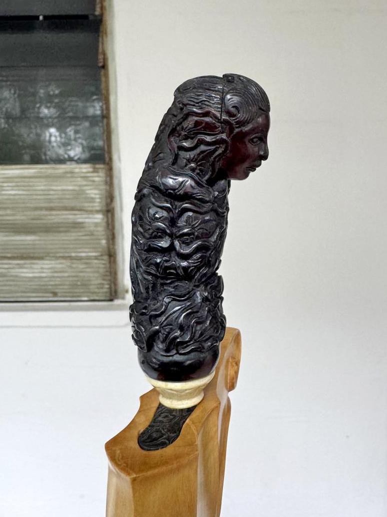

Finally back and had the opportunity to get the pictures. Please refer below:

Old 25th July 2026, 02:32 PM   #6
Posts: 7,303
Yes, a very attractive keris, though i couldn't say for sure who it is meant to depict. Given being wrapped in foliage i suppose this figure might represent an Orang Bunian, forest spirits or nature dieties, but i am just guessing.
I did a quick photoshop on some of your photos to show that details of the carving better.
