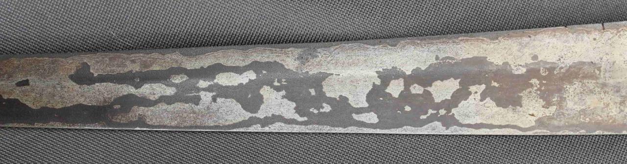

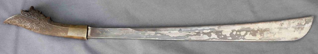

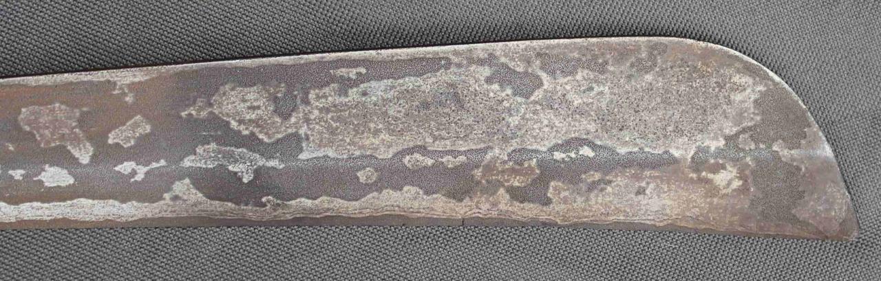

Has anyone seen a pattern like this on a sword blade?
What is it, and how should I treat it? Any thoughts are welcome. The sword is a Sumatran Cot Jang. |
#2 |
Posts: 7,254
This is a laminated blade that has been produced from ferric material with varying levels of carbon, it is also possible that the entire blade was quenched during heat treat, rather than just the cutting edge. It is possible that the lighter coloured material contains some nickel, it could well be iron from Sulawesi.
Personally, I would simply oil & use steel wool on it, the variation in blade colour tells a story. |
#3 |
Posts: 7,415
I'm with Alan. Oil and enjoy.

Posts: 7,254
