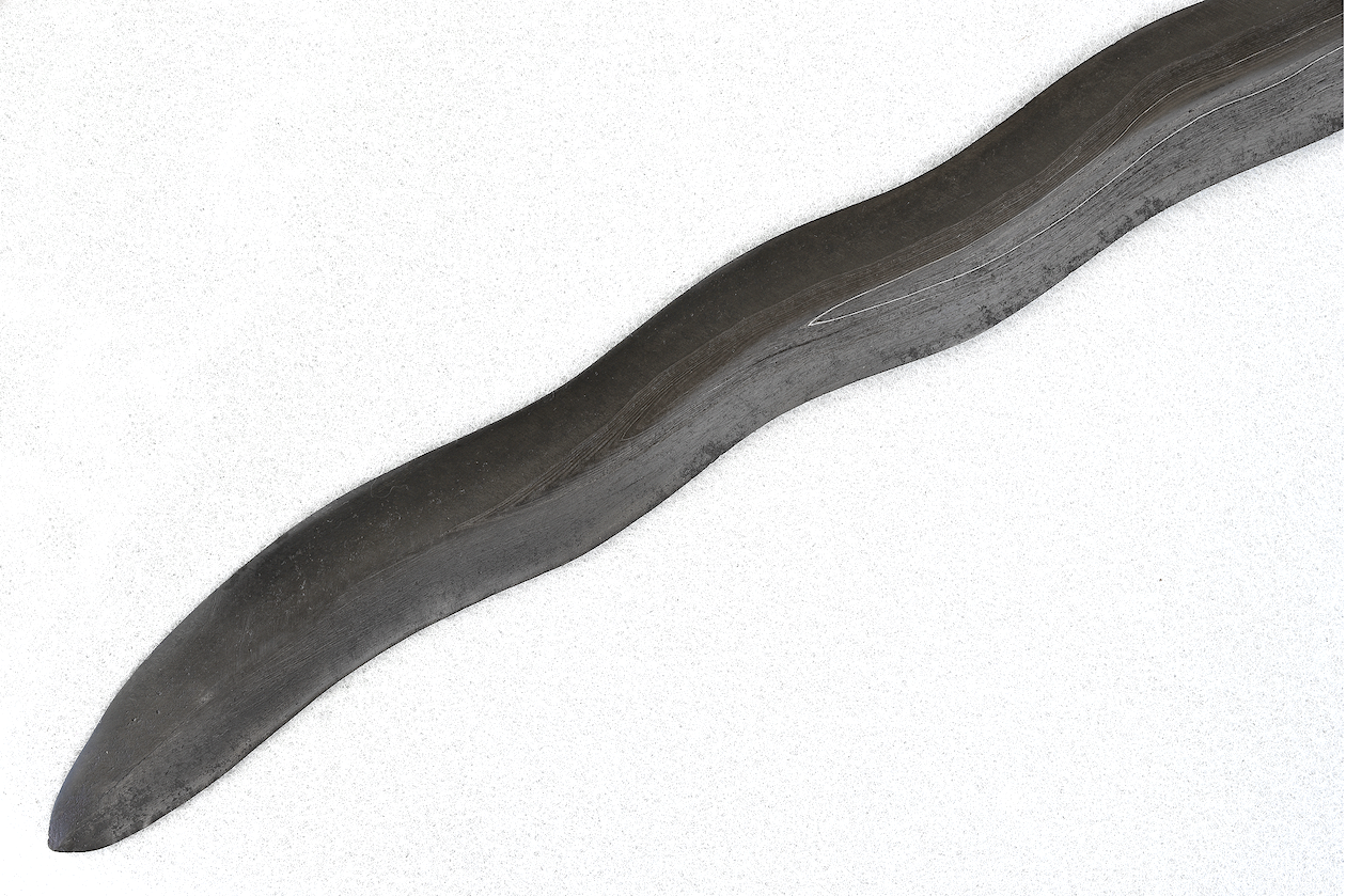

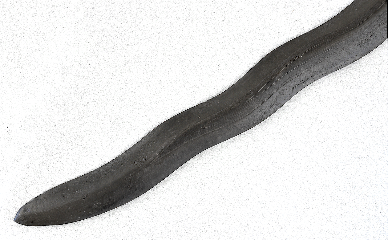

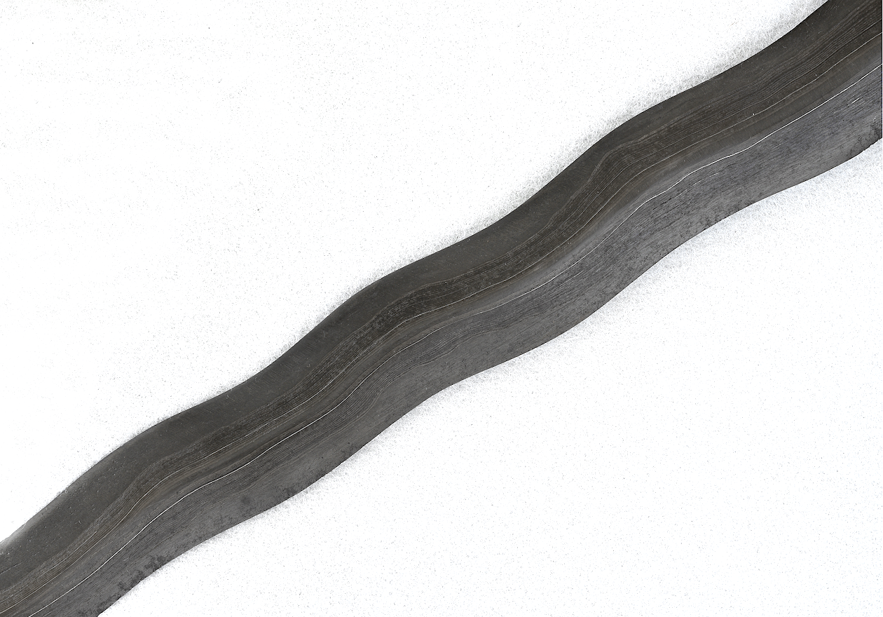

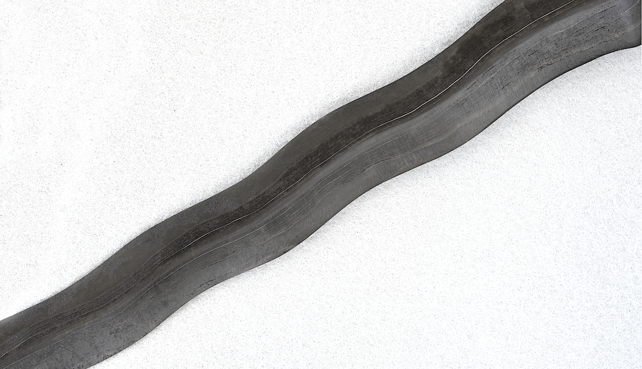

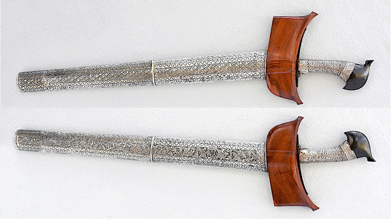

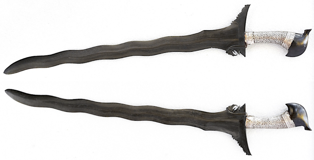

This Moro kris (Malay: Keris suluk; Sundang) is likely from the second half of the 19th C. The laminated blade has, by current Indonesian keris convention, a total of 11 curves (luk). At some point the blade has been stained with warangan, an arsenic-based preparation used to stain Indonesian keris. This is a very unusual treatment for a Moro kris, the blades of which are polished to white or etched with various weak acid solutions to highlight the laminations. Although the blade appears to have a central panel, there is no evidence of twist core elements. A single, steel asang-asang has been stained with warangan also.

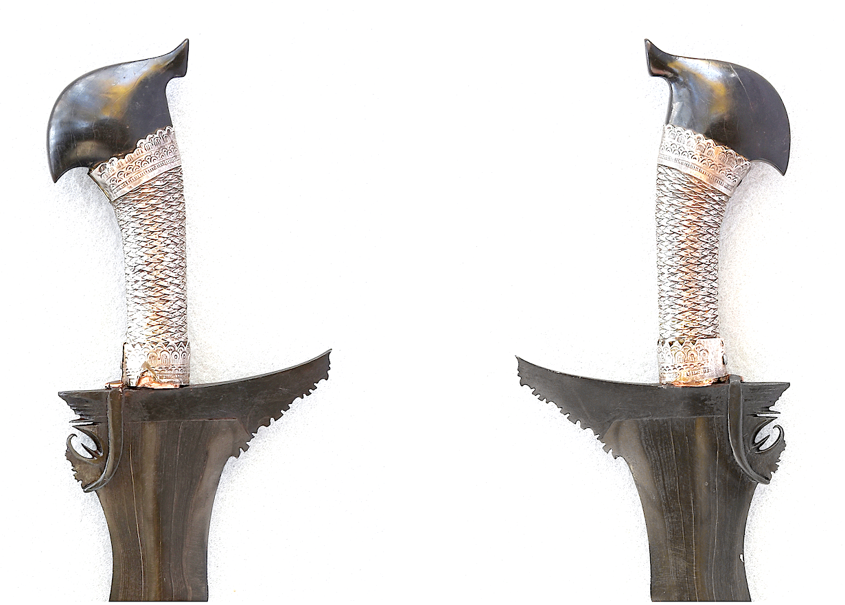

The blade has a flattened diamond cross-section and a central ridge on each side that follows the blade’s contours along its whole length. There is a separate gangya (ganja), with the straight section extending almost the entire length across the blade before angling down to the greneng. The elephant trunk area resembles most closely a Sulu style, with the “tusk” angled towards the gangya and the area enclosed by the “trunk” and gandhik being approximately oval. For this reason, I think the blade is most likely Sulu in manufacture.
The hilt has a silver band at each end of the grip, which has been covered over most of its length with plaited silver wire. The pommel is a simply carved, small kakatua form made from polished horn. The beak of the kakatua is abbreviated compared with most examples of this type, and the crest is likewise small. Side panels are absent from the body of the pommel. Although simple, the quality of carving on the pommel is exceptional: the symmetry of each side is perfect and the carving of this abstract form has created an elegant work of art.

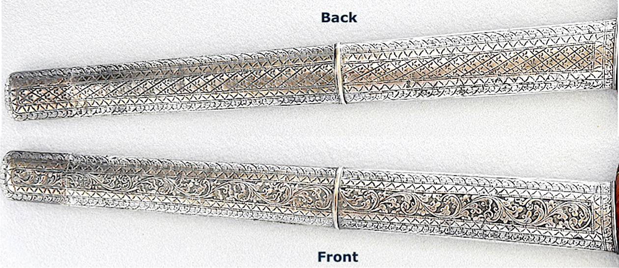

The wooden scabbard is covered with a pendok of embossed silver, segmented by a single yellow band into two panels. The front shows embossed vines running vertically down the pendok, flanked by geometric designs. The toe of the scabbard has a buntut with the same designs in pink-yellow silver. The bottom of the buntut is slightly curved and has a plain flat under surface.
The wooden sampir at the throat of the scabbard is of a form seen widely throughout maritime SE Asia on Malay sundang and Moro kris. The sword sits “proud” in its scabbard, with about 2 mm of the gangya/ganja appearing above the sampir. I’m told this is an old custom for keris, including during the 19th C.
It has been suggested that the different coloured buntut compared with the rest of the pendok might be alluding to a Melayu influence, where the toe of the scabbard is usually ornamented with a dark wood or horn segment or insert.
I have talked with a few people about this sword. There is a sense that it mostly reflects Moro work, particularly the blade. The use of warangan to stain the blade is highly unusual, however, and suggests an Indonesian/Melayu influence. There may be further Melayu influence in the buntut. The vines and leaves depicted on the front of the pendok are consistent with Moro work, but the remaining geometric designs are non-specific. The silver decorations on the hilt are found on both Melayu sundang and Moro kris.
I’m calling this one a Moro/Malay kris because I see elements of both cultures (albeit they are closely related in northern Borneo and Brunei). It may have been created in the Sulu Archipelago as a gift or bride price for a prominent individual in northern Borneo/Brunei, or vice versa. One can only speculate at this time.
Provenance: I purchased this sword from a prominent Australian collector who acquired it in the late 1950s from a Sydney art dealer. At that time the blade had some surface rust and was soaked in vinegar, which removed the rust and left the dark underlying warangan staining. The sword had not been otherwise maintained apart from oiling the blade and cleaning the silver periodically.

I would say that your very nice kris is a Malay sundang therefore also the etching. But I would agree that the blade is most probably Moro work.

Yes. And the Pendok looks like Sumatran work, actually quite typical. Sampir is a Riau form. Terennganu form is very similar, but a bit different.

Thank you both for your excellent comments and perspectives on this sword. i have not seen another similar pendok on a Moro kris, and your comments strongly suggest that the dress of this sword is not primarily Moro (although there are some similar elements—as noted above). Presumably, the dress reflected the tastes of the (eventual) owner. Would either of you care to speculate, based on the styles identified, where that owner may have resided?

I would guess that the first owner was situated in the greater Riau region, like Gustav stated, the sampir is in Riau style and the pendok is very Sumatran in style so this would be my conclusion that this ensemble was put together in this region.

While i see why Ian and Sajen are leaning towards a Moro origin for the blade, the pamor pattern in low contrasting material that resembles Ujung Gunung makes me consider that this may possibly have an Indonesian origin. I have never seen this on a Moro keris.
And Ian, i believe the word for the Indonesian staining solution that you were looking for was "warangan".

Pamor is, what is called Pucuk Rebung/Raja Abala Raja/Jungjung Derajat. As I understand, Pucuk Rebung was more used in Sumatran/Peninsular context.
While this Pamor could be very rare or unique for a Moro blade, sometimes quite unexpected Pamor can appear on these.

You raise an interesting point. I have not thought of Moro kris having pamor. To the extent that laminations are present and define a pattern, the only intentional pattern of which I am aware on Moro swords is the deliberately forged twisted core pattern. Otherwise, my impression was that laminated patterns (when present) resulted from the manner in which a Moro panday chose to work the metal, and that the resulting visual effect was a secondary concern or accidental.
If this understanding is correct, should we be looking for a defined pamor on Moro blades? I can understand why such a description might be fitting for a Malay sundang, given that such a sword cohabits a culture that also uses and respects the Indonesian keris.

Ian, what you describe would be Pamor Rekan - "engineered" Pamor, versus Pamor Tiban.
In short - Pamor Adeg is not very rare on Moro Kris, I have seen some examples here on forum. From Pamor Adeg there are only a couple of steps to Pamor Pucuk Rebung.

Thanks again for your observations. I am unaware of any significance that Moro culture might attach to the pamor that you describe. That these patterns appear on Moro kris seems unintentional and, in my limited knowledge of Moro views on such pamor, of little consequence to them other than perhaps an element of decoration. At least, that is my working hypothesis—but I am always willing to be proven wrong.
Moro etching of kris blades is usually done with fruit-based organic acids, such as vinegar or kalamansi juice (a particularly tart form of lime juice). Organic acids are a "less aggressive" acid etchant than metallic acids such as warangang or ferric chloride, or common industrial acids such as hydrochloric, nitric, sulfuric, or phosphoric acids.

Ian, I never claimed any significance to Pamor on Moro Kris, I just say, that we sometimes see other intended patterns then twisted rods. Please don't put words in my mouth.
Warangan is not a "metallic" acid. There are Moro Kris, which were stained very dark, and that could suggest treatment with Warangan. In fact, such result was achievable only with Warangan. One of these fotos circulated a couple of times on this forum, another one, a Kris from Munich, collected quite early, I posted maybe ten years ago. There are many methods of staining a blade, and there often is more than one used in a region.

What Gustav stated is that Moro kris blades which show a lamination could appear stained with warangan and as a result of this the appearance is very dark after such a staining.

Finally had chance to see it on bigger screen. These are horizontal layers, so no Pucuk Rebung here.
