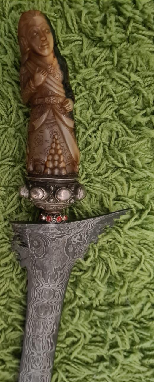

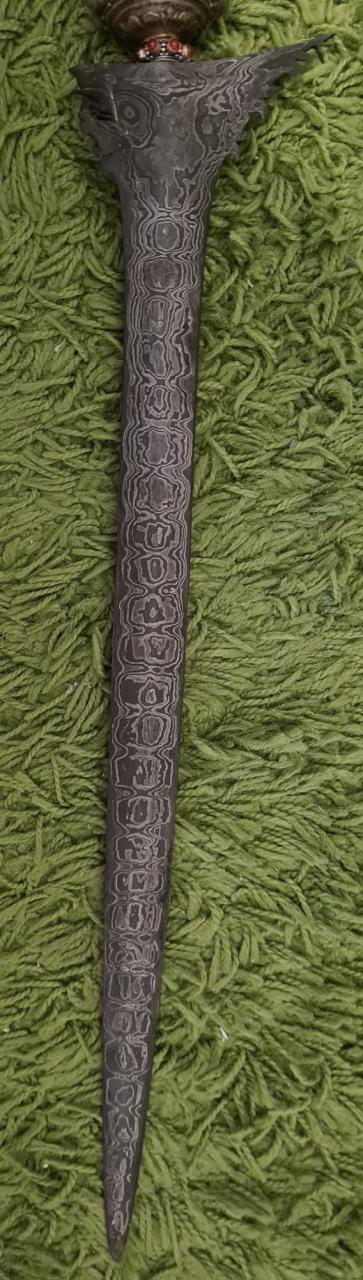

Here's my Iras blade.
I have a feeling, that due to the size (15") and polish, it may be from Lombok.

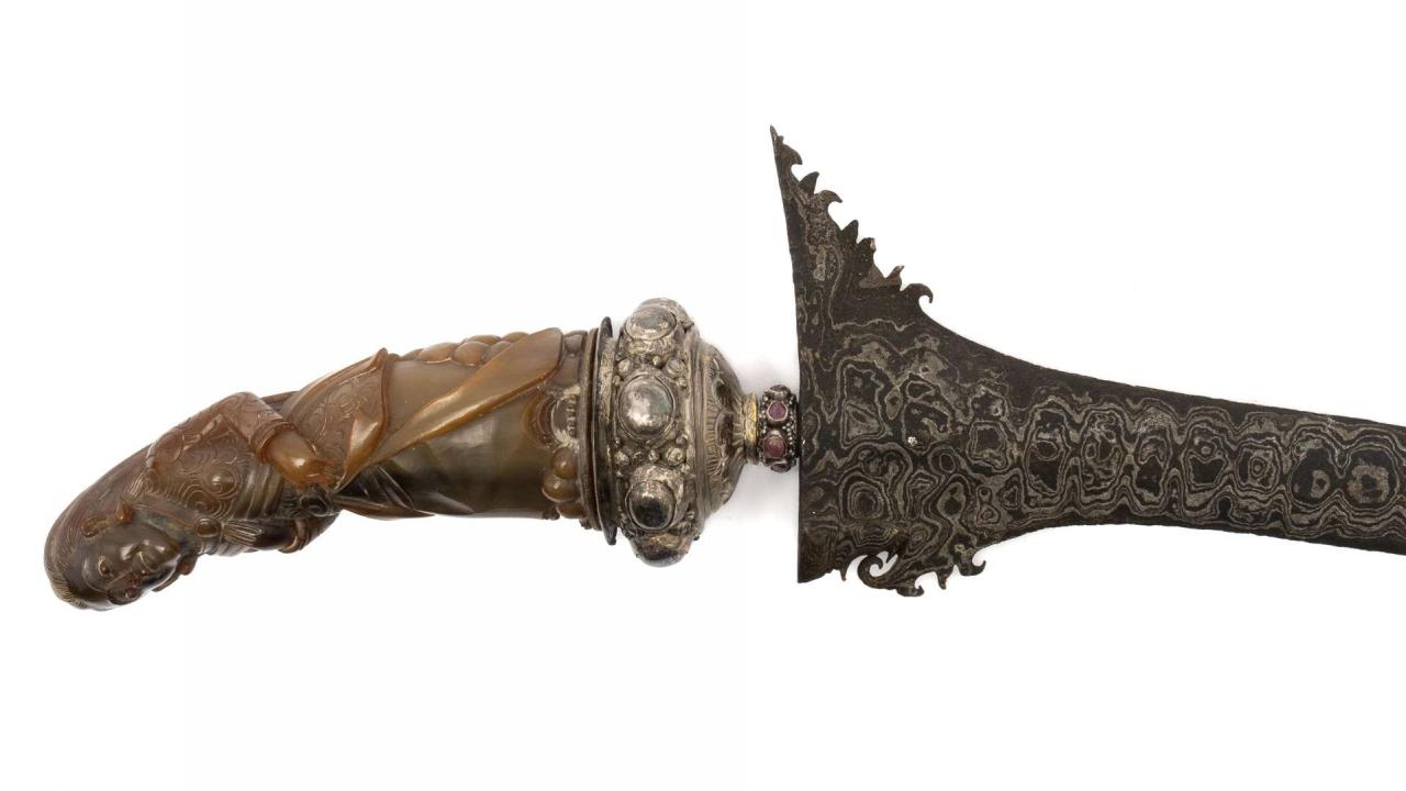

I have owned a few ganja iras krises and they came from several regions.
Palembang and Bali for example.
At the moment I still have one which is one of my precious possessions.
A Balinese kris which I bought without the Hulu ( it had a wrong sheath with a pencil written description of the village where it was found in Indonesia by a Dutch soldier ) and later on I had de sheath made to measure and purchased a Hulu at auction which then turned out to be almost identical to other kris, also Ganja Iras from Bali with a similar Bengo Segodo Pamor which belonged to the collection by E.A.N. (Emile) van Veenendaal.
I have shown and spoken about this kris before.
Im my opinion making a true ganja iras (so that the Ganja is not lost and not replaced) is a sign of great security of the kris maker.
If the maker at the last stages of making this kris makes a mistake it would be very difficult to recuperate the kris.

if the greneng carving goes wrong then the Keris has to be rescued somehow, in that respect if not taking longer, the kris maker has to pay more attention to the carving of the small details
this is the almost identical kris from the E.A.N. ( Emile) van Venendaal collection
Slightly different but incredibly with the same hilt and the same ganja iras and pamor
