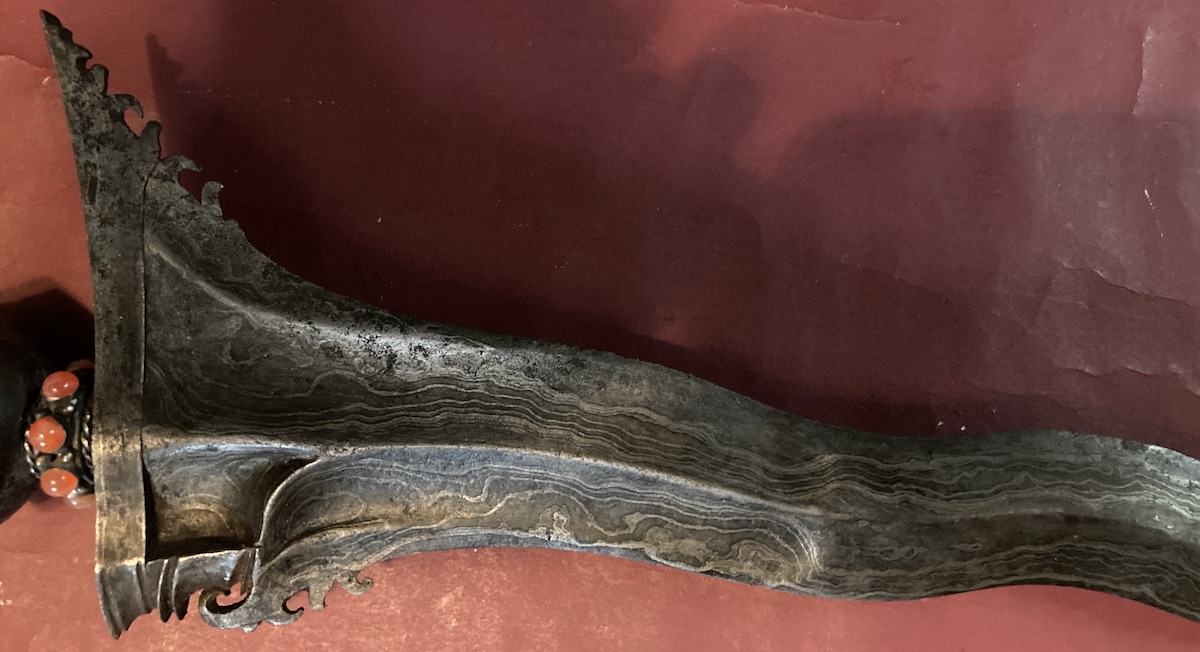

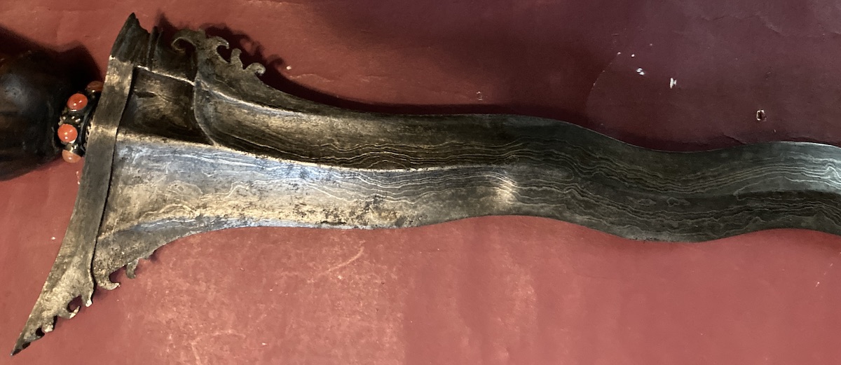

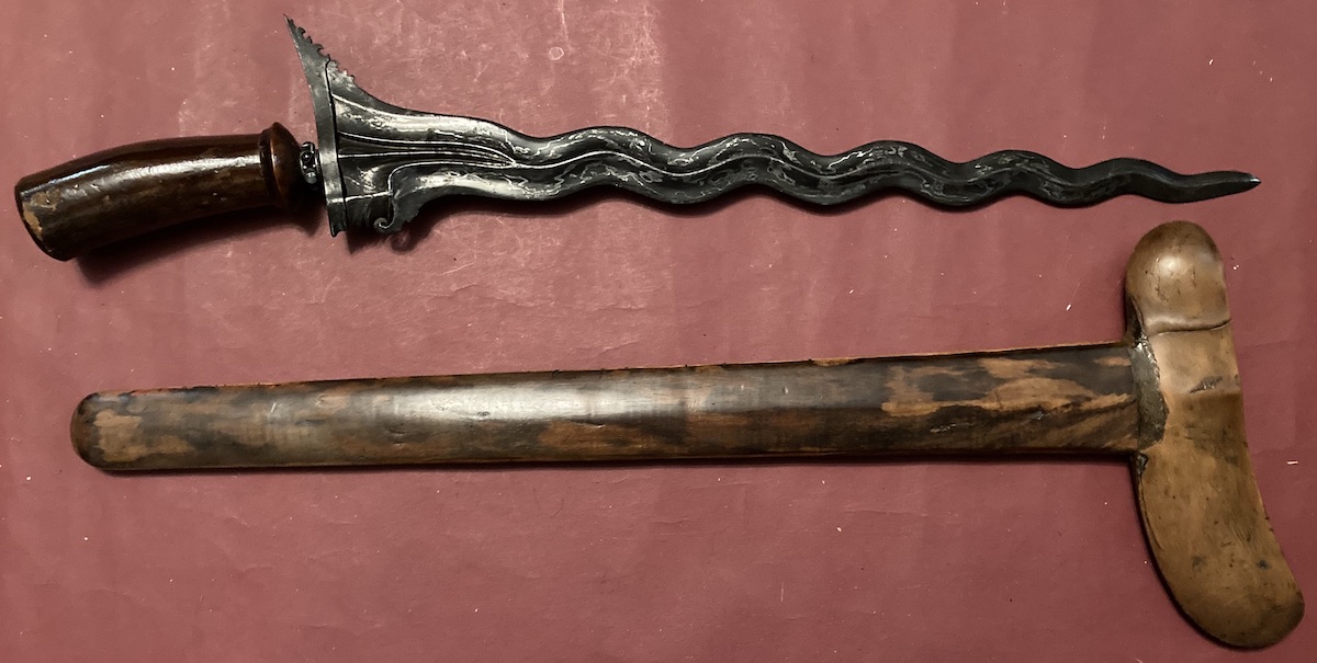

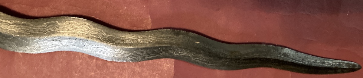

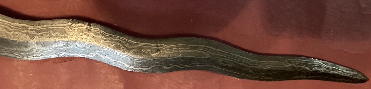

Hi All,
I bought this Bali keris a while ago (uwer added by me). I think the dapor and pamor are both very nice. Save for the broken last piece of grenning on the aring side, the blade is in pretty good shape. I think the blade and sheath are older than the hilt which I believe to be made of suar wood (AKA monkey pod or Rain tree, Saman Samanea). I would appreciate forum members opinions and observations so I can tell whether or not my evaluations are accurate. Can anyone id the pamor?
Sincerely,
RobT
Old 13th April 2026, 12:07 AM   #2
Posts: 7,201

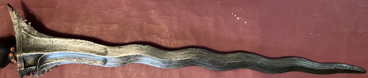

This is pretty fair old keris Rob, the blade could do with a bit of a clean, but I would probably not go gangbusters on it, the pamor is quite readable, there does not appear to be any excessive active rust, maybe just a good soak in WD40 might be sufficient.
At times I’ve worked over a blade in this sort of condition and picked the rust out of the pitting with a needle, I use a saddlers awl with a fine needle, & under bright light & sometimes magnification.
I cannot see any breaks in the greneng, could you clarify please? Maybe the last bit of greneng in the wadidang is a remnant of a broken piece, but the image is not clear on my screen.
The hilt would be referred to in Bali/Jawa as “pelet” wood : “kayu pelet” & possibly as timoho.
I would give the pamor as ilining warih/banyu mili/air mengalir/flowing water.
One face of the blade has been forged more heavily than the other, & this has resulted in the central part of the pamor on that face as presenting as wusing wutah/ujan baas/beras wutah/beras utah/wos wutah/scattered rice grains, however, ilining warih was clearly intended, so it should be named as the maker intended, rather than as it finished up. It is a not a different pamor on each face, only one side was not as well managed as the other.
In Bali the form (dhapur) of a keris is not as strictly regulated, nor taken note of, as in Jawa, however, I would probably give this keris as Durgam Pinis, luk 11. I cannot translate this name, "durgam" seems to indicate "dangerous" or "immoral" , "pinis" is actually one of the woods used in woodcarvings.
I am naming this dhapur in accordance with present day practice of the most influential Balinese keris literate people, & I would not challenge any other name given by somebody else. In Jawa all this nomenclature thing is pretty much defined , in Bali it is much more relaxed.

Yes, the first element of Greneng is broken.

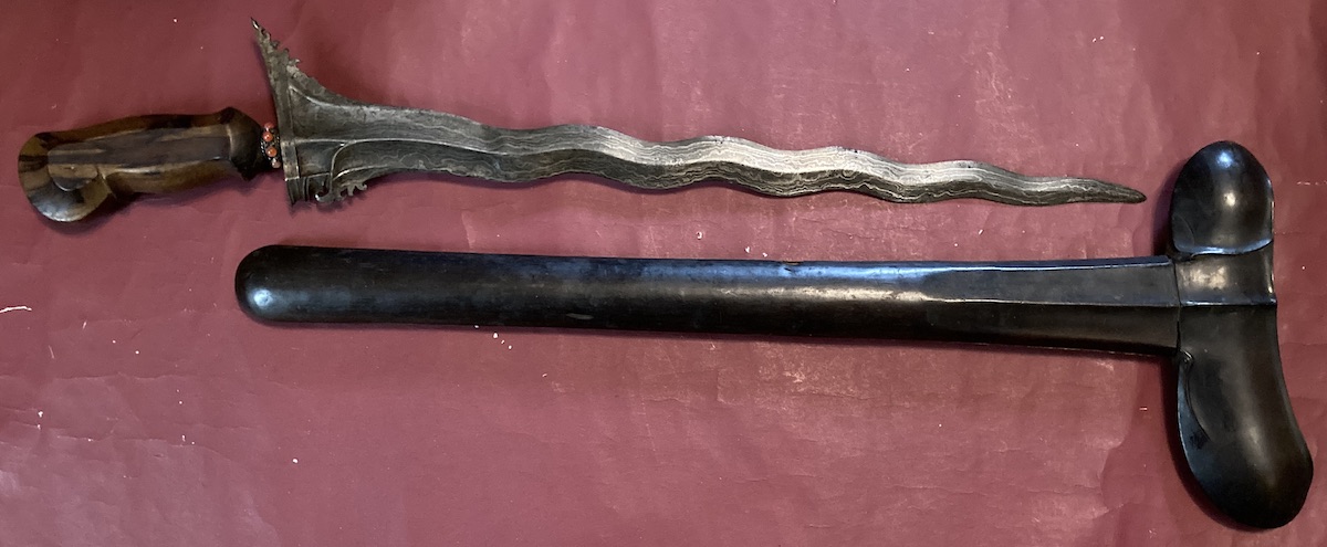

As I understand, a sheath of such proportions, with a slender crosspiece, could likely be attributed to Northern Bali.

I'm using a decent screen now, & I can see that there is a little stump in the middle of the wadidang, this is a very minor defect and in Bali it would be cleaned up the first time the keris was placed with a m'ranggi for clean & stain.
Yes, that style of sampiran (the top cross piece of the scabbard) is usually attributed to North Bali, specifically Singaraja. The style is called " gegodohan".
However, a camera angle can alter perception, & there is very little difference between some bebatun pohan styles, & this particular gegodohan style, there are several styles of each of these types of sampiran. It can be quite difficult sometimes make a correct judgement from a photo. It is a similar problem with the bebelatungan style, in a photo it is sometimes difficult to differentiate between bebatun pohan & bebelatungan.

A. G. Maisey,
I’m glad my assessment was basically correct. Thanks for the pamor and dhapur info plus the cleaning advice. I think I’ll stick with the WD40 soak.

The Northern Bali info is valuable and I’m glad A. G. Maisey added the name gegodohan. I have another Bali keris with a really narrow sampiran (which means boat and is the Balinese term for the Javanese wranka?). I will post a picture of that keris with this response because I would like to know if it also qualifies as gegodghan and if the hilt can be called cenegan.

Yes, I believe that in this case WD40 might be the way to go.

RobT, by "Cenegan" you obviously mean Cenangan. Terminology depends on time and the linguistic/social group, that uses that terminology. My feeling at the moment is, term "Cenangan"could be something of an umbrella term for simpler hilts of related form, and possibly could be not older then 100 years, likely younger. This particular hilt looks quite like a Tapukan which has lost its hair wrapping and subsequently lacquered.
The term Sampiran - do Balinese really use it nowadays? If yes, I doubt, they do for longer then about 30 years at most, as it quite surely comes from peninsular Malay Keris community/English language writers about Keris from Malay states. The boat/ship iconology in the cross piece of sheath is stressed all the time, but word Sampir doesn't have such connotation.
According to Neka the cross piece of this second Keris would be Gegodohan, as Neka in his book seems not to distinguish between Gegodohan and Bebelatungan - he even don't use word Bebelatungan.
I am not sure if the crosspiece and the long part originally belong together, as the proportion seems to be a bit off. But even if it would be so, that's not important.

The second keris that Rob has shown us definitely has a gegodahan sampiran, this is evidenced by the presence of the alis kidang, that widengy little curved line just next to where the foot of the sampiran enters the body.
We need to be a little bit cautious with the Neka publication, Mr. Neka himself is a respected authority in Balinese art & a member of the Pande Clan, but the credit for the text in "Keris Bali Bersejarah" probably should go to Basuki Teguh Yuwono, who is Javanese and a noted current authority in the world of the keris. A thorough reading of this book does raise a few questions.

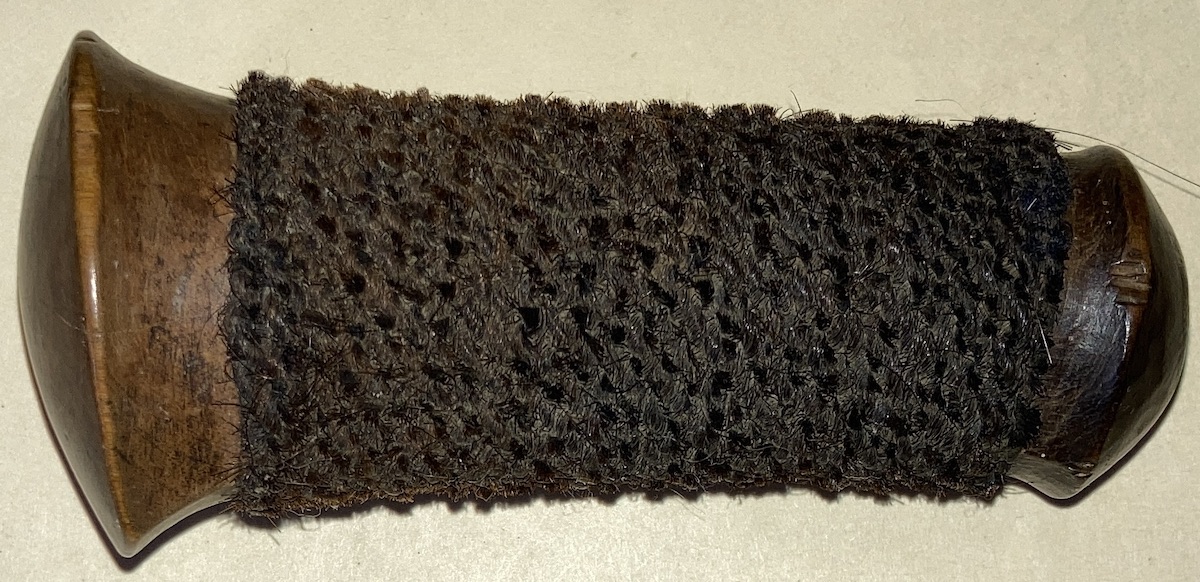

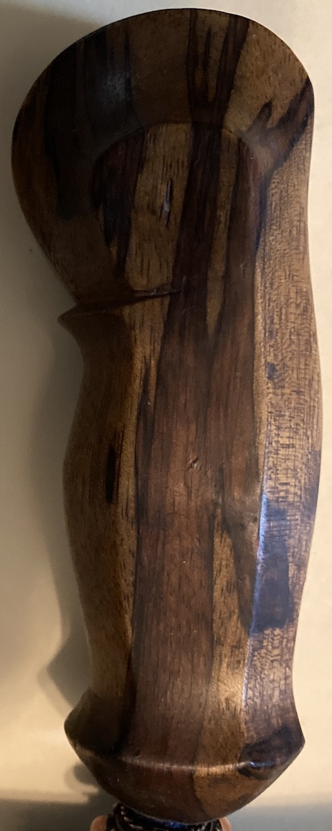

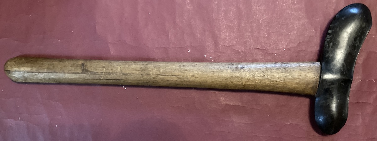

Many years ago I bought the hilt shown below on eBay. The seller called it a Balinese canegan hilt. I just perpetuated the error.
As for my assumption that sampiran means boat. That was simply based on my incorrect belief that sampir meant boat. I shoulda checked. As for sampiran being the Balinese word for wranka, since Gustav wrote, “a sheath of such proportions, with a slender crosspiece, could likely be attributed to Northern Bali” and you responded, “Yes, that style of sampiran (the top cross piece of the scabbard) is usually attributed to North Bali”, I thought you were referring to the entire crosspiece (wranka) and calling it by its common Balinese name. If I understand correctly what I later found online, the word sampir (from Old Javanese meaning scarf or shawl) only refers to the sheath mouth. Does this meaning also apply to the word sampiran and, when referring to keris, do both words mean the same thing?
Gustav,
So, if I understand you correctly, the proper spelling would be cenangan but, since that is a fairly recent coined catchall term for related forms of simple hilts, both of my examples should more properly be called tapukan? With this post I have provided an example complete with hair covering. The wood of this hilt is one piece but the wood of the second kris I showed is in two pieces. As for that second kris, you may very well be correct about the “crosspiece and the long part” not being original to each other. The figure in the wood of the gandar and that of the wranka don’t match. Also, that large brown patch where the two parts of the sheath join appears to be some kind of wood putty. There is also evidence of extensive repair to the same area on the back side of the keris.

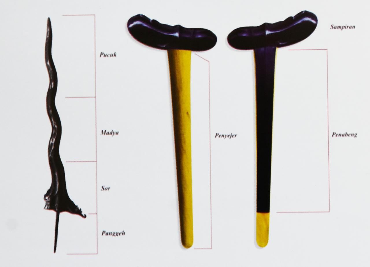

This picture is from the book I mentioned, it is a bit blurred & the pic in the book is small, but I think it is sufficient to tell the story. If still unclear, please do not hesitate to make a further enquiry.
Rob, I do not want to jump into hilt names, because you have addressed these questions to Gustav, & we really should wait for his response before making a comment, however, the way this discussion is moving is straight into a mine field, one of the reasons I really do not like playing name games with Indonesian terms & very much do not like playing name games with keris.
Put it this way:- you ask ten Javanese people for an opinion you'll probably get upwards of twenty firm opinions, same applies with Balinese people. And all of those 20+ opinions & ideas will depend upon a multitude of factors that nobody who is a stranger to these societies could have a hope in hell of understanding. What you think you understand today can be contradicted tomorrow, what Pak Gede told you this morning can be different to what he tells you this afternoon, & both things might be generally accepted as fact, or both things might be generally disregarded as nonsense. Maybe the only way to come to a reasonable understanding of the keris in Jawa & Bali is to immerse yourself into the two societies & at least have some sort of understanding about what you are being told & why.
Outside of keris literate people in Jawa & Bali I often find it is easier & safer to use English language terms if possible.
