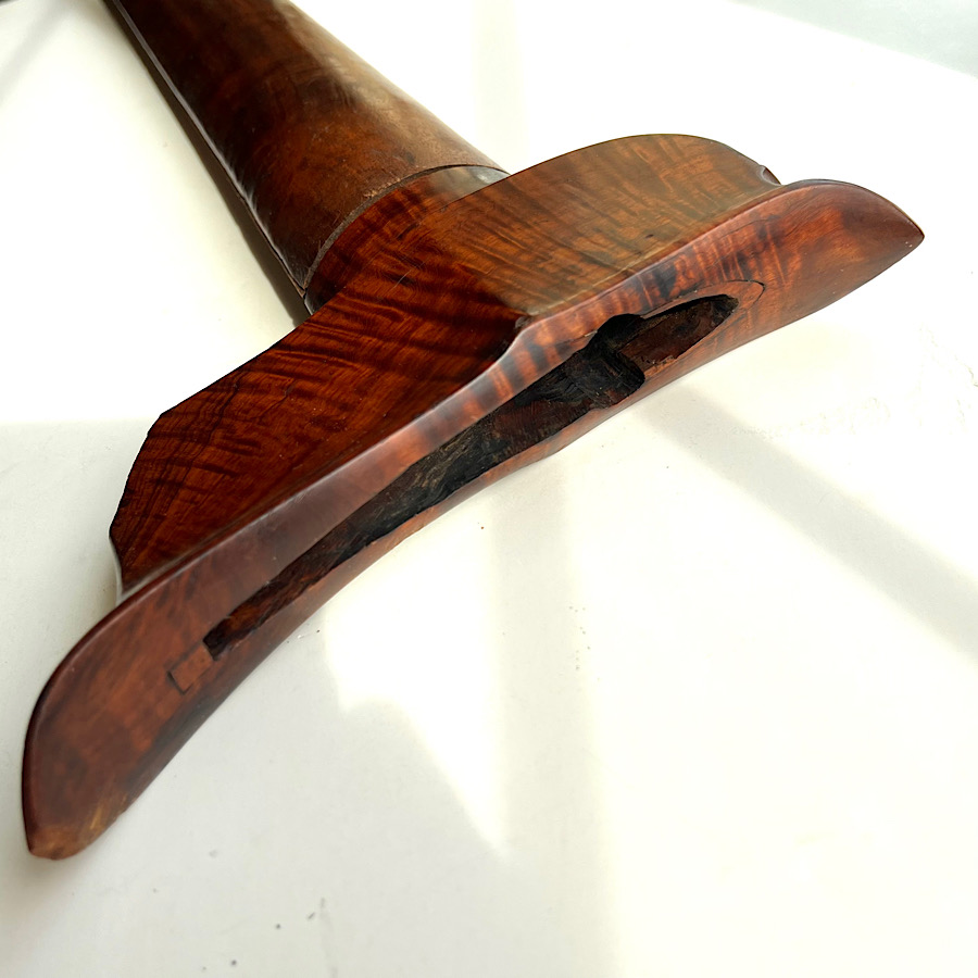

Hi All,
My wife gave me this very nice 3 luk Bugis keris with its very well carved, ivory Java demam hilt and silver selut for my birthday. I have four questions about the sheath which appears to be fairly recent. I know that I will need to make a small modification to the throat in order for the blade to seat properly but the size of the wranka appears to be proportionate to the hilt.
1) Is the sheath (which appears to be Sulawesi) appropriate for a Sumatera hilt?
2) Even though the gandar is considerably longer than the blade, can I leave it as is?
3) If the gandar needs to be shortened, how short can I make it without it appearing too “stumpy”
4) I would like to replace the damaged buntut with something to match the hilt. Would camel bone be appropriate?. I have some ivory scraps that could work also but I would prefer to use bone.
Sincerely,
RobT

There is no question that the sheath is not original to the blade and In my previous post I had mentioned the possibility that the hilt and selut weren’t either. Of course, you are far more knowledgeable about keris than I am but it’s funny how different people see things. To me, the hilt and selut look a tad too large for the blade but just right for the sheath. That’s not to say that the hilt wouldn’t still look good in the sheath if it were a bit larger but, as it stands, it’s a pretty whacking big chunk of ivory already.
A. G. Maisey,
I am following your recommendations exactly. As I mentioned in my last post, I have already widened the sheath throat (at best 1/64” on each side) so the blade seats fully without wobbling and aring side fits well. It took at most 30 minutes work making flight passes with a fine cut riffler and checking the blade for fit between strokes.
I have cut the wooden plug for the dagu side and it fits well. Now comes the really hairy part, matching the color of the plug to the sheath. This will probably take about a week as I test various agents on pieces of scrap wood and wait for them to dry fully.
The buntut has been covered with a rather opaque stain. I have examined the chip with a magnifying glass and it appears for all the world to be some sort of poplar. The bottom of the buntut (where the stain is less opaque) shows a figure like poplar also. Ideally, I would like to fit a wood piece to fill the chip but that looks like it might be tough to do. I’ll give it a shot but, if I fail, plastic wood will work.
Sincerely,

Old 19th March 2026, 09:58 PM   #23
RobT
RobT's Avatar
Join Date: Mar 2005
Posts: 644
Default Work Complete
Hi All,
Here are photos of my efforts to modify the sheath throat and repair the buntut. Thanks to all for your advice about what and what not to do with the sheath.
Sincerely,
RobT

Rob, for a first attempt at this sort of modification, I consider that you have done a pretty fair job.
However, if you are prepared to spend more time on the job --- as your remarks do seem to indicate --- I suggest that you have a look at Post 16 & Post 17.
If you were to completely line the mouth with a contrasting wood, this would turn the minor defect of poor fit into an enhancement.
Yes, it will take time & care, but it will look a lot better than just taking up the space in front of the gonjo with a piece of wood.
I have found that the easiest way to do this job is to fit a plug of wood into the mouth of the wrongko first, I use tinted 5 minute Araldite as the adhesive.
The mouth of the wrongko can be enlarged a bit first but be careful to follow the shape of the gonjo.
After the new wood is in place and the adhesive has cured I drill a hole in the middle of the plug and line that hole up with the tang of the blade --- you place the blade onto the wrongko so that the gandar will accept it, & the top of the gonjo is level with the top of the wrongko (gambar, atasan).
Then you just gradually enlarge to hole you have drilled to accept the gonjo, you smear light oil onto the sides of the gonjo & just scrape away where the oil shows on the new wooden plug.
I prefer a dark wood for the plug, black ebony works well, but it is not all that easy to work with.
