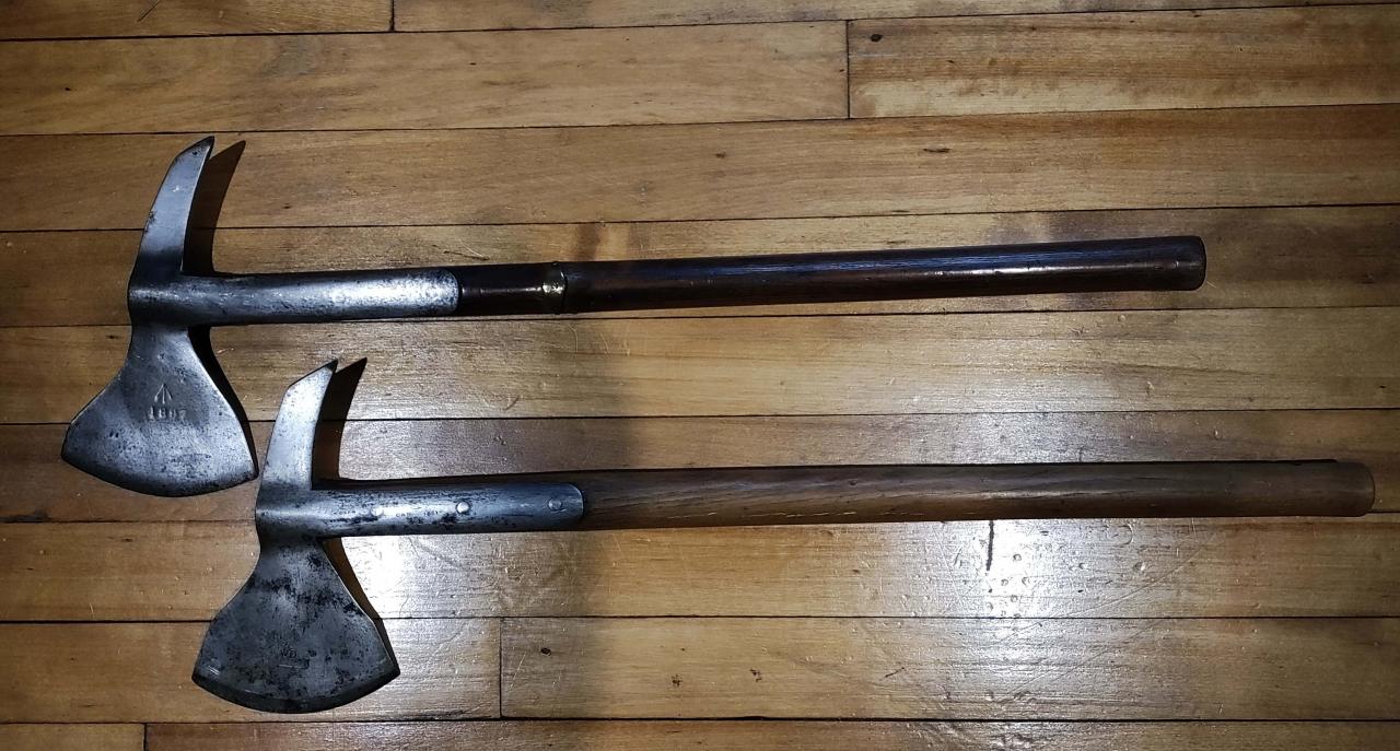

Hi Mark,
The top axe is from my picture archive, so not mine. There are only two known that were made by Chas Thomas. Richard Thomas axes were a little more common but almost all these model 1859 boarding axes were made by Gilpin with dates ranging from 1861 to 1898. Only these three makers carry British government or Navy marks.
A slightly different shaped axe was manufactured for private purchase or other navys by:
John Yates and Co.
Adams Small Arms Company (famous for revolvers)
Apsam Co. Based in London WC
Here are two of mine. The top is a Richard Thomas 1897 and the lower one is a Gilpin 1861.
