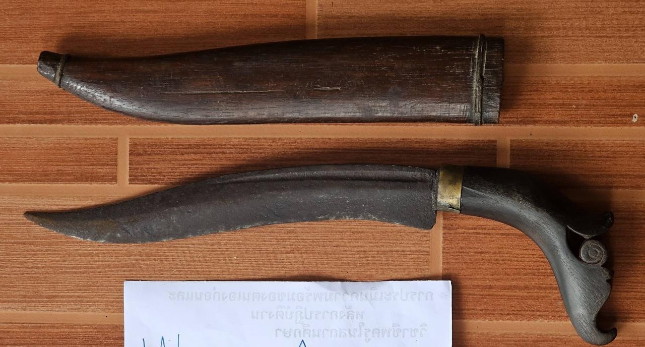

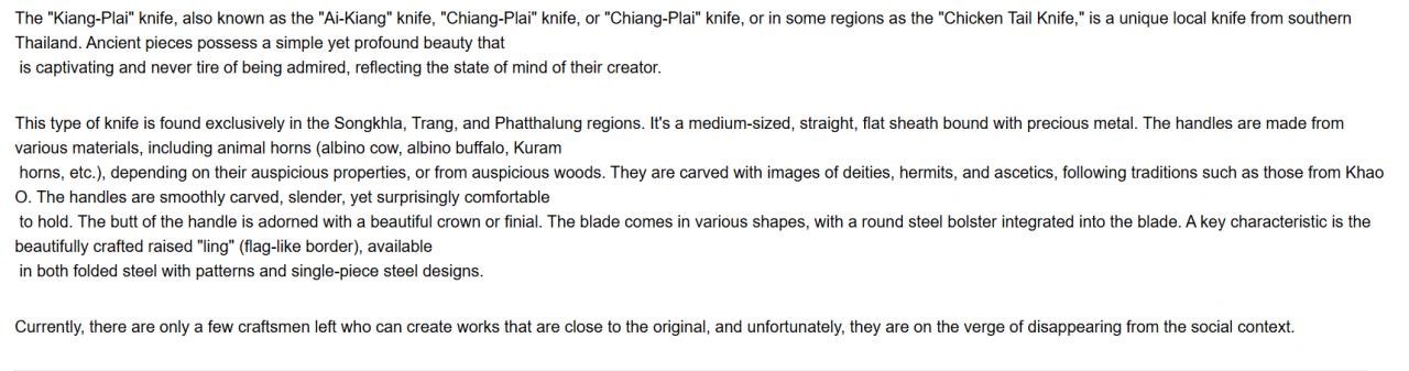

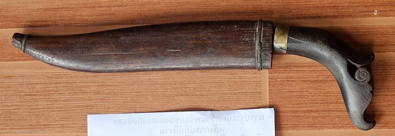

I got from a Thai collector that the knife in question is indeed a Southern Thai knife. What he stated I've attached as a picture and also a knife with a similar handle which was offered by a local collectors market in Thailand.

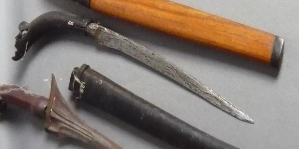

Another knife, again a different blade style but with a similar handle.

Hello All,
If wikipedia is correct, Phatthalung, Trang, Songkhla all have significant historic Malay populations.
I could totally believe that these knives come from the Malay cultural sphere, which of course extends to Sumatra.
Have fun,
Leif
