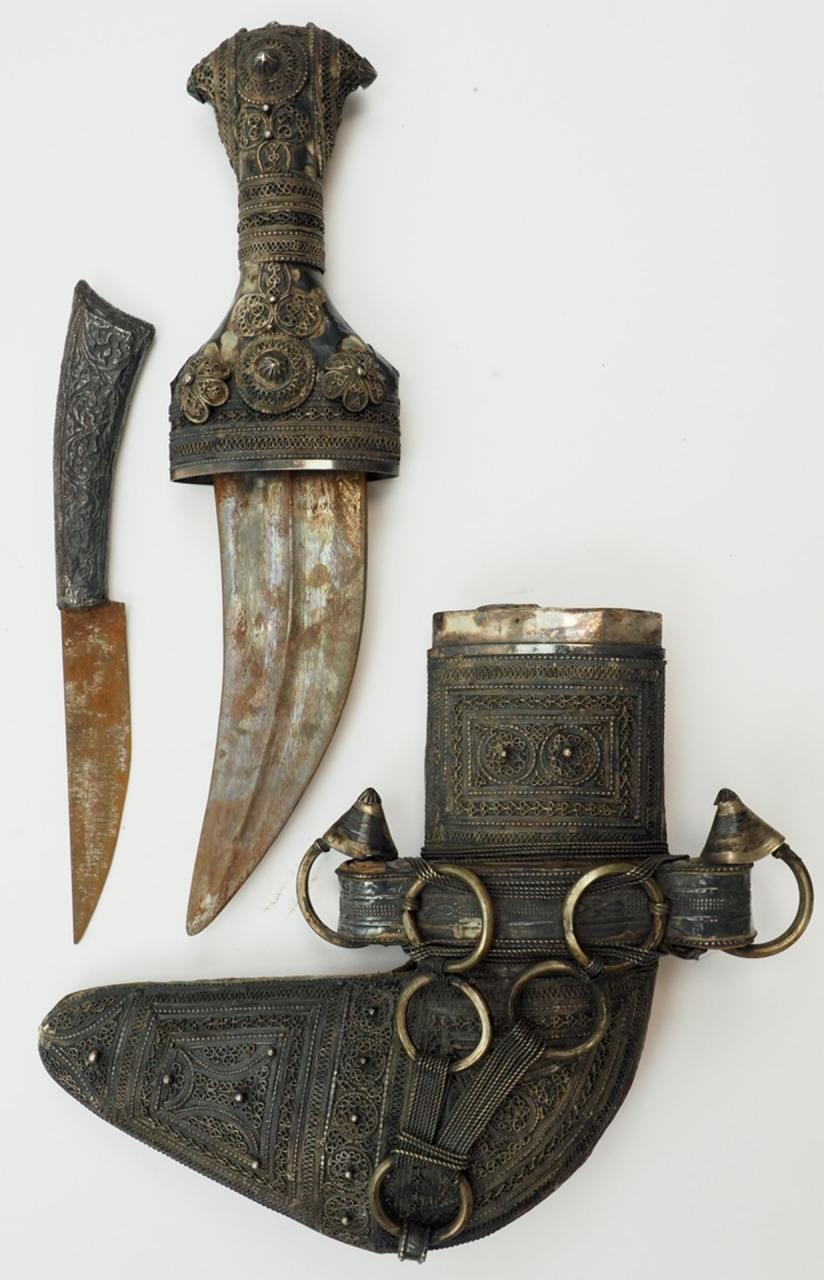

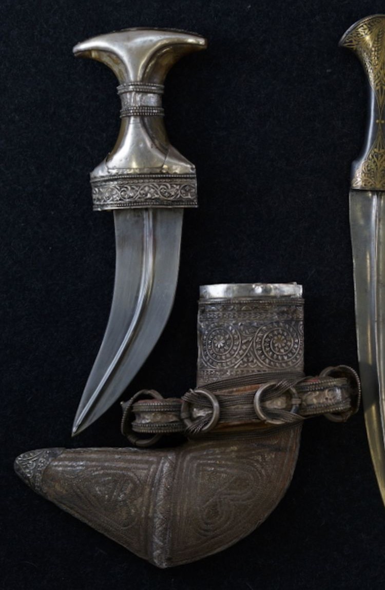

These are Khanjars from Oman, not Yemeni Jambiya, circa the second half of the 20th century. Take a look:
http://www.vikingsword.com/vb/showthread.php?t=22016
khalid.4545@gmail.com
https://encyclocraftsapr.com/khanjar-dagger/
According to my information, blades made from two sheets of pressed steel were made for tourists.
Sincerely,
Yuri
