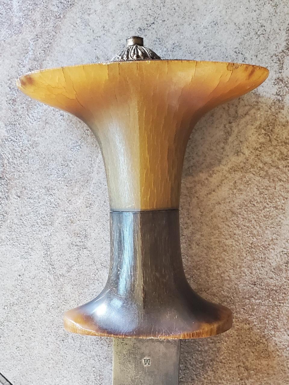

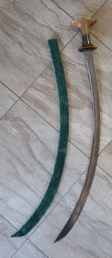

This shotel I have had for many years, and going through things I wanted to update with more revised description. I am always puzzled by the use of the term shotel as opposed to 'gurade'. I have understood both to be terms used collectively for the sword in Ethiopia.
Also, am unclear on the versions of shotel......the deeply curved sickle form as opposed to these with of course the same style hilt, but using saber type blades which seem of the cavalry types of 19th c.

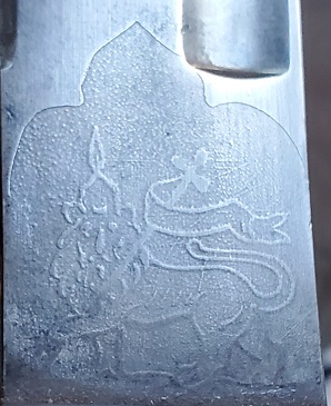

With this example it seems the cavalry type blade has the Abyssinian 'Lion of Judah' in the blade at the forte. The green velveteen scabbard reminds me of the styles used for Indian tulwars.
Some questions:

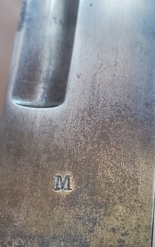

The blade seems like a product by perhaps Wilkinson? made for export to Abyssinia in last quarter 19th into early 20th c.. Any idea what the distinct 'M' might be for?
I know Germany was also providing blades to then Abyssinia in these times, into 1930s if I understand correctly.

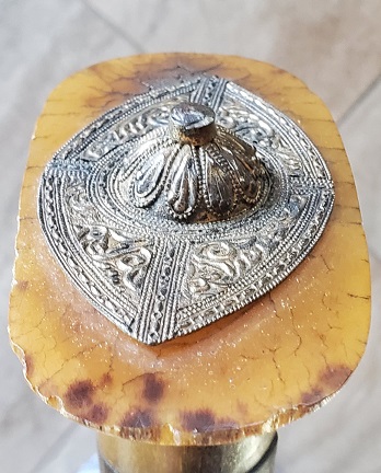

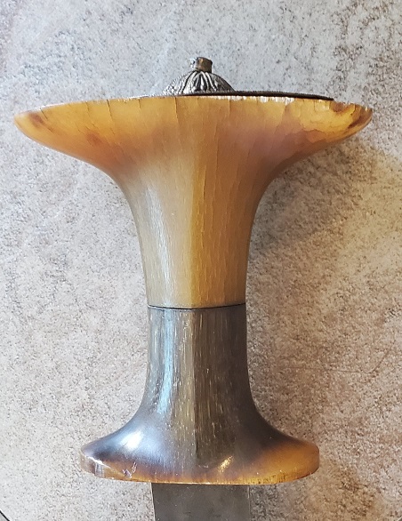

What is the material in the unusual combined grip, horn? and wood. Any ideas of what types?
While I have studied swords in form and history for many years, these kinds of particulars are for the experts here who specialize in these areas, so I REALLY would be grateful for your insights.
Thank you guys,
My understanding has been that the sickle shaped and forward/outward curved swords are labeled shotel whereas the saber bladed and straight bladed swords are named gurade. So yours would be a gurade (and a very nice one!).
Shotel:
Gurade:
And of course the Afar gile/jile:
That's my understanding of it anyway, but others may know more.
With respect to the hilt materials, while I have not been able to confirm this, I've read at least one source that claimed the light colored, yellowish hilts were made of giraffe hoof, whereas the darker horn may be either rhino or bovine. But then again, buffalo/cow horn comes in different shades so perhaps the giraffe hoof is just a bit of fanciful advertising. Both pieces of your grip look like horn to me, rather than wood.
Thank you so much! That has been pretty much my understanding as well, but as we know, with ethnographic weapons the name game gets so dynamic. I had not thought of giraffe hoof, but sounds very logical.

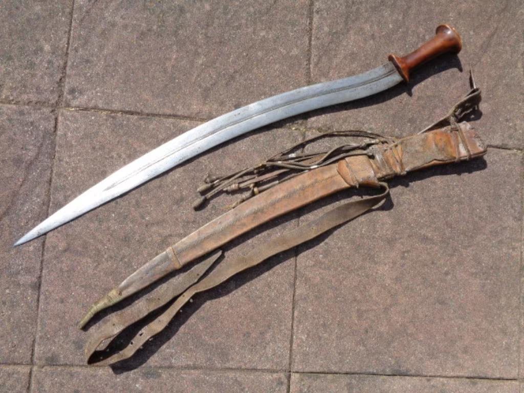

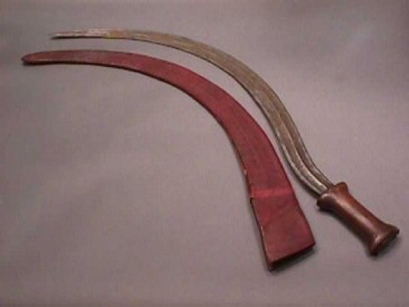

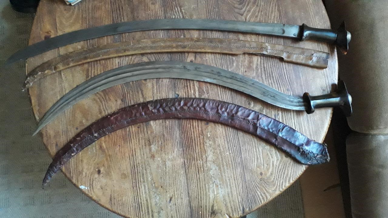

So that raises another question: is the one in this picture a shotel, or is it actually one of the long Jille you describe Martin?
I have one of the much more sickle shaped shotels and this one, and they are incredibly different things. The one in the first picture is quite thin and light, and can only be used one way, with the curve on the outside, whereas the sickle shaped sword shown at the bottom of the picture below is thick and hefty, and could be used in either configuration with the curve facing out or in.
Name:  WhatsApp Image 2024-07-05 at 20.39.47_b00c60e6.jpg
Of course, the top one in that picture would be a gurade, and Ii guess this one would be a saif:

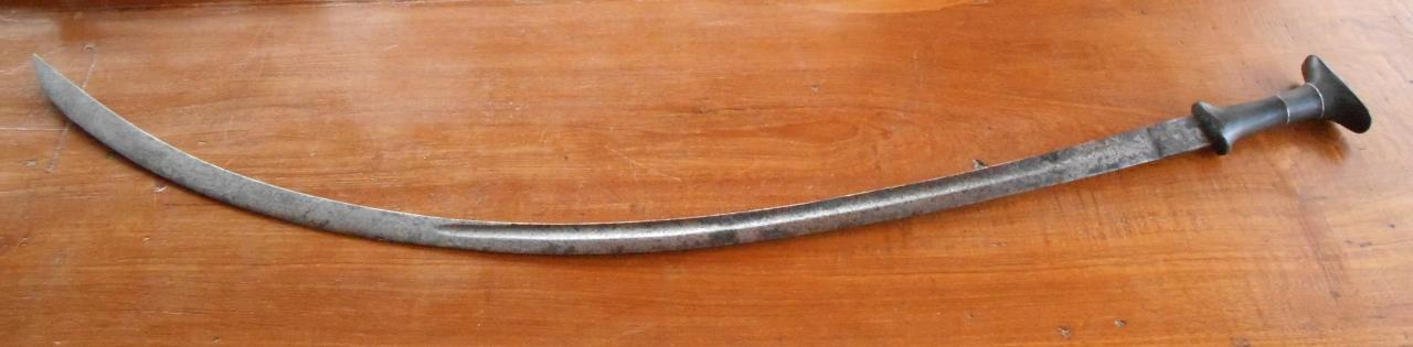

Another one with a long and very curved blade, around 110cm...

In the upper image, according to the terminology used by Addis Ababa sellers, it is a Jille (or Gile). The sheath has also decorative leather cords, which are otherwise common on the sheaths of jille-daggers, for example those used by the Kereyu group.

Alright, that goes some way to explain the wide disparity between them, thanks!

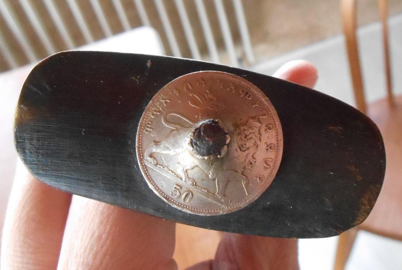

Here is shotel in my collection. It is a well-forged, double-sided sword 31 1/4 inches in length with a 27 inch curved blade. The blade is flat with diamond cross-section. The hilt is wooden with a copper disk at the pommel. The typically-colored red leather scabbard has decorative designs from top to bottom on both sides and is in good condition although very stiff.
Dave A.

Patterson thank you for that unusually long example, and Dave very nice one! Was the red coloring something was particular significance? It seems the 'seme' with the Massai often had red colored scabbards as well.

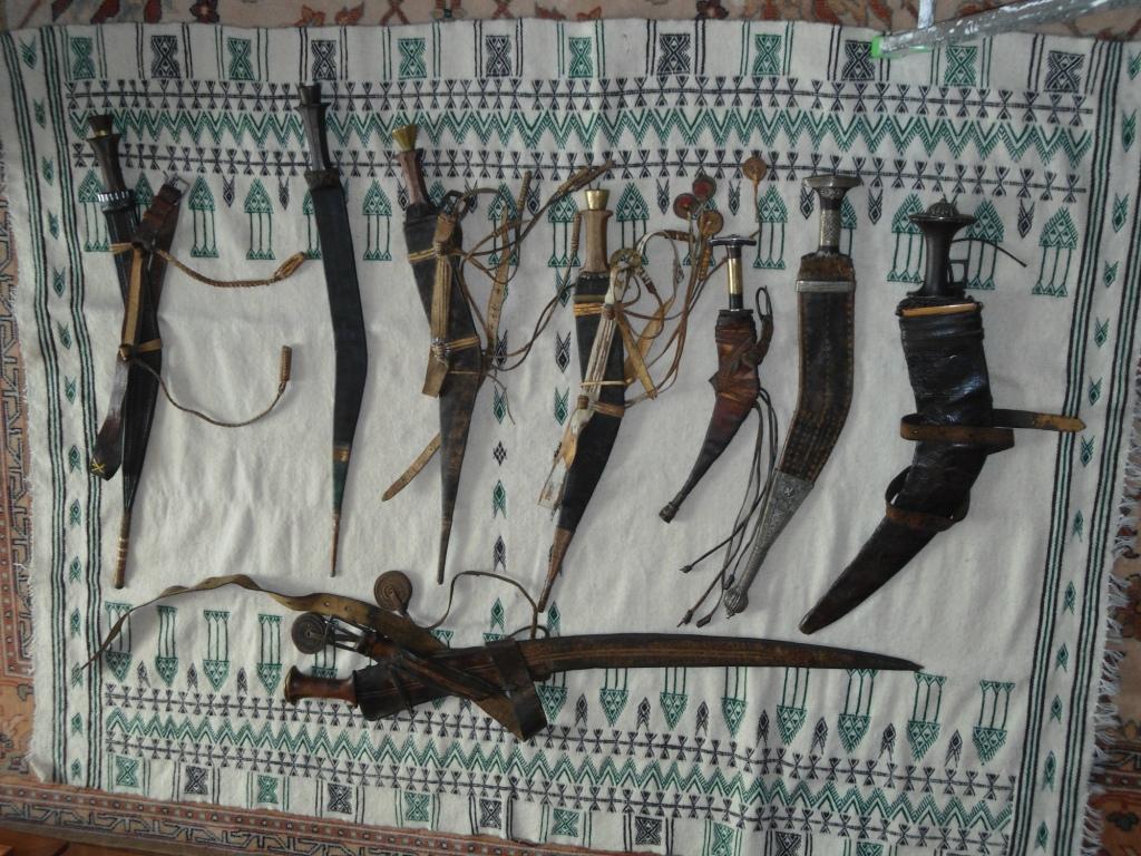

As for the age, I believe that older shotels or jile/gile-swords than from the second third of the 19th century have not survived (maybe in some museums?), and I would welcome any evidence to the contrary. I also think they were used roughly until the 1940s – see, for example, the photograph of Tigray people with a shotel in hand from 1935.
Jile/gile daggers (not swords) are still "used" (basically more or less as part of the traditional costume...). Over time their shape also changed slightly – see the photo from a celebration in Addis Ababa (December 2018) and the old photo of the Afars. These daggers were/are used by several ethnic groups, not only by the Afar themselves but also, for example, by the Kereyu, Itu, and others. Accordingly, the decoration, especially of the scabbards and hilts, could vary, but only a little . Jile/gile used by the Issa group also differed in that they were narrower and longer, and the lower part of the hilt slid into the scabbard – see the photo of the Issa from the desert. I am also attaching an approximately 15-year-old photo of several pieces from my collection.
As far as gile-sword is concerned, I have seen a jile/gile-sword with people in an old photo only once (whereas old photos of shotels with people several times; perhaps the shotel was more common ??) - unfortunately I do not have that picture. I believe it also dates to the 1930s–1940s.
As for the red colour, shotel scabbards and gorade scabbards made of thick rawhide were often covered with fine red “goatskin” with embossed patterns. In my opinion this was purely decorative and had nothing to do with Maasai swords.

In posting this shotel originally, I was hoping to get some insights on this example which Ive had for many years. Ive gone through all the posts over the years in search, and while there are of course many similar examples, this one seems unusual.
What I was asking is about the blade, the M initial and the Lion of Judah which seems etched.
The hilt seems of horn and giraffe.

Default Importer's Stamp?
Jim Mcdougall,
This may or may not be relevant but “MK” in a Circle at the base of Ethiopian gurades stands for Matig Kevorkoff & Cie an Armenian importer based in Harar, Ethiopia. Perhaps some blades only carried an “M” for the importer’s first name.
Sincerely,
RobT

Thank you Rob, I was wondering the same thing and knew of Kevorkoff, but the single letter seems unusual for such a noted importer, also his first name initial does not sound likely. In the examples I've seen in many discussions this is the only blade I have seen with this anomaly.
Best regards
