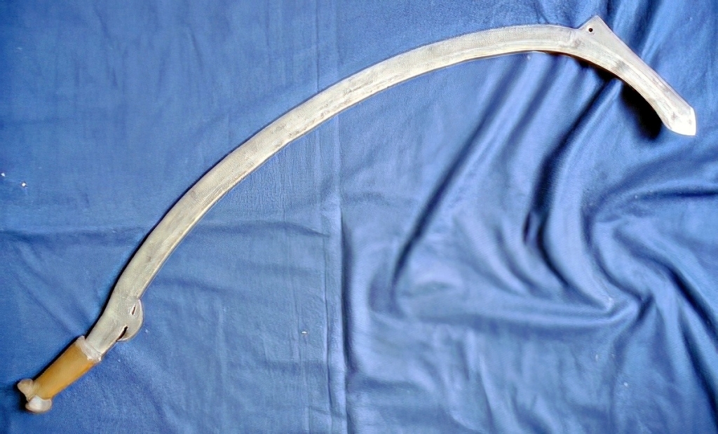

My humble one. Made of a soft iron, not steel, as they are.
