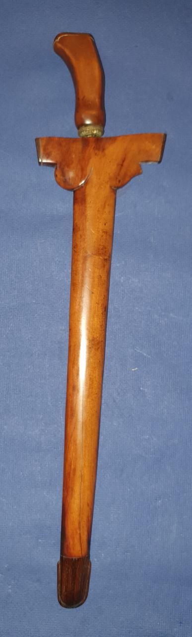

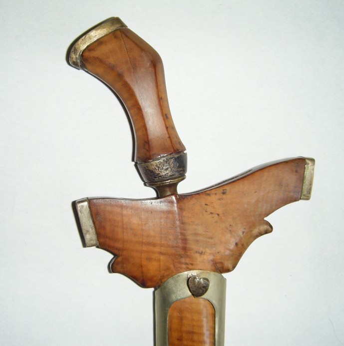

Hi all,
After lurking for the last six months I picked up this 9 luk Keris yesterday. It's I need of some serious TLC. It sure can use a good cleaning of the rust. I don't know a lot about it what I find interesting is that the wilah is standing in an angle from the Hilt. The Warangka is a model i have seen before but don't know how it is called. And my guess is that the Keris is from Madura. There is pamor to be seen but after derusting it might be better visible.
Hope someone can provide me some more info about this Keris.
Thnx for now and regards
Martin

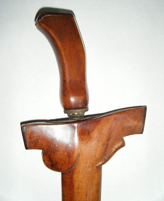

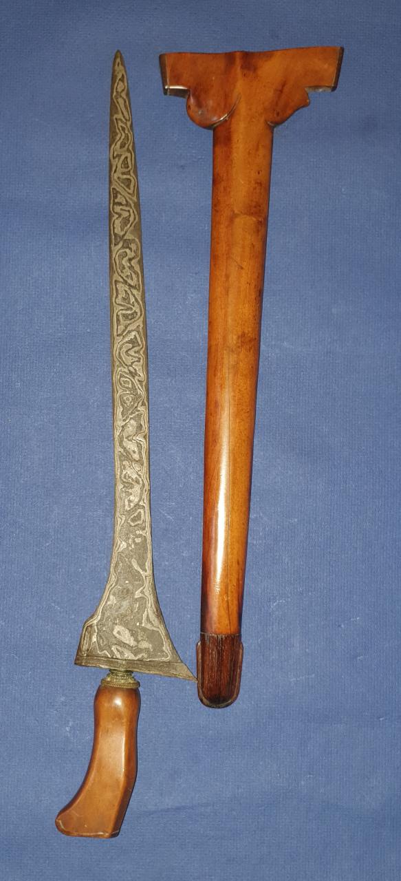

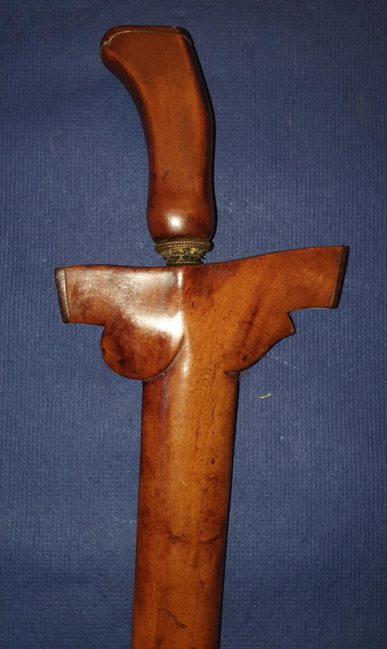

Hi Martin,
Jep, the sarung is Madurese. But like you I can't name it exactly.
Pics of my example attached.
Old 26th October 2025, 04:45 PM   #3

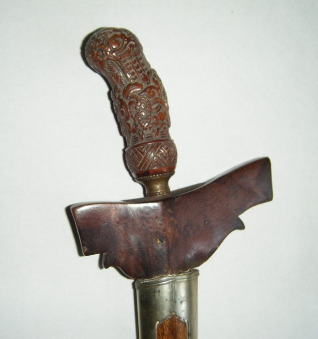

Posts: 9,783
All three I've have/had (one I sold) and one from Alan G. Maisey.

Posts: 7,220
Yes, Madura, dress is a sandang walikat style.
It is possible that in Madura, sandang walikat might be known by a different name, but if it is, I do not know that name.

Posts: 173
Thank you both so much, for the information. and i was also wondering the hilt /hulu when you hold it straight up the wilah is really under an angle, that is different than most of the keris i have.
Maybe a stupid question but has it a name? And if i am right it has 9 luk?
Regards, Martin

Thank you Mr. Maisey and Detlef,
yes i was curious what the dhapur would be, but most of the time the wilah is more in line with the hulu or ukiran. and this keris the wilah goes with a bevel arround 50 degrees.
So i was curious if this has a name in determinating a Keris.

Posts: 7,220
This is actually a pretty good question Martin --- I think of "good questions" as ones that I need to think about before I can respond to, and although I could have given a quick, off-the-cuff response to this question, I've been thinking about how best I should respond. I think I might now be able to do so.
In Jawa, when we refer to the angle of a keris blade, we refer to that as the "condong campur" of the blade.
"condong campur" applied to the keris & in Bahasa Indonesia can be understood as a "confused angle", actual translation is campur = mixed/confused, condong = leaning; used in Basa Jawa context the understanding is similar but the actual translation is campur = to mix, condhong = in agreement with.
So the blade angle in this keris is bit too "condong campur".
Now, in the Surakarta Pakem, there is a straight keris that is Dhapur Condhong Campur. It has not been drawn with an extreme blade angle, the only remarkable thing about it is that it has sogokan for the full length of the blade. There is also a waved keris that is given as Condhong Campur.
So there you have an explanation of how we would think of this keris in Jawa, but it still does not give you a dhapur name for it, and in my opinion, the blade is far too worn for us to be able to determine exactly how it looked when new.
Footnote: in fact the practical application of this extreme angle is an attempt at an ergonomic application, the angle moves the blade point to a position more favourable to centering on an opponent's body. Now that doesn't matter much today, but it might have provided some slight advantage when keris were used to end life.

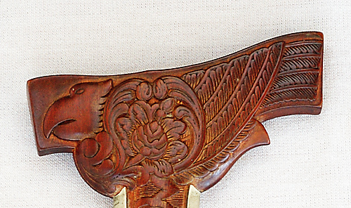

I understand in Madura, sandang walikat warangka are often used as the primary sandangan and more ornately decorated. There are several types/designs, among other Jurigan (the most common Sumenep style often paired with donoreko hilt), Saron, Nam-Nam, etc.

Mr. Maisey, I was referring to the variations in the shape of the Madurese warangka.
To my understanding, Madura, or in particular Sumenep which is considered to be the older (sepuh) cultural center there, has several common designs for warangka. Among other there are: 'daunan' ('leaves', akin to java-style ladrang, albeit more like 'capu'), dhang-odhangan ('shrimp', akin to jogja-style gayaman, though alot more shrimp-like in shape), and jurigan (more symmetrical, western-style scabbard often featuring the sumenep's crest or jaran panoleh, like what is shown at the beginning of this thread - though this one is rather simple).
