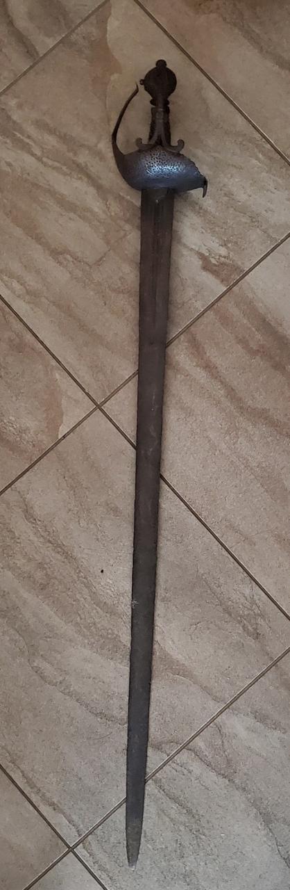

1 Ribbon hilt (beak nose) Highland c. 1650-80s pre Glasgow form ANDREA FERARA blade
2 Glasgow form, c1700 early 17th c Solingen blade Wirsberg.
3 Glasgow form c.1715, ANDREA FERARA blade
4 Glasgow form, British cavalry, poss. Scots Greys c. 1760
Note: English swords typically used German blades through 17th century, but the Hounslow enterprise 1630s and Shotley Bridge 1680s-1700 were using German makers relocated to England for production of blades. However, while a nominal number of blades were produced, there was still a large import of German blades.
