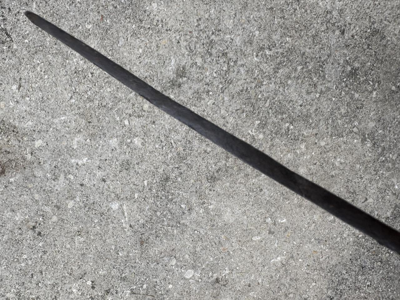

Can we see the spine of the blade? How thick is it,? , what is the blade edge profile like? Single beveled or doubly beveled?

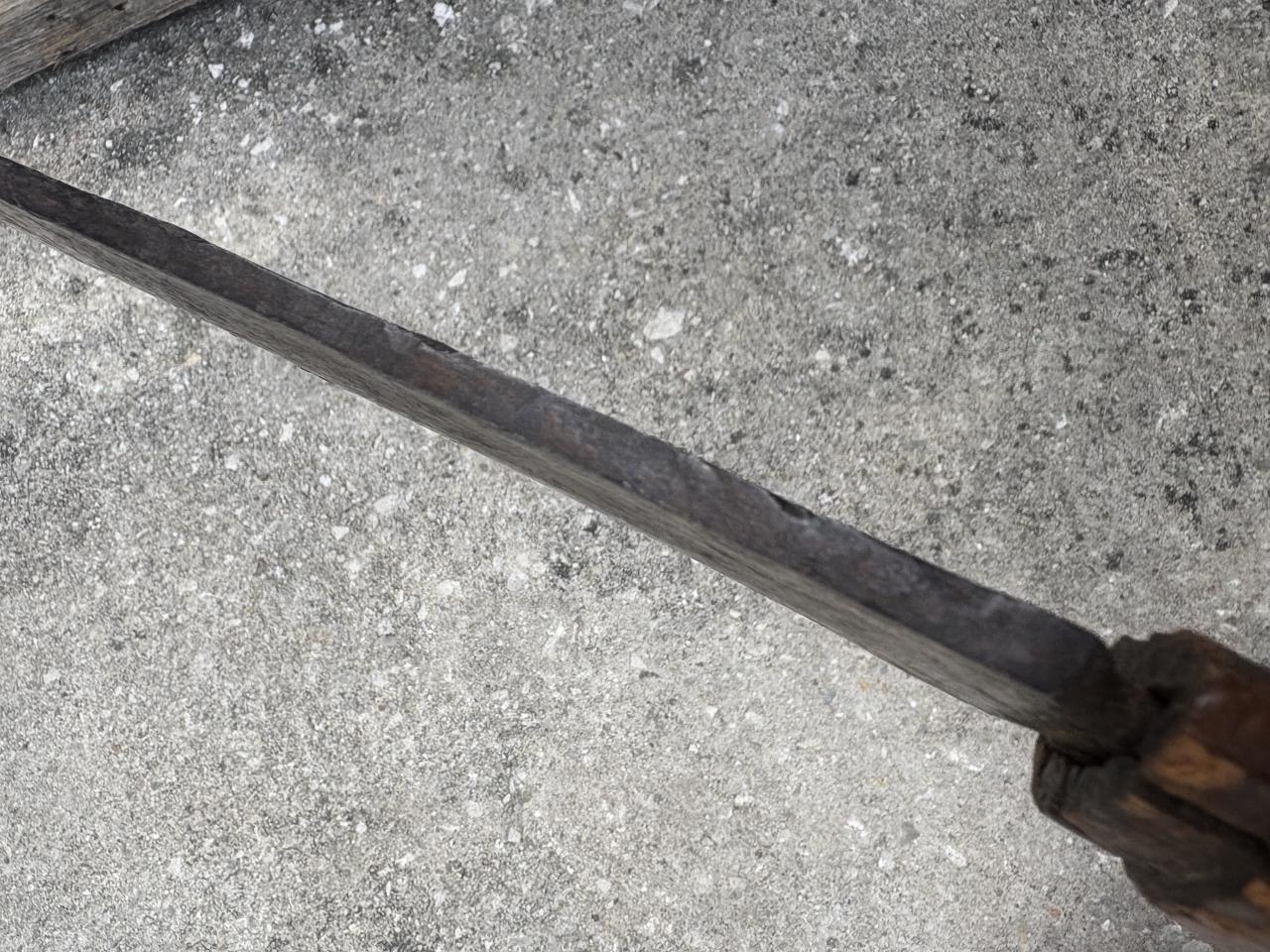

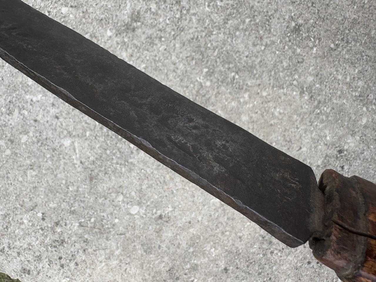

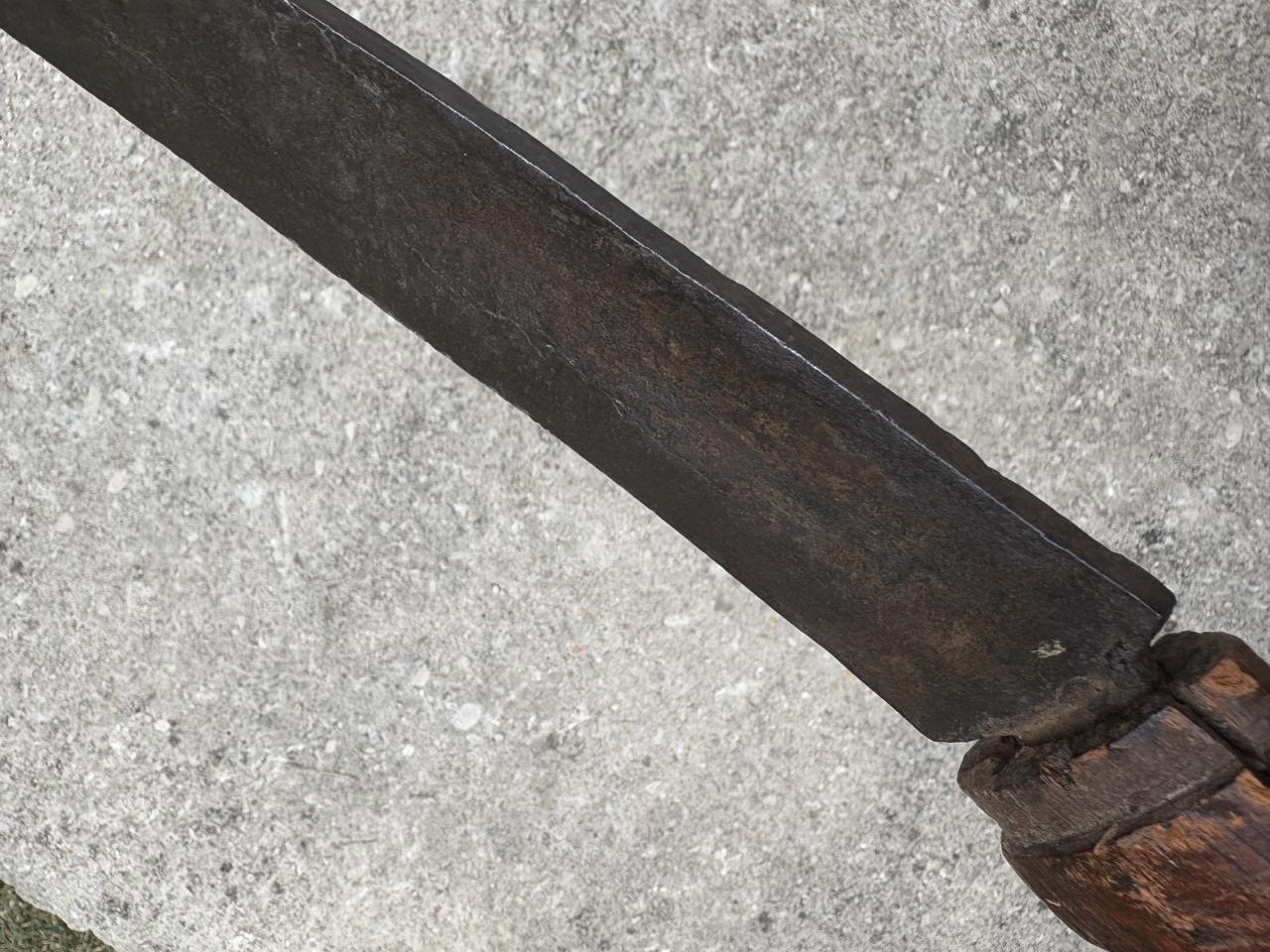

Of course! The blade is about 5mm at the hilt. The blade’s very rough and beaten-up, but it seems to have a double bevel. It actually curves forward slightly, with the spine in front of the rounded tip about in line with the center of the hilt.

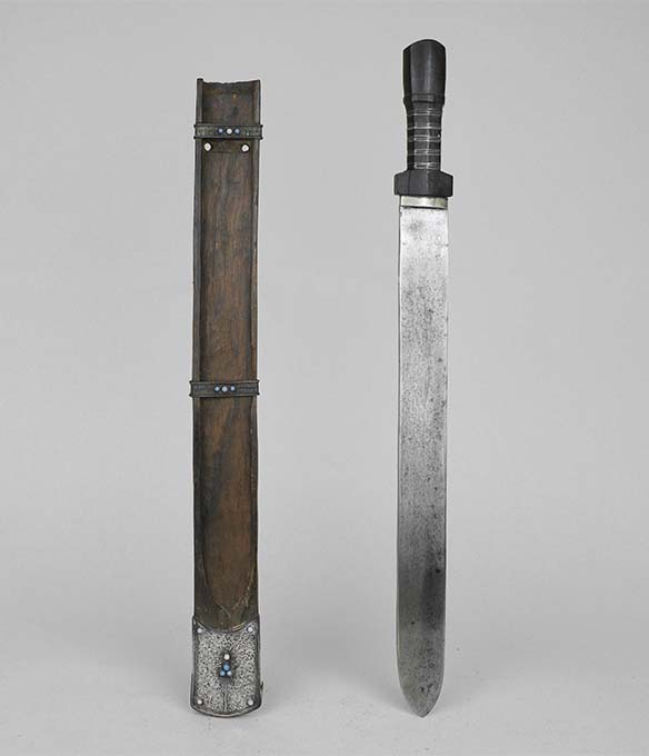

Very similar.
http://www.vikingsword.com/vb/showth...=tibetan+knife
